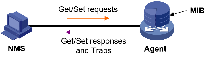

SNMP framework
The SNMP framework contains the following elements:
·     SNMP manager—Works on an NMS to monitor and manage the SNMP-capable devices in the network. It can get and set values of MIB objects on the agent.
·     SNMP agent—Works on a managed device to receive and handle requests from the NMS, and sends notifications to the NMS when events, such as an interface state change, occur.
·     Management Information Base (MIB)—Specifies the variables (for example, interface status and CPU usage) maintained by the SNMP agent for the SNMP manager to read and set.
Figure 1 Relationship between NMS, agent, and MIB

SNMPv1/SNMPv2c configuration example
The SNMPv1 configuration procedure is the same as the SNMPv2c configuration procedure. This example uses SNMPv1, and is not available in FIPS mode.
Network requirements
As shown in Figure 3, the NMS (1.1.1.2/24) uses SNMPv1 to manage the SNMP agent (1.1.1.1/24), and the agent automatically sends notifications to report events to the NMS.
Figure 3 Network diagram
Configuration procedure

SNMPv3 configuration example
As shown in Figure 4, the NMS (1.1.1.2/24) uses SNMPv3 to monitor and manage the interface status of the agent (1.1.1.1/24). The agent automatically sends notifications to report events to the NMS. The default UDP port 162 is used for SNMP notifications.
The NMS and the agent perform authentication when they establish an SNMP session. The authentication algorithm is SHA-1 and the authentication key is 123456TESTauth&!. The NMS and the agent also encrypt the SNMP packets between them by using the AES algorithm and the privacy key 123456TESTencr&!.
Figure 4 Network diagram

# Set the value for the sysName node to Sysname. The operation fails because the NMS does not have write access to the node.
# Shut down or bring up an interface on the agent. The NMS receives linkUP (OID: 1.3.6.1.6.3.1.1.5.4) or linkDown (OID: 1.3.6.1.6.3.1.1.5.3) notifications.
·     Use username VACMtest to access the agent.
# Retrieve the value of the sysName node. The value Agent is returned.
# Set the value for the sysName node to Sysname. The operation succeeds.
