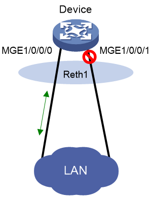

Applicable scenario
As shown in Figure 1, M-GigabitEthernet 1/0/0/0 and M-GigabitEthernet 1/0/0/1 are member interfaces of a Reth interface. The Reth interface selects the member interface to forward traffic as follows:
·     When both member interfaces are operating correctly, the Reth interface forwards traffic through M-GigabitEthernet 1/0/0/0 and places M-GigabitEthernet 1/0/0/1 in inactive state.
·     When M-GigabitEthernet 1/0/0/0 fails, M-GigabitEthernet 1/0/0/1 becomes active and the Reth interface switches traffic over to M-GigabitEthernet 1/0/0/1.
Figure 1 Reth interfaces

Reth interface configuration example
Network requirements
As shown in Figure 2, configure a Reth interface as follows:
·     Assign M-GigabitEthernet 1/0/0/0 and M-GigabitEthernet 1/0/0/1 to the Reth interface.
·     Assign a higher priority to M-GigabitEthernet 1/0/0/0 for it to be the active member interface.
Figure 2 Network diagram
