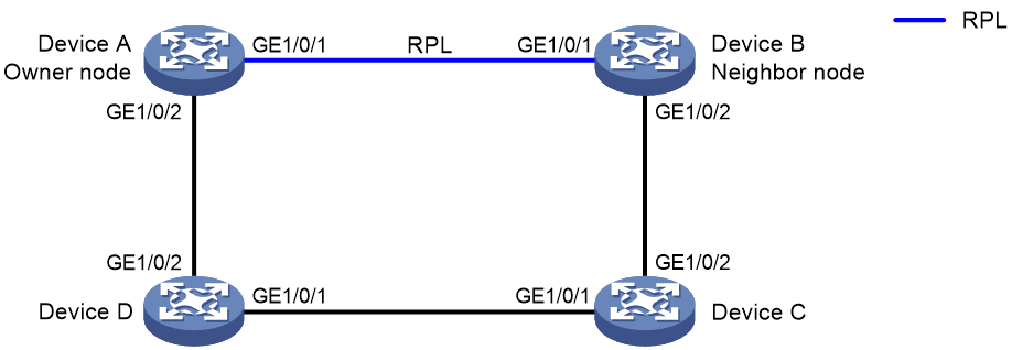

Link-down report mechanism
Figure 2 Link-down report mechanism
As shown in Figure 2, the link-down report mechanism uses the following process:
1.     Device C and Device D detect the link failure and perform the following operations:
a.     Block the ports on both side of the faulty link.
b.     Periodically send SF packets to other nodes.
2.     Device A and Device B receive the SF packets and perform the following operations:
a.     Unblock RPL ports.
b.     Update the MAC address entries.
Service packets are switched to the RPL link.

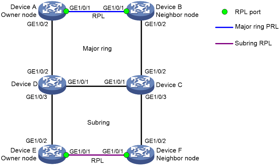

Link recovery mechanism
Figure 3 Link recovery mechanism
As shown in Figure 3, the link recovery mechanism uses the following process:
1.     Device C and Device D detect the link recovery and perform the following operations:
a.     Block the recovered ports.
b.     Start the guard timer.
c.     Send NR packets.
2.     When Device A (owner node) receives the NR packets, it does not perform any operations if it is in non-revertive mode. If Device A is in revertive mode, it performs the following operations:
a.     Starts the WTR timer.
b.     Blocks the RPL port and periodically sends NR-RB packets when the WTR timer expires.
3.     When other nodes receive the NR-RB packets, they perform the following operations:
a.     Device B (neighbor port) blocks the RPL port.
b.     Device C and Device D unblock the recovered ports.
Service packets are switched to the recovered link.

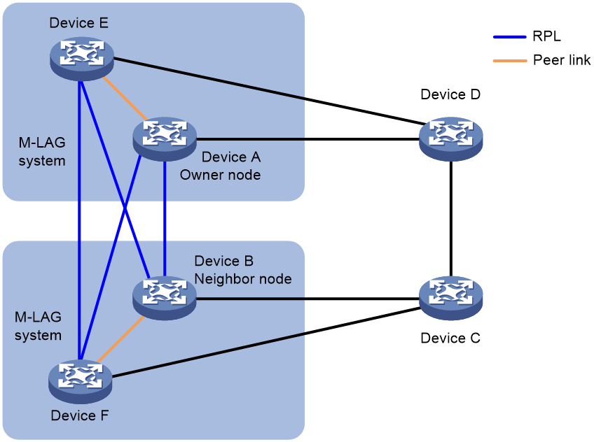

ERPS with M-LAG
M-LAG allows you to virtualize the devices in an ERPS ring into one system through multichassis link to achieve device-level redundancy and load balancing.
You can use the display erps detail ring command to determine whether ERPS works correctly in an M-LAG network. For more information about M-LAG, see Layer 2—LAN Switching Configuration Guide.
Figure 11 ERPS with M-LAG

·     Do not assign both an M-LAG interface and a non-M-LAG interface on a non-interconnection node to an ERPS ring. If you do so, the M-LAG interface does not take effect on the ERPS ring.

·     When configuring ERPS with M-LAG, make sure the peer-link interface is a trunk port. The peer-link interface will automatically join or leave a control VLAN as the control VLAN is created or deleted.
