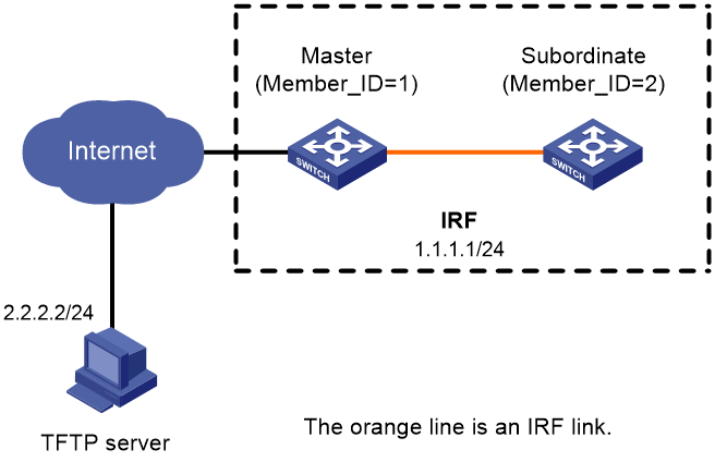

As shown in Figure 1, the two-chassis IRF fabric and the TFTP server can reach each other. The IRF members are running CMW710-SYSTEM-R7748.bin, and they have not been patched before.
Use the patch image file CMW710-SYSTEM-R7748H04.bin to fix bugs without rebooting the members.
Figure 1 Network diagram
