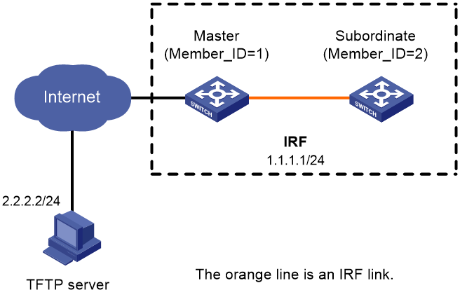

As shown in Figure 1, the two-chassis IRF fabric and the TFTP server can reach each other. Perform a compatible ISSU on the IRF to upgrade startup images from T0001015 to T0001016.

# Download the new image file T0001017.ipe from the TFTP server to the root directory of a file system on the master. The .ipe file includes the boot-t0001017.bin image file and the system-t0001017.bin image file.
<Sysname> tftp 2.2.2.2 get T0001017.ipe

# Upgrade the subordinate member.
<Sysname> issu load file ipe flash:/T0001017.ipe slot 2
