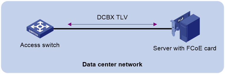

DCBX application scenario
Figure 6 DCBX application scenario
DCBX enables lossless packet transmission on DCE networks.
As shown in Figure 6, DCBX applies to an FCoE-based data center network, and operates on an access switch. DCBX enables the switch to control the server or storage adapter, and simplifies the configuration and guarantees configuration consistency. DCBX extends LLDP by using the IEEE 802.1 organizationally specific TLVs (DCBX TLVs) to transmit DCBX data, including:
·     Priority-based Flow Control (PFC) in DCBX Rev 1.00 and DCBX Rev 1.01.
·     PFC in IEEE Std 802.1Qaz-2011.
The devices can send these types of DCBX information to a server or storage adapter. However, the devices cannot accept these types of DCBX information.
