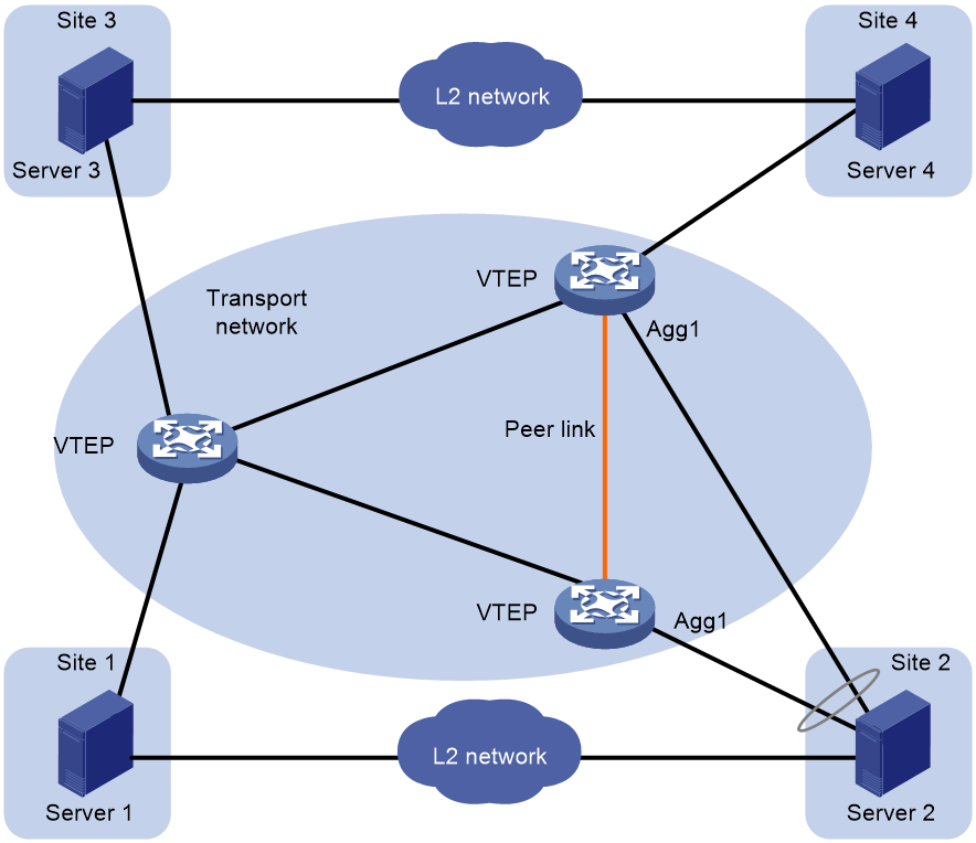

Configuring loop detection in a VXLAN network· 0

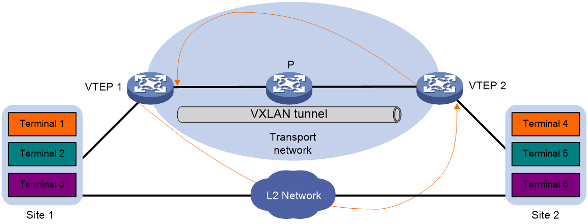

About loop detection in a VXLAN network· 0
Application scenario· 0
Loop detection frame format 0
Loop detection priority· 2
Loop detection mechanisms· 2
Loop detection actions· 3
AC status auto recovery· 3
Loop detection in a VXLAN network with M-LAG configured· 3

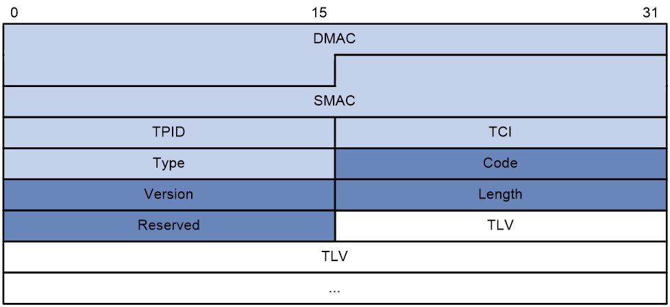

Figure 1 Ethernet frame header for loop detection
The Ethernet frame header of a loop detection packet contains the following fields:
·     DMACDestination MAC address of the frame, which is the multicast MAC address 010f-e200-0007. When a loop detection-enabled device receives a frame with this destination MAC address, it performs the following operations:
¡     Sends the frame to the CPU.
¡     Floods the frame in the VLAN from which the frame was originally received.
·     SMACSource MAC address of the frame, which is the bridge MAC address of the sending device.
·     TPIDType of the VLAN tag, with the value of 0x8100.
·     TCIInformation of the VLAN tag, including the priority and VLAN ID.
·     TypeProtocol type, with the value of 0x8918.
Figure 2 Inner frame header for loop detection
The inner frame header of a loop detection packet contains the following fields:
·     CodeProtocol sub-type, which is 0x0001, indicating the loop detection protocol.
·     VersionProtocol version, which is always 0x0000.
·     LengthLength of the frame. The value includes the inner header, but excludes the Ethernet header.
·     ReservedThis field is reserved.
Frames for loop detection are encapsulated as TLV triplets.

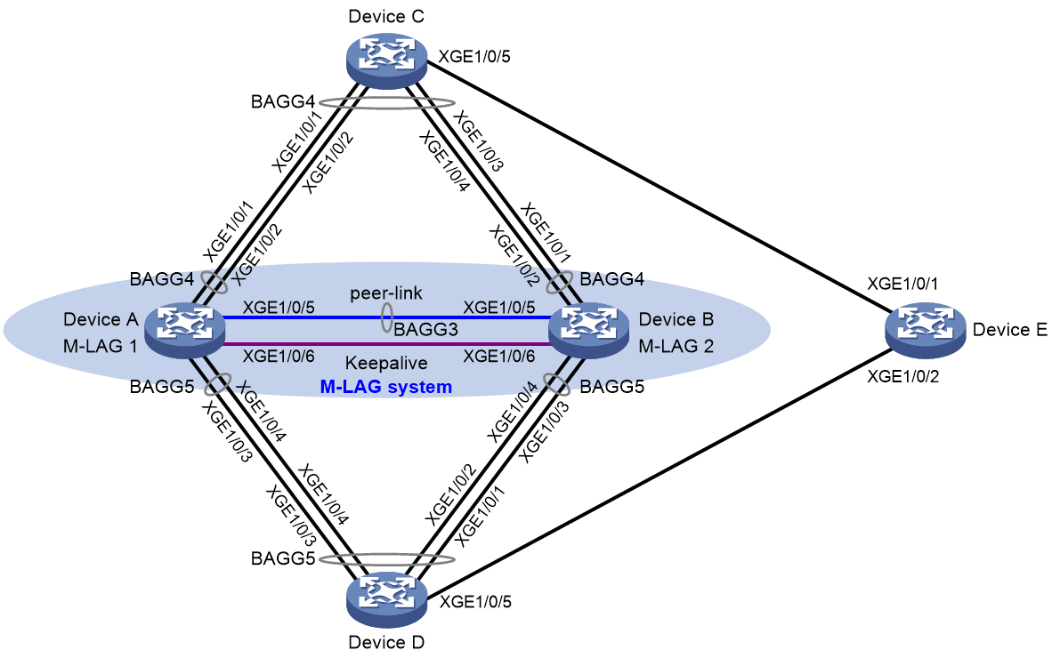

Restriction and guidelines: M-LAG configuration
Member devices in an M-LAG system must have the same loop detection configuration.

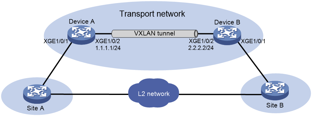

As shown in Figure 3, configure loop detection on Device A to meet the following requirements:
·     Device A generates a log as a notification.
·     Device A automatically shuts down the interface on which a loop is detected.
Figure 3 Network diagram
1.     Configure Device A:
# Create VLAN 100, and globally enable loop detection for the VLAN.
<DeviceA> system-view
[DeviceA] vlan 100
[DeviceA-vlan100] quit
[DeviceA] loopback-detection global enable vlan 100
# Configure Ten-GigabitEthernet 1/0/1 and Ten-GigabitEthernet 1/0/2 as trunk ports, and assign them to VLAN 100.
[DeviceA] interface Ten-GigabitEthernet 1/0/1
[DeviceA-Ten-GigabitEthernet1/0/1] port link-type trunk
[DeviceA-Ten-GigabitEthernet1/0/1] port trunk permit vlan 100
[DeviceA-Ten-GigabitEthernet1/0/1] quit
[DeviceA] interface ten-gigabitethernet 1/0/2
[DeviceA-Ten-GigabitEthernet1/0/2] port link-type trunk
[DeviceA-Ten-GigabitEthernet1/0/2] port trunk permit vlan 100
[DeviceA-Ten-GigabitEthernet1/0/2] quit
# Set the global loop protection action to shutdown.
[DeviceA] loopback-detection global action shutdown
# Set the loop detection interval to 35 seconds.
[DeviceA] loopback-detection interval-time 35

Example: Configuring loop detection on an M-LAG system
As shown in Figure 4, configure loop detection on the M-LAG system formed by Device A and Device B to meet the following requirements:
·     Generates a log as a notification.
·     Automatically shuts down the interface on which a loop is detected.
Figure 4 Network diagram

# View the system logs on Device A.
[DeviceA]
%Aug  1 03:28:48:110 2019 DeviceA LPDT/4/LPDT_LOOPED: A loop was detected on
 Bridge-Aggregation4.
%Aug  1 03:28:48:191 2019 DeviceA LPDT/4/LPDT_VLAN_LOOPED: A loop was detect
ed on Bridge-Aggregation4 in VLAN 100.
%Aug  1 03:28:48:194 2019 DeviceA LPDT/4/LPDT_LOOPED: A loop was detected on
 Bridge-Aggregation5.
%Aug  1 03:28:48:288 2019 DeviceA LPDT/4/LPDT_VLAN_LOOPED: A loop was detect
ed on Bridge-Aggregation5 in VLAN 100.
%Aug  1 03:28:48:290 2019 DeviceA LPDT/5/LPDT_VLAN_RECOVERED: A loop was rem
oved on Bridge-Aggregation4 in VLAN 100.
%Aug  1 03:28:48:291 2019 DeviceA LPDT/5/LPDT_RECOVERED: All loops were remo
ved on Bridge-Aggregation4.
%Aug  1 03:28:48:302 2019 DeviceA LPDT/5/LPDT_VLAN_RECOVERED: A loop was rem
oved on Bridge-Aggregation5 in VLAN 100.
%Aug  1 03:28:48:304 2019 DeviceA LPDT/5/LPDT_RECOVERED: All loops were remo
ved on Bridge-Aggregation5.
The output shows the following information:
·     Device A detected loops on Bridge-Aggregation 4 and Bridge-Aggregation 5 within a loop detection interval.
·     Loops on Bridge-Aggregation 4 and Bridge-Aggregation 5 were removed.
# Use the display loopback-detection command to display the loop detection configuration and status on Device A.
[DeviceA] display loopback-detection
Loop detection is enabled.
Global loop detection interval is 35 second(s).
Loop is detected on following interfaces:
  Interface                       Action mode     VLANs/VSI
  Bridge-Aggregation4             Shutdown        100
  Bridge-Aggregation5             Shutdown        100
The output shows that the device has removed the loops from Bridge-Aggregation 4 and Bridge-Aggregation 5 according to the shutdown action.
# Verify that Bridge-Aggregation 4 has been shut down by loop detection.
[DeviceA] display interface Bridge-Aggregation 4
Bridge-Aggregation4
The interface has assigned a M-LAG group.
Current state: DOWN (Loopback detection down)
# Verify that Bridge-Aggregation 5 has been shut down by loop detection.
[DeviceA] display interface Bridge-Aggregation 5
Bridge-Aggregation5
# Verify that loops have been removed on Device B. (Details not shown.)
As shown in Figure 6, a loop detection frame contains the Ethernet header, loop detection header, and loop detection TLVs.
Figure 6 Loop detection frame format
The Ethernet frame header of a loop detection frame contains the following fields:
·     DMAC—Destination MAC address of the frame, which is the multicast MAC address 010f-e200-0007. When a loop detection-enabled device receives a frame with this destination MAC address, it performs the following operations:
¡     Floods the frame in the VLAN from which the frame was received.
·     SMAC—Source MAC address of the frame, which is the bridge MAC address of the sending device.
·     TPID—Type of the VLAN tag, with the default value of 0x8100.
·     TCI—Tag control information, including the priority and VLAN ID.
·     Type—Protocol type, with the value of 0x8918.
The loop detection header of a loop detection frame contains the following fields:
·     Code—Protocol sub-type, which is 0x0001, indicating the loop detection type.
·     Version—Protocol version, which is reserved. This field is fixed at 0x0000.
·     Length—Length of the frame. The value includes the loop detection header, but excludes the Ethernet header.
·     Reserved—This field is reserved.
Payload of a loop detection frame is encapsulated as TLV triplets.
After you enable loop detection on a VSI, its ACs keep sending loop detection frames and detecting incoming loop detection frames at the same time. If an AC receives a loop detection frame that carries a VXLAN ID the same as the AC's VXLAN ID, the device determines that a loop exists on the AC. Then, the AC compares its own loop detection priority with that in the frame. If the loop detection priority in the frame is higher, the loop protection action is triggered. If the loop detection priority of the AC is higher, the system only records the loop information.
The ACs of a loop detection-enabled VSI send loop detection frames to detect loops in the attached sites. If the device receives a loop detection frame on a VXLAN tunnel interface and the VXLAN ID in the frame matches the local one, it determines that a loop exists on the traffic outgoing AC.
Loop detection is a continuous process as the network changes. Loop detection frames are sent at the loop detection interval to determine whether loops occur on ACs and whether loops are removed.
In a VXLAN network, M-LAG can virtualize two VTEPs into an M-LAG system that connects to the remote aggregation system through a multichassis aggregate link. To the remote aggregation system, the M-LAG system is one device. This prevents single points of failure from interrupting traffic forwarding and ensures high availability of the VXLAN network. For more information about M-LAG, see "Configuring M-LAG."
Figure 7 Network diagram
As shown in Figure 7, if an endpoint is dualhomed to the M-LAG system, you must enable loop detection on both VTEPs in the M-LAG system. Loop detection works as follows on the VTEPs:
1.     The VTEPs send loop detection frames out of the ACs configured on the M-LAG interfaces facing the endpoint. The loop detection frames contain the same source MAC address, VLAN tag, loop detection interval, and loop detection priority. The source MAC address is the M-LAG system MAC address.
2.     When receiving loop detection frames on a local M-LAG interface, a VTEP sends the loop detection frames to the peer VTEP over the peer link. This synchronization mechanism ensures that a VTEP can receive loop detection frames in case of link or interface failure.
3.     If a VTEP receives a self-sent loop detection frame from an AC, the VTEP compares the loop detection priority of the AC with that in the frame and acts as follows:
¡     If the loop detection priority in the frame is higher, the VTEP performs the loop protection action on all ACs configured for the M-LAG group that accommodates the looped M-LAG interface.
¡     If the loop detection priority of the AC is higher, the system only records the loop information.
If an endpoint is singlehomed to one VTEP in the M-LAG system, enable loop detection only on that VTEP. Loop detection works as follows on the VTEP:
1.     The VTEP sends loop detection frames out of the ACs configured on the M-LAG interface facing the endpoint. The source MAC address is the M-LAG system MAC address.
2.     If the VTEP receives a self-sent loop detection frame from an AC, the VTEP compares the loop detection priority of the AC with that in the frame and acts as follows:
¡     If the loop detection priority in the frame is higher, the VTEP performs the loop protection action on the looped AC.

Example: Configuring local site loop detection
As shown in Figure 8, Device A and Device B provide user traffic transmission service for site 1 and site 2, and the sites have Layer 2 connectivity in VLAN 10. Configure loop detection on Device A and Device B so that they can block ACs if loops exist.
Figure 8 Network diagram
Configure a routing protocol in the VXLAN for the VTEPs to reach one another.
# Create VXLAN 1 and assign it a VXLAN tunnel. Map VSI vsi 1 to VXLAN 1.
[DeviceA] l2vpn enable
[DeviceA] interface tunnel 10 mode vxlan
[DeviceA-Tunnel10] source 1.1.1.1
[DeviceA-Tunnel10] destination 2.2.2.2
[DeviceA-Tunnel10] quit
[DeviceA] vsi 1
[DeviceA-vsi-1] vxlan 1
[DeviceA-vsi-1-vxlan-1] tunnel 10
[DeviceA-vsi-1-vxlan-1] quit
# Disable spanning tree globally.
[DeviceA] undo stp global enable
# Configure an AC and map it to VSI vsi 1.
[DeviceA] interface ten-gigabitethernet 1/0/1
[DeviceA-Ten-GigabitEthernet1/0/1] service-instance 1
[DeviceA-Ten-GigabitEthernet1/0/1-srv1] encapsulation s-vid 10
[DeviceA-Ten-GigabitEthernet1/0/1-srv1] xconnect vsi 1
[DeviceA-Ten-GigabitEthernet1/0/1-srv1] quit
# Enable loop detection on VSI vsi 1.
[DeviceA] vsi 1
[DeviceA-vsi-1] loopback-detection enable
# Set the loop protection action to block on VSI vsi 1.
[DeviceA-vsi-1] loopback-detection action block
# Set the loop detection interval to 35 seconds on VSI vsi 1.
[DeviceA-vsi-1] loopback-detection interval-time 35
# Set the loop detection priority to 1 on VSI vsi 1.
[DeviceA-vsi-1] loopback-detection priority 1
2.     Configure Device B:
<DeviceB> system-view
[DeviceB] l2vpn enable
[DeviceB] interface Tunnel 10 mode vxlan
[DeviceB-Tunnel10] source 2.2.2.2
[DeviceB-Tunnel10] destination 1.1.1.1
[DeviceB-Tunnel10] quit
[DeviceB] vsi 1
[DeviceB-vsi-1] vxlan 1
[DeviceB-vsi-1-vxlan-1] tunnel 10
[DeviceB-vsi-1-vxlan-1] quit
[DeviceB] undo stp global enable
[DeviceB] interface ten-gigabitethernet 1/0/1
[DeviceB-Ten-GigabitEthernet1/0/1] service-instance 1
[DeviceB-Ten-GigabitEthernet1/0/1-srv1] encapsulation s-vid 10
[DeviceB-Ten-GigabitEthernet1/0/1-srv1] xconnect vsi 1
[DeviceB-Ten-GigabitEthernet1/0/1-srv1] quit
[DeviceB] vsi 1
[DeviceB-vsi-1] loopback-detection enable
[DeviceB-vsi-1] loopback-detection action block
[DeviceB-vsi-1] loopback-detection interval-time 35
# Set the loop detection priority to 6 on VSI vsi 1.
[DeviceB-vsi-1] loopback-detection priority 6
# Verify that Device A has detected a loop.
[DeviceA]
%Mar 25 10:59:59:690 2019 Device A LPDT/4/LPDT_VSI_LOOPED: A loop was detected on VSI 1's Ethernet service instance srv1 on Ten-GigabitEthernet1/0/1.
# Verify that Device A has detected a loop on the AC on Ten-GigabitEthernet 1/0/1 but does not block the AC because it has high priority.
Global loop detection interval is 30 second(s).
* indicates the loop protection action was not triggered.
# indicates the loop protection action failed.
  Ten-GigabitEthernet1/0/1  srv1    Block*          1
# Verify that Device B has blocked the AC on Ten-GigabitEthernet 1/0/1 to remove the loop.
[DeviceB] display loopback-detection
  Ten-GigabitEthernet1/0/1  srv1    Block           1
