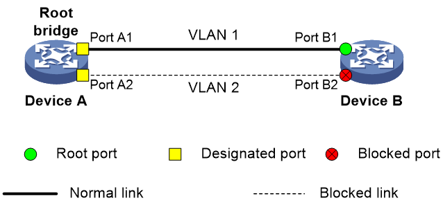

As shown in Figure 6, Device A is the root bridge. The priority of Device B is higher than the priority of Device C. Port C2 on Device C is blocked.
When the link between Device A and Device B fails, the following events occur:
1.     Device B sends an RSTP BPDU with itself as the root bridge to Device C.
2.     Device C compares the RSTP BPDU with its own BPDU.
3.     Because the RSTP BPDU from Device B has a lower priority, Device C sends its own BPDU to Device B.
4.     Device B considers that Port B2 is the root port and stops sending RSTP BPDUs to Device C.
Figure 6 BPDU processing in RSTP

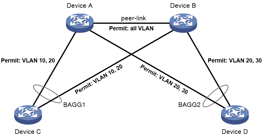

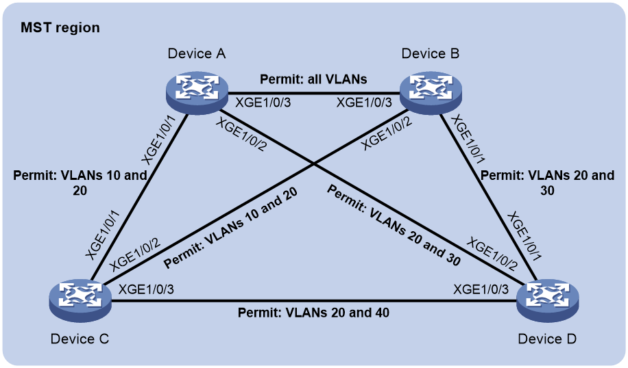

Figure 9 shows a switched network that contains four MST regions, each MST region containing four MSTP devices. Figure 10 shows the networking topology of MST region 3.
Figure 9 Basic concepts in MSTP
Figure 10 Network diagram and topology of MST region 3

Edge port rapid transition
As shown in Figure 12, Port C3 is an edge port connected to a host. When a network topology change occurs, the port can immediately transit from the blocking state to the forwarding state because no loop will be caused.
Figure 12 Edge port rapid transition

Ignoring the specified VLANs
Traffic of a VLAN on a complex network might be blocked by the spanning tree, as shown in Figure 16.
·     Port A1 on Device A allows the traffic of VLAN 1 to pass through.
·     Port A2 on Device A allows the traffic of VLAN 2 to pass through.
·     Port B1 on Device B allows the traffic of VLAN 1 to pass through.
·     Port B2 on Device B allows the traffic of VLAN 2 to pass through.
·     Device A and Device B run a spanning tree protocol. Device A is the root bridge, and Port A1 and Port A2 are designated ports. On Device B, Port B1 is the root port, and Port B2 is the blocked port. Traffic of VLAN 2 is blocked.
Figure 16 VLAN connectivity blocked by MSTP
Ignoring a VLAN can make ports of the VLAN forward frames correctly rather than comply with the spanning tree calculation result.
2.     Ignore the specified VLANs.
stp ignored vlan vlan-id-list
By default, no VLAN is ignored.

5.     Enable Digest Snooping globally.
stp global config-digest-snooping
By default, Digest Snooping is disabled globally.
Configuring No Agreement Check
In RSTP and MSTP, the following types of messages are used for rapid state transition on designated ports:
·     Proposal—Sent by designated ports to request rapid transition
·     Agreement—Used to acknowledge rapid transition requests
Both RSTP and MSTP devices can perform rapid transition on a designated port only when the port receives an agreement packet from the downstream device. RSTP and MSTP devices have the following differences:
·     For MSTP, the root port of the downstream device sends an agreement packet only after it receives an agreement packet from the upstream device.
·     For RSTP, the downstream device sends an agreement packet whether or not an agreement packet from the upstream device is received.
Figure 17 Rapid state transition of an MSTP designated port
Figure 18 Rapid state transition of an RSTP designated port
If the upstream device is a third-party device, the rapid state transition implementation might be limited as follows:
·     The upstream device uses a rapid transition mechanism similar to that of RSTP.
·     The downstream device runs MSTP and does not operate in RSTP mode.
In this case, the following occurs:

As shown in Figure 19, an IRF fabric connects to two user networks through double links.
·     Device A and Device B form the IRF fabric.
·     The spanning tree feature is disabled on Device A and Device B and enabled on all devices in user network 1 and user network 2.
·     The IRF fabric transparently transmits BPDUs for both user networks and is not involved in the calculation of spanning trees.
When the network topology changes, it takes time for the IRF fabric to update its MAC address table and ARP table. During this period, traffic in the network might be interrupted.
Figure 19 TC Snooping application scenario
image14.emf
To avoid traffic interruption, you can enable TC Snooping on the IRF fabric. After receiving a TC-BPDU through a port, the IRF fabric updates MAC address table and ARP table entries associated with the port's VLAN. In this way, TC Snooping prevents topology change from interrupting traffic forwarding in the network. For more information about the MAC address table and the ARP table, see "Configuring the MAC address table" and Layer 3—IP Services Configuration Guide.

Dispute guard can be triggered by unidirectional link failures. If an upstream port receives inferior BPDUs from a downstream designated port in forwarding or learning state because of a unidirectional link failure, a loop appears. Dispute guard blocks the upstream designated port to prevent the loop.
As shown in Figure 20, in normal conditions, the spanning tree calculation result is as follows:
·     Device A is the root bridge, and Port A1 is a designated port.
·     Port B1 is blocked.
When the link between Port A1 and Port B1 fails in the direction of Port A1 to Port B1 and becomes unidirectional, the following events occur:
1.     Port A1 can only receive BPDUs and cannot send BPDUs to Port B1.
2.     Port B1 does not receive BPDUs from Port A1 for a certain period of time.
3.     Device B determines itself as the root bridge.
4.     Port B1 sends its BPDUs to Port A1.
5.     Port A1 determines the received BPDUs are inferior to its own BPDUs. A dispute is detected.
6.     Dispute guard is triggered and blocks Port A1 to prevent a loop.
Figure 20 Dispute guard triggering scenario (on a designated port)

Example: Configuring MSTP
As shown in Figure 23, all devices on the network are in the same MST region. Device A and Device B work at the distribution layer. Device C and Device D work at the access layer.
Configure MSTP so that frames of different VLANs are forwarded along different spanning trees.
·     VLAN 10 frames are forwarded along MSTI 1.
·     VLAN 30 frames are forwarded along MSTI 3.
·     VLAN 40 frames are forwarded along MSTI 4.
·     VLAN 20 frames are forwarded along MSTI 0.
VLAN 10 and VLAN 30 are terminated on the distribution layer devices, and VLAN 40 is terminated on the access layer devices. The root bridges of MSTI 1 and MSTI 3 are Device A and Device B, respectively, and the root bridge of MSTI 4 is Device C.
Figure 23 Network diagram
1.     Configure VLANs and VLAN member ports. (Details not shown.)
¡     Create VLAN 10, VLAN 20, and VLAN 30 on both Device A and Device B.
¡     Create VLAN 10, VLAN 20, and VLAN 40 on Device C.
¡     Create VLAN 20, VLAN 30, and VLAN 40 on Device D.
¡     Configure the ports on these devices as trunk ports and assign them to related VLANs.
2.     Configure Device A:
# Enter MST region view, and configure the MST region name as example.
<DeviceA> system-view
[DeviceA] stp region-configuration
[DeviceA-mst-region] region-name example
# Map VLAN 10, VLAN 30, and VLAN 40 to MSTI 1, MSTI 3, and MSTI 4, respectively.
[DeviceA-mst-region] instance 1 vlan 10
[DeviceA-mst-region] instance 3 vlan 30
[DeviceA-mst-region] instance 4 vlan 40
# Configure the revision level of the MST region as 0.
[DeviceA-mst-region] revision-level 0
# Activate MST region configuration.
[DeviceA-mst-region] active region-configuration
[DeviceA-mst-region] quit
# Configure the Device A as the root bridge of MSTI 1.
[DeviceA] stp instance 1 root primary
# Enable the spanning tree feature globally.
[DeviceA] stp global enable
3.     Configure Device B:
<DeviceB> system-view
[DeviceB] stp region-configuration
[DeviceB-mst-region] region-name example
[DeviceB-mst-region] instance 1 vlan 10
[DeviceB-mst-region] instance 3 vlan 30
[DeviceB-mst-region] instance 4 vlan 40
[DeviceB-mst-region] revision-level 0
[DeviceB-mst-region] active region-configuration
[DeviceB-mst-region] quit
# Configure Device B as the root bridge of MSTI 3.
[DeviceB] stp instance 3 root primary
[DeviceB] stp global enable
4.     Configure Device C:
<DeviceC> system-view
[DeviceC] stp region-configuration
[DeviceC-mst-region] region-name example
[DeviceC-mst-region] instance 1 vlan 10
[DeviceC-mst-region] instance 3 vlan 30
[DeviceC-mst-region] instance 4 vlan 40
[DeviceC-mst-region] revision-level 0
[DeviceC-mst-region] active region-configuration
[DeviceC-mst-region] quit
# Configure the Device C as the root bridge of MSTI 4.
[DeviceC] stp instance 4 root primary
[DeviceC] stp global enable
5.     Configure Device D:
<DeviceD> system-view
[DeviceD] stp region-configuration
[DeviceD-mst-region] region-name example
[DeviceD-mst-region] instance 1 vlan 10
[DeviceD-mst-region] instance 3 vlan 30
[DeviceD-mst-region] instance 4 vlan 40
[DeviceD-mst-region] revision-level 0
[DeviceD-mst-region] active region-configuration
[DeviceD-mst-region] quit
[DeviceD] stp global enable
In this example, Device B has the lowest root bridge ID. As a result, Device B is elected as the root bridge in MSTI 0.
When the network is stable, you can use the display stp brief command to display brief spanning tree information on each device.
# Display brief spanning tree information on Device A.
[DeviceA] display stp brief
 MST ID      Port                         Role  STP State     Protection
 0           Ten-GigabitEthernet1/0/1     ALTE  DISCARDING    NONE
 0           Ten-GigabitEthernet1/0/2     DESI  FORWARDING    NONE
 0           Ten-GigabitEthernet1/0/3     ROOT  FORWARDING    NONE
 1           Ten-GigabitEthernet1/0/1     DESI  FORWARDING    NONE
 1           Ten-GigabitEthernet1/0/3     DESI  FORWARDING    NONE
 3           Ten-GigabitEthernet1/0/2     DESI  FORWARDING    NONE
 3           Ten-GigabitEthernet1/0/3     ROOT  FORWARDING    NONE
# Display brief spanning tree information on Device B.
[DeviceB] display stp brief
 0           Ten-GigabitEthernet1/0/1     DESI  FORWARDING    NONE
 0           Ten-GigabitEthernet1/0/3     DESI  FORWARDING    NONE
 1           Ten-GigabitEthernet1/0/2     DESI  FORWARDING    NONE
 1           Ten-GigabitEthernet1/0/3     ROOT  FORWARDING    NONE
 3           Ten-GigabitEthernet1/0/1     DESI  FORWARDING    NONE
 3           Ten-GigabitEthernet1/0/3     DESI  FORWARDING    NONE
# Display brief spanning tree information on Device C.
[DeviceC] display stp brief
 0           Ten-GigabitEthernet1/0/2     ROOT  FORWARDING    NONE
 1           Ten-GigabitEthernet1/0/1     ROOT  FORWARDING    NONE
 1           Ten-GigabitEthernet1/0/2     ALTE  DISCARDING    NONE
 4           Ten-GigabitEthernet1/0/3     DESI  FORWARDING    NONE
# Display brief spanning tree information on Device D.
[DeviceD] display stp brief
 0           Ten-GigabitEthernet1/0/1     ROOT  FORWARDING    NONE
 0           Ten-GigabitEthernet1/0/2     ALTE  DISCARDING    NONE
 0           Ten-GigabitEthernet1/0/3     ALTE  DISCARDING    NONE
 3           Ten-GigabitEthernet1/0/1     ROOT  FORWARDING    NONE
 3           Ten-GigabitEthernet1/0/2     ALTE  DISCARDING    NONE
 4           Ten-GigabitEthernet1/0/3     ROOT  FORWARDING    NONE
Based on the output, you can draw each MSTI mapped to each VLAN, as shown in Figure 24.

2.     Configure M-LAG on Device A and Device B. (Details not shown.)
For more information about M-LAG, see "Configuring M-LAG."
3.     Configure Device A:
# Set the spanning tree mode to PVST.
[DeviceA] stp mode pvst
# Configure the device as the root bridge of VLAN 10 and VLAN 20.
[DeviceA] stp vlan 10 20 root primary
# Enable the spanning tree feature globally and in VLAN 10, VLAN 20, and VLAN 30.
[DeviceA] stp vlan 10 20 30 enable
4.     Configure Device B in the same way Device A is configured. (Details not shown.)
