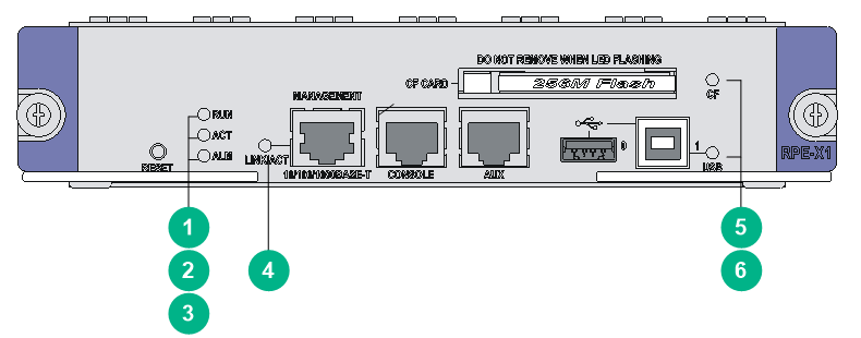

RPE-X1 LEDs |
Run LED (RUN) |
See Table3-2. |
Active LED (ACT) |
Alarm LED (ALM) |
Management Ethernet port LED (LINK/ACT) |
USB port LED (USB) |
CF card LED (CF) |

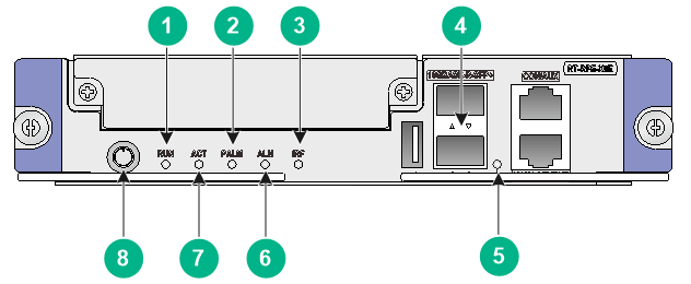

RPE-X5E LEDs |
Run LED (RUN) |
See Table3-5. |
Power alarm LED (PALM) |
IRF LED (IRF) |
10GBASE-R-SFP+ port (SFP+0 and SFP+1) |
Management Ethernet port LED (MANAGEMENT) |
Alarm LED (ALM) |
Active LED (ACT) |
Power button |

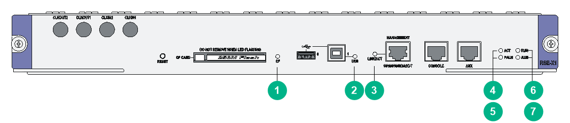

RSE-X1 LEDs |
Run LED (RUN) |
See Table3-6. |
Active LED (ACT) |
Alarm LED (ALM) |
CF card LED (CF) |

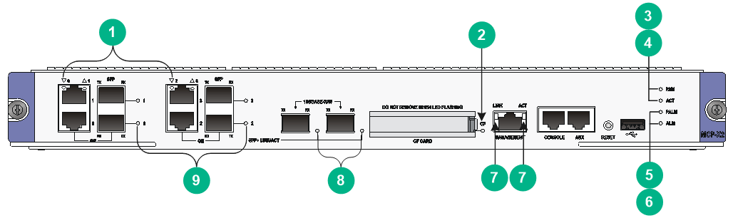

MCP-X2 LEDs |
10/100/1000 Mbps copper Ethernet port LEDs (GE0 through GE3) |
See Table3-8. |
CF card LED (CF) |
Run LED (RUN) |
Active LED (ACT) |
Alarm LED (ALM) |
10 Gbps Ethernet port LED (SFP+LINK/ACT) |
1000 Mbps fiber Ethernet port LED (SFP0 through SFP3) |

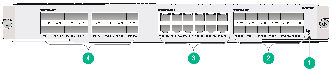

Switching fabric module LEDs |
Run LED (RUN) |
See Table3-9. |

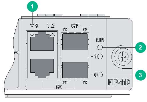

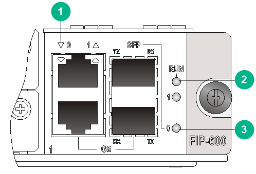

FIP LEDs |
Run LED (RUN) |
See Table3-11. |
10/100/1000 Mbps copper Ethernet port LED (GE0 and GE1) |
1000 Mbps fiber Ethernet port LED (SFP0 and SFP1) |

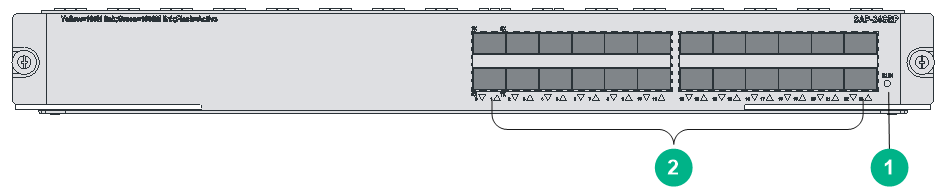

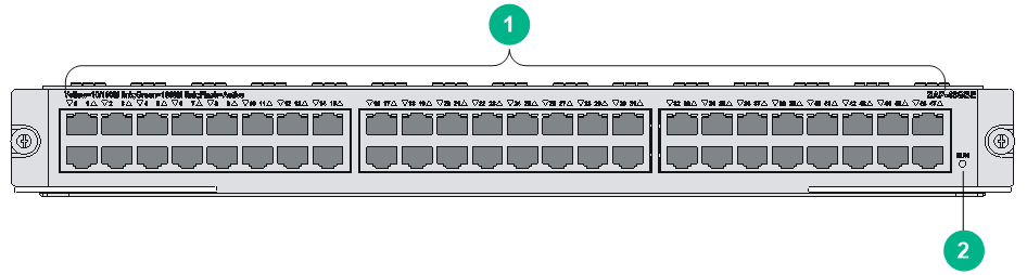

SAP LEDs |
Run LED (RUN) |
10/100/1000 Mbps Ethernet port LED |

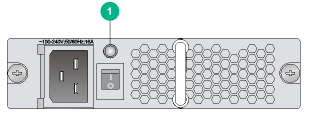

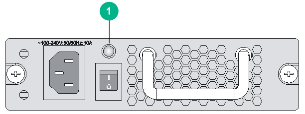

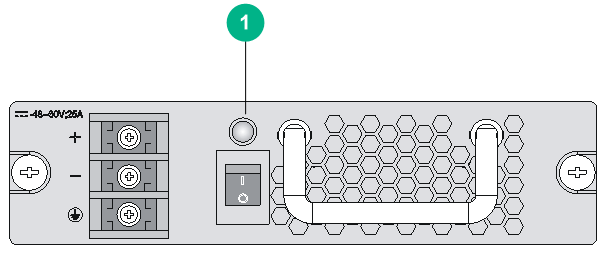

Power module LEDs |
Power LED |
See Table3-24. |

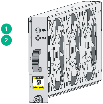

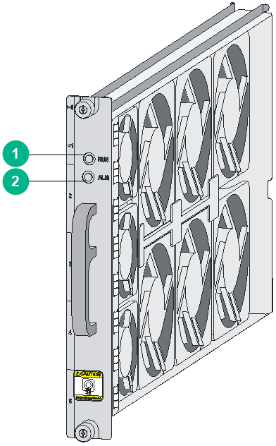

Fan tray LEDs |
Run LED (RUN) |
See Table3-25. |
Alarm LED (ALM) |

Table3-2 RPE-X1 LED description
LED |
Status |
Description |
(green) |
RUN |
Off |
No power input is available, or the RPE-X1 has failed. |
Slow flashing (1 Hz) |
The RPE-X1 is operating correctly. |
Fast flashing (8 Hz) |
The application software is being loaded (in this case, never power off the device or hot-swap the RPE-X1; otherwise the RPE-X1 might be damaged). |
(green) |
ACT |
Off |
The RPE-X1 is in standby state. |
Steady on |
The RPE-X1 is in active state. |
(red) |
ALM |
Off |
The system is operating correctly and no alarm has occurred. |
Steady on |
A fault has occurred on the system or the available power is insufficient. In this state, check the system log immediately. |
A critical fault has occurred to the system. In this state, handle the fault immediately. |
(yellow/green) |
LINK/ACT |
Steady yellow |
A 10/100 Mbps link is present. |
Steady green |
A 1000 Mbps link is present. |
Flashing yellow |
Data is being received or transmitted at 10/100 Mbps. |
Flashing green |
Data is being received or transmitted at 1000 Mbps. |
(green) |
CF |
Off |
No CF card is present or the CF card is not recognizable. |
Steady on |
A CF card is in position and has been detected. |
Flashing |
The system is accessing the CF card. In this state, do not remove the CF card. |
(green) |
USB |
Off |
No host is connected to the device-mode USB port. |
Steady on |
A host is connected to the device-mode USB port. The USB cable can be unplugged in this state. |
Flashing |
Data is being transmitted or received through the device-mode USB port. In this state, do not unplug the USB cable. |

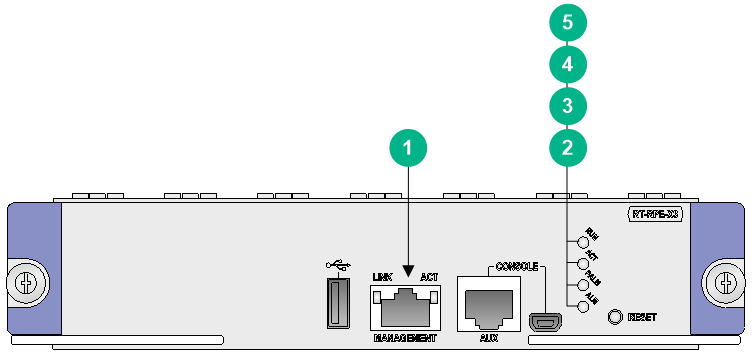

Table3-3 RPE-X3 LED description
LED |
Status |
Description |
(yellow/green) |
LINK/ACT |
Steady yellow |
Steady green |
Flashing yellow |
Flashing green |
(red) |
ALM |
Off |
Steady on |
A fault has occurred on the system. |
A critical fault has occurred to the system. |
(red) |
PALM |
Off |
Steady on |
(green) |
ACT |
Off |
The MPU is in standby state. |
Steady on |
The MPU is in active state. |
(green) |
RUN |
Off |
No power input is available, or the MPU has failed. |
The MPU is operating correctly. |
The system software is being loaded. To avoid damage to the MPU, never power off the device or hot-swap the MPU. |

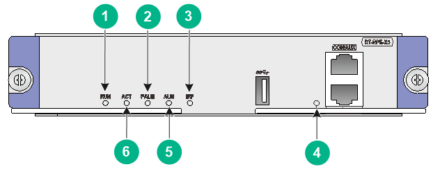

Figure3-3 LEDs on the RPE-X5
Table3-4 RPE-X5 LED description
LED |
Status |
Description |
(yellow/green) |
RUN |
Fast flashing green |
BIOS stage |
The BIOS is operating correctly. |
Slow flashing yellow |
No or insufficient memory or initialization failure. |
Fast flashing yellow |
The extended segment does not exist. |
Off |
Hardware failure or no power input. |
Steady green |
BootWare stage |
The SDRAM is performing self-test. |
The BootWare runs. |
Slow flashing green |
The Comware system has started with the configuration file and the system is operating correctly. |
Steady yellow |
The boot image does not exist. |
The SDRAM has failed the self-test. |
Off |
Comware stage |
The system is operating correctly. |
Fast flashing green (5 seconds) |
USB-based automatic configuration has succeeded. |
(red) |
PALM |
Steady on |
The system power is insufficient. |
Off |
The power system is operating correctly. |
(yellow/green) |
IRF |
The device is in IRF mode and the MPU is the global active MPU. |
Steady green |
The device is in IRF mode and the MPU is a standby MPU. |
Steady yellow |
The device is in IRF mode but the IRF configuration has failed. |
Off |
The device is in standalone mode. |
(yellow/green) |
MANAGEMENT |
Steady green |
Flashing green |
Steady yellow |
A 100 Mbps link is present. |
Flashing yellow |
Data is being received or transmitted at 100 Mbps. |
Off |
No link is present or the port is faulty. |
(red) |
ALM |
Fast flashing (10 seconds) |
USB-based automatic configuration has failed. |
Steady on |
Off |
(green) |
ACT |
Steady on |
Off |

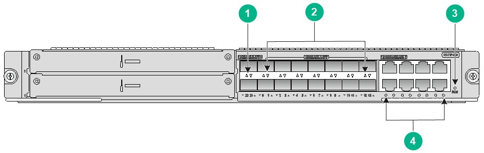

Figure3-4 LEDs on the RPE-X5E
Table3-5 RPE-X5E LED description
LED |
Status |
Description |
(yellow/green) |
RUN |
BIOS stage |
Off |
Steady green |
BootWare stage |
Steady yellow |
Off |
Comware stage |
(red) |
PALM |
Steady on |
Off |
(yellow/green) |
IRF |
Steady green |
Steady yellow |
Off |
(green) |
SFP+0 and SFP+1 |
Steady green |
NOTE: After a link is set up, using the command to bring up or shut down the port does not change the LED status. |
A 10 Gbps link is present. |
Flashing green |
Data is being received or transmitted at 10000 Mbps. |
Off |
No link is present. |
(yellow/green) |
MANAGEMENT |
Steady green |
Flashing green |
Steady yellow |
Flashing yellow |
Off |
(red) |
ALM |
Steady on |
Off |
(green) |
ACT |
Steady on |
Off |
(red/green) |
Power button |
Fast flashing red |
The MPU has been powered up to start up the Comware system. |
Slow flashing red |
The BIOS is starting up. |
The BootWare is starting up. |
Steady green |
The Comware system starts up and is operating correctly. |
The power button has been pressed and the Comware system starts to shut down. |
Steady red |
The shutdown of the Comware system is in progress. |
Off |
The Comware system has shut down. |
Table3-6 RSE-X1 LED description
LED |
Status |
Description |
(green) |
CF |
Off |
Steady on |
Flashing |
(green) |
USB |
Off |
Steady on |
Flashing |
LINK/ACT |
Steady yellow |
Steady green |
Flashing yellow |
Flashing green |
(green) |
ACT |
Off |
The RSE-X1 is in standby state. |
Steady on |
The RSE-X1 is in active state. |
(red) |
PALM |
Off |
The system power module is normal. |
Steady on |
(green) |
RUN |
Off |
No power input is available, or the RSE-X1 has failed. |
The RSE-X1 is operating correctly. |
The application software is being loaded (in this case, never power off the device or hot-swap the RSE-X1; otherwise the RSE-X1 might be damaged). |
(red) |
ALM |
Off |
Steady on |
Table3-7 MCP-X1 LED description
LED |
Status |
Description |
(yellow/green) |
GE0 through GE3 |
Off |
The corresponding interface is not connected. |
Steady green |
Flashing green |
Steady yellow |
Flashing yellow |
(yellow/green) |
CF |
Off |
Steady green |
Flashing green |
Steady yellow |
A CF card not provided by H3C. |
(green) |
RUN |
Off |
No power input is available, or the MCP-X1 has failed. |
The MCP-X1 is operating correctly. |
The application software is being loaded (in this case, never power off the device or hot-swap the MCP-X1; otherwise the MCP-X1 might be damaged). |
(green) |
ACT |
Off |
The MCP-X1 is in standby state. |
Steady on |
The MCP-X1 is in active state. |
(red) |
PALM |
Off |
Steady on |
(red) |
ALM |
Off |
Steady on |
LINK |
Off |
Steady green |
Steady yellow |
ACT |
Off |
No data is being received or transmitted. |
Flashing yellow |
Data is being received or transmitted. |
(yellow/green) |
SFP0 through SFP3 |
Off |
Steady green |
Flashing green |
Steady yellow |
Flashing yellow |
Table3-8 MCP-X2 LED description
LED |
Status |
Description |
(yellow/green) |
GE0 through GE3 |
Off |
Steady green |
Flashing green |
Steady yellow |
Flashing yellow |
(yellow/green) |
CF |
Off |
Steady green |
Flashing green |
Steady yellow |
(green) |
RUN |
Off |
(green) |
ACT |
Off |
Steady on |
(red) |
PALM |
Off |
Steady on |
(red) |
ALM |
Off |
Steady on |
LINK |
Off |
Steady green |
Steady yellow |
ACT |
Off |
Flashing yellow |
SFP+LINK/ACT |
Off |
Steady green |
Flashing green |
Data is being received or transmitted at 10 Gbps. |
Steady yellow |
Transceiver module check has failed. |
(yellow/green) |
SFP0 through SFP3 |
Off |
Steady green |
Flashing green |
Steady yellow |
Flashing yellow |

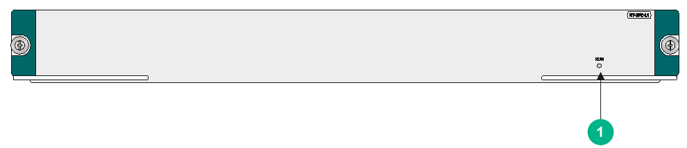

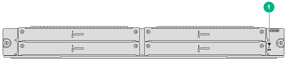

Figure3-8 SFE-L1 status LED
Figure3-9 SFE-L2 status LED
Table3-9 SFE-L1 LED description
LED |
Status |
Description |
(green) |
RUN |
Off |
No link is present or the module is faulty. |
The module is operating correctly. |
Application software is being loaded. To avoid damage to the module, do not power off the device or hot-swap the module while the application software is being loaded. |

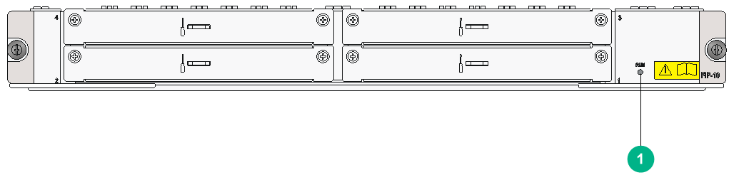

FIP LEDs
Table3-10 FIP-10/20 LED description
LED |
Status |
Description |
(green) |
RUN |
Off |
No link is present or the FIP is faulty. |
The FIP is operating correctly. |
System software is being loaded. To avoid damage to the FIP, never power off the device or hot-swap the FIP while the system software is being loaded. |

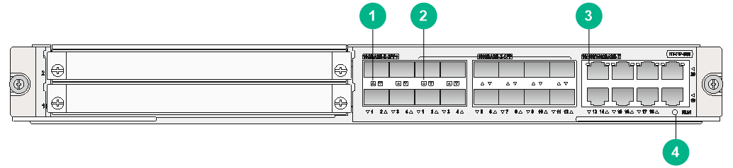

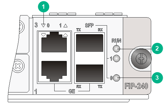

Table3-11 FIP-110/210/240/600 LED description
LED |
Status |
Description |
(yellow/green) |
10/100/1000 Mbps copper Ethernet port |
Off |
Steady green |
Flashing green |
Steady yellow |
Flashing yellow |
(green) |
RUN |
Off |
No power input is available or the FIP has failed. |
(yellow/green) |
1000 Mbps fiber Ethernet port LED |
Off |
Steady green |
A link is present. |
Flashing green |
Data is being sent or received at 1000 Mbps. |
Steady yellow |
The transceiver module failed to be detected. |

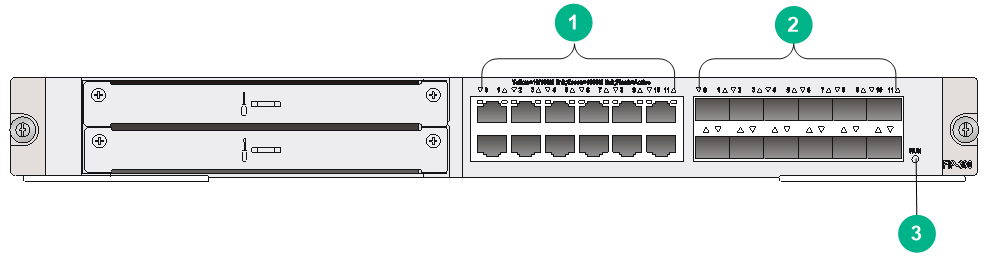

(yellow/green) |
GE0 through GE3 |
Off |
Steady green |
Flashing green |
Steady yellow |
Flashing yellow |
(yellow/green) |
SFP0 through SFP3 |
Off |
Steady green |
Flashing green |
Steady yellow |
POST has failed. |
(green) |
RUN |
Off |
(yellow/green) |
SFP+ |
Off |
Steady green |
Flashing green |
Steady yellow |
POST has failed. |
Figure3-19 FIP-380 LEDs
Table3-15 FIP-380 LED description
LED |
Status |
Description |
(yellow/green) |
SFP+22 and SFP+23 |
Off |
No link is present or the port has failed. |
Steady yellow |
Flashing yellow (8 Hz) |
Steady green |
Flashing green (8 Hz) |
(yellow/green) |
SFP0 through SFP3 |
Off |
Steady yellow |
Steady green |
(green) |
RUN |
Off |
No power input is available or the FIP-380 has failed. |
System software is being loaded. |
Steady green |
The FIP software system is starting up. |
(yellow/green) |
GE14 through GE21 |
Off |
Steady yellow |
Steady green |
Figure3-20 FIP-660 LEDs
Table3-16 FIP-660 LED description
LED |
Status |
Description |
(green) |
RUN |
Off |
No power input is available or the FIP-660 has failed. |
Steady green |
Figure3-21 FIP-680 LEDs
Table3-17 FIP-680 LED description
LED |
Status |
Description |
(green) |
SFP1 through SFP12 |
Off |
Steady green |
Flashing green |
(green) |
SFP+1 through SFP+4 |
Off |
Steady green |
Flashing green |
(yellow/green) |
GE13 through GE20 |
Off |
Steady green |
Flashing green |
Steady yellow |
Flashing yellow |
(green) |
Module status LED (RUN) |
Off |
System software is being loaded. To avoid damage to the FIP, never power off the device or hot-swap the FIP when the system software is being loaded. |

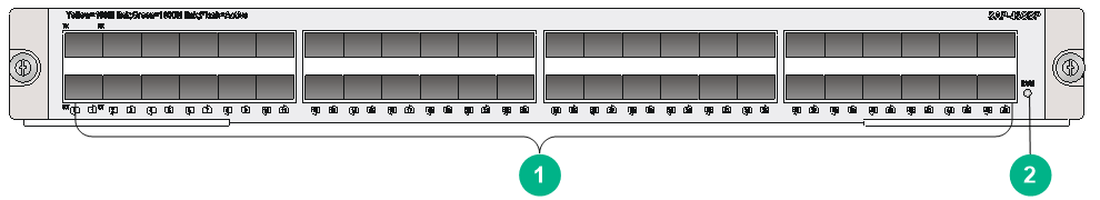

SAP LEDs
Figure3-22 SAP LEDs(SAP-48GBE)

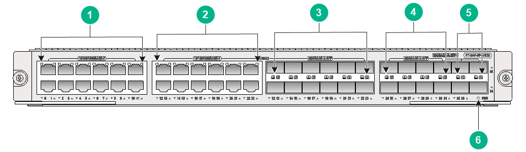

Table3-18 SAP-48GBE LED description
Item |
Status |
Description |
(yellow/green) |
Status LEDs of GE 0 through GE 47 |
Off |
Steady green |
Flashing green |
Steady yellow |
Flashing yellow |
(green) |
RUN |
Off |
No power input is available or the SAP-48GBE has failed. |
The SAP-48GBE is operating correctly. |
Application program is being loaded (in this case, never power off the device or hot-swap the SAP-48GBE; otherwise, the SAP-48GBE might be damaged), or the SAP-48GBE is not operating. |
Figure3-23 SAP LEDs (SAP-24GBP)
Table3-19 SAP-24GBP LED description
LED |
Status |
Description |
(green) |
RUN |
Off |
No power input is available or the SAP-24GBP has failed. |
The SAP-24GBP is operating correctly. |
Application program is being loaded (in this case, never power off the device or hot-swap the SAP-24GBP; otherwise, the SAP-24GBP might be damaged), or the SAP-24GBP is not operating. |
(yellow/green) |
Status LEDs of SFP 0 to SFP 23 |
Off |
Steady green |
Flashing green |
Steady yellow |
Flashing yellow |
Figure3-24 SAP LEDs (SAP-48GBP)
Table3-20 SAP-48GBP LED description
LED |
Status |
Description |
(yellow/green) |
Status LEDs of SFP 0 to SFP 47 |
Off |
Steady green |
Flashing green |
Steady yellow |
Flashing yellow |
(green) |
System status LED |
Off |
No power input is available or the SAP-48GBP has failed. |
The SAP-48GBP is operating correctly. |
Application program is being loaded (in this case, never power off the device or hot-swap the SAP-48GBP; otherwise, the SAP-48GBP might be damaged), or the SAP-48GBP is not working. |
Table3-21 SAP-20GE2XP LED description
LED |
Status |
Description |
(green) |
RUN |
Off |
No power input is available or the SAP-20GE2XP has failed. |
The SAP-20GE2XP is operating correctly. |
System software is being loaded or the SAP-20GE2XP is not operating. To avoid hardware damage, do not power off the router, or insert or remove the SAP-20GE2XP when system software is being loaded. |
(yellow/green) |
Status LEDs for SFP+ port 0 and SFP+ port 1 |
Off |
Steady green |
Flashing green |
Steady yellow |
The transceiver module has failed to be detected. |
(yellow/green) |
Status LEDs for fiber combo ports GE16 to GE19 |
Off |
Steady green |
Flashing green |
Steady yellow |
Flashing yellow |
(yellow/green) |
Status LEDs for copper combo ports GE16 to GE19 |
Off |
Steady green |
Flashing green |
Steady yellow |
Flashing yellow |
(yellow/green) |
Status LEDs for SFP ports GE0 to GE15 |
Off |
Steady green |
Flashing green |
Steady yellow |
Flashing yellow |
Table3-22 SAP-28GE LED description
LED |
Status |
Description |
(green) |
RUN |
Off |
No power input is available or the SAP-28GE has failed. |
The SAP-28GE is operating correctly. |
System software is being loaded or the SAP-28GE is not operating. To avoid hardware damage, do not power off the router, or insert or remove the SAP-28GE when system software is being loaded. |
(yellow/green) |
Status LEDs for fiber combo ports GE16 to GE27 |
Off |
Steady green |
Flashing green |
Steady yellow |
Flashing yellow |
(yellow/green) |
Status LEDs for copper combo ports GE16 to GE27 |
Off |
Steady green |
Flashing green |
Steady yellow |
Flashing yellow |
(yellow/green) |
Off |
Steady green |
Flashing green |
Steady yellow |
Flashing yellow |
Figure3-27 SAP-XP4GE32 LEDs
Table3-23 SAP-XP4GE32 LED description
LED |
Status |
Description |
(yellow/green) |
· GE0 through GE11 · GE12 through GE23 (copper combo port) |
Off |
No power input is available or the port has failed. |
Steady yellow |
Steady green |
(yellow/green) |
· SFP12 through SFP23 (fiber combo port) · SFP24 through SFP31 |
Off |
Steady yellow |
Steady green |
SFP+32 through SFP+35 |
Off |
Steady green |
(green) |
RUN |
Off |
No power input is available or the SAP-XP4GE32 has failed. |
HIM/MIM/MIC/MIC-X LEDs

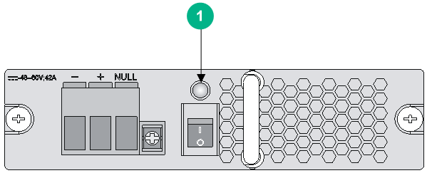

Power module LEDs
Figure3-28 PSR650-A AC power module LED
Figure3-29 PSR1200-A AC power module LED
Figure3-30 PSR650-D DC power module LED
Figure3-31 PSR1200-D DC power module LED
Table3-24 AC/DC power LED description
LED |
Status |
Description |
Power LED |
Steady green |
The power module is operating correctly. |
Steady red |
The power module is faulty. |
Off |
No power is input. |
Fan tray LEDs
Figure3-32 Fan tray for the SR6604
Figure3-33 Fan tray for the SR6608
Table3-25 Fan tray LED description
LED |
Status |
Description |
(green) |
RUN |
Off |
The system is powered off or the fan tray is faulty. |
Steady on |
The fan tray is operating correctly. |
(red) |
ALM |
Off |
Steady on |
The fan tray is faulty. |
