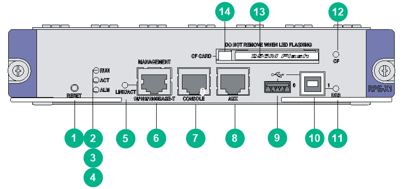

RPE-X1
Figure2-1 RPE-X1 MPU
(1) Reset button (RESET)
(2) RUN LED
(3) Active/Standby LED (ACT)
(4) Alarm LED (ALM)
(5) LINK/ACT LED for the Ethernet management port
(6) Management Ethernet port (MANAGEMENT)
(7) Console port (CONSOLE)
(8) AUX port (AUX)
(9) Host-mode USB port 0 (0)
(10) Device-mode USB port 1 (1)
(11) USB 1 LED
(12) CF card LED
(13) CF card
(14) CF card button

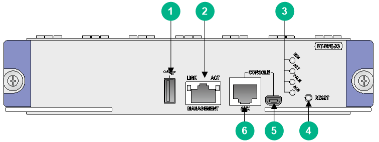

RPE-X3
Figure2-2 RPE-X3 MPU
(1) USB port
(2) Management Ethernet port (MANAGEMENT)RUN LED
(3) MPU status LEDs
(4) Reset button (RESET)
(5) USB console port
(6) Console/AUX port (CONSOLE/AUX)

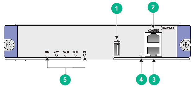

RPE-X5
CAUTION
CAUTION:
If you connect a large-sized USB drive directly to the RPE-X5 MPU, the right ejector lever of the MPU might be damaged. You must use a USB extension cable to connect a large-sized USB drive to the USB port on the MPU.
Figure2-3 RPE-X5 MPU
(1) USB port
(2) Console/AUX port
(3) Management Ethernet port (MANAGEMENT)
(4) Management Ethernet port LED
(5) MPU status LEDs
Table2-3 RPE-X5 specifications

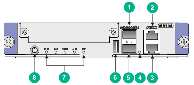

RPE-X5E
CAUTION
CAUTION:
If you connect a large-sized USB drive directly to the RPE-X5E MPU, the right ejector lever of the MPU might be damaged. You must use a USB extension cable to connect a large-sized USB drive to the USB port on the MPU.
The Ethernet fiber ports SFP+0 and SFP+1 on the RPE-X5E MPU are only used for virtual machine services and do not support Layer 2 or Layer 3 forwarding. For information about how to use these two fiber ports, see H3C SR6600 Router Series VM Deployment Guide.
Figure2-4 RPE-X5E MPU
(1) 10GBASE-R-SFP+ port (SFP+1)
(5) 10GBASE-R-SFP+ port (SFP+0)
(6) USB port
(7) MPU status LEDs
(8) Power button
Table2-4 RPE-X5E specifications

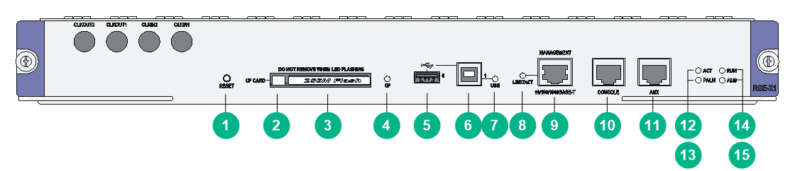

RSE-X1
Figure2-5 RSE-X1 MPU
(2) CF card button
(3) CF card
(4) CF card LED
(5) Host-mode USB port 0 (0)
(6) Device-mode USB port 1 (1)
(7) USB 1 LED
(8) LINK/ACT LED for the Ethernet management port
(9) Management Ethernet port (MANAGEMENT)
(10) Console port (CONSOLE)
(11) AUX port (AUX)
(12) Active/Standby LED (ACT)
(13) Power alarm LED (PALM)
(14) RUN LED
(15) System alarm LED (ALM)

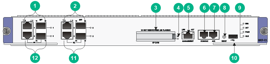

MCP-X1/MCP-X2

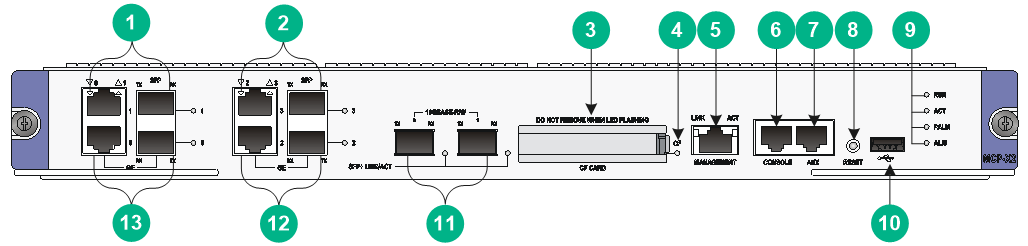

Figure2-6 MCP-X1
(1) Combo interface 1
(2) Combo interface 3
(3) CF card slot (CF CARD)
(4) CF card LED (CF)
(5) Management Ethernet port (MANAGEMENT)
(6) Console port (CONSOLE)
(7) AUX port (AUX)
(8) Reset button (RESET)
(9) MCP-X1 status LED
(10) USB port
(11) Combo interface 2
(12) Combo interface 0
Figure2-7 MCP-X2
(7) AUX port (AUX)
(9) MCP-X2 status LED
(10) USB port
(11) 10 Gbps Ethernet port
(12) Combo interface 2
(13) Combo interface 0
Table2-6 MCP specifications
Item
Specification
Flash
8 MB
Memory type and size
·     MCP-X1
·     Default—One 2-GB DDR3 SDRAM
·     Maximum—Two 2-GB DDR3 SDRAMs
·     MCP-X2
·     Default—Two 2-GB DDR3 SDRAMs
NVRAM
128 KB
Combo interfaces
4
Copper ports (automatic MDI/MDI-X)
10 Mbps, half/full-duplex
100 Mbps, half/full-duplex
Fiber ports
1000 Mbps, full-duplex
10 Gbps Ethernet ports
·     MCP-X1—None
·     MCP-X2—2
Console port
1
9600 bps (default) to 115200 bps
AUX port
1
1 (10Base-T/100Base-TX/1000Base-T)
CF card
·     1 GB by default for the built-in CF card
·     256 MB, 512 MB, or 1 GB for an optional external CF card (CF cards less than 256 MB are not supported)
USB port
1 (USB 0: Type A connector, operating in the host mode)
Reset button
1
Dimensions (H × W × D)
45 × 399 × 412 mm (1.77 × 15.71 × 16.22 in)
Power consumption
53 W
Hot swapping
Supported

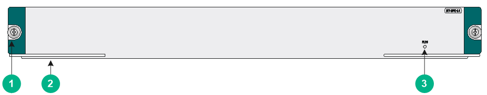

Figure2-8 SFE-L1 front panel
(1) Captive screw
(2) Ejector lever
(3) Switching fabric module status LED (RUN)

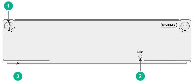

SFE-L2
Front panel
Figure2-9 SFE-L2 front panel
(1) Captive screw
(2) Switching fabric module status LED (RUN)
(3) Ejector lever

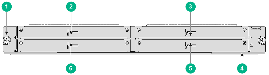

Front panel

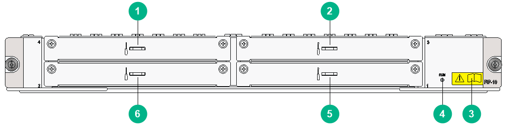

Figure2-10 FIP-10 front panel
(1) Slot 4
(2) Slot 3
(3) OPEN BOOK mark
(4) Status LED (RUN)
(5) Slot 1
(6) Slot 2
The OPEN BOOK mark indicates that the operator must read the following document before working with the FIP:

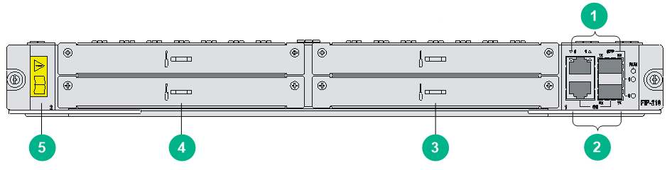

Front panel
Figure2-13 FIP-210 front panel
(2) Combo interface 0
(3) Slot 1
(4) Slot 2
(5) OPEN BOOK mark

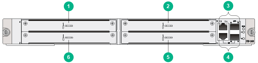

FIP-240
The FIP-240 provides two combo interfaces. It supports HIMs, MIMs, or a mix of HIMs and MIMs.
Front panel
Figure2-14 FIP-240 front panel
(1) Slot 4
(2) Slot 3
(3) Combo interface 1
(4) Combo interface 0
(5) Slot 1
(6) Slot 2
Technical specifications

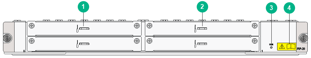

Supported
Hot swapping
Supported
Combo interface specifications
Specifications of combo interfaces on the FIP-240 and the FIP-110 are the same. For more information, see Table2-19 and Table2-20.
FIP-260
A FIP-260 provides four MIC-X interface module slots.
Front panel
Figure2-15 FIP-260 front panel
(1) Captive screw
(2) Slot 4
(3) Slot 3
(4) Ejector lever
(5) Slot 1
(6) Slot 2

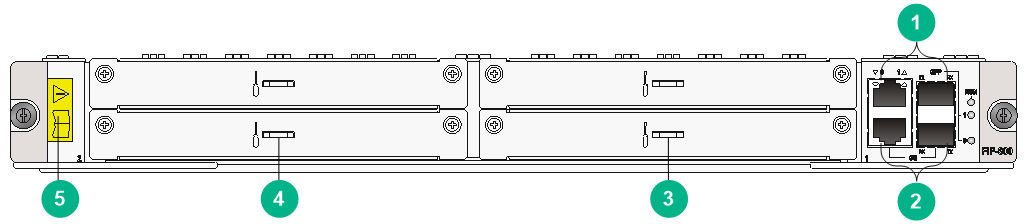

FIP-300
The FIP-300 provides twelve combo interfaces. It supports HIMs, MIMs, or a mix of HIMs and MIMs.

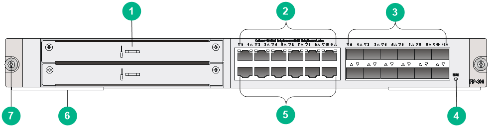

Front panel
Figure2-16 FIP-300 front panel
(1) HIM/MIM slot
(2) GE0 through GE11 copper port status LEDs
(3) GE0 through GE11 fiber ports
(4) RUN LED
(5) GE0 through GE11 copper ports
(6) Ejector lever
(7) Captive screw

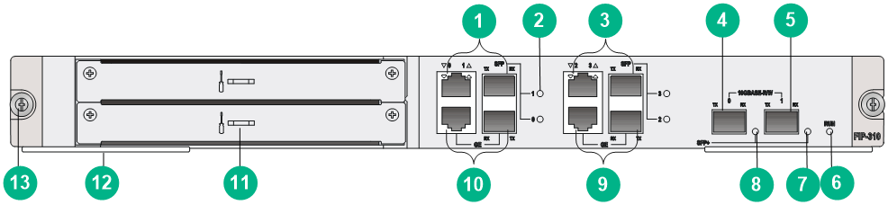

Figure2-17 FIP-310 front panel
(2) Combo interface status LED
(3) Combo interface 3
(4) SFP+ port 0
(5) SFP+ port 1
(6) RUN LED
(7) SFP+ port 1 status LED
(8) SFP+ port 0 status LED
(9) Combo interface 2
(10) Combo interface 0
(11) HIM/MIM slot
(12) Ejector lever
(13) Captive screw

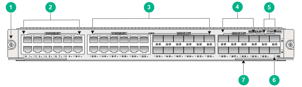

FIP-380

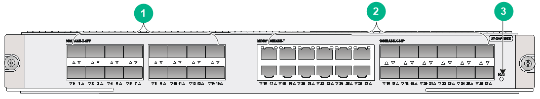

A FIP-380 delivers high-speed service processing capability. It provides two 10GBASE-R-SFP+ ports, fourteen 1000BASE-X-SFP ports, and eight 100/1000BASE-T copper ports. It supports MIC-X interface modules.

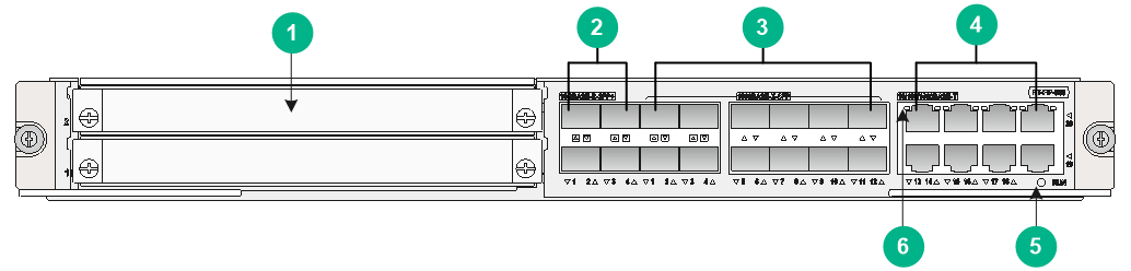

Front panel
Figure2-18 FIP-380 front panel
(1) Captive screw
(2) Slot 2
(3) 10GBASE-R-SFP+ ports SFP+22 and SFP+23
(4) 1000BASE-X-SFP ports SFP0 to SFP13
(5) 100/1000 BASE-T Ethernet copper ports GE14 to GE21
(6) Ejector lever
(7) Slot 1
Item
Specification
8GB DDR4
Drive
(Optional) 512 GB mSATA SSD
The mSATA hard disk with SSC enabled is not supported on the FIP-380.

MIM
Not supported
MIC
Not supported
MIC-X
A maximum of 2
Hardware encryption
Supported
Hot swapping
Supported
10GBASE-R-SFP+ port specifications
Table2-23 FIP-380 10GBASE-R-SFP+ port specifications
Item
Specification
Connector
LC
Transceiver module type
SFP+
Interface standards
802.3ae
Duplex mode
10 Gbps, full duplex
1000BASE-X-SFP port specifications
Table2-24 FIP-380 1000BASE-X-SFP port specifications
Item
Specification
Connector
LC
SFP
Interface standards
802.3, 802.3u, and 802.3ab
Duplex mode
1000 Mbps, full duplex
100/1000BASE-T Ethernet copper port specifications
Table2-25 FIP-380 100/1000BASE-T Ethernet copper port specifications
Item
Specification
Connector
RJ-45
Interface type
Autosensing
Interface speed and duplex mode
100 Mbps
Full duplex, auto-negotiation
1000 Mbps
FIP-600
The FIP-600 provides four combo interfaces. It supports a maximum of two HIMs.
Front panel
Figure2-19 FIP-600 front panel
(3) Slot 1
(4) Slot 2
(5) OPEN BOOK mark
Item
Specification
Flash
8 MB
The SDRAMs must be used in pairs and must be the same size.
They must be inserted in slot 1 or slot 3. These two slots are located near the backplane connectors on the FIP module.
NVRAM
128 KB
Combo interfaces
2
2 copper ports (automatic MDI/MDIX)
2 fiber ports
HIM
2
MIM
Not supported
MIC
Not supported
Hardware encryption
Supported
Hot-swapping
Supported

FIP-660
A FIP-660 provides four MIC-X interface module slots. When installing a FIP-660, if a service module slot adjacent to the FIP-660 is empty, install an air deflector over the slot. For information about installing an air deflector, see H3C SR6604[6608] Routers Installation Guide.
Front panel
Figure2-20 FIP-660 front panel
(1) Captive screw
(2) Slot 4
(3) Slot 3
(4) Ejector lever
(5) Slot 1
(6) Slot 2

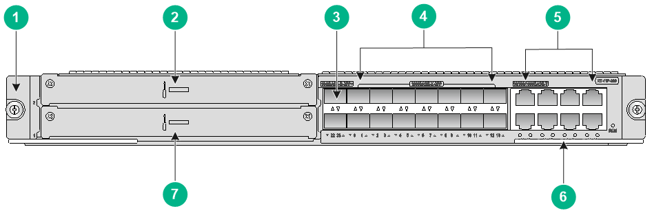

FIP-680
The FIP-680 provides 4 SFP+ ports, 12 SFP ports, and 8 copper GE ports. It supports a maximum of two MICs.
Front panel
Figure2-22 FIP-680 front panel
(1) Interface module slot
(2) 10GBASE-R-SFP+ ports (4 in total)
(3) 1000BASE-X-SFP ports (12 in total)
(4) 10/100/1000BASE-T copper Ethernet ports (8 in total)
(5) Module status LED (RUN)
(6) 10/100/1000BASE-T copper Ethernet port status LED
Item
Specification
·     Default—Two 4-GB DDR3 SDRAMs
·     Maximum—Two 4-GB DDR3 SDRAMs
NVRAM
128 KB
10GE fiber ports (SFP+)
4
GE fiber ports (SFP)
12
Copper Ethernet ports
8
10/100/1000M autosensing
HIM
Not supported
MIM
Not supported
MIC
2
Hardware encryption
Supported
Hot-swapping
Supported

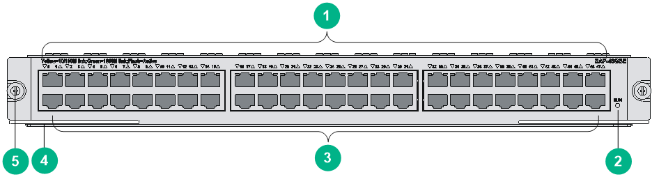

SAP-48GBE
The SAP-48GBE has 48 high-performance RJ-45 ports that can be both routed and switched. One two-color LED is available for each port to indicate their activity and link status. The module also has a RUN LED to indicate the module operating status.
Front panel
Figure2-23 SAP-48GBE front panel
(1) LEDs for GE ports 0 to 47
(2) SAP module status LED (RUN)
(3) GE ports 0 to 47
(4) Ejector levers
(5) Captive screw
Item
Specification
Flash
4 MB
·     Default—Two 1-GB DDR2 SDRAMs
·     Maximum—Two 2-GB DDR2 SDRAMs
NVRAM
128 KB
Max power consumption
200 W
Connector type
RJ-45
Number of interfaces
48
Interface standards
Interface type
Automatic MDI/MDIX
Cable type
Straight-through/crossover Ethernet cable
Transmission distance
100 m (328.08 ft)
Supported frame format
Ethernet_II
Ethernet_SNAP
10 Mbps
Full/half duplex, auto-negotiation
100 Mbps
1000 Mbps

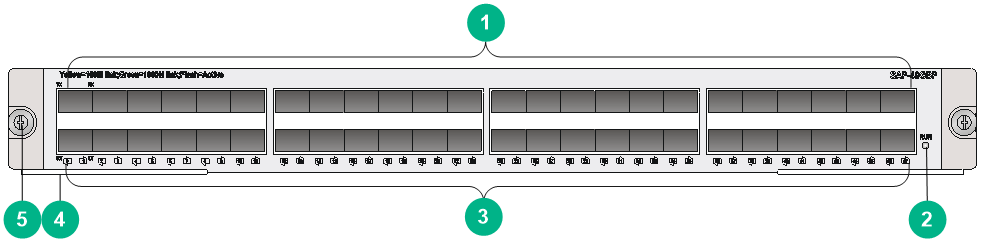

SAP-48GBP
The SAP-48GBP has 48 high-performance fiber SFP ports that can be both routed and switched. One two-color LED is available for each port to indicate their activity and link status. The module also has a RUN LED to indicate the module operating status.
Front panel
Figure2-25 SAP-48GBP front panel
(1) SFP ports 0 to 47
(3) LEDs for SFP ports 0 to 47
(4) Ejector levers
(5) Captive screw
Item
Specification
Flash
4 MB
NVRAM
128 KB
144 W
Connector type
SFP
48
Interface standards
Ethernet_II
Ethernet_SNAP
Interface speed
1000 Mbps (recommended)
Full duplex
Fixed Ethernet port specifications
Specifications of the SAP-48GBP fixed Ethernet ports and the FIP-110 fiber combo ports are the same. For more information, see Table2-20.

SAP-XP4GE32
Front panel
Figure2-28 SAP-XP4GE32 front panel
(1) Captive screw
(2) 10/100/1000Base-T Ethernet copper ports GE0 to GE11
(3) Combo interfaces GE12 to GE23
(4) 1000BASE-X-SFP ports SFP24 to SFP31
(5) 10GBASE-R-SFP+ ports SFP+32 to SFP+35
(6) Operating status LED (RUN)
(7) Ejector lever

Service module

RPE-X3
RPE-X5
RPE-X5E
RSE-X1
MCP-X1
MCP-X2
FIP-10
FIP-20
FIP-110
FIP-210
FIP-240
FIP-260
FIP-300
FIP-310
FIP-380
FIP-600
FIP-660
FIP-680
SAP-48GBE
SAP-24GBP
SAP-48GBP
SAP-20GE2XP
SAP-28GE
SAP-XP4GE32

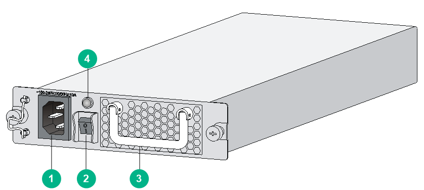

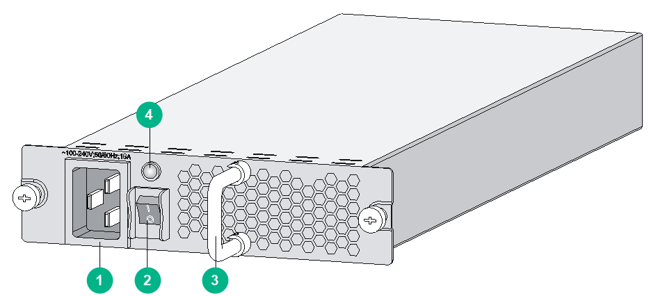

PSR650-A
Figure2-29 PSR650-A view
(1) AC-input power receptacle
(2) Power switch
(3) Handle
(4) Status LED
Table2-40 PSR650-A specifications
Item
Specification
Rated input voltage
100 VAC to 240 VAC @ 50 or 60 Hz
Maximum input current
10 A
Maximum power
650 W
PSR1200-A
Figure2-30 PSR1200-A view
(2) Power switch
(3) Handle
(4) Status LED
Table2-41 PSR1200-A specifications
Item
Specification
Rated input voltage
16 A
Maximum power
1213 W

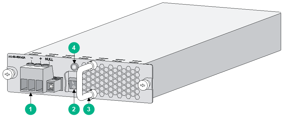

DC power supplies
PSR650-D
Figure2-31 PSR650-D view
(1) DC-input terminal block
(2) Power switch
(3) Handle
(4) Status LED
Table2-42 PSR650-D specifications
Item
Specification
Rated input voltage
–48 VDC to –60 VDC
25 A
Maximum power
650 W

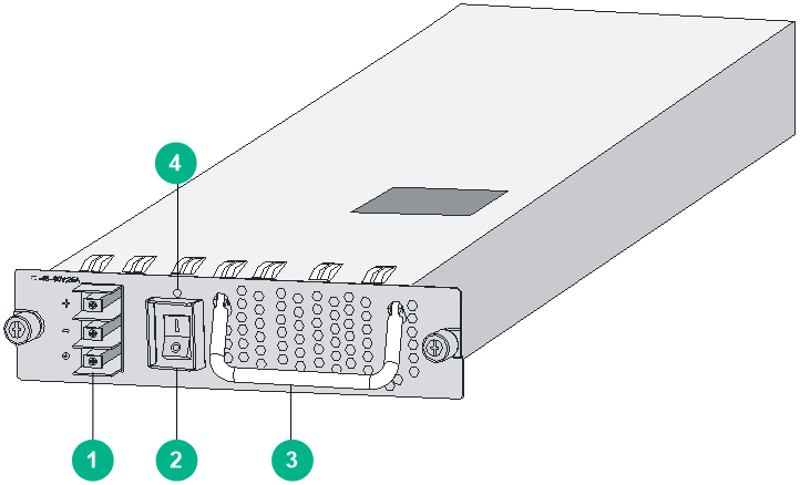

PSR1200-D
Figure2-32 PSR1200-D view
(1) Connector
(2) Power switch
(3) Handle
(4) Status LED
Table2-43 PSR1200-D specifications
Item
Specification
Rated input voltage
–48 VDC to –60 VDC
42 A
Maximum power
1213 W

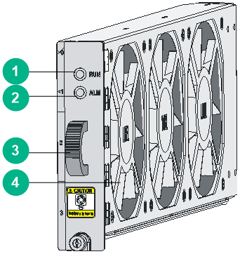

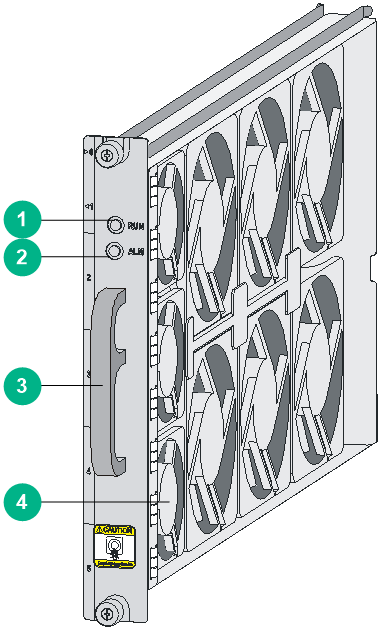

Fan trays
The fan tray structures of the SR6604 and SR6608 are similar.
Figure2-33 SR6604 fan tray
Figure2-34 SR6608 fan tray
(1) Fan tray status LED (RUN)
(2) Alarm LED (ALM)
(3) Handle
(4) Fans
Table2-44 Fan tray specifications
Fan (built-in)
Specification
SR6604
SR6608
Rated voltage
12 VDC
Automatic fan speed adjustment
Supported
136.4 × 31 × 427.8 mm (5.37 ×1.22 × 16.84 in)
228 × 31 × 413.3 mm (8.98 ×1.22 × 16.27 in)
Failsafe
Supported
Hot swapping
Supported
