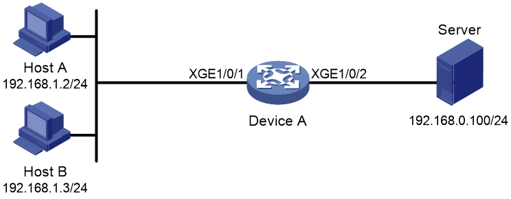

Network requirements
As shown in Figure 1, configure an ACL on Device A to allow Host A to access the server only during 8:00 and 18:00 on working days from June 2015 to the end of the year.
Figure 1 Network diagram
Configuration procedure
# Create a periodic time range during 8:00 and 18:00 on working days from June 2015 to the end of the year.
<DeviceA> system-view
[DeviceA] time-range work 8:0 to 18:0 working-day from 0:0 6/1/2015 to 24:00 12/31/2015
# Create an IPv4 basic ACL numbered 2001, and configure a rule in the ACL to permit packets only from 192.168.1.2/32 during the time range work.
[DeviceA] acl basic 2001
[DeviceA-acl-ipv4-basic-2001] rule permit source 192.168.1.2 0 time-range work
[DeviceA-acl-ipv4-basic-2001] rule deny source any time-range work
[DeviceA-acl-ipv4-basic-2001] quit
# Apply IPv4 basic ACL 2001 to filter outgoing packets on Ten-GigabitEthernet 1/0/2.
[DeviceA] interface ten-gigabitethernet 1/0/2
[DeviceA-Ten-GigabitEthernet1/0/2] packet-filter 2001 outbound
[DeviceA-Ten-GigabitEthernet1/0/2] quit
# Verify that the time range work is active on Device A.
[DeviceA] display time-range all
Current time is 13:58:35 6/29/2015 Friday
Time-range : work ( Active )
 08:00 to 18:00 working-day
 from 00:00 6/1/2015 to 00:00 1/1/2016
