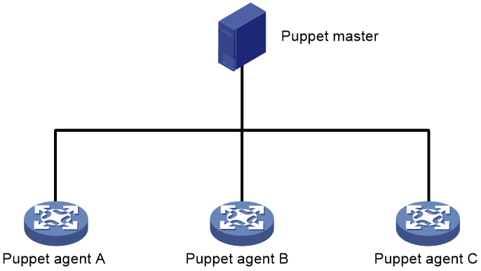

Puppet network framework
Figure 1 Puppet network framework
As shown in Figure 1, Puppet operates in a client/server network framework. In the framework, the Puppet master (server) stores configuration manifests for Puppet agents (clients). The Puppet agents establish SSL connections to the Puppet master to obtain their respective latest configurations.
Puppet master
The Puppet master runs the Puppet daemon process to listen to requests from Puppet agents, authenticates Puppet agents, and sends configurations to Puppet agents on demand.
For information about installing and configuring a Puppet master, access the official Puppet website at https://puppetlabs.com/.
Puppet agent
H3C devices support Puppet 3.7.3 agent. The following is the communication process between a Puppet agent and the Puppet master:
1.     The Puppet agent sends an authentication request to the Puppet master.
2.     The Puppet agent checks with the Puppet master for the authentication result periodically (every two minutes by default). Once the Puppet agent passes the authentication, a connection is established to the Puppet master.
3.     After the connection is established, the Puppet agent sends a request to the Puppet master periodically (every 30 minutes by default) to obtain the latest configuration.
4.     After obtaining the latest configuration, the Puppet agent compares the configuration with its running configuration. If a difference exists, the Puppet agent overwrites its running configuration with the newly obtained configuration.
5.     After overwriting the running configuration, the Puppet agent sends a feedback to the Puppet master.

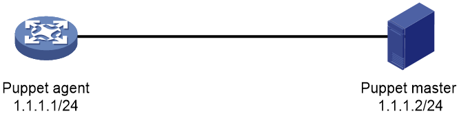

As shown in Figure 2, the device is connected to the Puppet master. Use Puppet to configure the device to perform the following operations:
·     Set the SSH login username and password to user and passwd, respectively.
·     Create VLAN 3.
Figure 2 Network diagram
1.     Configure SSH login and enable NETCONF over SSH on the device. (Details not shown.)
2.     On the Puppet master, create the modules/custom/manifests directory in the /etc/puppet/ directory for storing configuration manifests.
$ mkdir -p /etc/puppet/modules/custom/manifests
3.     Create configuration manifest init.pp in the /etc/puppet/modules/custom/manifests directory as follows:
netdev_device{'device':
 ensure => undo_shutdown,
 username => 'user',
 password => 'passwd',
 ipaddr => '1.1.1.1',
netdev_vlan{'vlan3':
 id => 3,
 require => Netdev_device['device'],
4.     Start Puppet on the device.
<PuppetAgent> system-view
[PuppetAgent] third-part-process start name puppet arg agent --certname=1.1.1.1 --server=1.1.1.2
5.     Configure the Puppet master to authenticate the request from the Puppet agent.
$ puppet cert sign 1.1.1.1
After passing the authentication, the Puppet agent requests the latest configuration for it from the Puppet master.
