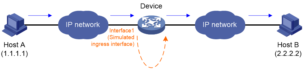

As shown in Figure 1, you can use packet trace as follows:
1.     Capture a packet sent from Host A to Host B on Interface 1 of the device.
2.     Configure a packet profile on the device according to the field values in the captured packet.
3.     Execute a packet trace operation. In the operation, specify the profile to construct traced packets and injects the packets to the device from Interface 1. The device simulates the packet forwarding process and traces the entire packet forwarding process, including the packets are injected, processed by software and hardware, and sent out of the device.
4.     View the packet trace operation result, obtain the forwarding process of the packets, identify whether packets are lost, and locate the packet drop reason.
Figure 1 Application scenario

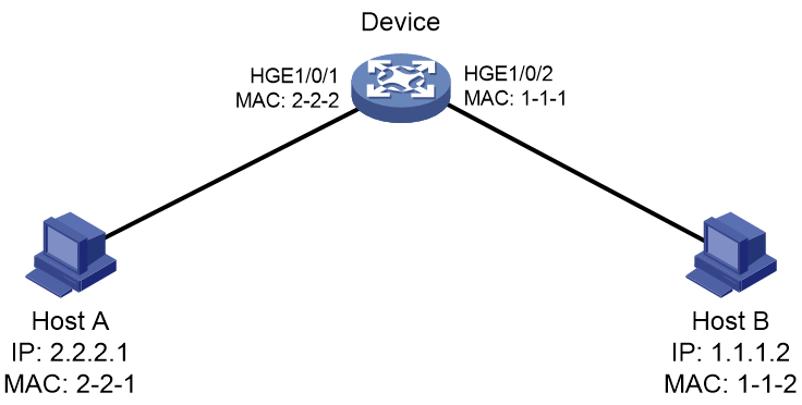

Example: Executing a packet trace operation (TCP packet profile)
As shown in Figure 2, the Telnet client Telnets to the Telnet server. The Telnet connection is flapping.
Use the packet trace feature to identify whether Telnet packets are dropped when the packets pass through the device. If the packets are dropped on the device, locate the packet drop reason.
Figure 2 Network diagram

The output shows that the device can correctly forward the Telnet packets sent from the Telnet client to the Telnet server without packet loss. Packet loss occurred at other locations.

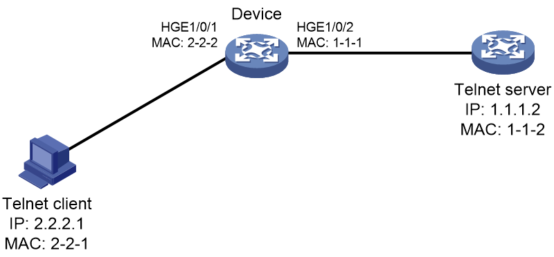

Example: Executing a packet trace operation (ICMP packet profile)
As shown in Figure 3, when Host A pings Host B, packets are lost. Use the packet trace feature to identify whether ping packets are dropped when the packets pass through the device. If the packets are dropped on the device, locate the packet drop reason.
Figure 3 Network diagram

The output shows that the device can correctly forward the ping packets sent from Host A to Host B without packet loss. Packet loss occurred at other locations.
