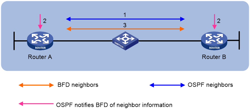

BFD establishes a session between two network devices to detect failures on the bidirectional forwarding paths between the devices and provide services for upper-layer protocols. BFD provides no neighbor discovery mechanism. Protocols that BFD services notify BFD of devices to which it needs to establish sessions. After a session is established, if no BFD control packet is received from the peer within the negotiated BFD interval, BFD notifies a failure to the protocol, which then takes appropriate measures.
Figure 1 describes the operation of BFD for OSPF.
1.     OSPF discovers neighbors by sending Hello packets and establishes neighbor relationships.
2.     After establishing neighbor relationships, OSPF notifies BFD of the neighbor information, including destination and source addresses.
3.     BFD uses the information to establish BFD sessions.
Figure 1 BFD session establishment

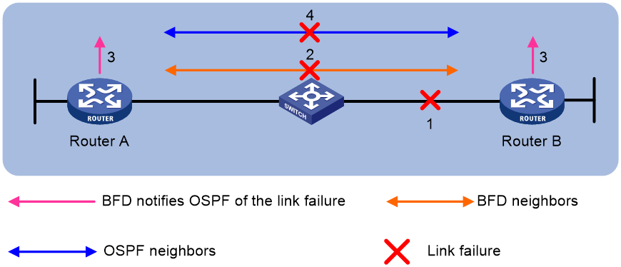

Figure 2 describes the BFD fault detection process.
1.     BFD detects a link failure and tears down the session.
2.     BFD notifies the neighbor unreachability to OSPF.
3.     OSPF terminates the neighbor relationship on the link.
Figure 2 BFD fault detection

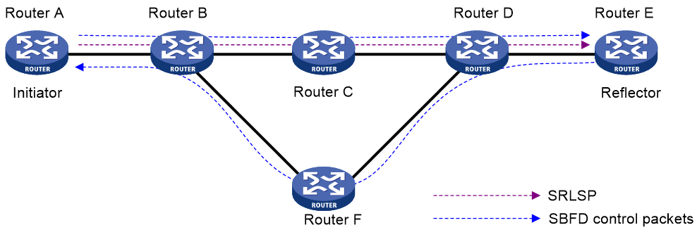

·     Multihop detection—Detects any of the paths between two systems, for example, Device A and Device B as shown in Figure 4. These paths have multiple hops, and might overlap.
Figure 4 Multihop detection

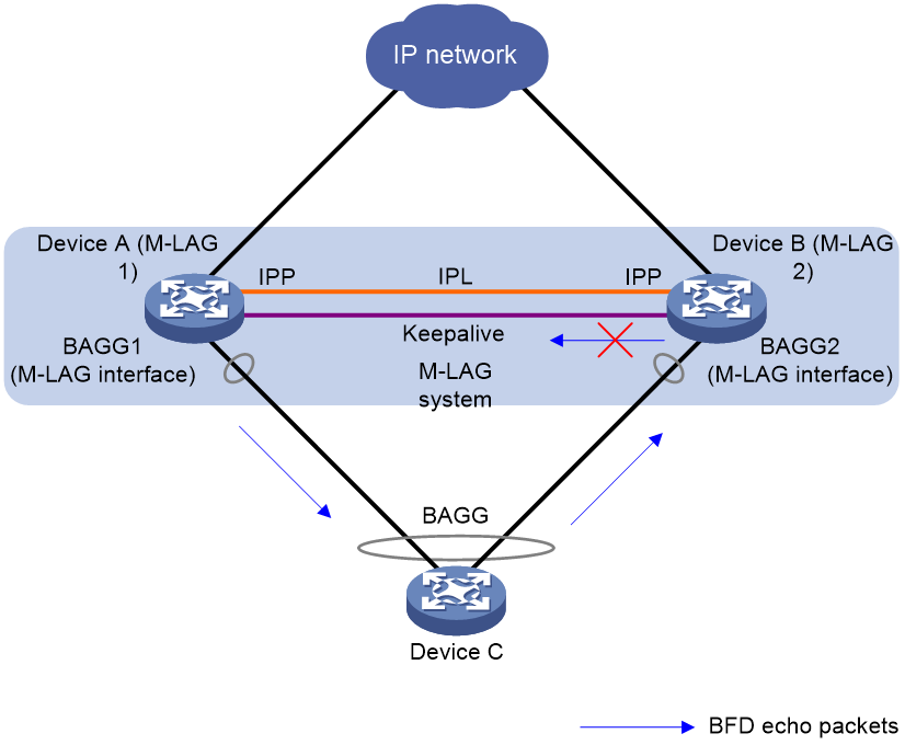

Forwarding the specified BFD echo packets through the peer link in an M-LAG system
Typically, only local discriminators are required for static BFD sessions in echo packet mode, and you do not need to configure remote discriminators. In an M-LAG system, a BFD session state anomaly might occur if the following conditions exist:
·     AN M-LAG member device uses a static BFD session in echo packet mode to detect the link to the downlink device.
·     The destination IP address in the BFD echo packets is the same as the IP address of the other M-LAG member device.
For example, as shown in Figure 5, Device C in the user network is dual-homed to an OSPF network through an M-LAG system. The M-LAG member devices are configured as gateways to implement Layer 3 forwarding. The gateway interfaces (for example, VLAN interfaces) on the M-LAG member devices use the same IP address and MAC address. Each M-LAG member device uses a static BFD session in echo packet mode to detect the link to Device C. The destination IP address in the BFD echo packets sent by the M-LAG member devices is the gateway IP address. Upon receiving the BFD echo packet sent by M-LAG 1, Device C might forward the packet to M-LAG 2. M-LAG 2 does not send the packet to M-LAG 1 because the destination IP address in the packet is the local device. Because no BFD echo packet is received from Device C, the BFD session state will become abnormal on M-LAG 1.
To resolve this issue, you can specify the local discriminator on M-LAG 1 for M-LAG 2 as a remote discriminator. Upon receiving a BFD echo packet matching a remote discriminator, M-LAG 2 sends the packet to M-LAG 1 through the peer link. This ensures that the BFD session on M-LAG 1 can come up correctly. Similarly, you can specify the local discriminator on M-LAG 2 for M-LAG 1 as a remote discriminator to ensure that the BFD session on M-LAG 2 can come up correctly.
Figure 5 BFD for M-LAG
As a best practice, make sure the BFD session discriminators on the M-LAG member interfaces do not overlap in an M-LAG system.
1.     Enter system view
2.     Specify remote discriminators of static BFD sessions for the local device.
bfd forwarding match remote-discriminator discr-value-list { discr-value1 [ to discr-value2 ] } &<1-10>
By default, no remote discriminators of static BFD sessions are specified for the local device.

Configuring SBFD
About SBFD
Seamless BFD (SBFD) is a unidirectional failure detection mechanism that provides shorter detection time than BFD. SBFD is used in scenarios where only one end of a link requires failure detection, such as MPLS TE tunneling and LSP establishment through LDP. For information about SRLSP, see SR-MPLS configuration in Segment Routing Configuration Guide. For information about LSP establishment through LDP, see LDP configuration in MPLS Configuration Guide.
An SBFD session involves the following roles:
·     Initiator—Periodically sends SBFD control packets to detect connectivity to remote entities. The initiator injects SBFD control packets into an MPLS TE tunnel or LDP LSP. The initiator initiates SBFD sessions and maintains SBFD session state.
·     Reflector—Listens for incoming SBFD control packets on local entities and replies with response SBFD control packets.
As shown in Figure 6, in an SR-based MPLS TE tunnel, the SRLSP from Router A to Router E is considered available if Router A (initiator) can receive response SBFD control packets from Router E (reflector).
Figure 6 Initiator and reflector in SBFD
Restrictions and guidelines: SBFD configuration
A node can act as the initiator of one session and the reflector of another session at the same time.
An SBFD session can only be established statically. You must manually specify the remote discriminator for an SBFD session.
