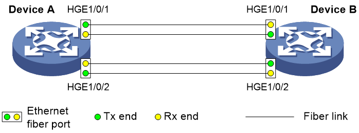

A link becomes unidirectional when only one end of the link can receive packets from the other end.
Unidirectional fiber links occur in the following cases:
·     Fibers are cross-connected.
·     A fiber is not connected at one end or one fiber of a fiber pair is broken.
Figure 1 shows a correct fiber connection and two types of unidirectional fiber connections.
When DLDP detects unidirectional links, it can automatically shut down the faulty port to avoid network problems. Alternatively, a user can manually shut down the faulty port.
Figure 1 Correct and incorrect fiber connections

Figure 2 Cross-connected fibers
As shown in Figure 2, before you enable DLDP, the optical fibers between Device A and Device B are cross-connected. After you enable DLDP, the four ports are all up and in unidirectional state, and they send RecoverProbe packets. Take Port A1 as an example to illustrate the unidirectional link detection process.
a.     Port A1 receives the RecoverProbe packet from Port B2, and returns a RecoverEcho packet.
b.     Port B2 cannot receive any RecoverEcho packet from Port A1, so Port B2 cannot become the neighbor of Port A1.
c.     Port B1 can receive the RecoverEcho packet from Port A1, but Port B1 is not the intended destination, so Port B1 cannot become the neighbor of Port A1.
The same process occurs on the other three ports. The four ports are all in unidirectional state.

Example: Configuring the manual port shutdown mode
As shown in Figure 6, Device A and Device B are connected through two fiber pairs.
Configure DLDP to detect unidirectional links. When a unidirectional link is detected, the administrator must manually shut down the port.
Figure 6 Network diagram

Example: Configuring the hybrid port shutdown mode
As shown in Figure 7Figure 6, Device A and Device B are connected through two fiber pairs.
Configure DLDP to detect unidirectional links. When a unidirectional link is detected, DLDP automatically shuts down the unidirectional port. The administrator needs to bring up the port after clearing the fault.
Figure 7 Network diagram
