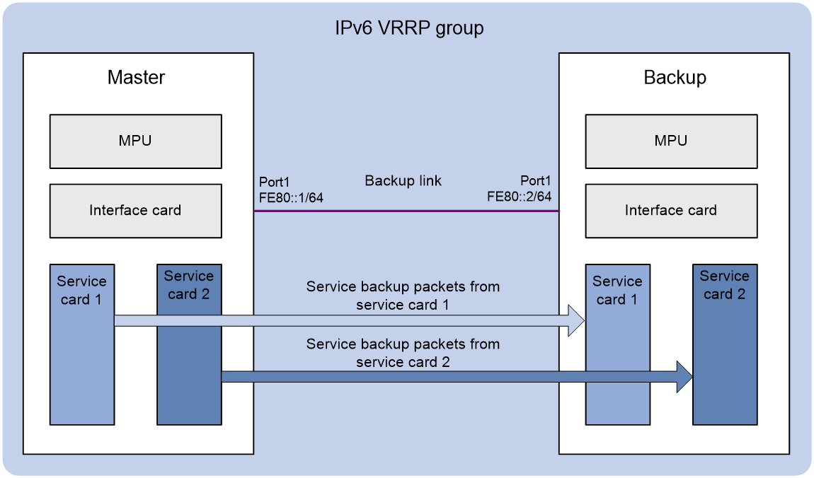

Some high availability services (such as VSRP, failover group, and subordinate IPv6 VRRP group) determine the device roles based on the device states in the associated IPv6 VRRP group. The master device corresponds to the master in the IPv6 VRRP group and is used to forward traffic. The backup device corresponds to the backup in the IPv6 VRRP group and is used to monitor the state of the master device. If the IPv6 VRRP group is configured on the interfaces of a direct link connecting two devices, an interface or link failure can cause a state transition. The master and backup in the IPv6 VRRP group transition to Initialize state. Consequently, the master and backup devices for the associated high availability service transition to the initialized state, and the master device stops processing service data. To prevent interruption of high availability services, perform this task on the two devices in the IPv6 VRRP group. The IPv6 VRRP group will keep the state of master and backup unchanged when a hosting interface is physically down.
As shown in Figure 10, in the network where a failover group is bound with an IPv6 VRRP group, a direct link exists between the two devices. The IPv6 VRRP group is configured on the interfaces at the two ends of the direct link. The failover group determines the primary node and secondary node based on the device states (master and backup) in the IPv6 VRRP group. If an interface or link failure occurs, the peer interface physically goes down, and the master and backup in the IPv6 VRRP group transition to Initialize state. As a result, the primary node in the failover group stops process service data, and a service interruption occurs. To avoid this issue, perform this task to keep the state of master and backup unchanged in the IPv6 VRRP group upon an interface or link failure.
Figure 10 Networking of a failover group bound with an IPv6 VRRP group
For more information about master and subordinate IPv6 VRRP groups, see "Configuring a subordinate IPv6 VRRP group to follow a master IPv6 VRRP group."
