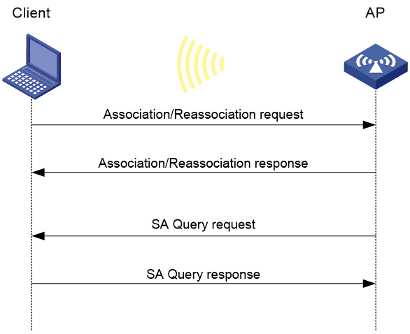

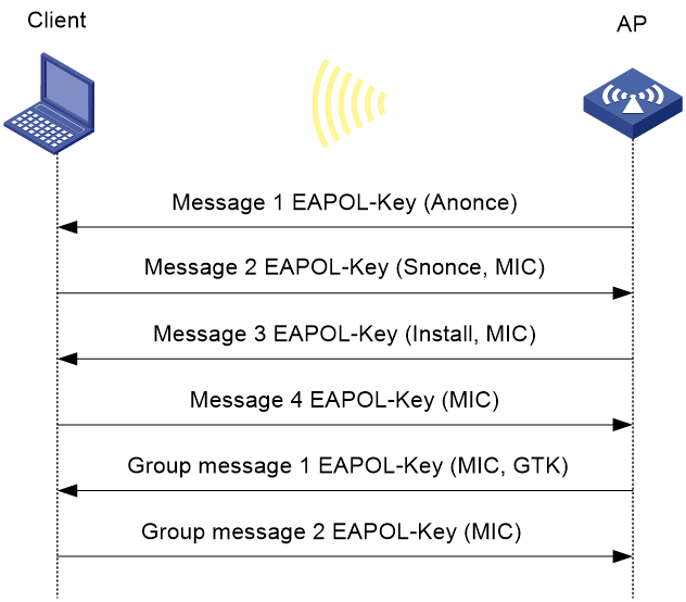

Open system authentication
Open system authentication is the default and simplest authentication algorithm. Any client that requests authentication by using this algorithm can pass the authentication.
Open system authentication uses the following process:
1.     The client sends an authentication request to the AP.
2.     The AP sends an authentication response to the client after the client passes the authentication.
Figure 1 Open system authentication process

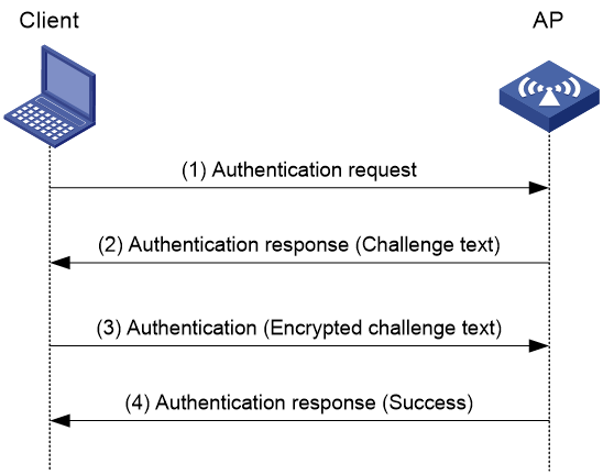

Shared key authentication
Shared key authentication uses a WEP key for the AP and client to complete authentication.
Shared key authentication uses the following process:
2.     The AP randomly generates a challenge text and sends it to the client.
3.     The client uses the WEP key to encrypt the challenge text and sends it to the AP.
4.     The AP uses the WEP key to decrypt the challenge text and compares the decrypted challenge text with the original challenge text. If they are identical, the client passes the authentication. If they are not, the authentication fails.
Figure 2 Shared key authentication process

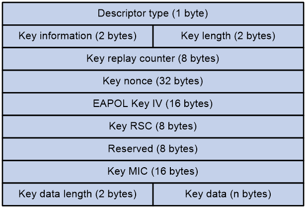

EAPOL-Key packet
The IEEE 802.11i protocol uses EAPOL-Key packets during key negotiation.
Figure 3 EAPOL-Key structure
Table 1 EAPOL-Key field description
Field
Description
Descriptor type
Specifies the network type:
·     WPA network.
·     RSN network.
Key information
For more information about this field, see Table 2.
Key length
Length of the key.
Key replay counter
Records the total number of GTK updates to prevent replay attacks.
The AP sets this field to 0 at the beginning of the negotiation and increments the value on each successive EAPOL-Key frame.
The client records this field from the last valid EAPOL-Key frame that it received if this field is greater than the field recorded previously.
EAPOL-Key frame retransmission is required in the following situations:
·     The field received by the client is smaller than or equal to the field recorded by the client.
·     The field received by the AP is not equal to the field recorded on the AP.
If the retransmission attempts exceed the maximum number, the AP disconnects the client.
Key nonce
Random value used to generate the PTK.
EAPOL Key IV
Encrypts the TKIP. This field is valid only when the encryption type is not CCMP.
Key RSC
Records the total number of multicast packets or broadcast packets to prevent replay attacks. The AP increments the value of this field on transmission of each multicast or broadcast packet.
Reserved
Reserved field.
Key MIC
Message integrity check.
Key data length
Length of the key data.
Key data
Data to be transmitted, such as the GTK and pairwise master key identifier (PMKID).

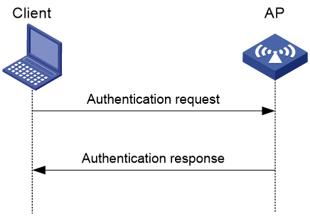

RSN key negotiation
RSN uses EAPOL-Key packets in the four-way handshake to negotiate the PTK and the GTK.
Figure 6 RSN key negotiation process
RSN key negotiation uses the following process:
1.     The AP sends the client EAPOL-Key message 1 that contains a random value ANonce.
2.     The client performs the following operations:
a.     Uses the random value SNonce, ANonce, and PMK to generate a PTK by using the KDF.
b.     Uses the KCK in the PTK to generate the MIC.
c.     Returns EAPOL-Key message 2 that contains the SNonce and MIC.
3.     The AP performs the following operations:
a.     Uses the SNonce, ANonce, and PMK to generate a PTK by using the KDF.
c.     Compares the received MIC with the local MIC.
d.     Generates a GTK with the random GMK and MAC address of the AP by using the KDF if the two MICs are the same.
e.     Returns EAPOL-Key message 3 that contains the key installation request tag, MIC, and GTK.
4.     The client performs the following operations:
a.     Compares the received MIC with the local MIC.
b.     Installs the PTK and GTK if the two MICs are the same.
c.     Returns EAPOL-Key message 4 that contains the MIC.
5.     The AP performs the following operations:

Enhanced open system authentication
Enhanced open system authentication uses Opportunistic Wireless Encryption (OWE) to negotiate keys for encrypting data packets of OWE-capable clients, providing open system authentication with enhanced security performance.
Enhanced open system authentication uses the following procedure:
2.     The AP determines that the client can pass wireless link layer authentication and sends an authentication response to the client to notify the client of the authentication success.
3.     The client and the AP perform 4-way handshake to generate a key for encryption.
Figure 9 Enhanced open system authentication process

WLAN security configuration examples

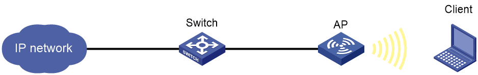

Example: Configuring shared key authentication
As shown in Figure 10, the switch functions as a DHCP server to assign IP addresses to the AP and client. Configure shared key authentication to enable the client to access the network by using WEP key 12345.
Figure 10 Network diagram
# Create a WLAN service template named service1.
<AP> system-view
[AP] wlan service-template service1
# Specify an SSID of service for the service template.
[AP-wlan-st-service1] ssid service
# Configure a WEP40 plaintext key of 12345 as WEP key 2, and apply WEP key 2.
[AP-wlan-st-service1] cipher-suite wep40
[AP-wlan-st-service1] wep key 2 wep40 pass-phrase simple 12345
[AP-wlan-st-service1] wep key-id 2
# Enable service template service1.
[AP-wlan-st-service1] service-template enable
[AP-wlan-st-service1] quit
# Bind service template service1 to radio interface WLAN-Radio 1/0/1 of the AP.
[AP] interface WLAN-Radio 1/0/1
[AP-WLAN-Radio1/0/1] undo shutdown
[AP-WLAN-Radio1/0/1] service-template service1
[AP-WLAN-Radio1/0/1] quit
# Use the display wlan service-template command to verify that the WLAN service template has been configured correctly.
[AP] display wlan service-template service1 verbose
Service template name        : service1
Description                  : Not configured
SSID                         : service
SSID-hide                    : Disabled
User-isolation               : Disabled
Service template status      : Enabled
Maximum clients per BSS      : 64
Frame format                 : Dot3
VLAN ID                      : 1
AKM mode                     : Not configured
Security IE                  : Not configured
Cipher suite                 : WEP40
WEP key ID                   : 2
TKIP countermeasure time     : 0
PTK lifetime                 : 43200 sec
GTK rekey                    : Enabled
GTK rekey method             : Time-based
GTK rekey time               : 86400 sec
GTK rekey client-offline     : Enabled
User authentication mode     : Shared-key
Intrusion protection         : Disabled
Intrusion protection mode    : Temporary-block
Temporary block time         : 180 sec
Temporary service stop time  : 20 sec
Fail VLAN ID                 : Not configured
802.1X handshake             : Disabled
802.1X handshake secure      : Disabled
802.1X domain                : Not configured
MAC-auth domain              : Not configured
Max 802.1X users per BSS     : 4096
Max MAC-auth users per BSS   : 4096
802.1X re-authenticate       : Disabled
Authorization fail mode      : Online
Accounting fail mode         : Online
Authorization                : Permitted
Key derivation               : N/A
PMF status                   : Disabled
Hotspot policy number        : Not configured
Forward policy               : Not configured
Forwarder                    : AC
FT status                    : Disabled
QoS trust                    : Port
QoS priority                 : 0

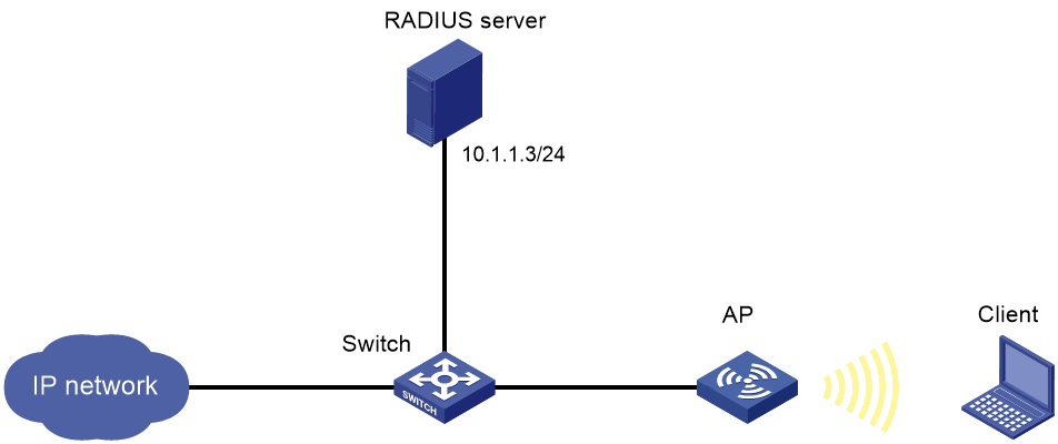

Example: Configuring PSK authentication and MAC authentication
As shown in Figure 12, the switch functions as a DHCP server to assign IP addresses to the AP and client.
·     Configure open system authentication and MAC authentication so that the client can access the network by using login username abc and password 123.
·     Configure the client to use preshared key 12345678 to access the network.
Figure 12 Network diagram
1.     Configure a username of abc and a password of 123 on the RADIUS server and make sure the RADIUS server and AC can reach each other. (Details not shown.)
2.     Create a WLAN service template named service1.
<AP> system-view
3.     Specify an SSID of service for the service template.
4.     Configure WLAN security for service template service1:
# Configure the PSK AKM mode and the 12345678 plaintext key.
[AP-wlan-st-service1] akm mode psk
[AP-wlan-st-service1] preshared-key pass-phrase simple 12345678
# Configure CCMP as the cipher suite and WPA as the security IE.
[AP-wlan-st-service1] cipher-suite ccmp
[AP-wlan-st-service1] security-ie wpa
# Configure the MAC-address-based authentication mode.
[AP-wlan-st-service1] client-security authentication-mode mac
5.     Enable service template service1.
6.     Configure a RADIUS scheme:
# Create a RADIUS scheme named radius1 and enter its view.
[AP] radius scheme radius1
# Specify the primary authentication server and accounting server.
[AP-radius-radius1] primary authentication 10.1.1.3 1812
[AP-radius-radius1] primary accounting 10.1.1.3 1813
# Set the shared keys for authentication and accounting to 12345678 in plaintext.
[AP-radius-radius1] key authentication simple 12345678
[AP-radius-radius1] key accounting simple 12345678
# Configure the format for the usernames sent to the RADIUS server based on the RADIUS server configuration:
¡     Exclude domain names from the usernames sent to the RADIUS server.
[AP-radius-radius1] user-name-format without-domain
[AP-radius-radius1] quit
¡     Include domain names in the usernames sent to the RADIUS server.
[AP-radius-radius1] user-name-format with-domain
7.     Create an ISP domain named dom1 and configure a RADIUS scheme for the ISP domain.
[AP] domain dom1
[AP-isp-dom1] authentication lan-access radius-scheme radius1
[AP-isp-dom1] authorization lan-access radius-scheme radius1
[AP-isp-dom1] accounting lan-access radius-scheme radius1
[AP-isp-dom1] quit
8.     Configure an ISP domain of dom1, a username of abc, and a password of 123 for the user.
[AP] mac-authentication mac domain dom1
[AP] mac-authentication user-name-format fixed account abc password simple 123
9.     Bind service template service1 to radio interface WLAN-Radio 1/0/1 of the AP.
For more information about the AAA and RADIUS commands in this section, see Security Command Reference.
SSID                         : service
Frame format                 : Dot3
VLAN ID                      : 1
AKM mode                     : PSK
Security IE                  : WPA
Cipher suite                 : CCMP
GTK rekey                    : Enabled
User authentication mode          : MAC
Forwarder                    : AC
QoS trust                    : Port
QoS priority                 : 0
Example: Configuring 802.1X AKM
As shown in Figure 13, the switch functions as a DHCP server to assign IP addresses to the AP and client.
·     Configure open system authentication and 802.1X authentication so that the client can access the network by using login username abcdef and password 123456.
·     Configure the 802.1X as the AKM mode.
Figure 13 Network diagram
1.     Configure a username of abcdef and a password of 123456 on the RADIUS server and make sure the RADIUS server and AC can reach each other. (Details not shown.)
2.     Configure the 802.1X client. (Details not shown.)
3.     Create a WLAN service template named service1.
<AP> system-view
4.     Specify an SSID of service for the service template.
5.     Configure WLAN security for service template service1:
# Configure 802.1X as the AKM mode.
[AP-wlan-st-service1] akm mode dot1x
# Configure the 802.1X authentication mode.
[AP-wlan-st-service1] client-security authentication-mode dot1x
6.     Enable service template service1.
7.     Configure a RADIUS scheme.
# Set the shared keys for authentication and accounting to 12345 in plaintext.

Example: Configuring management frame protection
As shown in Figure 14, the switch functions as a DHCP server to assign IP addresses to the AP and client.
·     Configure the CCMP cipher suite, RSN security IE, and management frame protection.
Figure 14 Network diagram
1.     Create a WLAN service template named service1.
<AP> system-view
2.     Specify an SSID of service for the service template.
3.     Enable management frame protection in optional mode.
[AP-wlan-st-service1] pmf optional
4.     Configure the 802.11i mechanism:
# Configure CCMP as the cipher suite and RSN as the security IE.
[AP-wlan-st-service1] security-ie rsn
6.     Bind service template service1 to radio interface WLAN-Radio 1/0/1 of the AP.

Example: Configuring dynamic WEP
As shown in Figure 15, the switch functions as a DHCP server to assign IP addresses to the AP and client.
·     Configure dynamic WEP.
Figure 15 Network diagram
<AP> system-view
5.     Enable dynamic WEP.
[AP-wlan-st-service1] wep mode dynamic
6.     Configure the 802.1X authentication mode.
7.     Enable service template service1.
8.     Configure a RADIUS scheme:
# Set the format for the usernames sent to the RADIUS server based on the RADIUS server configuration:
9.     Create an ISP domain named dom1 and configure a RADIUS scheme for the ISP domain.
[AP] domain dom1
[AP-isp-dom1] quit
10.     Configure ISP domain dom1 as the default ISP domain.
[AP] domain default enable dom1
11.     Bind service template service1 to radio interface WLAN-Radio 1/0/1 of the AP.

Example: Configuring private PSK authentication and MAC authentication
As shown in Figure 16, the switch functions as a DHCP server to assign IP addresses to the AP and client.
·     Configure the MAC authentication mode so that the client can access the network by using its MAC address as the login username and password.
·     Configure the private PSK AKM mode so that the client can use its MAC address as the PSK.
Figure 16 Network diagram
1.     Configure a username of 00-23-12-45-67-7a and a password of 00-23-12-45-67-7a on the RADIUS server and make sure the RADIUS server and AC can reach each other. (Details not shown.)
<AP> system-view
# Configure private PSK as the AKM mode.
[AP-wlan-st-service1] akm mode private-psk
# Configure the MAC authentication mode.
