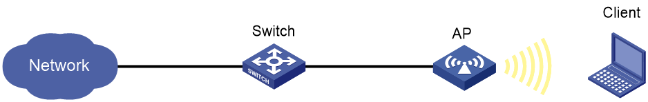

WLAN access process
A wireless client can access a WLAN only when it completes the scanning, link layer authentication, association, and WLAN authentication processes.
For more information about data link layer authentication, see "Configuring WLAN security." For more information about WLAN authentication, see "Configuring WLAN authentication."

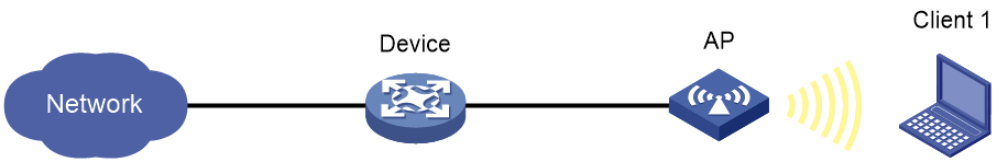

Active scanning
A wireless client periodically scans surrounding wireless networks by sending probe requests. It obtains network information from received probe responses. Based on whether a probe request carries an SSID, active scanning can be divided into the following types:
·     Active scanning of all wireless networks.
As shown in Figure 2, the client periodically sends a probe request on each of its supported channels to scan wireless networks. APs that receive the probe request send a probe response that carries the available wireless network information. The client associates with the optimal AP.
Figure 2 Scanning all wireless networks

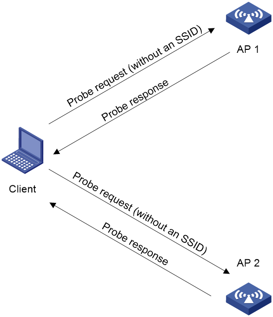

·     Active scanning of a specific wireless network.
As shown in Figure 3, the client periodically sends a probe request carrying the specified SSID or the SSID of the wireless network it has been associated with. When an AP that can provide wireless services with the specified SSID receives the probe request, it sends a probe response.
Figure 3 Scanning a specific wireless network

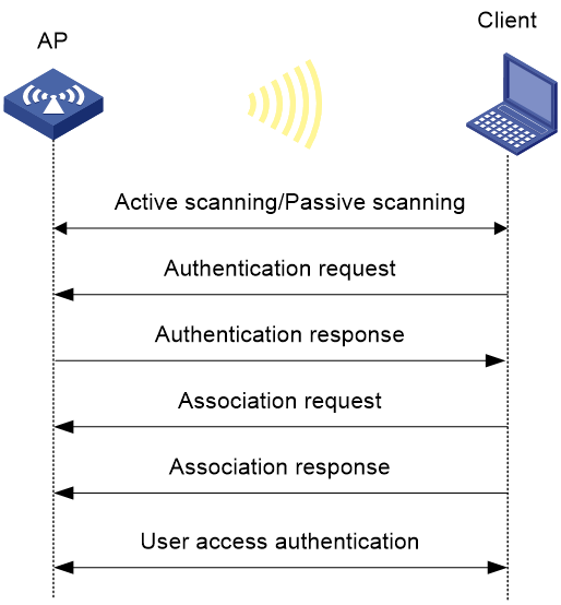

Passive scanning
As shown in Figure 4, the clients periodically listen for beacon frames sent by APs on their supported channels to get information about surrounding wireless networks. Then the clients select an AP for association. Passive scanning is used when clients want to save power.
Figure 4 Passive scanning

WLAN access configuration examples
Example: Configuring WLAN access
As shown in Figure 6, the switch acts as the DHCP server to assign IP addresses to the AP and the client. The AP provides wireless services with SSID trade-off.
Figure 6 Network diagram
# Create service template service1, set the SSID to trade-off, and enable the service template.
<AP> system-view
[AP] wlan service-template service1
[AP-wlan-st-service1] ssid trade-off
[AP-wlan-st-service1] service-template enable
[AP-wlan-st-service1] quit
# Bind service template service1 to WLAN-Radio 0/0.
[AP] interface wlan-radio 0/0
[AP-WLAN-Radio0/0] undo shutdown
[AP-WLAN-Radio0/0] service-template service1
[AP-WLAN-Radio0/0] quit
# Verify that the SSID is trade-off, and the service template is enabled.
[AP] display wlan service-template verbose

Example: Configuring whitelist-based access control
As shown in Figure 7, configure the whitelist to permit only the client whose MAC address is 0000-000f-1211 to access the WLAN.
Figure 7 Network diagram
# Add MAC address 0000-000f-1211 to the whitelist.
<AP> system-view
[AP] wlan whitelist mac-address 0000-000f-1211

Example: Configuring static blacklist-based access control
As shown in Figure 8, configure the static blacklist to forbid the client whose MAC address is 0000-000f-1211 to access the WLAN.
Figure 8 Network diagram
# Add MAC address 0000-000f-1211 to the static blacklist.
<AP> system-view
[AP] wlan static-blacklist mac-address 0000-000f-1211
# Verify that MAC address 0000-000f-1211 is in the static blacklist.
<AP> display wlan blacklist static
Total number of clients: 1
 MAC addresses:
  0000-000f-1211
