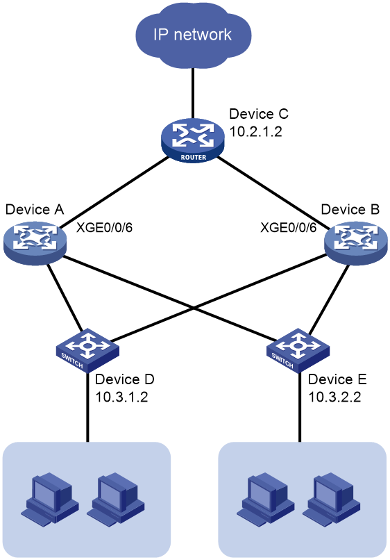

As shown in Figure 2, use Tcl to create a monitor policy on the Device. This policy must meet the following requirements:
·     EAA sends the log message "rtm_tcl_test is running" when a command that contains the display this string is entered.
·     The system executes the command only after it executes the policy successfully.
Figure 2 Network diagram

As shown in Figure 3, Device A has established BGP sessions with Device D and Device E. Traffic from Device D and Device E to the Internet is forwarded through Device A.
Configure a CLI-defined EAA monitor policy on Device A to disconnect the sessions with Device D and Device E when Ten-GigabitEthernet 0/0/6 connected to Device C is down. In this way, traffic from Device D and Device E to the Internet can be forwarded through Device B.
Figure 3 Network diagram
