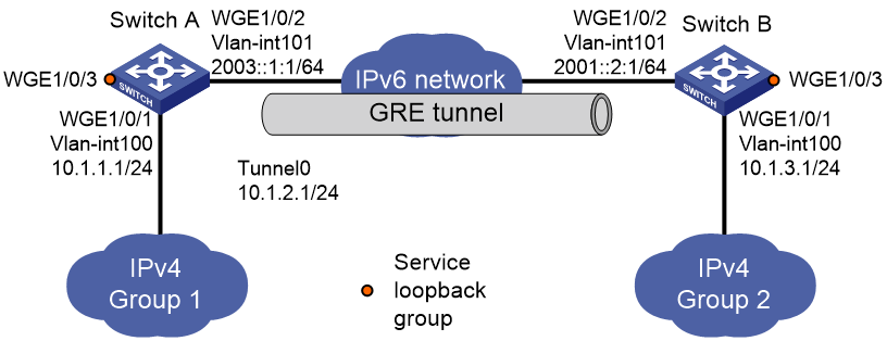

As shown in Figure 3, IPv6 network 1 and IPv6 network 2 are IPv6 networks, and IPv4 network 1 and IPv4 network 2 are IPv4 networks. Through the GRE tunnel between Device A and Device B, IPv6 network 1 can communicate with IPv6 network 2 and IPv4 network 1 can communicate with IPv4 network 2, without affecting each other.
Figure 3 Network diagram

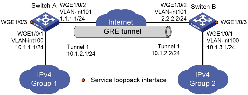

As shown in Figure 7, Group 1 and Group 2 are two private IPv4 networks. The two networks both use private network addresses and belong to the same VPN. Establish a GRE tunnel between Switch A and Switch B to interconnect the two private IPv4 networks Group 1 and Group 2.
Figure 7 Network diagram

Example: Configuring an IPv4 over IPv6 GRE tunnel
As shown in Figure 8, two IPv4 subnets Group 1 and Group 2 are connected to an IPv6 network. Create a GRE/IPv6 tunnel between Switch A and Switch B, so the two IPv4 subnets can communicate with each other through the GRE tunnel over the IPv6 network.
Figure 8 Network diagram
Before performing the following configuration, configure an IP address for each interface, and make sure Switch A and Switch B can reach each other.
1.     Configure Switch A:
# Create service loopback group 1, and configure the service type as tunnel.
<SwitchA> system-view
[SwitchA] service-loopback group 1 type tunnel
# Add port Twenty-FiveGigE 1/0/3 to service loopback group 1.
[SwitchA] interface twenty-fivegige 1/0/3
[SwitchA-Twenty-FiveGigE1/0/3] port service-loopback group 1
[SwitchA-Twenty-FiveGigE1/0/3] quit
# Create a tunnel interface Tunnel 0, and specify the tunnel mode as GRE/ IPv6.
[SwitchA] interface tunnel 0 mode gre ipv6
# Configure an IP address for the tunnel interface.
[SwitchA-Tunnel0] ip address 10.1.2.1 255.255.255.0
# Configure the source address of the tunnel interface as the IPv6 address of VLAN-interface 101 on Switch A.
[SwitchA-Tunnel0] source 2003::1:1
# Configure the destination address of the tunnel interface as the IPv6 address of VLAN-interface 101 on Switch B.
[SwitchA-Tunnel0] destination 2001::2:1
[SwitchA-Tunnel0] quit
# Configure a static route from Switch A through the tunnel interface to Group 2.
[SwitchA] ip route-static 10.1.3.0 255.255.255.0 tunnel 0
2.     Configure Switch B:
<SwitchB> system-view
[SwitchB] service-loopback group 1 type tunnel
[SwitchB] interface twenty-fivegige 1/0/3
[SwitchB-Twenty-FiveGigE1/0/3] port service-loopback group 1
[SwitchB-Twenty-FiveGigE1/0/3] quit
# Create a tunnel interface Tunnel 0, and specify the tunnel mode as GRE/IPv6.
[SwitchB] interface tunnel 0 mode gre ipv6
[SwitchB-Tunnel0] ip address 10.1.2.2 255.255.255.0
# Configure the source address of tunnel interface as the IPv6 address of VLAN-interface 101 on Switch B.
[SwitchB-Tunnel0] source 2001::2:1
# Configure the destination address of the tunnel interface as the IPv6 address of VLAN-interface 101 on Switch A.
[SwitchB-Tunnel0] destination 2003::1:1
[SwitchB-Tunnel0] quit
# Configure a static route from Switch B through the tunnel interface to Group 1.
[SwitchB] ip route-static 10.1.1.0 255.255.255.0 tunnel 0
# Display tunnel interface information on Switch A.
[SwitchA] display interface tunnel 0
Tunnel0
Current state: UP
Line protocol state: UP
Description: Tunnel0 Interface
Bandwidth: 64kbps
Maximum transmission unit: 1456
Internet address: 10.1.2.1/24 (primary)
Tunnel source 2003::1:1, destination 2001::2:1
Tunnel TTL 255
Tunnel protocol/transport GRE/IPv6
    GRE key disabled
    Checksumming of GRE packets disabled
Last clearing of counters: Never
Last 300 seconds input rate: 0 bytes/sec, 0 bits/sec, 0 packets/sec
Last 300 seconds output rate: 0 bytes/sec, 0 bits/sec, 0 packets/sec
Input: 0 packets, 0 bytes, 0 drops
Output: 0 packets, 0 bytes, 0 drops
# Display tunnel interface information on Switch B.
[SwitchB] display interface tunnel 0
Tunnel0
Current state: UP
Bandwidth: 64kbps
Internet address: 10.1.2.2/24 (primary)
Tunnel source 2001::2:1, destination 2003::1:1
Tunnel TTL 255
    GRE key disabled
# From Switch B, ping the IP address of VLAN-interface 100 on Switch A.
[SwitchB] ping -a 10.1.3.1 10.1.1.1
Ping 10.1.1.1 (10.1.1.1) from 10.1.3.1: 56 data bytes, press CTRL_C to break
56 bytes from 10.1.1.1: icmp_seq=0 ttl=255 time=2.000 ms
56 bytes from 10.1.1.1: icmp_seq=1 ttl=255 time=1.000 ms
56 bytes from 10.1.1.1: icmp_seq=2 ttl=255 time=1.000 ms
56 bytes from 10.1.1.1: icmp_seq=3 ttl=255 time=0.000 ms
56 bytes from 10.1.1.1: icmp_seq=4 ttl=255 time=1.000 ms
--- Ping statistics for 10.1.1.1 ---
round-trip min/avg/max/std-dev = 0.000/1.000/2.000/0.632 ms
The output shows that Switch B can successfully ping Switch A.
Troubleshooting GRE
The key to configuring GRE is to keep the configuration consistent. Most faults can be located by using the debugging gre or debugging tunnel command. This section analyzes one type of fault for illustration, with the scenario shown in Figure 9.
Figure 9 Network diagram
Hosts at both ends of a GRE tunnel cannot ping each other
Symptom
The interfaces at both ends of the tunnel are configured correctly and can ping each other, but Host A and Host B cannot ping each other.
Solution
To resolve the issue:
1.     Execute the display ip routing-table command on Device A and Device C to view whether Device A has a route over tunnel 0 to 10.2.0.0/16 and whether Device C has a route over tunnel 0 to 10.1.0.0/16.
2.     If such a route does not exist, execute the ip route-static command in system view to add the route. Take Device A as an example:
[DeviceA] ip route-static 10.2.0.0 255.255.0.0 tunnel 0
3.     If the issue persists, contact H3C Support.
