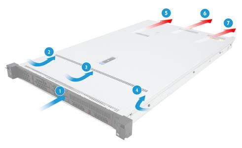

Airflow direction of the server
Figure 2 Airflow direction of the server
(1) to (4) Directions of the airflow into the chassis
(5) to (7) Direction of the airflow out of the chassis

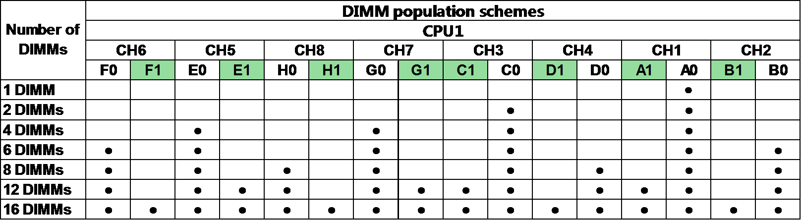

Guidelines for installing only DDR4 DIMMs
When you install only DDR4 DIMMs, follow these restrictions and guidelines:
·     Make sure their corresponding processors are present before powering on the server.
·     Make sure all DDR4 DIMMs installed on the server have the same product code. For information about DIMM product codes, use the query tool available from http://www.h3c.com/cn/Service/Document_Software/Document_Center/Server/.
·     For the configured memory mode to take effect, make sure the following installation requirements are met:
Memory mode
DIMM population requirements
Independent
·     If one processor is present, see Figure 15.
·     If two processors are present, see Figure 16 and Figure 17.
Mirror
·     A minimum of two DIMMs for a processor.
·     Strictly follow the DIMM installation schemes recommended for installing a minimum of two DIMMs per processor.
¡     If one processor is present, see Figure 15.
¡     If two processors are present, see Figure 16 and Figure 17.
·     If the DIMM configuration does not meet the requirements for the configured memory mode, the system uses the default memory mode (Independent mode).
·     In Figure 15, Figure 16, and Figure 17, the black DIMM slots (for example, the F1 slot) are grey colored, and the white DIMM slots (for example, the F0 slot) are not colored.
Figure 15 DDR4-only DIMM population schemes for one processor
Figure 16 DDR4-only DIMM population schemes for two processors (1)
Figure 17 DDR4-only DIMM population schemes for two processors (2)

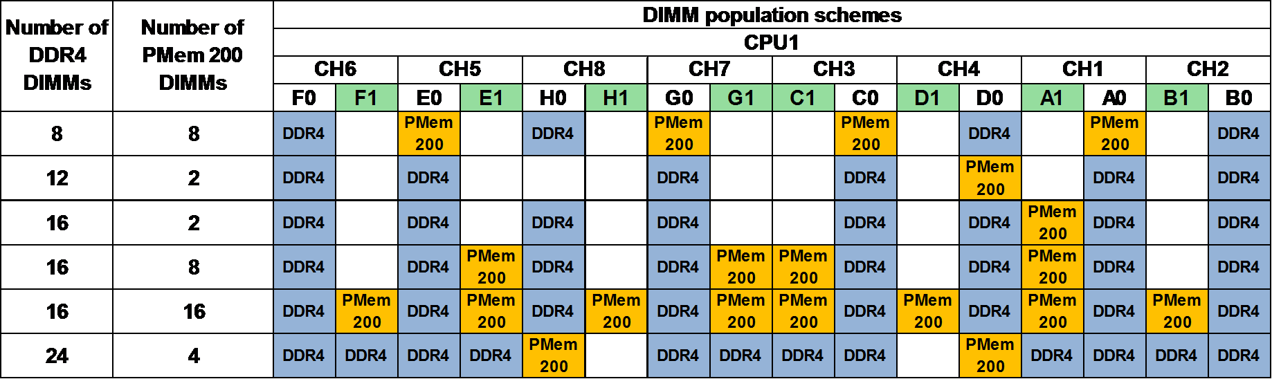

Guidelines for installing a mixture of PMem 200 and DDR4 DIMMs
When you install PMem 200 and DDR4 DIMMs on the server, follow these restrictions and guidelines:
·     Make sure the PMem 200 DIMMs have never been used on any other products. If they have been used on any other products, they might be unusable on the server.
·     Make sure all DDR4 DIMMs have the same product code and all PMem DIMMs have the same product code. For information about DIMM product codes, use the query tool available from http://www.h3c.com/cn/Service/Document_Software/Document_Center/Server/.
·     Depending on the processor and DIMM configuration, use the schemes shown in Figure 18, Figure 19, and Figure 20 to populate the DIMM slots.
In Figure 18, Figure 19, and Figure 20, the black DIMM slots (for example, the B1 slot) are grey colored, and the white DIMM slots (for example, the B0 slot) are not colored.
If one processor is present, populate DIMMs as shown in Figure 18.
Figure 18 Mixed DDR4 and PMem DIMM population schemes for one processor
If two processors are present, populate DIMMs as shown in Figure 19 or Figure 20.
Figure 19 Mixed DDR4 and PMem DIMM population schemes for two processors (1)
Figure 20 Mixed DDR4 and PMem DIMM population schemes for two processors (1)

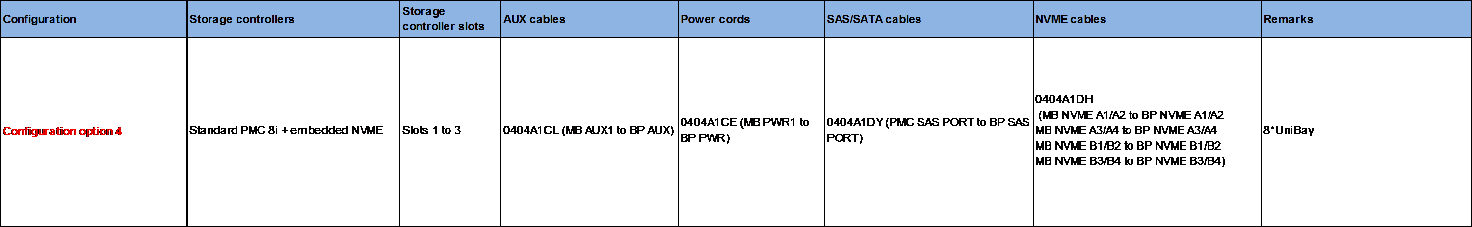

Figure 23 Drive configuration and cabling scheme for configuration option 2
Table 11 Cabling scheme for drive configuration option 2
Cable type
Cable code
Cabling method
Remarks
AUX signal cable
0404A1CL
MB AUX1 to BP AUX, connecting connector AUX1 on the system board to connector AUX on the drive backplane.
Figure 26
Power cord
0404A1CE
MB PWR1 to BP PWR, connecting connector PWR1 on the system board to connector PWR on the drive backplane.
Figure 26
SAS/SATA data cable
0404A1DY
PMC SAS PORT to BP SAS PORT, connecting the SAS connector on the PMC storage controller to connector SAS PORT on the drive backplane.
Figure 25

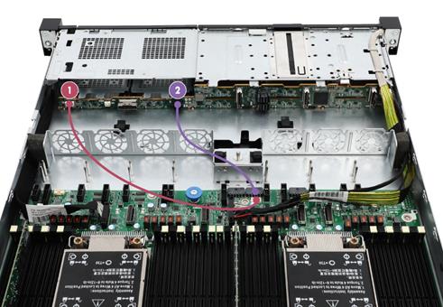

Figure 24
Figure 24 Connecting NVMe data cables
(1) NVMe data cable 1 (from connector NVMe A1/A2 on the drive backplane to connector NVMe A1/A2 on the system board)
(2) NVMe data cable 2 (from connector NVMe A3/A4 on the drive backplane to connector NVMe A3/A4 on the system board)
(3) NVMe data cable 3 (from connector NVMe B1/B2 on the drive backplane to connector NVMe B1/B2 on the system board)
(4) NVMe data cable 4 (from connector NVMe B3/B4 on the drive backplane to connector NVMe B3/B4 on the system board)

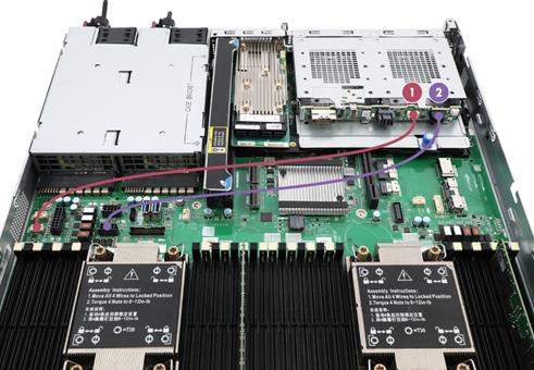

Figure 25 Connecting an SAS/SATA data cable
Figure 26 Connecting an AUX cable and power cord
(1) AUX cable
(2) Power cord

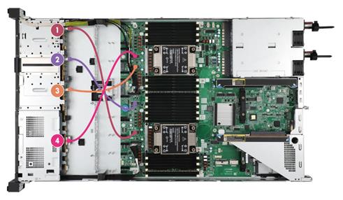

1.     Connect an NVMe data cable for the 8SFF drives at the front.
Figure 27 Connecting an NVMe data cable for the 8SFF drives at the front

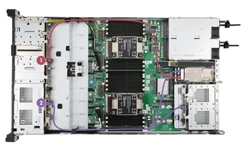

2.     Connect an SAS/SATA data cable for the 8SFF drives at the front.
Figure 28 Connecting an SAS/SATA data cable for the 8SFF drives at the front
3.     Connect an AUX cable and power cord for the 8SFF drives at the front.
Figure 29 Connecting an AUX cable and power cord for the 8SFF drives at the front

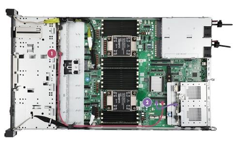

4LFF drives at the front + 2SFF drives at the rear
1.     Connect SAS/SATA data cables for the 4LFF drives at the front and 2SFF drives at the rear.
Figure 30 Connecting SAS/SATA data cables for the 4LFF drives at the front and 2SFF drives at the rear
2.     Connect an AUX cable and power cord for the 4LFF drives at the front.
Figure 31 Connecting an AUX cable and power cord for the 4LFF drives at the front
(1) AUX cable
(2) Power cord

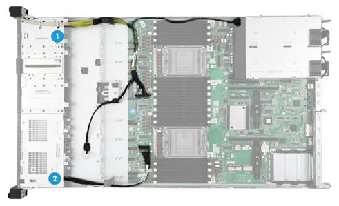

3.     Connect an AUX cable and power cord for the 2SFF drives at the rear.
Figure 32 Connecting an AUX cable and power cord for the 2SFF drives at the rear
(1) AUX cable
(2) Power cord

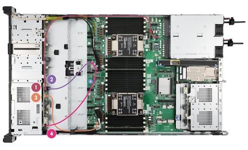

8SFF UniBay + 2SFF UniBay drives at the front + 2SFF drives at the rear
1.     Connect SAS/SATA data cables for 8SFF UniBay and 2SFF UniBay drives at the front and for 2SFF drives at the rear.
Figure 33 Connecting SAS/SATA data cables for 8SFF UniBay and 2SFF UniBay drives at the front and for 2SFF drives at the rear
2.     Connect AUX cables and power cords for 8SFF UniBay and 2SFF UniBay drives at the front.
Figure 34 Connecting AUX cables and power cords for 8SFF UniBay and 2SFF UniBay drives at the front
(1) Power cord for the 2SFF UniBay drives
(2) Power cord for the 8SFF UniBay drives
(3) AUX cable for the 2SFF UniBay drives
(4) AUX cable for the 8SFF UniBay drives
3.     Connect an AUX cable and power cord for 2SFF drives at the rear.
Figure 35 Connecting an AUX cable and power cord for 2SFF drives at the rear
(1) AUX cable
(2) Power cord
