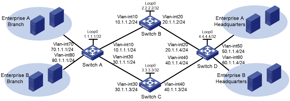

As shown in Figure 1, use RSVP-TE to establish two MPLS TE tunnels between Switch A and Switch D. The MPLS TE tunnel for Enterprise A requires a bandwidth of 20000 kbps. The MPLS TE tunnel for Enterprise B requires a bandwidth of 30000 kbps.
The maximum bandwidth of the link that each tunnel traverses is 50000 kbps and the maximum reservable bandwidth is 40000 kbps.
Figure 1 Network diagram
Analysis
To establish MPLS TE tunnels through RSVP-TE, you must perform the following tasks:
·     Enable MPLS, MPLS TE, and RSVP-TE on nodes that the MPLS TE tunnels traverse.
·     On each interface that the MPLS TE tunnels traverse, configure link TE attributes, including the maximum link bandwidth and the maximum reservable bandwidth.
·     On each node that the MPLS TE tunnels traverse, configure the IGP TE extension to advertise the link TE attributes, which generates a TEDB on each node.
Based on the TEDB, CSPF calculates the shortest, TE constraints-compliant path to the tunnel destination. If you do not configure the IGP TE extension, the path is created based on IGP routing. The supported IGP TE extensions are OSPF TE and ISIS TE. This example uses OSPF TE.
·     Create a tunnel interface on the ingress node of each MPLS TE tunnel, and perform the following tasks on the tunnel interface:
¡     Specify the tunnel destination address.
¡     Specify the tunnel bandwidth as required (20000 kbps for Enterprise A and 30000 kbps for Enterprise B).
¡     Specify the MPLS TE signaling protocol as RSVP-TE.
RSVP-TE advertises labels to establish CRLSPs and reserves bandwidth resources on each node along the calculated path.
·     On the ingress node of each MPLS TE tunnel, configure static routing to direct traffic to the MPLS TE tunnel.

6.     Configure MPLS TE tunnels on Switch A:
# Configure MPLS TE tunnel interface Tunnel 1 to forward traffic of Enterprise A.
[SwitchA] interface tunnel 1 mode mpls-te
[SwitchA-Tunnel1] ip address 7.1.1.1 255.255.255.0

7.     Configure static routing on Switch A to direct traffic to the MPLS TE tunnels:
# Configure a static route to direct traffic destined for 50.1.1.0/24 to MPLS TE tunnel interface Tunnel 1.
[SwitchA] ip route-static 50.1.1.0 24 tunnel 1 preference 1
# Configure a static route to direct traffic destined for 60.1.1.0/24 to MPLS TE tunnel interface Tunnel 2.
[SwitchA] ip route-static 60.1.1.0 24 tunnel 2 preference 1
