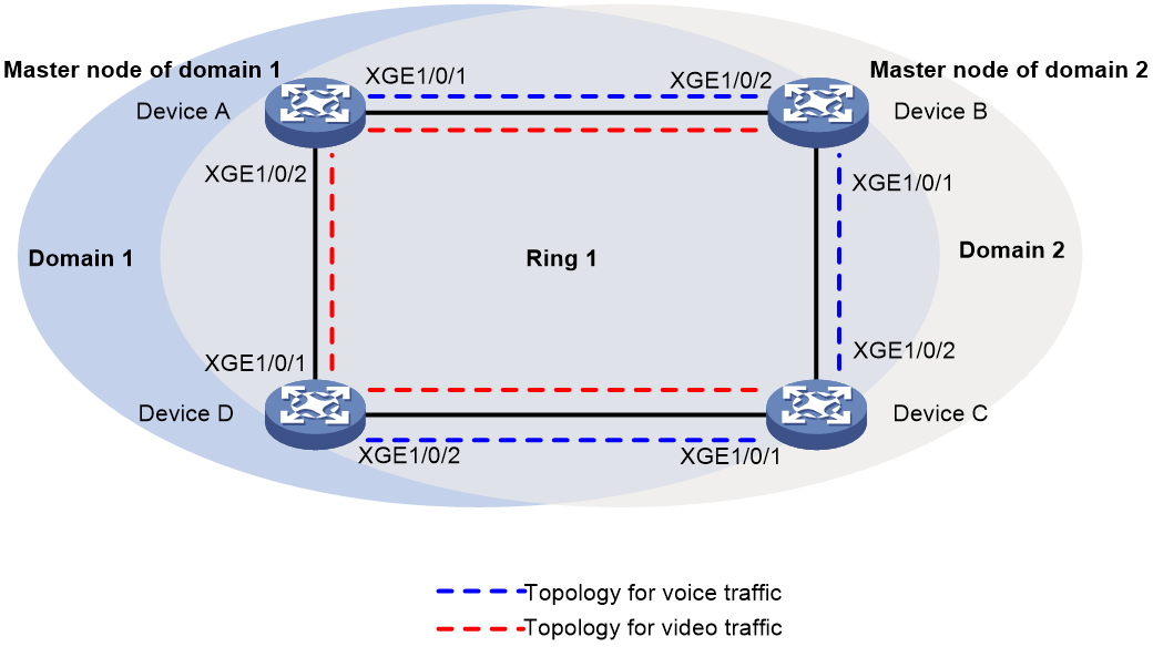

Example: Configuring a single ring
As shown in Figure 1, area A and area B are connected to a ring-shaped distribution layer network. Configure RRPP to implement the following requirements in the network:
·     Eliminate loops and implement link recovery in the Layer 2 network.
·     Implement link load balancing by forwarding voice traffic in VLAN 100 through VLAN 150 and video traffic in VLAN 151 through VLAN 200.
·     Improve RRPP topology convergence speed by setting the physical state change suppression interval to 0 seconds for all Ethernet interfaces on the RRPP ring.
Figure 1 Network diagram
Analysis
For voice and video traffic to be forwarded in different topologies, create two RRPP domains.
·     In RRPP domain 1, specify VLAN 100 through VLAN 150 as protected VLANs, and specify Device A as the master node.
·     In RRPP domain 2, specify VLAN 151 through VLAN 200 as protected VLANs, and specify Device B as the master node.
To implement load balancing for voice and video traffic, perform the following tasks:
·     On Device A, specify Ten-GigabitEthernet 1/0/1 as the primary port, and Ten-GigabitEthernet 1/0/2 as the secondary port.
·     On Device B, specify Ten-GigabitEthernet 1/0/2 as the primary port, and Ten-GigabitEthernet 1/0/1 as the secondary port.
Figure 2 Topologies for voice and video traffic

[DeviceC-rrpp-domain1] ring 1 node-mode transit primary-port ten-gigabitethernet 1/0/1 secondary-port ten-gigabitethernet 1/0/2 level 0
[DeviceC-rrpp-domain1] ring 1 enable
[DeviceC-rrpp-domain1] quit
# Create RRPP domain 2.
[DeviceC] rrpp domain 2
# Configure VLAN 2000 as the primary control VLAN of RRPP domain 2.
[DeviceC-rrpp-domain2] control-vlan 2000
# Configure the VLANs mapped to MSTI 2 as the protected VLANs of RRPP domain 2.
[DeviceC-rrpp-domain2] protected-vlan reference-instance 2
# Configure Device C as the transit node of primary ring 1, with Ten-GigabitEthernet 1/0/1 as the primary port and Ten-GigabitEthernet 1/0/2 as the secondary port. Enable ring 1.
[DeviceC-rrpp-domain2] ring 1 node-mode transit primary-port ten-gigabitethernet 1/0/1 secondary-port ten-gigabitethernet 1/0/2 level 0
[DeviceC-rrpp-domain2] ring 1 enable
[DeviceC-rrpp-domain2] quit
# Enable RRPP.
[DeviceC] rrpp enable
Configuring Device D
# Create VLANs 100 through 200.
<DeviceD> system-view
[DeviceD] vlan 100 to 200
# Map VLANs 100 through 150 to MSTI 1, and VLANs 151 through 200 to MSTI 2.
[DeviceD] stp region-configuration
[DeviceD-mst-region] instance 1 vlan 100 to 150
[DeviceD-mst-region] instance 2 vlan 151 to 200
# Activate the MST region configuration.
[DeviceD-mst-region] active region-configuration
[DeviceD-mst-region] quit
# Configure Ten-GigabitEthernet 1/0/1 as a trunk port.
[DeviceD] interface ten-gigabitethernet 1/0/1
[DeviceD-Ten-GigabitEthernet1/0/1] undo shutdown
[DeviceD-Ten-GigabitEthernet1/0/1] port link-type trunk
# Assign the port to VLANs 100 through 200, and remove it from VLAN 1.
[DeviceD-Ten-GigabitEthernet1/0/1] port trunk permit vlan 100 to 200
[DeviceD-Ten-GigabitEthernet1/0/1] undo port trunk permit vlan 1
# Set the physical state change suppression interval to 0 seconds on the port.
[DeviceD-Ten-GigabitEthernet1/0/1] link-delay up 0
[DeviceD-Ten-GigabitEthernet1/0/1] link-delay down 0
# Disable the spanning tree feature on the port.
[DeviceD-Ten-GigabitEthernet1/0/1] undo stp enable
[DeviceD-Ten-GigabitEthernet1/0/1] quit
# Configure Ten-GigabitEthernet 1/0/2 in the same way Ten-GigabitEthernet 1/0/1 is configured.
[DeviceD] interface ten-gigabitethernet 1/0/2
[DeviceD-Ten-GigabitEthernet1/0/2] undo shutdown
[DeviceD-Ten-GigabitEthernet1/0/2] port link-type trunk
[DeviceD-Ten-GigabitEthernet1/0/2] port trunk permit vlan 100 to 200
[DeviceD-Ten-GigabitEthernet1/0/2] undo port trunk permit vlan 1
[DeviceD-Ten-GigabitEthernet1/0/2] link-delay up 0
[DeviceD-Ten-GigabitEthernet1/0/2] link-delay down 0
[DeviceD-Ten-GigabitEthernet1/0/2] undo stp enable
[DeviceD-Ten-GigabitEthernet1/0/2] quit
# Create RRPP domain 1.
[DeviceD] rrpp domain 1
# Configure VLAN 1000 as the primary control VLAN of RRPP domain 1.
[DeviceD-rrpp-domain1] control-vlan 1000
# Configure the VLANs mapped to MSTI 1 as the protected VLANs of RRPP domain 1.
[DeviceD-rrpp-domain1] protected-vlan reference-instance 1
# Configure Device D as the transit node of primary ring 1, with Ten-GigabitEthernet 1/0/1 as the primary port and Ten-GigabitEthernet 1/0/2 as the secondary port. Enable ring 1.
[DeviceD-rrpp-domain1] ring 1 node-mode transit primary-port ten-gigabitethernet 1/0/1 secondary-port ten-gigabitethernet 1/0/2 level 0
[DeviceD-rrpp-domain1] ring 1 enable
[DeviceD-rrpp-domain1] quit
[DeviceD] rrpp domain 2
[DeviceD-rrpp-domain2] control-vlan 2000
[DeviceD-rrpp-domain2] protected-vlan reference-instance 2
[DeviceD-rrpp-domain2] ring 1 node-mode transit primary-port ten-gigabitethernet 1/0/1 secondary-port ten-gigabitethernet 1/0/2 level 0
[DeviceD-rrpp-domain2] ring 1 enable
[DeviceD-rrpp-domain2] quit
# Enable RRPP.
[DeviceD] rrpp enable
# View detailed information about RRPP domain 1 on Device A.
[DeviceA] display rrpp verbose domain 1
 Domain ID     : 1
Control VLAN  : Primary 1000, Secondary 1001
Protected VLAN: Reference instance 1
Hello timer   : 1 seconds, Fail timer: 3 seconds
Fast detection status: Disabled
Fast-Hello timer: 20 ms, Fast-Fail timer: 60 ms
Fast-Edge-Hello timer: 10 ms, Fast-Edge-Fail timer: 30 ms
Ring ID       : 1
Ring Level    : 0
Node Mode     : Master
Ring State    : Completed
Enable Status : Yes    Active Status: Yes
Primary port  : XGE1/0/1                    Port status: UP
Secondary port: XGE1/0/2                    Port status: BLOCKED
The output shows the following information:
·     Device A is the master node in RRPP domain 1.
·     The primary ring state of RRPP domain 1 is completed.
·     The primary port is up, and the secondary port is blocked.
# View detailed information about RRPP domain 2 on Device A.
[DeviceA] display rrpp verbose domain 2
Domain ID     : 2
Control VLAN  : Primary 2000, Secondary 2001
Protected VLAN: Reference instance 2
Ring ID       : 1
Ring Level    : 0
Node Mode     : Transit
Ring State    : -
Secondary port: XGE1/0/2                    Port status: UP
·     Device A is the transit node in RRPP domain 2.
·     The primary and secondary ports are up.
# View detailed information about RRPP domain 1 on Device B.
[DeviceB] display rrpp verbose domain 1
 Domain ID     : 1
Ring ID       : 1
Ring Level    : 0
Node Mode     : Transit
Ring State    : -
Primary port  : XGE1/0/2                    Port status: UP
Secondary port: XGE1/0/1                    Port status: UP
·     Device B is the transit node in RRPP domain 1.
# View detailed information about RRPP domain 2 on Device B.
[DeviceB] display rrpp verbose domain 2
 Domain ID     : 2
Ring ID       : 1
Ring Level    : 0
Node Mode     : Master
Secondary port: XGE1/0/1                    Port status: BLOCKED
·     Device B is the master node in RRPP domain 2.
·     The primary ring state of RRPP domain 2 is completed.
# View detailed information about RRPP domain 1 on Device C.
[DeviceC] display rrpp verbose domain 1
 Domain ID     : 1
Ring ID       : 1
Ring Level    : 0
Node Mode     : Transit
Ring State    : -
·     Device C is the transit node in RRPP domain 1.
# View detailed information about RRPP domain 2 on Device C.
[DeviceC] display rrpp verbose domain 2
 Domain ID     : 2
Ring ID       : 1
Ring Level    : 0
Node Mode     : Transit
Ring State    : -
·     Device C is the transit node in RRPP domain 2.
# View detailed RRPP domain information on Device D. (Details not shown.)

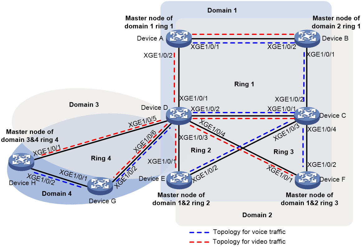

Example: Configuring intersecting rings
As shown in Figure 3, a ring-shaped access layer network is connected to a ring-shaped distribution layer network. Configure RRPP to implement the following requirements in the network:
Figure 3 Network diagram
Analysis
·     In RRPP domain 1, specify VLAN 100 through VLAN 150 as protected VLANs. Specify Device A as the master node of primary ring 1, and Device E as the master node of subring 2.
·     In RRPP domain 2, specify VLAN 151 through VLAN 200 as protected VLANs. Specify Device B as the master node of primary ring 1, and Device F as the master node of subring 2.
·     On Device E, specify Ten-GigabitEthernet 1/0/2 as the primary port, and Ten-GigabitEthernet 1/0/1 as the secondary port.
·     On Device F, specify Ten-GigabitEthernet 1/0/1 as the primary port, and Ten-GigabitEthernet 1/0/2 as the secondary port.
Figure 4 Topologies for voice and video traffic
Software versions used
This configuration example was created and verified on Release 3606.
When you configure intersecting rings, follow these restrictions and guidelines:
·     When you configure an edge node or assistant edge node, you must configure the primary ring before configuring the subrings.
·     After you configure RRPP rings for an RRPP domain, you cannot delete or modify the primary control VLAN of the domain. You can only use the undo control-vlan command to delete a primary control VLAN.
·     When you configure load balancing, you must configure different protected VLANs for different RRPP domains.
·     Before you enable subrings on a device, you must enable the primary ring. Before you disable the primary ring on the device, you must disable all subrings.
·     If a device carries multiple RRPP rings in an RRPP domain, it can only be an edge node or an assistant edge node on a subring.
·     To prevent Hello packets of subrings from being looped on the primary ring, first enable the primary ring on its master node. Then enable the subrings on their respective master nodes.
Procedures

Configuring Device E
<DeviceE> system-view
[DeviceE] vlan 100 to 200
[DeviceE] stp region-configuration
[DeviceE-mst-region] instance 1 vlan 100 to 150
[DeviceE-mst-region] instance 2 vlan 151 to 200
[DeviceE-mst-region] active region-configuration
[DeviceE-mst-region] quit
[DeviceE] interface ten-gigabitethernet 1/0/1
[DeviceE-Ten-GigabitEthernet1/0/1] undo shutdown
[DeviceE-Ten-GigabitEthernet1/0/1] port link-type trunk
[DeviceE-Ten-GigabitEthernet1/0/1] port trunk permit vlan 100 to 200
[DeviceE-Ten-GigabitEthernet1/0/1] undo port trunk permit vlan 1
[DeviceE-Ten-GigabitEthernet1/0/1] link-delay up 0
[DeviceE-Ten-GigabitEthernet1/0/1] link-delay down 0
[DeviceE-Ten-GigabitEthernet1/0/1] undo stp enable
[DeviceE-Ten-GigabitEthernet1/0/1] quit
[DeviceE] interface ten-gigabitethernet 1/0/2
[DeviceE-Ten-GigabitEthernet1/0/2] undo shutdown
[DeviceE-Ten-GigabitEthernet1/0/2] port link-type trunk
[DeviceE-Ten-GigabitEthernet1/0/2] port trunk permit vlan 100 to 200
[DeviceE-Ten-GigabitEthernet1/0/2] undo port trunk permit vlan 1
[DeviceE-Ten-GigabitEthernet1/0/2] link-delay up 0
[DeviceE-Ten-GigabitEthernet1/0/2] link-delay down 0
[DeviceE-Ten-GigabitEthernet1/0/2] undo stp enable
[DeviceE-Ten-GigabitEthernet1/0/2] quit
[DeviceE] rrpp domain 1
[DeviceE-rrpp-domain1] control-vlan 1000
[DeviceE-rrpp-domain1] protected-vlan reference-instance 1
# Configure Device E as the master node of subring 2, with Ten-GigabitEthernet 1/0/2 as the primary port and Ten-GigabitEthernet 1/0/1 as the secondary port. Enable ring 2.
[DeviceE-rrpp-domain1] ring 2 node-mode master primary-port ten-gigabitethernet 1/0/2 secondary-port ten-gigabitethernet 1/0/1 level 1
[DeviceE-rrpp-domain1] ring 2 enable
[DeviceE-rrpp-domain1] quit
[DeviceE] rrpp domain 2
[DeviceE-rrpp-domain2] control-vlan 2000
[DeviceE-rrpp-domain2] protected-vlan reference-instance 2
# Configure Device E as the transit node of subring 2, with Ten-GigabitEthernet 1/0/2 as the primary port and Ten-GigabitEthernet 1/0/1 as the secondary port. Enable ring 2.
[DeviceE-rrpp-domain2] ring 2 node-mode transit primary-port ten-gigabitethernet 1/0/2 secondary-port ten-gigabitethernet 1/0/1 level 1
[DeviceE-rrpp-domain2] ring 2 enable
[DeviceE-rrpp-domain2] quit
# Enable RRPP.
[DeviceE] rrpp enable
Configuring Device F
<DeviceF> system-view
[DeviceF] vlan 100 to 200
[DeviceF] stp region-configuration
[DeviceF-mst-region] instance 1 vlan 100 to 150
[DeviceF-mst-region] instance 2 vlan 151 to 200
[DeviceF-mst-region] active region-configuration
[DeviceF-mst-region] quit
[DeviceF] interface ten-gigabitethernet 1/0/1
[DeviceF-Ten-GigabitEthernet1/0/1] undo shutdown
[DeviceF-Ten-GigabitEthernet1/0/1] port link-type trunk
[DeviceF-Ten-GigabitEthernet1/0/1] port trunk permit vlan 100 to 200
[DeviceF-Ten-GigabitEthernet1/0/1] undo port trunk permit vlan 1
[DeviceF-Ten-GigabitEthernet1/0/1] link-delay up 0
[DeviceF-Ten-GigabitEthernet1/0/1] link-delay down 0
[DeviceF-Ten-GigabitEthernet1/0/1] undo stp enable
[DeviceF-Ten-GigabitEthernet1/0/1] quit
[DeviceF] interface ten-gigabitethernet 1/0/2
[DeviceF-Ten-GigabitEthernet1/0/2] undo shutdown
[DeviceF-Ten-GigabitEthernet1/0/2] port link-type trunk
[DeviceF-Ten-GigabitEthernet1/0/2] port trunk permit vlan 100 to 200
[DeviceF-Ten-GigabitEthernet1/0/2] undo port trunk permit vlan 1
[DeviceF-Ten-GigabitEthernet1/0/2] link-delay up 0
[DeviceF-Ten-GigabitEthernet1/0/2] link-delay down 0
[DeviceF-Ten-GigabitEthernet1/0/2] undo stp enable
[DeviceF-Ten-GigabitEthernet1/0/2] quit
[DeviceF] rrpp domain 1
[DeviceF-rrpp-domain1] control-vlan 1000
[DeviceF-rrpp-domain1] protected-vlan reference-instance 1
# Configure Device F as the transit node of subring 2, with Ten-GigabitEthernet 1/0/1 as the primary port and Ten-GigabitEthernet 1/0/2 as the secondary port. Enable ring 2.
[DeviceF-rrpp-domain1] ring 2 node-mode transit primary-port ten-gigabitethernet 1/0/1 secondary-port ten-gigabitethernet 1/0/2 level 1
[DeviceF-rrpp-domain1] ring 2 enable
[DeviceF-rrpp-domain1] quit
[DeviceF] rrpp domain 2
[DeviceF-rrpp-domain2] control-vlan 2000
[DeviceF-rrpp-domain2] protected-vlan reference-instance 2
# Configure Device F as the master node of subring 2, with Ten-GigabitEthernet 1/0/1 as the primary port and Ten-GigabitEthernet 1/0/2 as the secondary port. Enable ring 2.
[DeviceF-rrpp-domain2] ring 2 node-mode master primary-port ten-gigabitethernet 1/0/1 secondary-port ten-gigabitethernet 1/0/2 level 1
[DeviceF-rrpp-domain2] ring 2 enable
[DeviceF-rrpp-domain2] quit
# Enable RRPP.
[DeviceF] rrpp enable

Example: Configuring dual-homed intersecting rings
As shown in Figure 5, a ring-shaped campus network is connected to a ring-shaped distribution layer network through an access layer device. Configure RRPP to implement the following requirements in the network:
·     Reduce the number of Edge-Hello packets.
Figure 5 Network diagram
Analysis
For voice and video traffic to be forwarded in different topologies, create four RRPP domains.
·     In RRPP domain 1 and domain 4, specify VLAN 100 through VLAN 150 as protected VLANs, and configure the node roles as follows:
¡     Specify Device A as the master node of primary ring 1.
¡     Specify Device E as the master node of subring 2.
¡     Specify Device F as the master node of subring 3.
¡     Specify Device H as the master node of subring 4.
·     In RRPP domain 2 and domain 3, specify VLAN 151 through VLAN 200 as protected VLANs, and configure the node roles as follows:
¡     Specify Device B as the master node of primary ring 1.
·     On Device E, specify Ten-GigabitEthernet 1/0/1 as the secondary port in RRPP domain 1 and primary port in RRPP domain 2. Specify Ten-GigabitEthernet 1/0/2 as the primary port in RRPP domain 1 and secondary port in RRPP domain 2.
·     On Device F, specify Ten-GigabitEthernet 1/0/1 as the secondary port in RRPP domain 1 and primary port in RRPP domain 2. Specify Ten-GigabitEthernet 1/0/2 as the primary port in RRPP domain 1 and secondary port in RRPP domain 2.
·     On Device H, specify Ten-GigabitEthernet 1/0/1 as the primary port in RRPP domain 3 and secondary port in RRPP domain 4. Specify Ten-GigabitEthernet 1/0/2 as the secondary port in RRPP domain 3 and primary port in RRPP domain 4.
To reduce the number of Edge-Hello packets, add ring 2 and ring 3 in RRPP domain 1 and 2 to a ring group.
Figure 6 Topologies for voice and video traffic

[DeviceD-rrpp-domain1] ring 3 enable
# Configure Device D as the assistant edge node of subring 2, with Ten-GigabitEthernet 1/0/3 as the edge port. Enable ring 2.
[DeviceD-rrpp-domain2] ring 2 node-mode assistant-edge edge-port ten-gigabitethernet 1/0/3
[DeviceD-rrpp-domain2] ring 2 enable
# Configure Device D as the assistant edge node of subring 3, with Ten-GigabitEthernet 1/0/4 as the edge port. Enable ring 3.
[DeviceD-rrpp-domain2] ring 3 node-mode assistant-edge edge-port ten-gigabitethernet 1/0/4
[DeviceD-rrpp-domain2] ring 3 enable
# Create RRPP domain 3.
[DeviceD] rrpp domain 3
# Configure VLAN 3000 as the primary control VLAN of RRPP domain 3.
[DeviceD-rrpp-domain3] control-vlan 3000
# Configure the VLANs mapped to MSTI 1 as the protected VLANs of RRPP domain 3.
[DeviceD-rrpp-domain3] protected-vlan reference-instance 1
# Configure Device D as the transit node of primary ring 4, with Ten-GigabitEthernet 1/0/5 as the primary port and Ten-GigabitEthernet 1/0/6 as the secondary port. Enable ring 4.
[DeviceD-rrpp-domain3] ring 4 node-mode transit primary-port ten-gigabitethernet 1/0/5 secondary-port ten-gigabitethernet 1/0/6 level 0
[DeviceD-rrpp-domain3] ring 4 enable
[DeviceD-rrpp-domain3] quit
# Create RRPP domain 4.
[DeviceD] rrpp domain 4
# Configure VLAN 4000 as the primary control VLAN of RRPP domain 4.
[DeviceD-rrpp-domain4] control-vlan 4000
# Configure the VLANs mapped to MSTI 2 as the protected VLANs of RRPP domain 4.
[DeviceD-rrpp-domain4] protected-vlan reference-instance 2
[DeviceD-rrpp-domain4] ring 4 node-mode transit primary-port ten-gigabitethernet 1/0/5 secondary-port ten-gigabitethernet 1/0/6 level 0
[DeviceD-rrpp-domain4] ring 4 enable
[DeviceD-rrpp-domain4] quit
# Create RRPP ring group 1, and add subrings 2 and 3 in RRPP domains 1 and 2 to the RRPP ring group.
[DeviceD] rrpp ring 1
[DeviceD-ring-group1] domain 1 ring 2 3
[DeviceD-ring-group1] domain 2 ring 2 3
[DeviceD-ring-group1] quit
# Enable RRPP.
# Configure Device E as the master node of subring 2, with Ten-GigabitEthernet 1/0/1 as the primary port and Ten-GigabitEthernet 1/0/2 as the secondary port. Enable ring 2.
[DeviceE-rrpp-domain2] ring 2 node-mode master primary-port ten-gigabitethernet 1/0/1 secondary-port ten-gigabitethernet 1/0/2 level 1
# Enable RRPP.
# Configure Device F as the master node of subring 3, with Ten-GigabitEthernet 1/0/2 as the primary port and Ten-GigabitEthernet 1/0/1 as the secondary port. Enable ring 3.
[DeviceF-rrpp-domain1] ring 3 node-mode master primary-port ten-gigabitethernet 1/0/2 secondary-port ten-gigabitethernet 1/0/1 level 1
[DeviceF-rrpp-domain1] ring 3 enable
# Configure Device F as the master node of subring 3, with Ten-GigabitEthernet 1/0/1 as the primary port and Ten-GigabitEthernet 1/0/2 as the secondary port. Enable ring 3.
[DeviceF-rrpp-domain2] ring 3 node-mode master primary-port ten-gigabitethernet 1/0/1 secondary-port ten-gigabitethernet 1/0/2 level 1
[DeviceF-rrpp-domain2] ring 3 enable
# Enable RRPP.
Configuring Device G
<DeviceG> system-view
[DeviceG] vlan 100 to 200
[DeviceG] stp region-configuration
[DeviceG-mst-region] instance 1 vlan 100 to 150
[DeviceG-mst-region] instance 2 vlan 151 to 200
[DeviceG-mst-region] active region-configuration
[DeviceG-mst-region] quit
[DeviceG] interface ten-gigabitethernet 1/0/1
[DeviceG-Ten-GigabitEthernet1/0/1] undo shutdown
[DeviceG-Ten-GigabitEthernet1/0/1] port link-type trunk
[DeviceG-Ten-GigabitEthernet1/0/1] port trunk permit vlan 100 to 200
[DeviceG-Ten-GigabitEthernet1/0/1] undo port trunk permit vlan 1
[DeviceG-Ten-GigabitEthernet1/0/1] link-delay up 0
[DeviceG-Ten-GigabitEthernet1/0/1] link-delay down 0
[DeviceG-Ten-GigabitEthernet1/0/1] undo stp enable
[DeviceG-Ten-GigabitEthernet1/0/1] quit
[DeviceG] interface ten-gigabitethernet 1/0/2
[DeviceG-Ten-GigabitEthernet1/0/2] undo shutdown
[DeviceG-Ten-GigabitEthernet1/0/2] port link-type trunk
[DeviceG-Ten-GigabitEthernet1/0/2] port trunk permit vlan 100 to 200
[DeviceG-Ten-GigabitEthernet1/0/2] undo port trunk permit vlan 1
[DeviceG-Ten-GigabitEthernet1/0/2] link-delay up 0
[DeviceG-Ten-GigabitEthernet1/0/2] link-delay down 0
[DeviceG-Ten-GigabitEthernet1/0/2] undo stp enable
[DeviceG-Ten-GigabitEthernet1/0/2] quit
[DeviceG] rrpp domain 3
[DeviceG-rrpp-domain3] control-vlan 3000
[DeviceG-rrpp-domain3] protected-vlan reference-instance 1
# Configure Device G as the transit node of primary ring 4, with Ten-GigabitEthernet 1/0/2 as the primary port and Ten-GigabitEthernet 1/0/1 as the secondary port. Enable ring 4.
[DeviceG-rrpp-domain1] ring 4 node-mode transit primary-port ten-gigabitethernet 1/0/2 secondary-port ten-gigabitethernet 1/0/1 level 0
[DeviceG-rrpp-domain1] ring 4 enable
[DeviceG-rrpp-domain1] quit
[DeviceG] rrpp domain 4
[DeviceG-rrpp-domain4] control-vlan 4000
[DeviceG-rrpp-domain4] protected-vlan reference-instance 2
[DeviceG-rrpp-domain4] ring 4 node-mode transit primary-port ten-gigabitethernet 1/0/2 secondary-port ten-gigabitethernet 1/0/1 level 0
[DeviceG-rrpp-domain4] ring 4 enable
[DeviceG-rrpp-domain4] quit
# Enable RRPP.
[DeviceG] rrpp enable
Configuring Device H
<DeviceH> system-view
[DeviceH] vlan 100 to 200
[DeviceH] stp region-configuration
[DeviceH-mst-region] instance 1 vlan 100 to 150
[DeviceH-mst-region] instance 2 vlan 151 to 200
[DeviceH-mst-region] active region-configuration
[DeviceH-mst-region] quit
[DeviceH] interface ten-gigabitethernet 1/0/1
[DeviceH-Ten-GigabitEthernet1/0/1] undo shutdown
[DeviceH-Ten-GigabitEthernet1/0/1] port link-type trunk
[DeviceH-Ten-GigabitEthernet1/0/1] port trunk permit vlan 100 to 200
[DeviceH-Ten-GigabitEthernet1/0/1] undo port trunk permit vlan 1
[DeviceH-Ten-GigabitEthernet1/0/1] link-delay up 0
[DeviceH-Ten-GigabitEthernet1/0/1] link-delay down 0
[DeviceH-Ten-GigabitEthernet1/0/1] undo stp enable
[DeviceH-Ten-GigabitEthernet1/0/1] quit
[DeviceH] interface ten-gigabitethernet 1/0/2
[DeviceH-Ten-GigabitEthernet1/0/2] undo shutdown
[DeviceH-Ten-GigabitEthernet1/0/2] port link-type trunk
[DeviceH-Ten-GigabitEthernet1/0/2] port trunk permit vlan 100 to 200
[DeviceH-Ten-GigabitEthernet1/0/2] undo port trunk permit vlan 1
[DeviceH-Ten-GigabitEthernet1/0/2] link-delay up 0
[DeviceH-Ten-GigabitEthernet1/0/2] link-delay down 0
[DeviceH-Ten-GigabitEthernet1/0/2] undo stp enable
[DeviceH-Ten-GigabitEthernet1/0/2] quit
[DeviceH] rrpp domain 3
 Domain ID     : 1
Ring ID       : 1
Ring Level    : 0
Node Mode     : Master
·     Device A is the master node of primary ring 1 in RRPP domain 1.
 Domain ID     : 2
Ring ID       : 1
Ring Level    : 0
Node Mode     : Transit
Ring State    : -
·     Device A is the transit node of primary ring 1 in RRPP domain 2.
 Domain ID     : 1
Ring ID       : 1
Ring Level    : 0
Node Mode     : Transit
Ring State    : -
·     Device B is the transit node of primary ring 1 in RRPP domain 1.
 Domain ID     : 2
Ring ID       : 1
Ring Level    : 0
Node Mode     : Master
·     Device B is the master node of primary ring 1 in RRPP domain 2.
 Domain ID     : 1
Ring ID       : 1
Ring Level    : 0
Node Mode     : Transit
Ring State    : -
Ring ID       : 2
Ring Level    : 1
Node Mode     : Edge
Ring State    : -
Common port   : XGE1/0/1                    Port status: UP
Edge port     : XGE1/0/3                    Port status: UP
Ring ID       : 3
Ring Level    : 1
Node Mode     : Edge
Ring State    : -
Edge port     : XGE1/0/4                    Port status: UP
·     Device C is the transit node of primary ring 1 and edge node of subrings 2 and 3 in RRPP domain 1.
 Domain ID     : 2
Ring ID       : 1
Ring Level    : 0
Node Mode     : Transit
Ring State    : -
Ring ID       : 2
Ring Level    : 1
Node Mode     : Edge
Ring State    : -
Ring ID       : 3
Ring Level    : 1
Node Mode     : Edge
Ring State    : -
·     Device C is the transit node of primary ring 1 and edge node of subrings 2 and 3 in RRPP domain 2.
# View RRPP ring group information for the edge node and assistant edge node on Device C.
[DeviceC] display rrpp ring-group 1
Ring Group 1:
Domain 1 Ring 2 to 3
Domain 2 Ring 2 to 3
# View detailed information about RRPP domain 1 on Device D.
[DeviceD] display rrpp verbose domain 1
 Domain ID     : 1
Ring ID       : 1
Ring Level    : 0
Node Mode     : Transit
Ring State    : -
Ring ID       : 2
Ring Level    : 1
Node Mode     : Assistant-edge
Ring State    : -
Ring ID       : 3
Ring Level    : 1
Ring State    : -
·     Device D is the transit node of primary ring 1 and assistant edge node of subrings 2 and 3 in RRPP domain 1.
# View detailed information about RRPP domain 2 on Device D.
[DeviceD] display rrpp verbose domain 2
 Domain ID     : 2
Ring ID       : 1
Ring Level    : 0
Node Mode     : Transit
Ring State    : -
Ring ID       : 2
Ring Level    : 1
Ring State    : -
Ring ID       : 3
Ring Level    : 1
Ring State    : -
·     Device D is the transit node of primary ring 1 and assistant edge node of subrings 2 and 3 in RRPP domain 2.
# View detailed information about RRPP domain 3 on Device D.
[DeviceD] display rrpp verbose domain 3
 Domain ID     : 3
 Control VLAN  : Primary 3000, Secondary 3001
Ring ID       : 4
Ring Level    : 0
Node Mode     : Transit
Ring State    : -
Primary port  : XGE1/0/5                    Port status: UP
Secondary port: XGE1/0/6                    Port status: UP
·     Device D is the transit node of primary ring 4 in RRPP domain 3.
# View detailed information about RRPP domain 4 on Device D.
[DeviceD] display rrpp verbose domain 4
 Domain ID     : 4
 Control VLAN  : Primary 4000, Secondary 4001
Ring ID       : 4
Ring Level    : 0
Node Mode     : Transit
Ring State    : -
·     Device D is the transit node of primary ring 4 in RRPP domain 4.
# View RRPP ring group information for the edge node and assistant edge node on Device D.
[DeviceD] display rrpp ring-group 1
Ring Group 1:
# View detailed information about RRPP domain 1 on Device E.
[DeviceE] display rrpp verbose domain 1
 Domain ID     : 1
Ring ID       : 2
Ring Level    : 1
Node Mode     : Master
·     Device E is the master node of subring 2 in RRPP domain 1.
·     The subring state of RRPP domain 1 is completed.
# View detailed information about RRPP domain 2 on Device E.
[DeviceE] display rrpp verbose domain 2
 Domain ID     : 2
Ring ID       : 2
Ring Level    : 1
Node Mode     : Master
·     Device E is the master node of subring 2 in RRPP domain 2.
·     The subring state of RRPP domain 2 is completed.
# View detailed information about RRPP domain 1 on Device F.
[DeviceF] display rrpp verbose domain 1
 Domain ID     : 1
Ring ID       : 3
Ring Level    : 1
Node Mode     : Master
·     Device F is the master node of subring 3 in RRPP domain 1.
# View detailed information about RRPP domain 2 on Device F.
[DeviceF] display rrpp verbose domain 2
 Domain ID     : 2
Ring ID       : 3
Ring Level    : 1
Node Mode     : Master
·     Device F is the master node of subring 3 in RRPP domain 2.
# View detailed information about RRPP domain 3 on Device H.
[DeviceH] display rrpp verbose domain 3
 Domain ID     : 3
Ring ID       : 4
Ring Level    : 0
Node Mode     : Master
·     Device H is the master node of primary ring 4 in RRPP domain 3.
·     The primary ring state of RRPP domain 3 is completed.
# View detailed information about RRPP domain 4 on Device H.
[DeviceH] display rrpp verbose domain 4
 Domain ID     : 4
Ring ID       : 4
Ring Level    : 0
Node Mode     : Master
·     Device H is the master node of primary ring 4 in RRPP domain 4.
·     The primary ring state of RRPP domain 4 is completed.
# View detailed information about RRPP domain 3 on Device G.
[DeviceG] display rrpp verbose domain 3
 Domain ID     : 3
Ring ID       : 4
Ring Level    : 0
Node Mode     : Transit
Ring State    : -
·     Device G is the transit node of primary ring 4 in RRPP domain 3.
# View detailed information about RRPP domain 4 on Device G.
[DeviceG] display rrpp verbose domain 4
 Domain ID     : 4
Ring ID       : 4
Ring Level    : 0
Node Mode     : Transit
Ring State    : -
·     Device G is the transit node of primary ring 4 in RRPP domain 4.
 ring 2 node-mode master primary-port Ten-GigabitEthernet1/0/2 secondary-port Ten-GigabitEthernet1/0/1 level 1
 ring 2 enable
rrpp domain 2
 control-vlan 2000
 ring 2 node-mode master primary-port Ten-GigabitEthernet1/0/1 secondary-port Ten-GigabitEthernet1/0/2 level 1
 ring 2 enable
rrpp enable
·     Device F:
 sysname DeviceF
vlan 1
vlan 100 to 200
interface Ten-GigabitEthernet1/0/1
 link-delay up 0
 link-delay down 0
 undo stp enable
interface Ten-GigabitEthernet1/0/2
 link-delay up 0
 link-delay down 0
 undo stp enable
rrpp domain 1
 control-vlan 1000
 ring 3 node-mode master primary-port Ten-GigabitEthernet1/0/2 secondary-port Ten-GigabitEthernet1/0/1 level 1
 ring 3 enable
rrpp domain 2
 control-vlan 2000
 ring 3 node-mode master primary-port Ten-GigabitEthernet1/0/1 secondary-port Ten-GigabitEthernet1/0/2 level 1
 ring 3 enable
rrpp enable
·     Device G:
 sysname DeviceG
vlan 1
vlan 100 to 200
 link-delay up 0
 link-delay down 0
 undo stp enable
 link-delay up 0
 link-delay down 0
 undo stp enable
rrpp domain 3
 control-vlan 3000
 ring 4 node-mode transit primary-port Ten-GigabitEthernet1/0/2 secondary-port Ten-GigabitEthernet1/0/1 level 0
 ring 4 enable
rrpp domain 4
 control-vlan 4000
 ring 4 node-mode master primary-port Ten-GigabitEthernet1/0/2 secondary-port Ten-GigabitEthernet1/0/1 level 0
 ring 4 enable
rrpp enable
·     Device H:
 sysname DeviceH
vlan 1
vlan 100 to 200
 link-delay up 0
 link-delay down 0
 undo stp enable
 link-delay up 0
 link-delay down 0
 undo stp enable
rrpp domain 3
 control-vlan 3000
 ring 4 node-mode master primary-port Ten-GigabitEthernet1/0/1 secondary-port Ten-GigabitEthernet1/0/2 level 0
 ring 4 enable
rrpp domain 4
 control-vlan 4000
 ring 4 enable
rrpp enable
