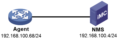

As shown in Figure 1, an IMC server acts as the NMS and the device acts as the agent. The NMS uses SNMPv1/SNMPv2c to manage the SNMP agent, and the agent automatically sends notifications to report events to the NMS.
Figure 1 Network diagram

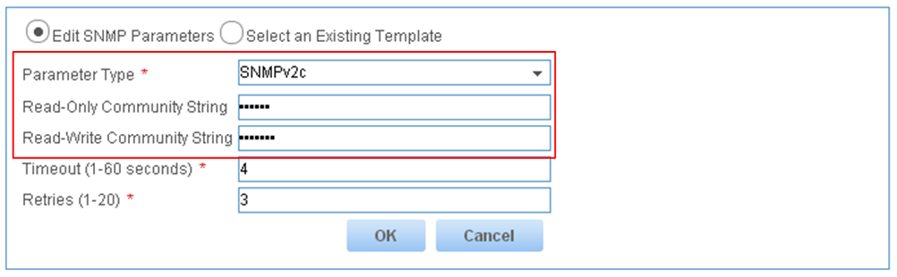

2.     Configure SNMP parameters:
a.     Expand the SNMP Settings area.
b.     Click Configure.
c.     On the page that appears, configure the following parameters:
-     Select SNMPv2c from the Parameter Type list.
-     Enter readtest in the Read-Only Community String field.
-     Enter writetest in the Read-Write Community String field.
-     Use the default values for other parameters.
-     Click OK.
Figure 3 Configuring SNMP parameters
