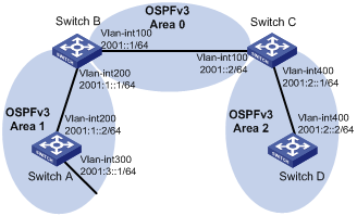

Example: Configuring OSPFv3 stub area
As shown in Figure 2:
·           Enable OSPFv3 on all switches.
·           Split the AS into three areas.
·           Configure Switch B and Switch C as ABRs to forward routing information between areas.
·           Configure Area 2 as a stub area to reduce LSAs in the area without affecting route reachability.
Figure 2 Network diagram

# Display OSPFv3 neighbors on Switch B.
[SwitchB] display ospfv3 peer
               OSPFv3 Process 1 with Router ID 2.2.2.2
 Area: 0.0.0.0
 Router ID       Pri State             Dead-Time InstID Interface
 3.3.3.3         1   Full/BDR          00:00:40  0      Vlan100
 Area: 0.0.0.1
 1.1.1.1         1   Full/DR           00:00:40  0      Vlan200
# Display OSPFv3 neighbors on Switch C.
[SwitchC] display ospfv3 peer
               OSPFv3 Process 1 with Router ID 3.3.3.3
 Area: 0.0.0.0
 2.2.2.2         1   Full/DR           00:00:40  0      Vlan100
 Area: 0.0.0.2
 4.4.4.4         1   Full/BDR          00:00:40  0      Vlan400
# Display OSPFv3 routing table information on Switch D.
[SwitchD] display ospfv3 routing
               OSPFv3 Process 1 with Router ID 4.4.4.4
 I  - Intra area route,  E1 - Type 1 external route,  N1 - Type 1 NSSA route
 IA - Inter area route,  E2 - Type 2 external route,  N2 - Type 2 NSSA route
 *  - Selected route
 *Destination: 2001::/64
  Type       : IA                        Area       : 0.0.0.2
  AdvRouter  : 3.3.3.3                   Preference : 10
  NibID      : 0x23000004                Cost       : 2
  Interface  : Vlan400                   BkInterface: N/A
  Nexthop    : FE80::48C0:26FF:FEDA:305
  BkNexthop  : N/A
 *Destination: 2001:1::/64
  NibID      : 0x23000004                Cost       : 3
  BkNexthop  : N/A
 *Destination: 2001:2::/64
  Type       : I                         Area       : 0.0.0.2
  AdvRouter  : 4.4.4.4                   Preference : 10
  NibID      : 0x23000002                Cost       : 1
  Nexthop    : ::
  BkNexthop  : N/A
 *Destination: 2001:3::1/128
  BkNexthop  : N/A
 Total: 4
 Intra area: 1         Inter area: 3         ASE: 0         NSSA: 0
3.      Configure Area 2 as a stub area:
# Configure Switch D.
[SwitchD] ospfv3
[SwitchD-ospfv3-1] area 2
[SwitchD-ospfv3-1-area-0.0.0.2] stub
# Configure Switch C, and specify the cost of the default route sent to the stub area as 10.
[SwitchC] ospfv3
[SwitchC-ospfv3-1] area 2
[SwitchC-ospfv3-1-area-0.0.0.2] stub
[SwitchC-ospfv3-1-area-0.0.0.2] default-cost 10
 *  - Selected route
 *Destination: ::/0
  NibID      : 0x23000003                Cost       : 11
  BkNexthop  : N/A
  NibID      : 0x23000003                Cost       : 2
  BkNexthop  : N/A
  NibID      : 0x23000003                Cost       : 3
  BkNexthop  : N/A
  NibID      : 0x23000001                Cost       : 1
  Nexthop    : ::
  BkNexthop  : N/A
  BkNexthop  : N/A
 Total: 5
 Intra area: 1         Inter area: 4         ASE: 0         NSSA: 0
The output shows that a default route is added, and its cost is the cost of a direct route plus the configured cost.
4.      Configure Area 2 as a totally stub area:
# Configure Area 2 as a totally stub area on Switch C.
[SwitchC-ospfv3-1-area-0.0.0.2] stub no-summary
 *  - Selected route
 *Destination: ::/0
  BkNexthop  : N/A
  Nexthop    : ::
  BkNexthop  : N/A
 Total: 2
 Intra area: 1         Inter area: 1         ASE: 0         NSSA: 0
The output shows that route entries are reduced. All indirect routes are removed, except the default route.

·           Configure Area 1 as an NSSA area and configure Switch A as an ASBR to redistribute static routes into the AS.
Figure 3 Network diagram
1.      Configure IPv6 addresses for interfaces. (Details not shown.)
2.      Configure basic OSPFv3 (see "Example: Configuring OSPFv3 stub area").
3.      Configure Area 1 as an NSSA area:

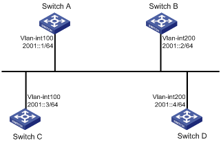

Example: Configuring OSPFv3 DR election
As shown in Figure 4:
·           Configure router priority 100 for Switch A, the highest priority on the network, so it will become the DR.
·           Configure router priority 2 for Switch C, the second highest priority on the network, so it will become the BDR.
·           Configure router priority 0 for Switch B, so it cannot become a DR or BDR.
·           Switch D uses the default router priority 1.
Figure 4 Network diagram

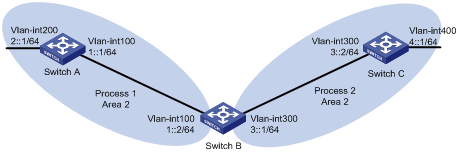

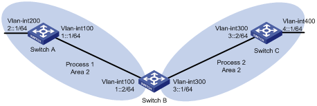

Example: Configuring OSPFv3 route redistribution
As shown in Figure 5:
·           Switch A, Switch B, and Switch C are in Area 2.
·           OSPFv3 process 1 and OSPFv3 process 2 run on Switch B. Switch B communicates with Switch A and Switch C through OSPFv3 process 1 and OSPFv3 process 2.
·           Configure OSPFv3 process 2 to redistribute direct routes and the routes from OSPFv3 process 1 on Switch B, and set the metric for redistributed routes to 3. Switch C can then learn the routes destined for 1::0/64 and 2::0/64, and Switch A cannot learn the routes destined for 3::0/64 or 4::0/64.
Figure 5 Network diagram
2.      Configure basic OSPFv3:

Example: Configuring OSPFv3 route summarization
As shown in Figure 6:
·           OSPFv3 process 1 and OSPFv3 process 2 run on Switch B. Switch B communicates with Switch A and Switch C through OSPFv3 process 1 and OSPFv3 process 2, respectively.
·           On Switch A, configure IPv6 addresses 2:1:1::1/64, 2:1:2::1/64, and 2:1:3::1/64 for VLAN-interface 200.
·           On Switch B, configure OSPFv3 process 2 to redistribute direct routes and the routes from OSPFv3 process 1. Switch C can then learn the routes destined for 2::/64, 2:1:1::/64, 2:1:2::/64, and 2:1:3::/64.
·           On Switch B, configure route summarization to advertise only summary route 2::/16 to Switch C.
Figure 6 Network diagram
2.      Configure OSPFv3:
# Enable OSPFv3 process 1 on Switch A.
<SwitchA> system-view
[SwitchA] ospfv3 1
[SwitchA-ospfv3-1] router-id 1.1.1.1
[SwitchA-ospfv3-1] quit
[SwitchA-Vlan-interface100] ospfv3 1 area 2
[SwitchA] interface vlan-interface 200
[SwitchA-Vlan-interface200] ipv6 address 2:1:1::1 64
[SwitchA-Vlan-interface200] ipv6 address 2:1:2::1 64
[SwitchA-Vlan-interface200] ipv6 address 2:1:3::1 64
[SwitchA-Vlan-interface200] ospfv3 1 area 2
[SwitchA-Vlan-interface200] quit
# Enable OSPFv3 process 1 and OSPFv3 process 2 on Switch B.
<SwitchB> system-view
[SwitchB] ospfv3 1
[SwitchB-ospfv3-1] router-id 2.2.2.2
[SwitchB-ospfv3-1] quit
[SwitchB-Vlan-interface100] ospfv3 1 area 2
[SwitchB] ospfv3 2
[SwitchB-ospfv3-2] router-id 3.3.3.3
[SwitchB-ospfv3-2] quit
[SwitchB] interface vlan-interface 300
[SwitchB-Vlan-interface300] ospfv3 2 area 2
[SwitchB-Vlan-interface300] quit
# Enable OSPFv3 process 2 on Switch C.
<SwitchC> system-view
[SwitchC] ospfv3 2
[SwitchC-ospfv3-2] router-id 4.4.4.4
[SwitchC-ospfv3-2] quit
[SwitchC] interface vlan-interface 300
[SwitchC-Vlan-interface300] ospfv3 2 area 2
[SwitchC-Vlan-interface300] quit
[SwitchC] interface vlan-interface 400
[SwitchC-Vlan-interface400] ospfv3 2 area 2
[SwitchC-Vlan-interface400] quit
3.      Configure OSPFv3 route redistribution:
# Configure OSPFv3 process 2 to redistribute direct routes and the routes from OSPFv3 process 1 on Switch B.
[SwitchB] ospfv3 2
[SwitchB-ospfv3-2] import-route ospfv3 1
[SwitchB-ospfv3-2] import-route direct
