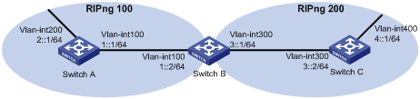

Example: Configuring RIPng route redistribution
As shown in Figure 3, Switch B communicates with Switch A through RIPng 100 and with Switch C through RIPng 200.
Configure route redistribution on Switch B, so the two RIPng processes can redistribute routes from each other.
Figure 3 Network diagram
