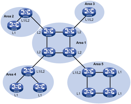

Figure 2 shows one IS-IS network topology. Area 1 is the backbone that comprises a set of Level-2 routers. The other four areas are non-backbone areas connected to the backbone through Level-1-2 routers.
Figure 2 IS-IS topology 1

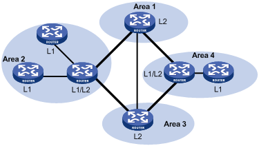

Figure 3 shows another IS-IS topology. No area is defined as the backbone in this topology. The backbone comprises all contiguous Level-2 and Level-1-2 routers in different areas. The IS-IS backbone does not need to be a specific area.
Figure 3 IS-IS topology 2
Both the Level-1 and Level-2 routers use the SPF algorithm to generate the shortest path tree.

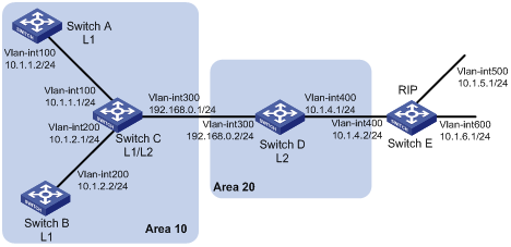

As shown in Figure 9, Switch A, Switch B, Switch C, and Switch D reside in an IS-IS AS.
Switch A and B are Level-1 switches, Switch D is a Level-2 switch, and Switch C is a Level-1-2 switch. Switch A, Switch B, and Switch C are in Area 10, and Switch D is in Area 20.
Figure 9 Network diagram
1.      Configure IP addresses for interfaces. (Details not shown.)
2.      Configure IS-IS:
# Configure Switch A.
<SwitchA> system-view
[SwitchA] isis 1
[SwitchA-isis-1] is-level level-1
[SwitchA-isis-1] network-entity 10.0000.0000.0001.00
[SwitchA-isis-1] quit
[SwitchA-Vlan-interface100] isis enable 1
# Configure Switch B.
<SwitchB> system-view
[SwitchB] isis 1
[SwitchB-isis-1] is-level level-1
[SwitchB-isis-1] network-entity 10.0000.0000.0002.00
[SwitchB-isis-1] quit
[SwitchB] interface vlan-interface 200
[SwitchB-Vlan-interface200] isis enable 1
[SwitchB-Vlan-interface200] quit
# Configure Switch C.
<SwitchC> system-view
[SwitchC] isis 1
[SwitchC-isis-1] network-entity 10.0000.0000.0003.00
[SwitchC-isis-1] quit
[SwitchC] interface vlan-interface 100
[SwitchC-Vlan-interface100] isis enable 1
[SwitchC-Vlan-interface100] quit
[SwitchC] interface vlan-interface 200
[SwitchC-Vlan-interface200] isis enable 1
[SwitchC-Vlan-interface200] quit
[SwitchC] interface vlan-interface 300
[SwitchC-Vlan-interface300] isis enable 1
[SwitchC-Vlan-interface300] quit
# Configure Switch D.
<SwitchD> system-view
[SwitchD] isis 1
[SwitchD-isis-1] is-level level-2
[SwitchD-isis-1] network-entity 20.0000.0000.0004.00
[SwitchD-isis-1] quit
[SwitchD] interface vlan-interface 100
[SwitchD-Vlan-interface100] isis enable 1
[SwitchD-Vlan-interface100] quit
[SwitchD] interface vlan-interface 300
[SwitchD-Vlan-interface300] isis enable 1
[SwitchD-Vlan-interface300] quit
# Display the IS-IS LSDB on each switch to verify the LSPs.
[SwitchA] display isis lsdb
                       Database information for IS-IS(1)
                          Level-1 Link State Database
LSPID                 Seq Num      Checksum   Holdtime   Length  ATT/P/OL
0000.0000.0001.00-00* 0x00000004   0xdf5e     1096       68      0/0/0
0000.0000.0002.00-00  0x00000004   0xee4d     1102       68      0/0/0
0000.0000.0002.01-00  0x00000001   0xdaaf     1102       55      0/0/0
0000.0000.0003.00-00  0x00000009   0xcaa3     1161       111     1/0/0
0000.0000.0003.01-00  0x00000001   0xadda     1112       55      0/0/0
    *-Self LSP, +-Self LSP(Extended), ATT-Attached, P-Partition, OL-Overload
[SwitchB] display isis lsdb
0000.0000.0001.00-00  0x00000006   0xdb60     988         68      0/0/0
0000.0000.0002.00-00* 0x00000008   0xe651     1189        68      0/0/0
0000.0000.0002.01-00* 0x00000005   0xd2b3     1188        55      0/0/0
0000.0000.0003.00-00  0x00000014   0x194a     1190        111     1/0/0
0000.0000.0003.01-00  0x00000002   0xabdb     995         55      0/0/0
[SwitchC] display isis lsdb
0000.0000.0001.00-00  0x00000006   0xdb60     847         68      0/0/0
0000.0000.0002.00-00  0x00000008   0xe651     1053        68      0/0/0
0000.0000.0002.01-00  0x00000005   0xd2b3     1052        55      0/0/0
0000.0000.0003.00-00* 0x00000014   0x194a     1051        111     1/0/0
0000.0000.0003.01-00* 0x00000002   0xabdb     854         55      0/0/0
                          Level-2 Link State Database
0000.0000.0003.00-00* 0x00000012   0xc93c     842         100     0/0/0
0000.0000.0004.00-00  0x00000026   0x331      1173        84      0/0/0
0000.0000.0004.01-00  0x00000001   0xee95     668         55      0/0/0

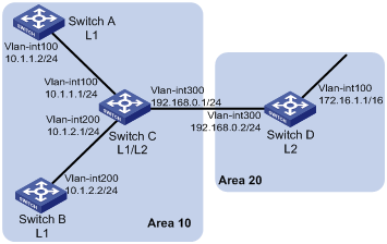

# Display the IS-IS routing information on each switch.
[SwitchA] display isis route
                         Route information for IS-IS(1)
                         Level-1 IPv4 Forwarding Table
 IPv4 Destination     IntCost    ExtCost ExitInterface   NextHop         Flags
 10.1.1.0/24          10         NULL    Vlan100         Direct          D/L/-
 10.1.2.0/24          20         NULL    Vlan100         10.1.1.1        R/-/-
 192.168.0.0/24       20         NULL    Vlan100         10.1.1.1        R/-/-
 0.0.0.0/0            10         NULL    Vlan100         10.1.1.1        R/-/-
      Flags: D-Direct, R-Added to Rib, L-Advertised in LSPs, U-Up/Down Bit Set
[SwitchC] display isis route
 192.168.0.0/24       10         NULL    Vlan300         Direct          D/L/-
 10.1.2.0/24          10         NULL    Vlan200         Direct          D/L/-
                         Level-2 IPv4 Forwarding Table
 192.168.0.0/24       10         NULL                                    D/L/-
 10.1.1.0/24          10         NULL                                    D/L/-
 10.1.2.0/24          10         NULL                                    D/L/-
 172.16.0.0/16        20         NULL    Vlan300         192.168.0.2     R/-/-
[SwitchD] display isis route
 10.1.1.0/24          20         NULL    Vlan300         192.168.0.1     R/-/-
 10.1.2.0/24          20         NULL    Vlan300         192.168.0.1     R/-/-
 172.16.0.0/16        10         NULL    Vlan100         Direct          D/L/-

Example: Configuring IS-IS route redistribution
As shown in Figure 11, Switch A, Switch B, Switch C, and Switch D reside in the same AS. They use IS-IS to interconnect. Switch A and Switch B are Level-1 routers, Switch D is a Level-2 router, and Switch C is a Level-1-2 router.
Redistribute RIP routes into IS-IS on Switch D.
Figure 11 Network diagram
2.      Configure basic IS-IS:
[SwitchD] isis 1
[SwitchD] interface interface vlan-interface 300
[SwitchD] interface interface vlan-interface 400
[SwitchD-Vlan-interface400] isis enable 1
[SwitchD-Vlan-interface400] quit
# Display IS-IS routing information on each switch.
 10.1.1.0/24          10         NULL    VLAN100         Direct          D/L/-
 10.1.2.0/24          20         NULL    VLAN100         10.1.1.1        R/-/-
 192.168.0.0/24       20         NULL    VLAN100         10.1.1.1        R/-/-
 0.0.0.0/0            10         NULL    VLAN100         10.1.1.1        R/-/-
 10.1.2.0/24          10         NULL    VLAN200         Direct          D/L/-
 192.168.0.0/24       10         NULL    VLAN300         Direct          D/L/-
 10.1.1.0/24          20         NULL    VLAN300         192.168.0.1     R/-/-
 10.1.2.0/24          20         NULL    VLAN300         192.168.0.1     R/-/-
3.      Run RIPv2 between Switch D and Switch E, and configure IS-IS to redistribute RIP routes on Switch D:
# Configure RIPv2 on Switch D.
[SwitchD] rip 1
[SwitchD-rip-1] network 10.0.0.0
[SwitchD-rip-1] version 2
[SwitchD-rip-1] undo summary
# Configure RIPv2 on Switch E.
[SwitchE] rip 1
[SwitchE-rip-1] network 10.0.0.0
[SwitchE-rip-1] version 2
[SwitchE-rip-1] undo summary
# Configure IS-IS to redistribute RIP routes on Switch D.
[SwitchD-rip-1] quit
[SwitchD] isis 1
[SwitchD–isis-1] address-family ipv4
[SwitchD–isis-1-ipv4] import-route rip level-2
# Display IS-IS routing information on Switch C.

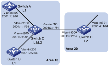

IPv6 IS-IS configuration examples
Example: Configuring IPv6 IS-IS basics
As shown in Figure 17, Switch A, Switch B, Switch C, and Switch D, all enabled with IPv6, reside in the same AS. Configure IPv6 IS-IS on the switches so that they can reach each other.
Switch A and Switch B are Level-1 switches, Switch D is a Level-2 switch, and Switch C is a Level-1-2 switch.
Figure 17 Network diagram
1.      Configure IPv6 addresses for interfaces. (Details not shown.)
2.      Configure IPv6 IS-IS:
[SwitchA] isis 1
[SwitchA-isis-1] address-family ipv6
[SwitchA-isis-1-ipv6] quit
[SwitchA-Vlan-interface100] isis ipv6 enable 1
[SwitchB] isis 1
[SwitchB-isis-1] address-family ipv6
[SwitchB-isis-1-ipv6] quit
[SwitchB-Vlan-interface200] isis ipv6 enable 1
[SwitchC] isis 1
[SwitchC-isis-1] address-family ipv6
[SwitchC-isis-1-ipv6] quit
[SwitchC-Vlan-interface100] isis ipv6 enable 1
[SwitchC-Vlan-interface200] isis ipv6 enable 1
[SwitchC-Vlan-interface300] isis ipv6 enable 1
[SwitchD] isis 1
[SwitchD-isis-1] address-family ipv6
[SwitchD-isis-1-ipv6] quit
[SwitchD-Vlan-interface300] isis ipv6 enable 1
[SwitchD] interface vlan-interface 301
[SwitchD-Vlan-interface301] isis ipv6 enable 1
[SwitchD-Vlan-interface301] quit
# Display the IPv6 IS-IS routing table on Switch A.
[SwitchA] display isis route ipv6
                         Level-1 IPv6 Forwarding Table
 Destination : ::                                      PrefixLen: 0
 Flag        : R/-/-                                   Cost     : 10
 Next Hop    : FE80::200:FF:FE0F:4                     Interface: Vlan100
 Destination : 2001:1::                                PrefixLen: 64
 Flag        : D/L/-                                   Cost     : 10
 Next Hop    : Direct                                  Interface: Vlan100
 Destination : 2001:2::                                PrefixLen: 64
 Flag        : R/-/-                                   Cost     : 20
 Destination : 2001:3::                                PrefixLen: 64
# Display the IPv6 IS-IS routing table on Switch B.
[SwitchB] display isis route ipv6
 Next Hop    : FE80::200:FF:FE0F:4                     Interface: Vlan200
 Next Hop    : Direct                                  Interface: Vlan200
# Display the IPv6 IS-IS routing table on Switch C.
[SwitchC] display isis route ipv6
 Next Hop    : Direct                                  Interface: Vlan300
                         Level-2 IPv6 Forwarding Table
 Destination : 2001:4::1                               PrefixLen: 64
 Next Hop    : FE80::20F:E2FF:FE3E:FA3D                Interface: Vlan300
# Display the IPv6 IS-IS routing table on Switch D.
[SwitchD] display isis route ipv6
 Next Hop    : FE80::200:FF:FE0F:4                     Interface: Vlan300
