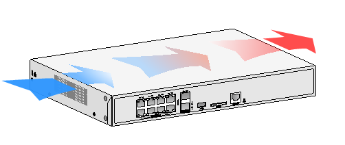

Cooling
The device uses left-to-right airflow. For adequate heat dissipation, make sure the following requirements are met:
·          A minimum clearance of 100 mm (3.94 in) is reserved around the air vents.
·          The rack has a good ventilation system.
Figure1-1 Airflow through the chassis (WX3508H)

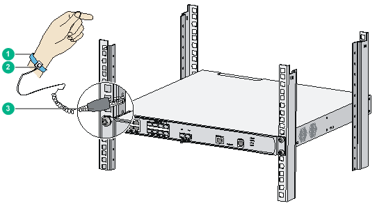

To attach an ESD wrist strap:
1.        Wear the wrist strap on your wrist.
2.        Lock the wrist strap tight around your wrist to maintain good contact with the skin.
3.        Secure the wrist strap lock and the alligator clip lock together.
4.        Attach the alligator clip to the rack.
5.        Make sure the rack is reliably grounded.
Figure1-2 Attaching an ESD wrist strap (WX3540H)
(1) ESD wrist strap
(2) Lock
(3) Alligator clip
