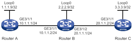

CRLSP setup procedure
As shown in Figure 1, a CRLSP is set up by using the following steps:
1.        The ingress LSR generates a Path message that carries LABEL_REQUEST, and then forwards the message along the path calculated by CSPF hop-by-hop towards the egress LSR.
2.        After receiving the Path message, the egress LSR generates a Resv message carrying the reservation information and the LABEL object. It forwards the Resv message to the ingress LSR along the reverse direction of the path that the Path message traveled.
The Resv message advertises labels, reserves resources, and creates a reserve state on each LSR it passes, so QoS can be guaranteed for services transmitted on the CRLSP.
3.        When the ingress LSR receives the Resv message, the CRLSP is established.
Figure 1 Setting up a CRLSP

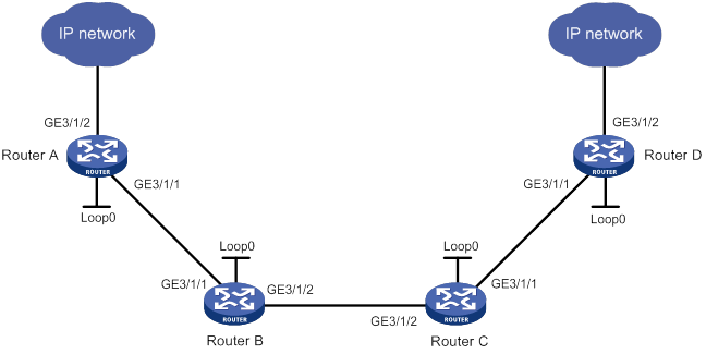

Example: Establishing an MPLS TE tunnel with RSVP-TE
Router A, Router B, Router C, and Router D run IS-IS and all of them are Layer 2 routers.
Use RSVP-TE to establish an MPLS TE tunnel from Router A to Router D to transmit data between the two IP networks. The MPLS TE tunnel requires a bandwidth of 2000 kbps.
The maximum bandwidth of the link that the tunnel traverses is 10000 kbps and the maximum reservable bandwidth of the link is 5000 kbps.
Figure 2 Network diagram
Device
Interface
IP address
Device
Interface
IP address
Router A
Loop0
1.1.1.9/32
Router C
Loop0
3.3.3.9/32
GE3/1/1
10.1.1.1/24
GE3/1/1
30.1.1.1/24
GE3/1/2
100.1.1.1/24
GE3/1/2
20.1.1.2/24
Router B
Loop0
2.2.2.9/32
Router D
Loop0
4.4.4.9/32
GE3/1/1
10.1.1.2/24
GE3/1/1
30.1.1.2/24
GE3/1/2
20.1.1.1/24
GE3/1/2
100.1.2.1/24

6.        Configure an MPLS TE tunnel on Router A:
# Configure MPLS TE tunnel interface Tunnel 1.
[RouterA] interface tunnel 1 mode mpls-te
[RouterA-Tunnel1] ip address 7.1.1.1 255.255.255.0
# Specify the tunnel destination address as the LSR ID of Router D.
[RouterA-Tunnel1] destination 4.4.4.9
# Configure MPLS TE to use RSVP-TE to establish the tunnel.
[RouterA-Tunnel1] mpls te signaling rsvp-te
# Assign 2000 kbps bandwidth to the tunnel.
[RouterA-Tunnel1] mpls te bandwidth 2000
[RouterA-Tunnel1] quit
7.        Configure a static route on Router A to direct the traffic destined for subnet 100.1.2.0/24 to MPLS TE tunnel 1.
[RouterA] ip route-static 100.1.2.0 24 tunnel 1 preference 1

Example: Configuring RSVP GR
Router A, Router B, and Router C run IS-IS, and all of them are Layer 2 devices.
Use RSVP-TE to establish a TE tunnel from Router A to Router C.
Configure RSVP GR on the routers to ensure continuous forwarding when a router reboots.
Figure 3 Network diagram
