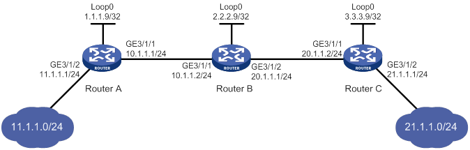

Static LSP configuration examples
Example: Configuring static LSPs
Router A, Router B, and Router C all support MPLS.
Establish static LSPs between Router A and Router C, so that subnets 11.1.1.0/24 and 21.1.1.0/24 can access each other over MPLS.
Figure 1 Network diagram
1.        Configure IP addresses for all interfaces, including the loopback interfaces, as shown in Figure 1. (Details not shown.)
