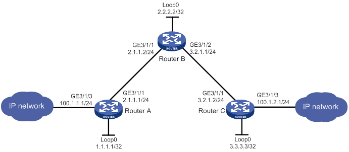

Static CRLSP configuration examples
Example: Configuring a static CRLSP
Router A, Router B, and Router C run IS-IS.
Establish an MPLS TE tunnel over a static CRLSP from Router A to Router C to transmit data between the two IP networks. The required bandwidth for the tunnel is 2000 kbps.
The maximum bandwidth for MPLS TE traffic is 10000 kbps, and the maximum reservable bandwidth is 5000 kbps.
Figure 1 Network diagram

# Display static CRLSP information on each router.
[RouterA] display mpls lsp
FEC                         Proto    In/Out Label    Out Inter/NHLFE/LSINDEX
1.1.1.1/0/1                 StaticCR -/20            GE3/1/1
2.1.1.2                     Local    -/-             GE3/1/1
[RouterB] display mpls lsp
-                           StaticCR 20/30           GE3/1/2
3.2.1.2                     Local    -/-             GE3/1/2
[RouterC] display mpls lsp
-                           StaticCR 30/-            -
[RouterA] display mpls static-cr-lsp
Name            LSR Type    In/Out Label   Out Interface        State
static-cr-lsp-1 Ingress     Null/20        GE3/1/1              Up
[RouterB] display mpls static-cr-lsp
static-cr-lsp-1 Transit     20/30          GE3/1/2              Up
[RouterC] display mpls static-cr-lsp
static-cr-lsp-1 Egress      30/Null        -                    Up
# Verify that Router A has a static route entry with interface Tunnel 0 as the output interface.
[RouterA] display ip routing-table
Destinations : 12        Routes : 12
Destination/Mask   Proto   Pre Cost        NextHop         Interface
0.0.0.0/32         Direct  0   0           127.0.0.1       InLoop0
1.1.1.1/32         Direct  0   0           127.0.0.1       InLoop0
2.1.1.0/24         Direct  0   0           2.1.1.1         GE3/1/1
2.1.1.0/32         Direct  0   0           2.1.1.1         GE3/1/1
2.1.1.1/32         Direct  0   0           127.0.0.1       InLoop0
2.1.1.255/32       Direct  0   0           2.1.1.1         GE3/1/1
2.2.2.2/32         IS_L1   15  10          2.1.1.2         GE3/1/1
100.1.2.0/24       Static  1   0           0.0.0.0         Tun0
3.3.3.3/32         IS_L1   15  20          2.1.1.2         GE3/1/1
6.1.1.0/24         Direct  0   0           6.1.1.1         Tun0
6.1.1.0/32         Direct  0   0           6.1.1.1         Tun0
6.1.1.1/32         Direct  0   0           127.0.0.1       InLoop0
6.1.1.255/32       Direct  0   0           6.1.1.1         Tun0
