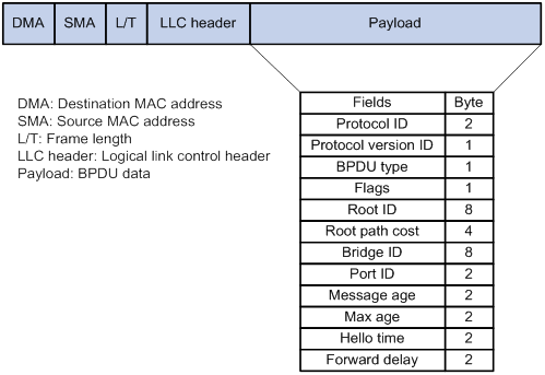

STP protocol frames

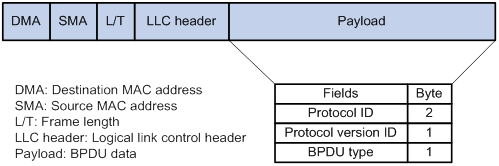

STP uses bridge protocol data units (BPDUs), also known as configuration messages, as its protocol frames. This chapter uses BPDUs to represent all types of spanning tree protocol frames.
STP-enabled devices exchange BPDUs to establish a spanning tree. BPDUs contain sufficient information for the devices to complete spanning tree calculation.
STP uses two types of BPDUs, configuration BPDUs and topology change notification (TCN) BPDUs.

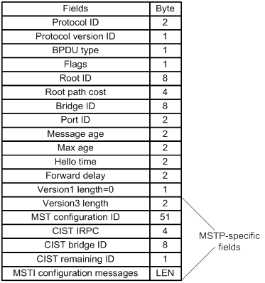

Configuration BPDUs
Devices exchange configuration BPDUs to elect the root bridge and determine port roles. Figure 1 shows the configuration BPDU format.
Figure 1 Configuration BPDU format
The payload of a configuration BPDU includes the following fields:
·          Protocol ID—Fixed at 0x0000, which represents IEEE 802.1d.
·          Protocol version ID—Spanning tree protocol version ID. The protocol version ID for STP is 0x00.
·          BPDU type—Type of the BPDU. The value is 0x00 for a configuration BPDU.
·          Flags—An 8-bit field indicates the purpose of the BPDU. The lowest bit is the Topology Change (TC) flag. The highest bit is the Topology Change Acknowledge (TCA) flag. All other bits are reserved.
·          Root ID—Root bridge ID formed by the priority and MAC address of the root bridge.
·          Root path cost—Cost of the path to the root bridge.
·          Bridge ID—Designated bridge ID formed by the priority and MAC address of the designated bridge.
·          Port ID—Designated port ID formed by the priority and global port number of the designated port.
·          Message age—Age of the configuration BPDU while it propagates in the network.
·          Max age—Maximum age of the configuration BPDU stored on the switch.
·          Hello time—Configuration BPDU transmission interval.
·          Forward delay—Delay for STP bridges to transit port state.
Devices use the root bridge ID, root path cost, designated bridge ID, designated port ID, message age, max age, hello time, and forward delay for spanning tree calculation.

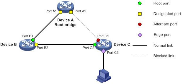

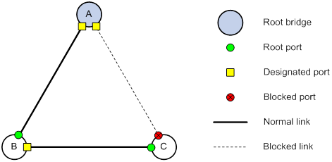

Basic concepts in STP
Root bridge
A tree network must have a root bridge. The entire network contains only one root bridge, and all the other bridges in the network are called leaf nodes. The root bridge is not permanent, but can change with changes of the network topology.
Upon initialization of a network, each device generates and periodically sends configuration BPDUs, with itself as the root bridge. After network convergence, only the root bridge generates and periodically sends configuration BPDUs. The other devices only forward the BPDUs.
Root port
On a non-root bridge, the port nearest to the root bridge is the root port. The root port communicates with the root bridge. Each non-root bridge has only one root port. The root bridge has no root port.

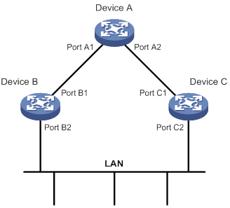

Designated bridge and designated port
Classification
Designated bridge
Designated port
For a device
Device directly connected to the local device and responsible for forwarding BPDUs to the local device.
Port through which the designated bridge forwards BPDUs to this device.
For a LAN
Device responsible for forwarding BPDUs to this LAN segment.
Port through which the designated bridge forwards BPDUs to this LAN segment.

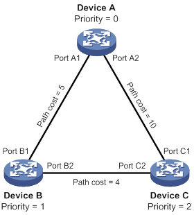

As shown in Figure 3, Device B and Device C are directly connected to a LAN.
If Device A forwards BPDUs to Device B through port A1, the designated bridge and designated port are as follows:
·          The designated bridge for Device B is Device A.
·          The designated port for Device B is port A1 on Device A.
If Device B forwards BPDUs to the LAN, the designated bridge and designated port are as follows:
·          The designated bridge for the LAN is Device B.
·          The designated port for the LAN is port B2 on Device B.
Figure 3 Designated bridges and designated ports

Path cost is a reference value used for link selection in STP. To prune the network into a loop-free tree, STP calculates path costs to select the most robust links and block redundant links that are less robust.

Example of STP calculation
Figure 4 provides an example showing how the STP algorithm works.
Figure 4 The STP algorithm
As shown in Figure 4, the priority values of Device A, Device B, and Device C are 0, 1, and 2, respectively. The path costs of links among the three devices are 5, 10, and 4.
Device state initialization
In Table 3, each configuration BPDU contains the following fields: root bridge ID, root path cost, designated bridge ID, and designated port ID.
Table 3 Initial state of each device
Device
Port name
Configuration BPDU on the port
Device A
Port A1
{0, 0, 0, Port A1}
Port A2
{0, 0, 0, Port A2}
Device B
Port B1
{1, 0, 1, Port B1}
Port B2
{1, 0, 1, Port B2}
Device C
Port C1
{2, 0, 2, Port C1}
Port C2
{2, 0, 2, Port C2}
Configuration BPDUs comparison on each device
In Table 4, each configuration BPDU contains the following fields: root bridge ID, root path cost, designated bridge ID, and designated port ID.
Table 4 Comparison process and result on each device
Device
Comparison process
Configuration BPDU on ports after comparison
Device A
Port A1 performs the following operations:
1.       Receives the configuration BPDU of Port B1 {1, 0, 1, Port B1}.
2.       Determines that its existing configuration BPDU {0, 0, 0, Port A1} is superior to the received configuration BPDU.
3.       Discards the received one.
Port A2 performs the following operations:
1.       Receives the configuration BPDU of Port C1 {2, 0, 2, Port C1}.
2.       Determines that its existing configuration BPDU {0, 0, 0, Port A2} is superior to the received configuration BPDU.
Device A determines that it is both the root bridge and designated bridge in the configuration BPDUs of all its ports. It considers itself as the root bridge. It does not change the configuration BPDU of any port and starts to periodically send configuration BPDUs.
·         Port A1: {0, 0, 0, Port A1}
·         Port A2: {0, 0, 0, Port A2}
Device B
Port B1 performs the following operations:
4.       Receives the configuration BPDU of Port A1 {0, 0, 0, Port A1}.
5.       Determines that the received configuration BPDU is superior to its existing configuration BPDU {1, 0, 1, Port B1}.
6.       Updates its configuration BPDU.
Port B2 performs the following operations:
1.       Receives the configuration BPDU of Port C2 {2, 0, 2, Port C2}.
2.       Determines that its existing configuration BPDU {1, 0, 1, Port B2} is superior to the received configuration BPDU.
3.       Discards the received BPDU.
·         Port B1: {0, 0, 0, Port A1}
·         Port B2: {1, 0, 1, Port B2}
Device B performs the following operations:
1.       Compares the configuration BPDUs of all its ports.
2.       Decides that the configuration BPDU of Port B1 is the optimum.
3.       Selects Port B1 as the root port with the configuration BPDU unchanged.
Based on the configuration BPDU and path cost of the root port, Device B calculates a designated port configuration BPDU for Port B2 {0, 5, 1, Port B2}. Device B compares it with the existing configuration BPDU of Port B2 {1, 0, 1, Port B2}. Device B determines that the calculated one is superior, and determines that Port B2 is the designated port. It replaces the configuration BPDU on Port B2 with the calculated one, and periodically sends the calculated configuration BPDU.
·         Root port (Port B1): {0, 0, 0, Port A1}
·         Designated port (Port B2): {0, 5, 1, Port B2}
Device C
Port C1 performs the following operations:
1.       Receives the configuration BPDU of Port A2 {0, 0, 0, Port A2}.
2.       Determines that the received configuration BPDU is superior to its existing configuration BPDU {2, 0, 2, Port C1}.
3.       Updates its configuration BPDU.
Port C2 performs the following operations:
1.       Receives the original configuration BPDU of Port B2 {1, 0, 1, Port B2}.
2.       Determines that the received configuration BPDU is superior to the existing configuration BPDU {2, 0, 2, Port C2}.
·         Port C1: {0, 0, 0, Port A2}
·         Port C2: {1, 0, 1, Port B2}
Device C performs the following operations:
2.       Decides that the configuration BPDU of Port C1 is the optimum.
3.       Selects Port C1 as the root port with the configuration BPDU unchanged.
Based on the configuration BPDU and path cost of the root port, Device C calculates the configuration BPDU of Port C2 {0, 10, 2, Port C2}. Device C compares it with the existing configuration BPDU of Port C2 {1, 0, 1, Port B2}. Device C determines that the calculated configuration BPDU is superior to the existing one, selects Port C2 as the designated port, and replaces the configuration BPDU of Port C2 with the calculated one.
·         Root port (Port C1): {0, 0, 0, Port A2}
·         Designated port (Port C2): {0, 10, 2, Port C2}
1.       Receives the updated configuration BPDU of Port B2 {0, 5, 1, Port B2}.
2.       Determines that the received configuration BPDU is superior to its existing configuration BPDU {0, 10, 2, Port C2}.
1.       Receives a periodic configuration BPDU {0, 0, 0, Port A2} from Port A2.
2.       Determines that it is the same as the existing configuration BPDU.
·         Port C2: {0, 5, 1, Port B2}
Device C determines that the root path cost of Port C1 is larger than that of Port C2. The root path cost of Port C1 is 10, root path cost of the received configuration BPDU (0) plus path cost of Port C1 (10). The root path cost of Port C2 is 9, root path cost of the received configuration BPDU (5) plus path cost of Port C2 (4). Device C determines that the configuration BPDU of Port C2 is the optimum, and selects Port C2 as the root port with the configuration BPDU unchanged.
Based on the configuration BPDU and path cost of the root port, Device C performs the following operations:
1.       Calculates a designated port configuration BPDU for Port C1 {0, 9, 2, Port C1}.
2.       Compares it with the existing configuration BPDU of Port C1 {0, 0, 0, Port A2}.
3.       Determines that the existing configuration BPDU is superior to the calculated one and blocks Port C1 with the configuration BPDU unchanged.
Port C1 does not forward data until a new event triggers a spanning tree calculation process: for example, the link between Device B and Device C is down.
·         Blocked port (Port C1): {0, 0, 0, Port A2}
·         Root port (Port C2): {0, 5, 1, Port B2}
Final calculated spanning tree
After the comparison processes described in Table 4, a spanning tree with Device A as the root bridge is established, as shown in Figure 5.
Figure 5 The final calculated spanning tree

RSTP protocol frames
An RSTP BPDU uses the same format as an STP BPDU except that a Version1 length field is added to the payload of RSTP BPDUs. The differences between an RSTP BPDU and an STP BPDU are as follows:
·          Protocol version ID—The value is 0x02 for RSTP.
·          BPDU type—The value is 0x02 for RSTP BPDUs.
·          Flags—All 8 bits are used.
·          Version1 length—The value is 0x00, which means no version 1 protocol information is present.

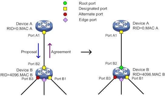

How RSTP works
During RSTP calculation, the following events occur:
·          If a port in discarding state becomes an alternate port, it retains its state.
·          If a port in discarding state is elected as the root port or designated port, it enters the learning state after the forward delay. The port learns MAC addresses, and enters the forwarding state after another forward delay.

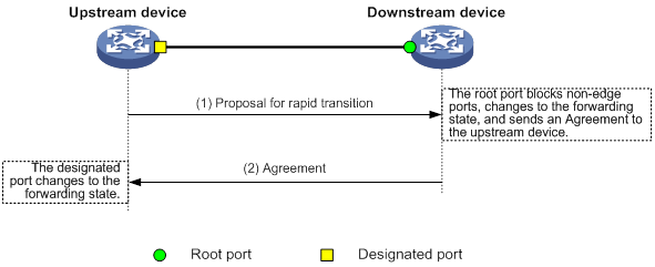

¡  A newly elected RSTP root port rapidly enters the forwarding state if the following requirements are met:
-      The old root port on the device has stopped forwarding data.
-      The upstream designated port has started forwarding data.
¡  A newly elected RSTP designated port rapidly enters the forwarding state if one of the following requirements is met:
-      The designated port is configured as an edge port which directly connects to a user terminal.
-      The designated port connects to a point-to-point link and receives a handshake response from the directly connected device.

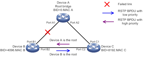

As shown in Figure 6, Device A is the root bridge. The priority of Device B is higher than the priority of Device C. Port C2 on Device C is blocked.
When the link between Device A and Device B fails, the following events occur:
1.        Device B sends an RSTP BPDU with itself as the root bridge to Device C.
2.        Device C compares the RSTP BPDU with its own BPDU.
3.        Because the RSTP BPDU from Device B has a lower priority, Device C sends its own BPDU to Device B.
4.        Device B considers that Port B2 is the root port and stops sending RSTP BPDUs to Device C.
Figure 6 BPDU processing in RSTP

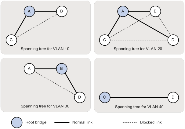

In an STP- or RSTP-enabled LAN, all bridges share one spanning tree. Traffic from all VLANs is forwarded along the spanning tree, and ports cannot be blocked on a per-VLAN basis to prune loops.
PVST allows every VLAN to have its own spanning tree, which increases usage of links and bandwidth. Because each VLAN runs RSTP independently, a spanning tree only serves its VLAN.

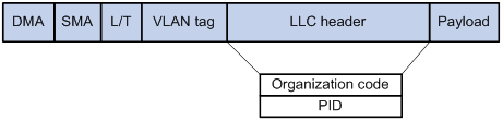

PVST protocol frames
As shown in Figure 7, a PVST BPDU uses the same format as an RSTP BPDU except the following differences:
·          The destination MAC address of a PVST BPDU is 01-00-0c-cc-cc-cd, which is a private MAC address.
·          Each PVST BPDU carries a VLAN tag. The VLAN tag identifies the VLAN to which the PVST BPDU belongs.
·          The organization code and PID fields are added to the LLC header of the PVST BPDU.
Figure 7 PVST BPDU format
A port's link type determines the type of BPDUs the port sends.
·          An access port sends RSTP BPDUs.
·          A trunk or hybrid port sends RSTP BPDUs in the default VLAN and sends PVST BPDUs in other VLANs.

PVST implements per-VLAN spanning tree calculation by mapping each VLAN to an MSTI. In PVST, each VLAN runs RSTP independently to maintain its own spanning tree without affecting the spanning trees of other VLANs. In this way, loops in each VLAN are eliminated and traffic of different VLANs is load shared over links. PVST uses RSTP BPDUs in the default VLAN and PVST BPDUs in other VLANs for spanning tree calculation.

MSTP protocol frames
Figure 8 shows the format of an MSTP BPDU.
Figure 8 MSTP BPDU format
The first 13 fields of an MSTP BPDU are the same as an RSTP BPDU. The other six fields are unique to MSTP.
·          Protocol version IDThe value is 0x03 for MSTP.
·          BPDU typeThe value is 0x02 for RSTP/MSTP BPDUs.
·          Root IDID of the common root bridge.
·          Root path costCIST external path cost.
·          Bridge IDID of the regional root for the IST or an MSTI.
·          Port IDID of the designated port in the CIST.
·          Version3 lengthLength of the MSTP-specific fields. Devices use this field for verification upon receiving an MSTP BPDU.
·          MST configuration IDIncludes the format selector, configuration name, revision level, and configuration digest. The value for format selector is fixed at 0x00. The other parameters are used to identify the MST region for the originating bridge.
·          CIST IRPCInternal root path cost (IRPC) from the originating bridge to the root of the MST region.
·          CIST bridge IDID of the bridge that sends the MSTP BPDU.
·          CIST remaining IDRemaining hop count. This field limits the scale of the MST region. The regional root sends a BPDU with the remaining hop count set to the maximum value. Each device that receives the BPDU decrements the hop count by one. When the hop count reaches zero, the BPDU is discarded. Devices beyond the maximum hops of the MST region cannot participate in spanning tree calculation. The default remaining hop count is 20.
·          MSTI configuration messagesContains MSTI configuration messages. Each MSTI configuration message is 16 bytes. This field can contain 0 to 64 MSTI configuration messages. The number of the MSTI configuration messages is determined by the number of MSTIs in the MST region.

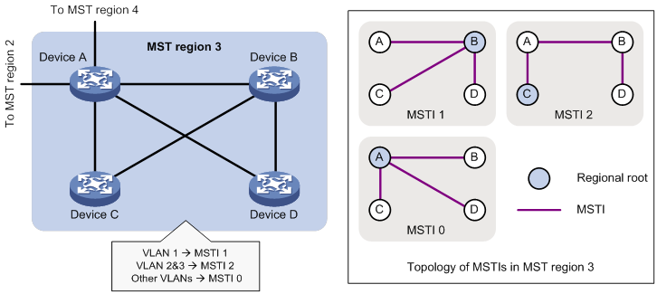

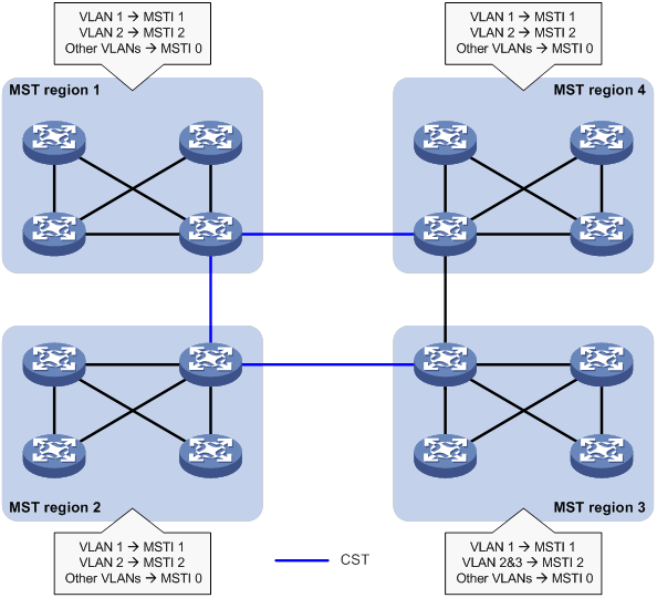

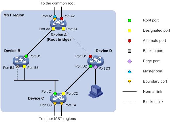

Basic concepts in MSTP
Figure 9 shows a switched network that contains four MST regions, each MST region containing four MSTP devices. Figure 10 shows the networking topology of MST region 3.
Figure 9 Basic concepts in MSTP
Figure 10 Network diagram and topology of MST region 3
MST region
A multiple spanning tree region (MST region) consists of multiple devices in a switched network and the network segments among them. All these devices have the following characteristics:
·          A spanning tree protocol enabled
·          Same region name
·          Same VLAN-to-instance mapping configuration
·          Same MSTP revision level
·          Physically linked together
Multiple MST regions can exist in a switched network. You can assign multiple devices to the same MST region, as shown in Figure 9.

MSTI
MSTP can generate multiple independent spanning trees in an MST region, and each spanning tree is mapped to the specific VLANs. Each spanning tree is referred to as a multiple spanning tree instance (MSTI).
In Figure 10, MST region 3 contains three MSTIs, MSTI 1, MSTI 2, and MSTI 0.
VLAN-to-instance mapping table
As an attribute of an MST region, the VLAN-to-instance mapping table describes the mapping relationships between VLANs and MSTIs.
In Figure 10, the VLAN-to-instance mapping table of MST region 3 is as follows:
·          VLAN 1 to MSTI 1.
·          VLAN 2 and VLAN 3 to MSTI 2.
·          Other VLANs to MSTI 0.
MSTP achieves load balancing by means of the VLAN-to-instance mapping table.
CST
The common spanning tree (CST) is a single spanning tree that connects all MST regions in a switched network. If you regard each MST region as a device, the CST is a spanning tree calculated by these devices through STP or RSTP.
The blue lines in Figure 9 represent the CST.
IST
An internal spanning tree (IST) is a spanning tree that runs in an MST region. It is also called MSTI 0, a special MSTI to which all VLANs are mapped by default.
In Figure 9, MSTI 0 is the IST in MST region 3.
CIST
The common and internal spanning tree (CIST) is a single spanning tree that connects all devices in a switched network. It consists of the ISTs in all MST regions and the CST.
In Figure 9, the ISTs (MSTI 0) in all MST regions plus the inter-region CST constitute the CIST of the entire network.
Regional root
The root bridge of the IST or an MSTI within an MST region is the regional root of the IST or MSTI. Based on the topology, different spanning trees in an MST region might have different regional roots, as shown in MST region 3 in Figure 10.
·          The regional root of MSTI 1 is Device B.
·          The regional root of MSTI 2 is Device C.
·          The regional root of MSTI 0 (also known as the IST) is Device A.
Common root bridge
The common root bridge is the root bridge of the CIST.
In Figure 9, the common root bridge is a device in MST region 1.
Port roles
A port can play different roles in different MSTIs. As shown in Figure 11, an MST region contains Device A, Device B, Device C, and Device D. Port A1 and port A2 of Device A connect to the common root bridge. Port B2 and Port B3 of Device B form a loop. Port C3 and Port C4 of Device C connect to other MST regions. Port D3 of Device D directly connects to a host.
Figure 11 Port roles
MSTP calculation involves the following port roles:
·          Root port—Forwards data for a non-root bridge to the root bridge. The root bridge does not have any root port.
·          Designated port—Forwards data to the downstream network segment or device.
·          Alternate port—Acts as the backup port for a root port or master port. When the root port or master port is blocked, the alternate port takes over.
·          Backup port—Acts as the backup port of a designated port. When the designated port is invalid, the backup port becomes the new designated port. A loop occurs when two ports of the same spanning tree device are connected, so the device blocks one of the ports. The blocked port acts as the backup.
·          Edge port—Directly connects to a user host rather than a network device or network segment.
·          Master port—Acts as a port on the shortest path from the local MST region to the common root bridge. The master port is not always located on the regional root. It is a root port on the IST or CIST and still a master port on the other MSTIs.
·          Boundary port—Connects an MST region to another MST region or to an STP/RSTP-running device. In MSTP calculation, a boundary port's role on an MSTI is consistent with its role on the CIST. However, that is not true with master ports. A master port on MSTIs is a root port on the CIST.

Edge port rapid transition
As shown in Figure 12, Port C3 is an edge port connected to a host. When a network topology change occurs, the port can immediately transit from the blocking state to the forwarding state because no loop will be caused.
Because a device cannot determine whether a port is directly connected to a terminal, you must manually configure the port as an edge port.
Figure 12 Edge port rapid transition
Root port rapid transition
When a root port is blocked, the bridge will elect the alternate port with the highest priority as the new root port. If the new root port's peer is in the forwarding state, the new root port immediately transits to the forwarding state.
As shown in Figure 13, Port C2 on Device C is a root port and Port C1 is an alternate port. When Port C2 transits to the blocking state, Port C1 is elected as the root port and immediately transits to the forwarding state.
Figure 13 Root port rapid transition
P/A transition
The P/A transition enables a designated port to rapidly transit to the forwarding state after a handshake with its peer. The P/A transition applies only to point-to-point links.
P/A transition for RSTP and PVST.

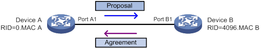

In RSTP or PVST, the ports on a new link or recovered link are designated ports in blocking state. When one of the designated ports transits to the discarding or learning state, it sets the proposal flag in its BPDU. Its peer bridge receives the BPDU and determines whether the receiving port is the root port. If it is the root port, the bridge blocks the other ports except edge ports. The bridge then replies an agreement BPDU to the designated port. The designated port immediately transits to the forwarding state upon receiving the agreement BPDU. If the designated port does not receive the agreement BPDU, it waits for twice the forward delay to transit to the forwarding state.
As shown in Figure 14, the P/A transition operates as follows:
1.        Device A sends a proposal BPDU to Device B through Port A1.
2.        Device B receives the proposal BPDU on Port B2. Port B2 is elected as the root port.
3.        Device B blocks its designated port Port B1 and alternate port Port B3 to eliminate loops.
4.        The root port Port B2 transits to the forwarding state and sends an agreement BPDU to Device A.
5.        The designated port Port A1 on Device A immediately transits to the forwarding state after receiving the agreement BPDU.

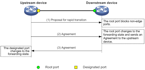

In MSTP, an upstream bridge sets both the proposal and agreement flags in its BPDU. If a downstream bridge receives the BPDU and its receiving port is elected as the root port, the bridge blocks all the other ports except edge ports. The downstream bridge then replies an agreement BPDU to the upstream bridge. The upstream port immediately transits to the forwarding state upon receiving the agreement BPDU. If the upstream port does not receive the agreement BPDU, it waits for twice the forward delay to transit to the forwarding state.
As shown in Figure 15, the P/A transition operates as follows:
1.        Device A sets the proposal and agreement flags in its BPDU and sends it to Device B through Port A1.
2.        Device B receives the BPDU. Port B1 of Device B is elected as the root port.
3.        Device B then blocks all its ports except the edge ports.
4.        The root port Port B1 of Device B transits to the forwarding state and sends an agreement BPDU to Device A.
5.        Port A1 of Device A immediately transits to the forwarding state upon receiving the agreement BPDU.
Figure 15 P/A transition for MSTP

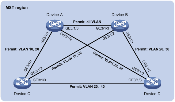

Ignoring the specified VLANs
About VLAN Ignore

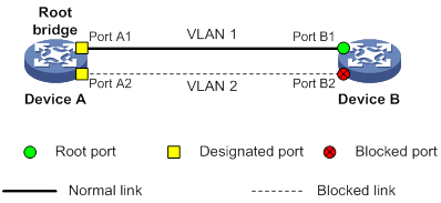

Traffic of a VLAN on a complex network might be blocked by the spanning tree, as shown in Figure 16.
·          Port A1 on Device A allows the traffic of VLAN 1 to pass through.
·          Port A2 on Device A allows the traffic of VLAN 2 to pass through.
·          Port B1 on Device B allows the traffic of VLAN 1 to pass through.
·          Port B2 on Device B allows the traffic of VLAN 2 to pass through.
·          Device A and Device B run a spanning tree protocol. Device A is the root bridge, and Port A1 and Port A2 are designated ports. On Device B, Port B1 is the root port, and Port B2 is the blocked port. Traffic of VLAN 2 is blocked.
Figure 16 VLAN connectivity blocked by MSTP
Ignoring a VLAN can make ports of the VLAN forward frames correctly rather than comply with the spanning tree calculation result.
1.        Enter system view.
2.        Ignore the specified VLANs.
stp ignored vlan vlan-id-list
By default, no VLAN is ignored.

Configuring No Agreement Check
About No Agreement Check
In RSTP and MSTP, the following types of messages are used for rapid state transition on designated ports:
·          Proposal—Sent by designated ports to request rapid transition
·          Agreement—Used to acknowledge rapid transition requests
Both RSTP and MSTP devices can perform rapid transition on a designated port only when the port receives an agreement packet from the downstream device. RSTP and MSTP devices have the following differences:
·          For MSTP, the root port of the downstream device sends an agreement packet only after it receives an agreement packet from the upstream device.
·          For RSTP, the downstream device sends an agreement packet whether or not an agreement packet from the upstream device is received.
Figure 17 Rapid state transition of an MSTP designated port
Figure 18 Rapid state transition of an RSTP designated port
If the upstream device is a third-party device, the rapid state transition implementation might be limited as follows:
·          The upstream device uses a rapid transition mechanism similar to that of RSTP.
·          The downstream device runs MSTP and does not operate in RSTP mode.
In this case, the following occurs:
1.        The root port on the downstream device receives no agreement from the upstream device.
2.        It sends no agreement to the upstream device.
As a result, the designated port of the upstream device can transit to the forwarding state only after a period twice the forward delay.
To enable the designated port of the upstream device to transit its state rapidly, enable No Agreement Check on the downstream device's port.
Configure No Agreement Check on the root port of your device, because this feature takes effect only if it's configured on root ports.
Before you configure the No Agreement Check feature, complete the following tasks:
·          Connect a device to a third-party upstream device that supports spanning tree protocols through a point-to-point link.
·          Configure the same region name, revision level, and VLAN-to-instance mappings on the two devices.
Enable the No Agreement Check feature on the root port.
2.        Enter interface view.
3.        Enable No Agreement Check.
stp no-agreement-check
By default, No Agreement Check is disabled.

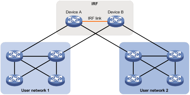

Configuring TC Snooping
About TC Snooping
As shown in Figure 19, an IRF fabric connects to two user networks through double links.
·          Device A and Device B form the IRF fabric.
·          The spanning tree feature is disabled on Device A and Device B and enabled on all devices in user network 1 and user network 2.
·          The IRF fabric transparently transmits BPDUs for both user networks and is not involved in the calculation of spanning trees.
When the network topology changes, it takes time for the IRF fabric to update its MAC address table and ARP table. During this period, traffic in the network might be interrupted.
Figure 19 TC Snooping application scenario
image14.emf
To avoid traffic interruption, you can enable TC Snooping on the IRF fabric. After receiving a TC-BPDU through a port, the IRF fabric updates MAC address table and ARP table entries associated with the port's VLAN. In this way, TC Snooping prevents topology change from interrupting traffic forwarding in the network. For more information about the MAC address table and the ARP table, see "Configuring the MAC address table" and Layer 3—IP Services Configuration Guide.
·          TC Snooping and the spanning tree feature are mutually exclusive. You must globally disable the spanning tree feature before enabling TC Snooping.

Example: Configuring MSTP

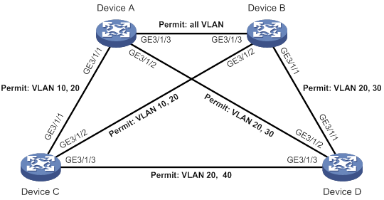

As shown in Figure 20, all devices on the network are in the same MST region. Device A and Device B work at the distribution layer. Device C and Device D work at the access layer.

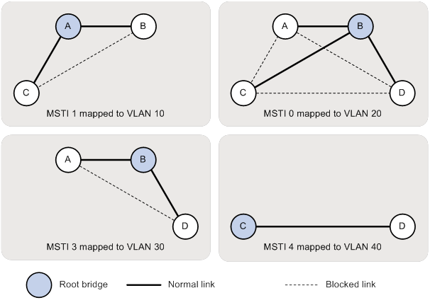

Configure MSTP so that frames of different VLANs are forwarded along different spanning trees.
·          VLAN 10 frames are forwarded along MSTI 1.
·          VLAN 30 frames are forwarded along MSTI 3.
·          VLAN 40 frames are forwarded along MSTI 4.
·          VLAN 20 frames are forwarded along MSTI 0.
VLAN 10 and VLAN 30 are terminated on the distribution layer devices, and VLAN 40 is terminated on the access layer devices. The root bridges of MSTI 1 and MSTI 3 are Device A and Device B, respectively, and the root bridge of MSTI 4 is Device C.
Figure 20 Network diagram
1.        Configure VLANs and VLAN member ports. (Details not shown.)
¡  Create VLAN 10, VLAN 20, and VLAN 30 on both Device A and Device B.
¡  Create VLAN 10, VLAN 20, and VLAN 40 on Device C.
¡  Create VLAN 20, VLAN 30, and VLAN 40 on Device D.
¡  Configure the ports on these devices as trunk ports and assign them to related VLANs.

In this example, Device B has the lowest root bridge ID. As a result, Device B is elected as the root bridge in MSTI 0.
When the network is stable, you can use the display stp brief command to display brief spanning tree information on each device.

# Display brief spanning tree information on Device B.
[DeviceB] display stp brief
 MST ID      Port                         Role  STP State     Protection
 0           GigabitEthernet3/1/1         DESI  FORWARDING    NONE
 0           GigabitEthernet3/1/2         DESI  FORWARDING    NONE
 0           GigabitEthernet3/1/3         DESI  FORWARDING    NONE
 1           GigabitEthernet3/1/2         DESI  FORWARDING    NONE
 1           GigabitEthernet3/1/3         ROOT  FORWARDING    NONE
 3           GigabitEthernet3/1/1         DESI  FORWARDING    NONE
 3           GigabitEthernet3/1/3         DESI  FORWARDING    NONE
# Display brief spanning tree information on Device C.
[DeviceC] display stp brief
 0           GigabitEthernet3/1/2         ROOT  FORWARDING    NONE
 1           GigabitEthernet3/1/1         ROOT  FORWARDING    NONE
 1           GigabitEthernet3/1/2         ALTE  DISCARDING    NONE
 4           GigabitEthernet3/1/3         DESI  FORWARDING    NONE
# Display brief spanning tree information on Device D.
[DeviceD] display stp brief
 0           GigabitEthernet3/1/1         ROOT  FORWARDING    NONE
 0           GigabitEthernet3/1/2         ALTE  DISCARDING    NONE
 0           GigabitEthernet3/1/3         ALTE  DISCARDING    NONE
 3           GigabitEthernet3/1/1         ROOT  FORWARDING    NONE
 3           GigabitEthernet3/1/2         ALTE  DISCARDING    NONE
 4           GigabitEthernet3/1/3         ROOT  FORWARDING    NONE
Based on the output, you can draw each MSTI mapped to each VLAN, as shown in Figure 21.
Figure 21 MSTIs mapped to different VLANs
Example: Configuring PVST
As shown in Figure 22, Device A and Device B work at the distribution layer, and Device C and Device D work at the access layer.
Configure PVST to meet the following requirements:
·          Frames of a VLAN are forwarded along the spanning trees of the VLAN.
·          VLAN 10, VLAN 20, and VLAN 30 are terminated on the distribution layer devices, and VLAN 40 is terminated on the access layer devices.
·          The root bridge of VLAN 10 and VLAN 20 is Device A.
·          The root bridge of VLAN 30 is Device B.
·          The root bridge of VLAN 40 is Device C.
Figure 22 Network diagram
2.        Configure Device A:
# Set the spanning tree mode to PVST.
<DeviceA> system-view
[DeviceA] stp mode pvst
# Configure the device as the root bridge of VLAN 10 and VLAN 20.
[DeviceA] stp vlan 10 20 root primary
# Enable the spanning tree feature globally and in VLAN 10, VLAN 20, and VLAN 30.
[DeviceA] stp global enable
[DeviceA] stp vlan 10 20 30 enable
3.        Configure Device B:
<DeviceB> system-view
[DeviceB] stp mode pvst
# Configure the device as the root bridge of VLAN 30.
[DeviceB] stp vlan 30 root primary
[DeviceB] stp global enable
[DeviceB] stp vlan 10 20 30 enable
4.        Configure Device C:
<DeviceC> system-view
[DeviceC] stp mode pvst
# Configure the device as the root bridge of VLAN 40.
[DeviceC] stp vlan 40 root primary
# Enable the spanning tree feature globally and in VLAN 10, VLAN 20, and VLAN 40.
[DeviceC] stp global enable
[DeviceC] stp vlan 10 20 40 enable
5.        Configure Device D:
<DeviceD> system-view
[DeviceD] stp mode pvst
# Enable the spanning tree feature globally and in VLAN 20, VLAN 30, and VLAN 40.
[DeviceD] stp global enable
[DeviceD] stp vlan 20 30 40 enable
# Display brief spanning tree information on Device A.
[DeviceA] display stp brief
 VLAN ID     Port                         Role  STP State     Protection
 10          GigabitEthernet3/1/1         DESI  FORWARDING    NONE
 10          GigabitEthernet3/1/3         DESI  FORWARDING    NONE
 20          GigabitEthernet3/1/1         DESI  FORWARDING    NONE
 20          GigabitEthernet3/1/2         DESI  FORWARDING    NONE
 20          GigabitEthernet3/1/3         DESI  FORWARDING    NONE
 30          GigabitEthernet3/1/2         DESI  FORWARDING    NONE
 30          GigabitEthernet3/1/3         ROOT  FORWARDING    NONE
 10          GigabitEthernet3/1/2         DESI  FORWARDING    NONE
 10          GigabitEthernet3/1/3         ROOT  FORWARDING    NONE
 20          GigabitEthernet3/1/3         ROOT  FORWARDING    NONE
 30          GigabitEthernet3/1/1         DESI  FORWARDING    NONE
 30          GigabitEthernet3/1/3         DESI  FORWARDING    NONE
 10          GigabitEthernet3/1/1         ROOT  FORWARDING    NONE
 10          GigabitEthernet3/1/2         ALTE  DISCARDING    NONE
 20          GigabitEthernet3/1/1         ROOT  FORWARDING    NONE
 20          GigabitEthernet3/1/2         ALTE  DISCARDING    NONE
 40          GigabitEthernet3/1/3         DESI  FORWARDING    NONE
 20          GigabitEthernet3/1/1         ALTE  DISCARDING    NONE
 20          GigabitEthernet3/1/2         ROOT  FORWARDING    NONE
 20          GigabitEthernet3/1/3         ALTE  DISCARDING    NONE
 30          GigabitEthernet3/1/1         ROOT  FORWARDING    NONE
 30          GigabitEthernet3/1/2         ALTE  DISCARDING    NONE
 40          GigabitEthernet3/1/3         ROOT  FORWARDING    NONE
Based on the output, you can draw a topology for each VLAN spanning tree, as shown in Figure 23.
Figure 23 VLAN spanning tree topologies
