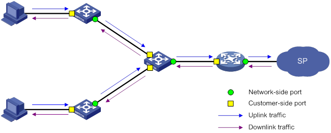

Figure 2 shows a simplified network that illustrates basic VLAN mapping terms.
Basic VLAN mapping terms include the following:
·          Uplink traffic—Traffic transmitted from the customer network to the service provider network.
·          Downlink traffic—Traffic transmitted from the service provider network to the customer network.
·          Network-side port—A port connected to or closer to the service provider network.
·          Customer-side port—A port connected to or closer to the customer network.
Figure 2 Basic VLAN mapping terms
As shown in Figure 3, one-to-one VLAN mapping is implemented on the customer-side port and replaces VLAN tags as follows:
·          Replaces the CVLAN with the SVLAN for the uplink traffic.
·          Replaces the SVLAN with the CVLAN for the downlink traffic.

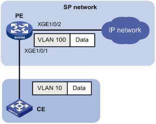

As shown in Figure 4, configure one-to-one VLAN mapping on the PE to map VLAN 10 to VLAN 100, so user packets can be transmitted over the service provider network.
Figure 4 Network diagram
1.        Configure PE:
# Create the original VLAN and the translated VLAN.
<PE> system-view
[PE] vlan 10
[PE-vlan10] quit
[PE] vlan 100
[PE-vlan100] quit
# Configure customer-side port Ten-GigabitEthernet 1/0/1 as a trunk port.
[PE] interface ten-gigabitethernet 1/0/1
[PE-Ten-GigabitEthernet1/0/1] port link-type trunk
# Assign Ten-GigabitEthernet 1/0/1 to the original VLAN and the translated VLAN.
[PE-Ten-GigabitEthernet1/0/1] port trunk permit vlan 10 100
# Configure one-to-one VLAN mapping on Ten-GigabitEthernet 1/0/1 to map VLAN 10 to VLAN 100.
[PE-Ten-GigabitEthernet1/0/1] vlan mapping 10 translated-vlan 100
[PE-Ten-GigabitEthernet1/0/1] quit
# Configure network-side port Ten-GigabitEthernet 1/0/2 as a trunk port.
[PE] interface ten-gigabitethernet 1/0/2
[PE-Ten-GigabitEthernet1/0/2] port link-type trunk
# Assign Ten-GigabitEthernet 1/0/2 to VLAN 100.
[PE-Ten-GigabitEthernet1/0/2] port trunk permit vlan 100
[PE-Ten-GigabitEthernet1/0/2] quit
# Verify VLAN mapping information on the PE.
[PE] display vlan mapping
Interface Ten-GigabitEthernet1/0/1:
  Outer VLAN    Inner VLAN    Translated Outer VLAN    Translated Inner VLAN
  10            N/A           100                      N/A
