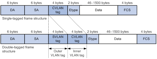

As shown in Figure 1, a QinQ frame transmitted over the service provider network carries the following tags:
·          CVLAN tag—Identifies the VLAN to which the frame belongs when it is transmitted in the customer network.
·          SVLAN tag—Identifies the VLAN to which the QinQ frame belongs when it is transmitted in the service provider network. The service provider allocates the SVLAN tag to the customer.
The devices in the service provider network forward a tagged frame according to its SVLAN tag only. The CVLAN tag is transmitted as part of the frame's payload.
Figure 1 Single-tagged Ethernet frame header and double-tagged Ethernet frame header

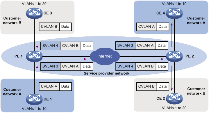

As shown in Figure 2, customer A has remote sites CE 1 and CE 4. Customer B has remote sites CE 2 and CE 3. The CVLANs of the two customers overlap. The service provider assigns SVLANs 3 and 4 to customers A and B, respectively.
When a tagged Ethernet frame from CE 1 arrives at PE 1, the PE tags the frame with SVLAN 3. The double-tagged Ethernet frame travels over the service provider network until it arrives at PE 2. PE 2 removes the SVLAN tag of the frame, and then sends the frame to CE 4.
Figure 2 Typical QinQ application scenario

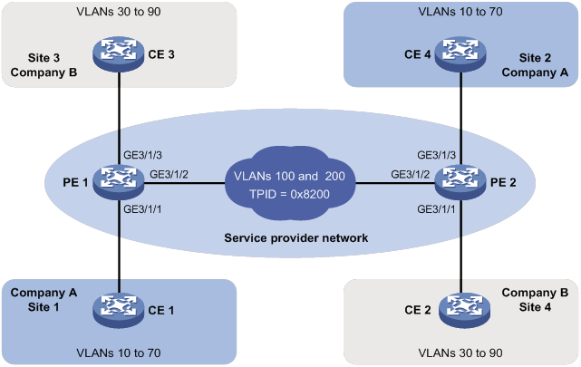

Example: Configuring basic QinQ
As shown in Figure 3:
·          The service provider assigns VLAN 100 to Company A's VLANs 10 through 70.
·          The service provider assigns VLAN 200 to Company B's VLANs 30 through 90.
·          The devices between PE 1 and PE 2 in the service provider network use a TPID value of 0x8200.
Configure QinQ on PE 1 and PE 2 to transmit traffic in VLANs 100 and 200 for Company A and Company B, respectively.
For the QinQ frames to be identified correctly, set the SVLAN TPID to 0x8200 on the service provider-side ports of PE 1 and PE 2.
Figure 3 Network diagram

[PE2-GigabitEthernet3/1/2] port link-type trunk
[PE2-GigabitEthernet3/1/2] port trunk permit vlan 100 200
# Set the TPID value in the SVLAN tags to 0x8200 on GigabitEthernet 3/1/2.
[PE2-GigabitEthernet3/1/2] qinq ethernet-type service-tag 8200
[PE2-GigabitEthernet3/1/2] quit
# Configure GigabitEthernet 3/1/3 as a trunk port, and assign it to VLAN 100.
[PE2] interface gigabitethernet 3/1/3
[PE2-GigabitEthernet3/1/3] port link-type trunk
[PE2-GigabitEthernet3/1/3] port trunk permit vlan 100
# Set the PVID of GigabitEthernet 3/1/3 to VLAN 100.
[PE2-GigabitEthernet3/1/3] port trunk pvid vlan 100
# Enable QinQ on GigabitEthernet 3/1/3.
[PE2-GigabitEthernet3/1/3] qinq enable
[PE2-GigabitEthernet3/1/3] quit
3.        Configure the devices between PE 1 and PE 2:
# Set the MTU to a minimum of 1504 bytes for each port on the path of QinQ frames. (Details not shown.)
# Configure all ports on the forwarding path to allow frames from VLANs 100 and 200 to pass through without removing the VLAN tag. (Details not shown.)
