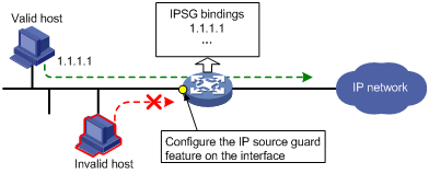

As shown in Figure 1, IPSG forwards only the packets that match an IPSG binding.
Figure 1 IPSG application
