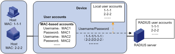

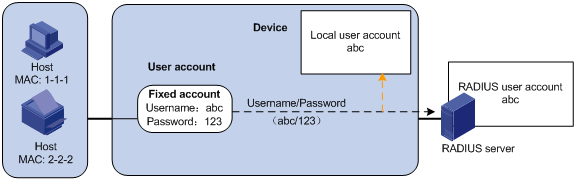

User account policies
MAC authentication supports the following user account policies:
·          One MAC-based user account for each user. As shown in Figure 1, the access device uses the source MAC addresses in packets as the usernames and passwords of users for MAC authentication. This policy is suitable for an insecure environment.
·          One shared user account for all users. You specify one username and password, which are not necessarily a MAC address, for all MAC authentication users on the access device. This policy is suitable for a secure environment. See Figure 2.
Figure 1 MAC-based user account policy
Figure 2 Shared user account policy

If MAC-based accounts are used, the access device sends the source MAC address of the packet as the username and password to the RADIUS server for authentication.
If a shared account is used, the access device sends the shared account username and password to the RADIUS server for authentication.
Local authentication
If MAC-based accounts are used, the access device uses the source MAC address of the packet as the username and password to search the local account database for a match.
If a shared account is used, the access device uses the shared account username and password to search the local account database for a match.

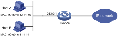

Example: Configuring local MAC authentication
As shown in Figure 3, the device performs local MAC authentication on GigabitEthernet 1/0/1 to control Internet access of users.
Configure the device to meet the following requirements:
·          Detect whether a user has gone offline every 180 seconds.
·          Deny a user for 180 seconds if the user fails MAC authentication.
·          Authenticate all users in ISP domain bbb.
·          Use the MAC address of each user as the username and password for authentication. A MAC address is in the hexadecimal notation with hyphens, and letters are in lower case.
Figure 3 Network diagram

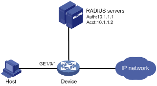

Example: Configuring RADIUS-based MAC authentication
As shown in Figure 4, the device uses RADIUS servers to perform authentication, authorization, and accounting for users.
To control user access to the Internet by MAC authentication, perform the following tasks:
·          Enable MAC authentication globally and on GigabitEthernet 1/0/1.
·          Configure the device to detect whether a user has gone offline every 180 seconds.
·          Configure the device to deny a user for 180 seconds if the user fails MAC authentication.
·          Configure all users to belong to ISP domain bbb.
·          Use a shared user account for all users, with username aaa and password 123456.
Figure 4 Network diagram
Make sure the RADIUS server and the access device can reach each other.

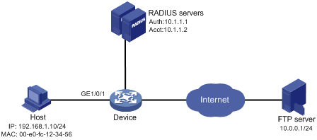

Example: Configuring ACL assignment for MAC authentication
As shown in Figure 5, configure the device to meet the following requirements:
·          Use RADIUS servers to perform authentication, authorization, and accounting for users.
·          Perform MAC authentication on GigabitEthernet 1/0/1 to control Internet access.
·          Use MAC-based user accounts for MAC authentication users. Each MAC address is in the hexadecimal notation with hyphens, and letters are in lower case.
·          Use an ACL to deny authenticated users to access the FTP server at 10.0.0.1.
Figure 5 Network diagram
Make sure the RADIUS servers and the access device can reach each other.
1.        Configure the RADIUS servers:
# Configure the RADIUS servers to provide authentication, authorization, and accounting services. (Details not shown.)
# Add a user account with 00-e0-fc-12-34-56 as both the username and password on each RADIUS server. (Details not shown.)
# Specify ACL 3000 as the authorization ACL for the user account. (Details not shown.)
2.        Configure ACL 3000 to deny packets destined for 10.0.0.1 on the device.

# Verify that you cannot ping the FTP server from the host.
C:\>ping 10.0.0.1
Pinging 10.0.0.1 with 32 bytes of data:
Request timed out.
Request timed out.
Request timed out.
Request timed out.
Ping statistics for 10.0.0.1:
   Packets: Sent = 4, Received = 0, Lost = 4 (100% loss),
The output shows that ACL 3000 has been assigned to GigabitEthernet 1/0/1 to deny access to the FTP server.
