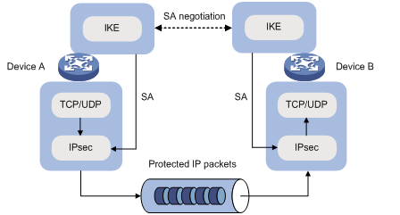

IPsec framework
IPsec is a security framework that has the following protocols and algorithms:
·          Authentication Header (AH).
·          Encapsulating Security Payload (ESP).
·          Internet Key Exchange (IKE).
·          Algorithms for authentication and encryption.
AH and ESP are security protocols that provide security services. IKE performs automatic key exchange. For more information about IKE, see "Configuring IKE."

A security association (SA) is an agreement negotiated between two communicating parties called IPsec peers. An SA includes the following parameters for data protection:
·          Security protocols (AH, ESP, or both).
·          Encapsulation mode (transport mode or tunnel mode).
·          Authentication algorithm (HMAC-MD5 or HMAC-SHA1).
·          Encryption algorithm (DES, 3DES, or AES).
·          Shared keys and their lifetimes.
An SA is unidirectional. At least two SAs are needed to protect data flows in a bidirectional communication. If two peers want to use both AH and ESP to protect data flows between them, they construct an independent SA for each protocol in each direction.
An SA is uniquely identified by a triplet, which consists of the security parameter index (SPI), destination IP address, and security protocol identifier. An SPI is a 32-bit number. It is transmitted in the AH/ESP header.
An SA can be set up manually or through IKE.

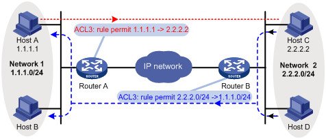

ACL-based IPsec

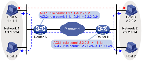

To implement ACL-based IPsec, configure an ACL to define the data flows to be protected, specify the ACL in an IPsec policy, and then apply the IPsec policy to an interface. You can apply an IPsec policy to physical interfaces such as serial interfaces and Ethernet interfaces, or virtual interfaces such as tunnel interfaces and virtual template interfaces.
ACL-based IPsec works as follows:
·          When packets sent by the interface match a permit rule of the ACL, the packets are protected by the outbound IPsec SA and encapsulated with IPsec.
·          When the interface receives an IPsec packet destined for the local device, it searches for the inbound IPsec SA according to the SPI in the IPsec packet header for de-encapsulation. If the de-encapsulated packet matches a permit rule of the ACL, the device processes the packet. If the de-encapsulated packet does not match any permit rule of the ACL, the device drops the packet.
The device supports the following data flow protection modes:
·          Standard mode—One IPsec tunnel protects one data flow. The data flow permitted by an ACL rule is protected by one IPsec tunnel that is established solely for it.
·          Aggregation mode—One IPsec tunnel protects all data flows permitted by all the rules of an ACL. This mode is only used to communicate with old-version devices.
·          Per-host mode—One IPsec tunnel protects one host-to-host data flow. One host-to-host data flow is identified by one ACL rule and protected by one IPsec tunnel established solely for it. This mode consumes more system resources when multiple data flows exist between two subnets to be protected.

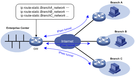

IPsec RRI
IPsec Reverse Route Injection (RRI) enables an IPsec tunnel gateway to automatically add and delete static routes destined for the protected private networks. It automatically adds the static routes when the IPsec SAs are established and deletes the static routes when the IPsec SAs are deleted. This greatly reduces the static route configuration work load on the gateway and increases the scalability of the IPsec VPN.
IPsec RRI is applicable to gateways that must provide many IPsec tunnels (for example, a headquarters gateway).
As shown in Figure 4, the traffic between the enterprise center and the branches are protected by IPsec. The gateway at the enterprise center is configured with static routes to route traffic to the IPsec-protected interfaces. It is difficult to add or modify static routes on the gateway at the enterprise center if the IPsec VPN has a large number of branches or if the network structure changes.
Figure 4 IPsec VPN
After you can enable IPsec RRI on the gateway, the gateway automatically adds a static route to the routing table each time an IPsec tunnel is established. The destination IP address is the protected private network, and the next hop is the remote IP address of the IPsec tunnel. Traffic destined for the peer end is routed to the IPsec tunnel interface and thereby protected by IPsec.
You can advertise the static routes created by IPsec RRI in the internal network, and the internal network device can use them to forward traffic in the IPsec VPN.
You can set preferences for the static routes created by IPsec RRI to implement flexible route management. For example, you can set the same preference for multiple routes to the same destination to implement load sharing, or you can set different preferences to implement route backup.
You can also set tags for the static routes created by IPsec RRI to implement flexible route control through routing policies.

Mirror image ACLs
To make sure SAs can be set up and the traffic protected by IPsec can be processed correctly between two IPsec peers, create mirror image ACLs on the IPsec peers. As shown in Figure 5, ACL rules on Router B are mirror images of the rules on Router A. In this way, SAs can be created successfully for the traffic between Host A and Host C and for the traffic between Network 1 and Network 2.
Figure 5 Mirror image ACLs
If the ACL rules on IPsec peers do not form mirror images of each other, SAs can be set up only when both of the following requirements are met:
·          The range specified by an ACL rule on one peer is covered by its counterpart ACL rule on the other peer. As shown in Figure 6, the range specified by the ACL rule configured on Router A is covered by its counterpart on Router B.
·          The peer with the narrower rule initiates SA negotiation. If a wider ACL rule is used by the SA initiator, the negotiation request might be rejected because the matching traffic is beyond the scope of the responder. As shown in Figure 6, the SA negotiation initiated by Host A to Host C is accepted but the SA negotiations from Host C to Host A, from Host C to Host B, and from Host D to Host A are rejected.
Figure 6 Non-mirror image ACLs

Configuring IPsec RRI
Enabling IPsec RRI for an IPsec policy deletes all existing IPsec SAs created by this IPsec policy. IPsec RRI creates static routes according to new IPsec SAs.
Disabling IPsec RRI for an IPsec policy deletes all existing IPsec SAs created by this IPsec policy and the associated static routes.
IPsec RRI is supported in both tunnel mode and transport mode.
If you change the preference value or tag value for an IPsec policy, the device deletes all IPsec SAs created by this IPsec policy, and the associated static routes. The change takes effect for future IPsec RRI-created static routes.
IPsec RRI does not generate a static route to a destination address to be protected if the destination address is not defined in the ACL used by an IPsec policy or an IPsec policy template. You must manually configure a static route to the destination address.
1.        Enter system view.
2.        Enter IPsec policy view or IPsec policy template view.
¡  Enter IPsec policy view.
ipsec { policy | ipv6-policy } policy-name seq-number  isakmp
¡  Enter IPsec policy template view.
ipsec { ipv6-policy-template | policy-template } template-name seq-number
3.        Enable IPsec RRI.
reverse-route dynamic
By default, IPsec RRI is disabled.
4.        (Optional.) Set the preference value for the static routes created by IPsec RRI.
reverse-route preference number
The default value is 60.
5.        (Optional.) Set the tag value for the static routes created by IPsec RRI.
reverse-route tag tag-value
The default value is 0.

Example: Configuring IPsec RRI
As shown in Figure 10, branches access the enterprise center through an IPsec VPN.
Configure the IPsec VPN as follows:
·          Configure an IPsec tunnel between Switch A and each branch gateway (Switch B, Switch C, and Switch D) to protect traffic between subnets 4.4.4.0/24 and 5.5.5.0/24.
·          Configure the tunnels to use security protocol ESP, encryption algorithm DES, and authentication algorithm SHA1-HMAC-96. Use IKE for IPsec SA negotiation.
·          Configure IKE proposal to use the pre-shared key authentication method, encryption algorithm 3DES, and authentication algorithm HMAC-SHA1.
·          Configure IPsec RRI on Switch A to automatically create static routes to the branches based on the established IPsec SAs.
Figure 10 Network diagram

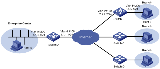

1.        Assign IPv4 addresses to the interfaces on the switches according to Figure 10. (Details not shown.)
2.        Configure Switch A:
# Create an IPsec transform set named tran1, and specify ESP as the security protocol, DES as the encryption algorithm, and HMAC-SHA-1-96 as the authentication algorithm.
<SwitchA> system-view
[SwitchA] ipsec transform-set tran1
[SwitchA-ipsec-transform-set-tran1] encapsulation-mode tunnel
[SwitchA-ipsec-transform-set-tran1] protocol esp
[SwitchA-ipsec-transform-set-tran1] esp encryption-algorithm des
[SwitchA-ipsec-transform-set-tran1] esp authentication-algorithm sha1
[SwitchA-ipsec-transform-set-tran1] quit
# Create and configure the IKE profile named profile1.
[SwitchA] ike profile profile1
[SwitchA-ike-profile-profile1] keychain keychain1
[SwitchA-ike-profile-profile1] match remote identity address 2.2.2.2 255.255.255.0
[SwitchA-ike-profile-profile1] quit
# Create an IPsec policy template named temp1. Specify IPsec transform set tran1 and IKE profile profile1 for the IPsec policy template.
[SwitchA] ipsec policy-template temp1 1
[SwitchA-ipsec-policy-template-temp1-1] transform-set tran1
[SwitchA-ipsec-policy-template-temp1-1] ike-profile profile1
# Enable IPsec RRI, set the preference to 100 and the tag to 1000 for the static routes created by IPsec RRI.
[SwitchA-ipsec-policy-template-temp1-1] reverse-route dynamic
[SwitchA-ipsec-policy-template-temp1-1] reverse-route preference 100
[SwitchA-ipsec-policy-template-temp1-1] reverse-route tag 1000
[SwitchA-ipsec-policy-template-temp1-1] quit
# Create an IKE-based IPsec policy entry by using IPsec policy template temp1. Specify the policy name as map1 and set the sequence number to 10.
[SwitchA] ipsec policy map1 10 isakmp template temp1
# Create an IKE proposal named 1, and specify 3DES as the encryption algorithm, HMAC-SHA1 as the authentication algorithm, and pre-share as the authentication method.
[SwitchA] ike proposal 1
[SwitchA-ike-proposal-1] encryption-algorithm 3des-cbc
[SwitchA-ike-proposal-1] authentication-algorithm sha
[SwitchA-ike-proposal-1] authentication-method pre-share
[SwitchA-ike-proposal-1] quit
# Create an IKE keychain named key1 and specify 123 in plain text as the pre-shared key to be used with the remote peer at 2.2.2.2.
[SwitchA] ike keychain key1
[SwitchA-ike-keychain-key1] pre-shared-key address 2.2.2.2 key simple 123
[SwitchA-ike-keychain-key1] quit
# Apply IPsec policy map1 to VLAN-interface 100.
[SwitchA-Vlan-interface100] ipsec apply policy map1
3.        Configure Switch B:
[SwitchB] ipsec transform-set tran1
[SwitchB-ipsec-transform-set-tran1] encapsulation-mode tunnel
[SwitchB-ipsec-transform-set-tran1] protocol esp
[SwitchB-ipsec-transform-set-tran1] esp encryption-algorithm des
[SwitchB-ipsec-transform-set-tran1] esp authentication-algorithm sha1
[SwitchB-ipsec-transform-set-tran1] quit
# Configure IPv4 advanced ACL 3000 to identify traffic from subnet 5.5.5.0/24 to subnet 4.4.4.0/24.
[SwitchB] acl advanced 3000
[SwitchB-acl-ipv4-adv-3000] rule permit ip source 5.5.5.0 0.0.0.255 destination 4.4.4.0 0.0.0.255
[SwitchB-acl-ipv4-adv-3000] quit
[SwitchB] ike profile profile1
[SwitchB-ike-profile-profile1] keychain keychain1
[SwitchB-ike-profile-profile1] match remote identity address 1.1.1.1 255.255.255.0
[SwitchB-ike-profile-profile1] quit
# Create an IKE-based IPsec policy entry named map1 and configure the following settings for the policy entry:
¡  Set the sequence number to 10.
¡  Specify transform set tran1 and ACL 3000.
¡  Specify the remote IP address for the tunnel as 1.1.1.1.
¡  Specify IKE profile profile1.
[SwitchB] ipsec policy map1 10 isakmp
[SwitchB-ipsec-policy-isakmp-map1-10] transform-set tran1
[SwitchB-ipsec-policy-isakmp-map1-10] security acl 3000
[SwitchB-ipsec-policy-isakmp-map1-10] remote-address 1.1.1.1
[SwitchB-ipsec-policy-isakmp-map1-10] ike-profile profile1
[SwitchB-ipsec-policy-isakmp-map1-10] quit
[SwitchB] ike proposal 1
[SwitchB-ike-proposal-1] encryption-algorithm 3des-cbc
[SwitchB-ike-proposal-1] authentication-algorithm sha
[SwitchB-ike-proposal-1] authentication-method pre-share
[SwitchB-ike-proposal-1] quit
# Create an IKE keychain named key1 and specify 123 in plain text as the pre-shared key to be used with the remote peer at 1.1.1.1.
[SwitchB] ike keychain key1
[SwitchB-ike-keychain-key1] pre-shared-key address 1.1.1.1 key simple 123
[SwitchB-ike-keychain-key1] quit
[SwitchB-Vlan-interface100] ipsec apply policy map1
Make sure Switch B has a route to the peer private network, with the outgoing interface as VLAN-interface 100.
4.        Configure Switch C and Switch D in the same way Switch B is configured.
1.        Verify that IPsec RRI can automatically create a static route from Switch A to Switch B:
# Initiate a connection from subnet 5.5.5.0/24 to subnet 4.4.4.0/24. IKE negotiation is triggered to establish IPsec SAs between Switch A and Switch B. (Details not shown.)
# Verify that IPsec SAs are established on Switch A.
[SwitchA] display ipsec sa
Interface: Vlan-interface100
  IPsec policy: map1
  Sequence number: 10
  Mode: Template
    Tunnel id: 0
    Encapsulation mode: tunnel
    Perfect Forward Secrecy:
    Inside VPN:
    Extended Sequence Numbers enable: N
    Traffic Flow Confidentiality enable: N
    Path MTU: 1463
    Tunnel:
        local  address: 1.1.1.1
        remote address: 2.2.2.2
    Flow:
        sour addr: 4.4.4.0/255.255.255.0  port: 0  protocol: ip
        dest addr: 5.5.5.0/255.255.255.0  port: 0  protocol: ip
    [Inbound ESP SAs]
      SPI: 1014286405 (0x3c74c845)
      Connection ID: 90194313219
      Transform set: ESP-ENCRYPT-DES-CBC ESP-AUTH-SHA1
      SA duration (kilobytes/sec): 1843200/3600
      SA remaining duration (kilobytes/sec): 1843199/3590
      Max received sequence-number: 4
      Anti-replay check enable: Y
      Anti-replay window size: 64
      UDP encapsulation used for NAT traversal: N
      Status: Active
    [Outbound ESP SAs]
      SPI: 4011716027 (0xef1dedbb)
      Connection ID: 64424509441
      Max sent sequence-number: 4
      Status: Active
# Verify that IPsec RRI has created a static route to reach Switch B.
[SwitchA] display ip routing-table verbose
2.        Verify that Switch A can automatically create static routes to Switch C and Switch D in the same way that you verify the IPsec RRI feature by using Switch A and Switch B. (Details not shown.)

Relationship between IPsec and IKE
As shown in Figure 11, IKE negotiates SAs for IPsec and transfers the SAs to IPsec, and IPsec uses the SAs to protect IP packets.
Figure 11 Relationship between IKE and IPsec

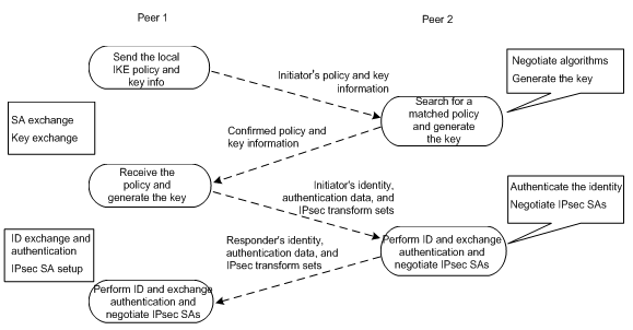

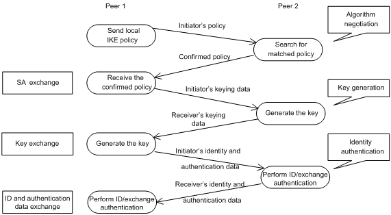

IKE exchange process in main mode
As shown in Figure 12, the main mode of IKE negotiation in phase 1 involves three pairs of messages:
·          SA exchange—Used for negotiating the IKE security policy.
·          Key exchange—Used for exchanging the DH public value and other values, such as the random number. The two peers use the exchanged data to generate key data and use the encryption key and authentication key to ensure the security of IP packets.
·          ID and authentication data exchange—Used for identity authentication.
Figure 12 IKE exchange process in main mode

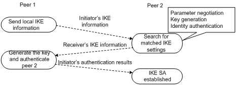

IKE exchange process in aggressive mode
As shown in Figure 13, the process of phase 1 IKE negotiation in aggressive mode is as follows:
1.        The initiator (peer 1) sends a message containing the local IKE information to peer 2. The message includes parameters used for IKE SA establishment, keying data, and peer 1's identity information.
2.        Peer 2 chooses the IKE establishment parameters to use, generate the key, and authenticate peer 1's identity. Then it sends the IKE data to peer 1.
3.        Peer 1 generates the key, authenticates peer 2's identity, and sends the results to peer 1.
After the preceding process, an IKE SA is established between peer 1 and peer 2.
The aggressive mode is faster than the main mode but it does not provide identity information protection. The main mode provides identity information protection but is slower. Choose the appropriate negotiation mode according to your requirements.
Figure 13 IKE exchange process in aggressive mode

2.        Verify that the ACL specified for the IPsec policy is correctly configured. If the flow range defined by the responder's ACL is smaller than that defined by the initiator's ACL, IPsec proposal matching will fail.
For example, if the initiator's ACL defines a flow from one network segment to another but the responder's ACL defines a flow from one host to another host, IPsec proposal matching will fail.
# On the initiator:
[Sysname] display acl 3000
Advanced IPv4 ACL 3000, 1 rule,
ACL's step is 5
 rule 0 permit ip source 192.168.222.0 0.0.0.255 destination 192.168.222.0 0.0.0.255
# On the responder:
ACL's step is 5
 rule 0 permit ip source 192.168.222.71 0 destination 192.168.222.5 0
3.        Verify that the IPsec policy has a remote address and an IPsec transform set configured and that the IPsec transform set has all necessary settings configured.
If, for example, the IPsec policy has no remote address configured, the IPsec SA negotiation will fail:
[Sysname] display ipsec policy
IPsec Policy: policy1
Interface: GigabitEthernet1/0/1
  Sequence number: 1
  Mode: ISAKMP
  Security data flow: 3000
  Selector mode: aggregation
  Local address: 192.168.222.5
  Remote address:
  Transform set:  transform1
  IKE profile: profile1
  SA duration(time based):
  SA duration(traffic based):
  SA idle time:
Solution
1.        If the IPsec policy specifies an IKE profile but no matching IKE profiles was found in IKE negotiation, perform one of the following tasks on the responder:
¡  Remove the specified IKE profile from the IPsec policy.
¡  Modify the specified IKE profile to match the IKE profile of the initiator.
2.        If the flow range defined by the responder's ACL is smaller than that defined by the initiator's ACL, modify the responder's ACL so the ACL defines a flow range equal to or greater than that of the initiator's ACL.
For example:
Advanced IPv4 ACL 3000, 2 rules,
ACL's step is 5
3.        Configure the missing settings (for example, the remote address).
Configuring IKEv2
About IKEv2
Internet Key Exchange version 2 (IKEv2) is an enhanced version of IKEv1. The same as IKEv1, IKEv2 has a set of self-protection mechanisms and can be used on insecure networks for reliable identity authentication, key distribution, and IPsec SA negotiation. IKEv2 provides stronger protection against attacks and higher key exchange ability and needs fewer message exchanges than IKEv1.
IKEv2 negotiation process
Compared with IKEv1, IKEv2 simplifies the negotiation process and is much more efficient.
IKEv2 defines three types of exchanges: initial exchanges, CREATE_CHILD_SA exchange, and INFORMATIONAL exchange.
As shown in Figure 16, IKEv2 uses two exchanges during the initial exchange process: IKE_SA_INIT and IKE_AUTH, each with two messages.
·          IKE_SA_INIT exchange—Negotiates IKE SA parameters and exchanges keys.
·          IKE_AUTH exchange—Authenticates the identity of the peer and establishes IPsec SAs.
After the four-message initial exchanges, IKEv2 sets up one IKE SA and one pair of IPsec SAs. For IKEv1 to set up one IKE SA and one pair of IPsec SAs, it must go through two phases that use a minimum of six messages.
To set up one more pair of IPsec SAs within the IKE SA, IKEv2 goes on to perform an additional two-message exchange—the CREATE_CHILD_SA exchange. One CREATE_CHILD_SA exchange creates one pair of IPsec SAs. IKEv2 also uses the CREATE_CHILD_SA exchange to rekey IKE SAs and Child SAs.
IKEv2 uses the INFORMATIONAL exchange to convey control messages about errors and notifications.
Figure 16 IKEv2 Initial exchange process
