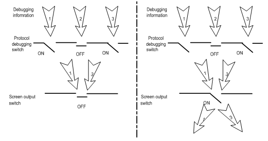

System debugging
The device supports debugging for the majority of protocols and features and provides debugging information to help users diagnose errors.
Debugging information control switches
The following switches control the display of debugging information:
·          Protocol debugging switch—Controls whether to generate the protocol-specific debugging information.
·          Screen output switchControls whether to display the debugging information on a certain screen.
As shown in Figure 3, assume that the device can provide debugging for the three modules 1, 2, and 3. The debugging information can be output on a terminal only when both the protocol debugging switch and the screen output switch are turned on.
Output of debugging information depends on the configurations of the information center and the debugging commands of each protocol and functional module. Debugging information is typically displayed on a terminal (including console or VTY). You can also send debugging information to other destinations. For more information, see "Configuring the information center."
Figure 3 Relationship between the protocol and screen output switch
