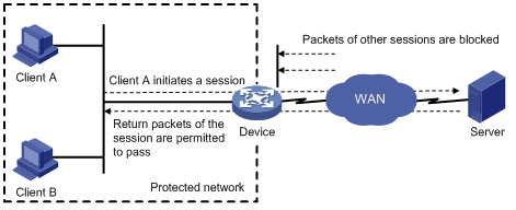

As shown in Figure 1, ACLs on the edge device deny incoming packets to the internal network. The ASPF application layer protocol inspection allows return packets from the external network to the internal network.
Figure 1 Application layer protocol inspection
ASPF inspects all application layer sessions as follows:
·     For a single-channel protocol, such as HTTP, the inspection process is simple.
ASPF creates a session entry immediately after it detects the session's first packet sent to the external network, and ASPF removes the entry when the connection is terminated.
The session entry helps record outgoing packets and their return packets. It can maintain the session status and determine whether state transitions of the session are correct. All packets that match a session entry can pass through the packet-filter firewall.

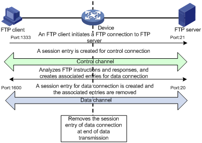

The following uses FTP to explain the process of multichannel application layer protocol inspection.
Figure 2 FTP inspection
As shown in Figure 2, FTP connections are established and removed as follows:
1.     The FTP client initiates an FTP control connection from port 1333 to port 21 of the FTP server.
2.     As a result of negotiation, the server initiates a data connection from port 20 to port 1600 of the client.
3.     When data transmission times out or ends, the data connection is removed.
ASPF implements FTP inspection during the FTP connection lifetime as follows:
1.     ASPF checks the IP packets the FTP client sends to the FTP server to identify TCP-based FTP packets. Based on the port number, ASPF identifies the control connection between the FTP client and server and creates a control connection session entry.
2.     ASPF checks each FTP control connection packet, and examines their TCP status based on the control connection session entry. ASPF analyzes the FTP instructions in the control connection packet. If the packet contains a data channel setup instruction, ASPF creates an associated entry for the data connection.
3.     For return FTP control connection packets, ASPF examines their TCP status based on the control connection session entry to make packet forwarding decisions.
4.     When the FTP data passes through the device, ASPF is triggered to create a session entry for the data connection and remove the associated entry.
5.     For returned FTP data packets, ASPF examines their TCP status based on the data connection session entry to make packet forwarding decisions.
6.     When the data transmission ends, ASPF removes the data connection session entry. When the FTP connection is removed, ASPF removes the control connection session entry.

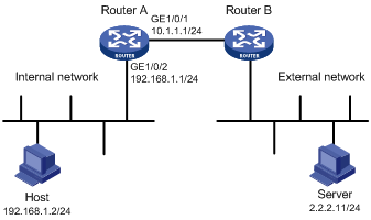

Example: Configuring ASPF FTP application inspection
Configure an ASPF policy on Router A to inspect the FTP traffic flows passing through Router A. Only return packets for FTP connections initiated by users on the internal network are permitted to pass through Router A and get into the internal network. All other types of packets from the external network to the internal network are blocked.
Figure 3 Network diagram
# Configure ACL 3111 to deny all IP packets.
<RouterA> system-view
[RouterA] acl advanced 3111
[RouterA-acl-ipv4-adv-3111] rule deny ip
[RouterA-acl-ipv4-adv-3111] quit
# Create ASPF policy 1 for FTP inspection.
[RouterA] aspf-policy 1
[RouterA-aspf-policy-1] detect ftp
[RouterA-aspf-policy-1] quit
# Apply ACL 3111 to deny all incoming IP packets on GigabitEthernet 1/0/1.
[RouterA] interface gigabitethernet 1/0/1
[RouterA-GigabitEthernet1/0/1] packet-filter 3111 inbound
# Apply ASPF policy 1 to the outgoing traffic on GigabitEthernet 1/0/1.
[RouterA-GigabitEthernet1/0/1] aspf apply policy 1 outbound
[RouterA-GigabitEthernet1/0/1] quit
# Verify that an ASPF session has been established for the FTP connection between the host and the FTP server.
[RouterA] display aspf session ipv4
Slot 0:
Initiator:
  Source      IP/port: 192.168.1.2/1877
  Destination IP/port: 2.2.2.11/21
  VPN instance/VLAN ID/Inline ID: -/-/-
  Protocol: TCP(6)
  Inbound interface: GigabitEthernet1/0/1
Total sessions found: 1
# Verify that only the return packets of FTP connections can enter the internal network. (Details not shown.)

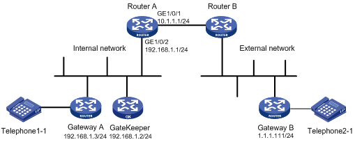

Example: Configuring ASPF H.323 application inspection
Figure 5 displays a typical H.323 application network. Gateway B on the external network needs to access the H.323 Gatekeeper, and with the assistance of Gatekeeper, to establish a connection with the H.323 Gateway A. Other protocol packets from the external network are dropped.
Configure a packet filter on Router A to permit only packets destined to the Gatekeeper. Configure an ASPF policy on Router A to detect H.323 protocol packets so that return packets to the external network can be passed through GigabitEthernet 1/0/1.
Figure 5 Network diagram
# Create ACL 3200 and configure two rules in the ACL: one to permit packets destined to Gatekeeper to pass, and one to deny all IP packets.
[RouterA] acl advanced 3200
[RouterA-acl-ipv4-adv-3200] rule 0 permit ip destination 192.168.1.2 0
[RouterA-acl-ipv4-adv-3200] rule 5 deny ip
[RouterA-acl-ipv4-adv-3200] quit
# Create ASPF policy 1 for H.323 inspection.
[RouterA] aspf policy 1
[RouterA-aspf-policy-1] detect h323
# Apply ACL 3200 to filter incoming packets on GigabitEthernet 1/0/1.
[RouterA-GigabitEthernet1/0/1] packet-filter 3200 inbound
# Apply ASPF policy 1 to incoming traffic on GigabitEthernet 1/0/1.
[RouterA-GigabitEthernet1/0/1] aspf apply policy 1 inbound
# Verify that ASPF sessions have been created between Gateway B and Gatekeeper/Gateway A.
Slot 0:
Initiator:
  Source      IP/port: 1.1.1.111/33184
  Destination IP/port: 192.168.1.3/32828
  Protocol: UDP(17)
Initiator:
  Source      IP/port: 1.1.1.111/1719
  Destination IP/port: 192.168.1.2/1719
  Protocol: UDP(17)
Initiator:
  Source      IP/port: 1.1.1.111/3521
  Destination IP/port: 192.168.1.2/20155
  Protocol: TCP(6)
Initiator:
  Source      IP/port: 1.1.1.111/33185
  Destination IP/port: 192.168.1.3/32829
  Protocol: UDP(17)
Initiator:
  Source      IP/port: 1.1.1.111/3688
  Destination IP/port: 192.168.1.2/1720
  Protocol: TCP(6)
Total sessions found: 5
# Verify that only return packets that match the entries can pass through GigabitEthernet 1/0/1. (Details not shown.)

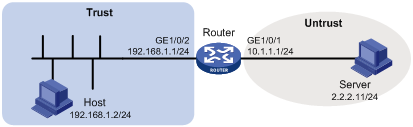

Example: Configuring ASPF for a zone pair
Configure an ASPF policy on the router to inspect FTP traffic that passes through the router to implement the following filtering:
·     Permits only return packets for the FTP connections initiated by users on the internal network to pass through the router .
·     Blocks all other types of packets from the external network to the internal network.
Figure 6 Network diagram
# Configure ACL 3500 to permit IP packets.
<Router> system-view
[Router] acl advanced 3500
[Router-acl-ipv4-adv-3500] rule permit ip
[Router-acl-ipv4-adv-3500] quit
# Add GigabitEthernet 1/0/2 to security zone Trust.
[Router] security-zone name trust
[Router-security-zone-Trust] import interface gigabitethernet 1/0/2
[Router-security-zone-Trust] quit
# Add GigabitEthernet 1/0/1 to security zone Untrust.
[Router] security-zone name untrust
[Router-security-zone-Untrust] import interface gigabitethernet 1/0/1
[Router-security-zone-Untrust] quit
[Router] aspf policy 1
[Router-aspf-policy-1] detect ftp
[Router-aspf-policy-1] quit
# Create a zone pair and enter its view.
[Router] zone-pair security source trust destination untrust
# Apply the ACL to filter to permit outgoing packets in the zone pair.
[Router-zone-pair-security-Trust-Untrust] packet-filter 3500
# Apply the ASPF policy to the zone pair.
[Router-zone-pair-security-Trust-Untrust] aspf apply policy 1
[Router-zone-pair-security-Trust-Untrust] quit
# Verify that an ASPF session has been established for the FTP connection between the host and the server.
[Router] display aspf session ipv4
Slot 0:
Initiator:
  Protocol: TCP(6)
  Inbound interface: GigabitEthernet1/0/2
  Source security zone: Trust
# Verify that only return packets that match the entries can enter the internal network. (Details not shown.)
