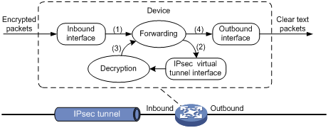

Figure 5 Tunnel interface de-encapsulation
As shown in Figure 5, a tunnel interface de-encapsulates an IP packet as follows:
1.     Upon receiving an encrypted packet, the inbound interface sends the packet to the forwarding module for routing.
2.     Because the packet is destined for the tunnel interface' source address and the payload protocol is AH or ESP, the forwarding module sends the packet to the tunnel interface.
3.     The tunnel interface de-encapsulates the packet (removes the outer IP header) and sends the de-encapsulated packet back to the forwarding module.
4.     The forwarding module looks up the routing table again and sends the packet out of the output interface.

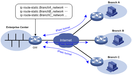

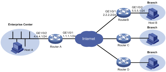

IPsec RRI
IPsec Reverse Route Injection (RRI) enables an IPsec tunnel gateway to automatically add and delete static routes destined for the protected private networks. It automatically adds the static routes when the IPsec SAs are established and deletes the static routes when the IPsec SAs are deleted. This greatly reduces the static route configuration work load on the gateway and increases the scalability of the IPsec VPN.
IPsec RRI is applicable to gateways that must provide many IPsec tunnels (for example, a headquarters gateway).
As shown in Figure 6, the traffic between the enterprise center and the branches are protected by IPsec. The gateway at the enterprise center is configured with static routes to route traffic to the IPsec-protected interfaces. It is difficult to add or modify static routes on the gateway at the enterprise center if the IPsec VPN has a large number of branches or if the network structure changes.
Figure 6 IPsec VPN
After you can enable IPsec RRI on the gateway, the gateway automatically adds a static route to the routing table each time an IPsec tunnel is established. The destination IP address is the protected private network. The next hop IP address can be the remote IP address of the IPsec tunnel (default) or a user-defined next hop IP address. Traffic destined for the peer end is routed to the IPsec tunnel interface and thereby protected by IPsec.
You can advertise the static routes created by IPsec RRI in the internal network, and the internal network device can use them to forward traffic in the IPsec VPN.
You can set preferences for the static routes created by IPsec RRI to implement flexible route management. For example, you can set the same preference for multiple routes to the same destination to implement load sharing, or you can set different preferences to implement route backup.
You can also set tags for the static routes created by IPsec RRI to implement flexible route control through routing policies.

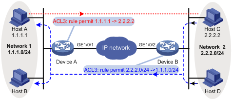

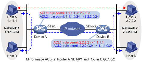

Mirror image ACLs
To make sure SAs can be set up and the traffic protected by IPsec can be processed correctly between two IPsec peers, create mirror image ACLs on the IPsec peers. As shown in Figure 7, ACL rules on Device B are mirror images of the rules on Device A. In this way, SAs can be created successfully for the traffic between Host A and Host C and for the traffic between Network 1 and Network 2.
Figure 7 Mirror image ACLs
If the ACL rules on IPsec peers do not form mirror images of each other, SAs can be set up only when both of the following requirements are met:
·     The range specified by an ACL rule on one peer is covered by its counterpart ACL rule on the other peer. As shown in Figure 8, the range specified by the ACL rule configured on Device A is covered by its counterpart on Device B.
·     The peer with the narrower rule initiates SA negotiation. If a wider ACL rule is used by the SA initiator, the negotiation request might be rejected because the matching traffic is beyond the scope of the responder. As shown in Figure 8, the SA negotiation initiated by Host A to Host C is accepted but the SA negotiations from Host C to Host A, from Host C to Host B, and from Host D to Host A are rejected.
Figure 8 Non-mirror image ACLs

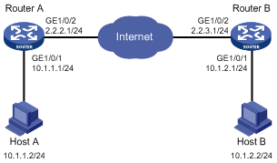

Example: Configuring a manual mode IPsec tunnel for IPv4 packets
As shown in Figure 10, establish an IPsec tunnel between Router A and Router B to protect data flows between subnet 10.1.1.0/24 and subnet 10.1.2.0/24. Configure the tunnel as follows:
·     Specify the encapsulation mode as tunnel, the security protocol as ESP, the encryption algorithm as 128-bit AES, and the authentication algorithm as HMAC-SHA1.
·     Manually set up IPsec SAs.
Figure 10 Network diagram
1.     Configure Router A:
# Configure IP addresses for interfaces. (Details not shown.)
# Configure an IPv4 advanced ACL to identify data flows from subnet 10.1.1.0/24 to subnet 10.1.2.0/24.
<RouterA> system-view
[RouterA] acl advanced 3101
[RouterA-acl-ipv4-adv-3101] rule permit ip source 10.1.1.0 0.0.0.255 destination 10.1.2.0 0.0.0.255
[RouterA-acl-ipv4-adv-3101] quit
# Configure a static route to Host B. The command uses the direct next hop address (2.2.2.3) as an example.
[RouterA] ip route-static 10.1.2.0 255.255.255.0 gigabitethernet 1/0/2 2.2.2.3
# Create an IPsec transform set named tran1.
[RouterA] ipsec transform-set tran1
# Specify the tunnel encapsulation mode.
[RouterA-ipsec-transform-set-tran1] encapsulation-mode tunnel
# Specify the ESP security protocol.
[RouterA-ipsec-transform-set-tran1] protocol esp
# Specify the ESP encryption and authentication algorithms.
[RouterA-ipsec-transform-set-tran1] esp encryption-algorithm aes-cbc-128
[RouterA-ipsec-transform-set-tran1] esp authentication-algorithm sha1
[RouterA-ipsec-transform-set-tran1] quit
# Create an IKE-based IPsec policy entry with name map1 and sequence number 10.
[RouterA] ipsec policy map1 10 manual
# Apply ACL 3101.
[RouterA-ipsec-policy-manual-map1-10] security acl 3101
# Apply IPsec transform set tran1.
[RouterA-ipsec-policy-manual-map1-10] transform-set tran1
# Specify 2.2.3.1 as the remote IP address of the IPsec tunnel.
[RouterA-ipsec-policy-manual-map1-10] remote-address 2.2.3.1
# Configure the inbound and outbound SPIs for ESP.
[RouterA-ipsec-policy-manual-map1-10] sa spi outbound esp 12345
[RouterA-ipsec-policy-manual-map1-10] sa spi inbound esp 54321
# Configure the inbound and outbound SA keys for ESP.
[RouterA-ipsec-policy-manual-map1-10] sa string-key outbound esp simple abcdefg
[RouterA-ipsec-policy-manual-map1-10] sa string-key inbound esp simple gfedcba
[RouterA-ipsec-policy-manual-map1-10] quit
# Apply IPsec policy map1 to GigabitEthernet 1/0/2.
[RouterA] interface gigabitethernet 1/0/2
[RouterA-GigabitEthernet1/0/2] ip address 2.2.2.1 255.255.255.0
[RouterA-GigabitEthernet1/0/2] ipsec apply policy map1
[RouterA-GigabitEthernet1/0/2] quit
2.     Configure Router B:
# Configure an IPv4 advanced ACL to identify data flows from subnet 10.1.2.0/24 to subnet 10.1.1.0/24.
<RouterB> system-view
[RouterB] acl advanced 3101
[RouterB-acl-ipv4-adv-3101] rule permit ip source 10.1.2.0 0.0.0.255 destination 10.1.1.0 0.0.0.255
[RouterB-acl-ipv4-adv-3101] quit
# Configure a static route to Host A. The command uses the direct next hop address (2.2.3.3) as an example.
[RouterB] ip route-static 10.1.1.0 255.255.255.0 gigabitethernet 1/0/2 2.2.3.3
[RouterB] ipsec transform-set tran1
[RouterB-ipsec-transform-set-tran1] encapsulation-mode tunnel
[RouterB-ipsec-transform-set-tran1] protocol esp
[RouterB-ipsec-transform-set-tran1] esp encryption-algorithm aes-cbc-128
[RouterB-ipsec-transform-set-tran1] esp authentication-algorithm sha1
[RouterB-ipsec-transform-set-tran1] quit
# Create a manual IPsec policy entry. Specify use1 as the policy name and set the sequence number to 10.
[RouterB] ipsec policy use1 10 manual
# Apply ACL 3101.
[RouterB-ipsec-policy-manual-use1-10] security acl 3101
[RouterB-ipsec-policy-manual-use1-10] transform-set tran1
# Specify 2.2.2.1 as the remote IP address for the IPsec tunnel.
[RouterB-ipsec-policy-manual-use1-10] remote-address 2.2.2.1
[RouterB-ipsec-policy-manual-use1-10] sa spi outbound esp 54321
[RouterB-ipsec-policy-manual-use1-10] sa spi inbound esp 12345
[RouterB-ipsec-policy-manual-use1-10] sa string-key outbound esp simple gfedcba
[RouterB-ipsec-policy-manual-use1-10] sa string-key inbound esp simple abcdefg
[RouterB-ipsec-policy-manual-use1-10] quit
# Apply IPsec policy use1 to GigabitEthernet 1/0/2.
[RouterB] interface gigabitethernet 1/0/2
[RouterB-GigabitEthernet1/0/2] ip address 2.2.3.1 255.255.255.0
[RouterB-GigabitEthernet1/0/2] ipsec policy use1
[RouterB-GigabitEthernet1/0/2] quit
After the configuration is completed, an IPsec tunnel between Router A and Router B is established, and the traffic between subnet 10.1.1.0/24 and subnet 10.1.2.0/24 is IPsec-protected. This example uses Router A to verify the configuration.
# Display IPsec SAs on Router A.
[RouterA] display ipsec sa
Interface: GigabitEthernet1/0/2
  IPsec policy: map1
  Sequence number: 10
  Mode: Manual
    Tunnel id: 549
    Encapsulation mode: tunnel
    Path MTU: 1443
    Tunnel:
        local  address: 2.2.2.1
        remote address: 2.2.3.1
    Flow:
        as defined in ACL 3101
    [Inbound ESP SA]
      SPI: 54321 (0x0000d431)
      Connection ID: 90194313219
      Transform set: ESP-ENCRYPT-AES-CBC-128 ESP-AUTH-SHA1
      No duration limit for this SA
    [Outbound ESP SA]
      SPI: 12345 (0x00003039)
      Connection ID: 64424509441

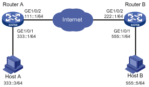

·     Set up SAs through IKE negotiation.
Figure 12 Network diagram
# Configure IPv6 addresses for interfaces. (Details not shown.)
# Configure an IPv6 advanced ACL to identify data flows from subnet 333::/64 to subnet 555::/64.
[RouterA] acl ipv6 advanced 3101
[RouterA-acl-ipv6-adv-3101] rule permit ipv6 source 333::0 64 destination 555::0 64
[RouterA-acl-ipv6-adv-3101] quit
# Configure a static route to Host B. The command uses the direct next hop address (111::2) as an example.
[RouterA] ipv6 route-static 555::0 64 111::2
# Create and configure an IKE keychain named keychain1.
[RouterA] ike keychain keychain1
[RouterA-ike-keychain-keychain1] pre-shared-key address ipv6 222::1 64 key simple 123456TESTplat&!
[RouterA-ike-keychain-keychain1] quit
# Create and configure an IKE profile named profile1.
[RouterA] ike profile profile1
[RouterA-ike-profile-profile1] keychain keychain1
[RouterA-ike-profile-profile1] match remote identity address ipv6 222::1 64
[RouterA-ike-profile-profile1] quit
[RouterA] ipsec ipv6-policy map1 10 isakmp
# Apply IPv6 ACL 3101.
[RouterA-ipsec-ipv6-policy-isakmp-map1-10] security acl ipv6 3101
[RouterA-ipsec-ipv6-policy-isakmp-map1-10] transform-set tran1
# Specify the local and remote IPv6 addresses of the IPsec tunnel as 111::1 and 222::1.
[RouterA-ipsec-ipv6-policy-isakmp-map1-10] local-address ipv6 111::1
[RouterA-ipsec-ipv6-policy-isakmp-map1-10] remote-address ipv6 222::1
# Apply IKE profile profile1.
[RouterA-ipsec-ipv6-policy-isakmp-map1-10] ike-profile profile1
[RouterA-ipsec-ipv6-policy-isakmp-map1-10] quit
[RouterA-GigabitEthernet1/0/2] ipv6 address 111::1/64
[RouterA-GigabitEthernet1/0/2] ipsec apply ipv6-policy map1
# Configure an IPv6 advanced ACL to identify data flows from subnet 555::/64 to subnet 333::/64.
[RouterB] acl ipv6 advanced 3101
[RouterB-acl-ipv6-adv-3101] rule permit ipv6 source 555::/64 destination 333::/64
[RouterB-acl-ipv6-adv-3101] quit
# Configure a static route to Host A. The command uses the direct next hop address (222::2) as an example.
[RouterB] ipv6 route-static 333::0 64 222::2
[RouterB] ike keychain keychain1
[RouterB-ike-keychain-keychain1] pre-shared-key address ipv6 111::1 64 key simple 123456TESTplat&!
[RouterB-ike-keychain-keychain1] quit
[RouterB] ike profile profile1
[RouterB-ike-profile-profile1] keychain keychain1
[RouterB-ike-profile-profile1] match remote identity address ipv6 111::1 64
[RouterB-ike-profile-profile1] quit
# Create an IKE-based IPsec policy entry. Specify use1 as the policy name and set the sequence number to 10.
[RouterB] ipsec ipv6-policy use1 10 isakmp
# Apply ACL 3101.
[RouterB-ipsec-ipv6-policy-isakmp-use1-10] security acl ipv6 3101
[RouterB-ipsec-ipv6-policy-isakmp-use1-10] transform-set tran1
# Specify the local and remote IPv6 addresses of the IPsec tunnel as 222::1 and 111::1.
[RouterB-ipsec-ipv6-policy-isakmp-use1-10] local-address ipv6 222::1
[RouterB-ipsec-ipv6-policy-isakmp-use1-10] remote-address ipv6 111::1
[RouterB-ipsec-ipv6-policy-isakmp-use1-10] ike-profile profile1
[RouterB-ipsec-ipv6-policy-isakmp-use1-10] quit
[RouterB-GigabitEthernet1/0/2] ipv6 address 222::1/64
[RouterB-GigabitEthernet1/0/2] ipsec apply ipv6-policy use1
# Initiate a connection from subnet 333::/64 to subnet 555::/64 to trigger IKE negotiation. After IPsec SAs are successfully negotiated by IKE, the traffic between the two subnets is IPsec-protected.
Interface: GigabitEthernet 1/0/2
  IPsec policy: map1
  Sequence number: 10
  Mode: ISAKMP
    Tunnel id: 0
    Perfect Forward Secrecy:
    Inside VPN:
    Extended Sequence Numbers enable: N
    Traffic Flow Confidentiality enable: N
    Path MTU: 1423
    Tunnel:
        local  address: 111::1
        remote address: 222::1
    Flow:
    sour addr: 111::1/0      port: 0  protocol: ipv6
    dest addr: 222::1/0      port: 0  protocol: ipv6
    [Inbound ESP SAs]
      SPI: 3769702703 (0xe0b1192f)
      Connection ID: 1
      SA duration (kilobytes/sec): 3000/28800
      SA remaining duration (kilobytes/sec): 2300/797
      Max received sequence-number: 1
      Anti-replay check enable: N
      Anti-replay window size:
      UDP encapsulation used for NAT traversal: N
      Status: Active
    [Outbound ESP SAs]
      SPI: 3840956402 (0xe4f057f2)
      Connection ID: 2
      SA remaining duration (kilobytes/sec): 2312/797
      Max sent sequence-number: 1
      Status: Active
# Display IPsec SAs on Router B. (Details not shown.)

Example: Configuring IPsec RRI
As shown in Figure 14, branches access the enterprise center through an IPsec VPN.
Configure the IPsec VPN as follows:
·     Configure an IPsec tunnel between Router A and each branch gateway (Router B, Router C, and Router D) to protect traffic between subnets 4.4.4.0/24 and 5.5.5.0/24.
·     Configure the tunnels to use security protocol ESP, encryption algorithm DES, and authentication algorithm SHA1-HMAC-96. Use IKE for IPsec SA negotiation.
·     On each router, configure an IKE proposal to use the preshared key authentication method, encryption algorithm 3DES, and authentication algorithm HMAC-SHA1.
·     Configure IPsec RRI on Router A to automatically create static routes to the branches based on the established IPsec SAs.
Figure 14 Network diagram
1.     Assign IPv4 addresses to the interfaces on the routers according to Figure 14. (Details not shown.)
2.     Configure Router A:
# Create an IPsec transform set named tran1, and specify ESP as the security protocol, DES as the encryption algorithm, and HMAC-SHA-1-96 as the authentication algorithm.
[RouterA-ipsec-transform-set-tran1] esp encryption-algorithm des
# Create and configure the IPsec profile named profile1.
[RouterA-ike-profile-profile1] keychain key1
[RouterA-ike-profile-profile1] match remote identity address 2.2.2.2 255.255.255.0
# Create an IPsec policy template named temp1. Specify IPsec transform set tran1 and IKE profile profile1 for the IPsec policy template.
[RouterA] ipsec policy-template temp1 1
[RouterA-ipsec-policy-template-temp1-1] transform-set tran1
[RouterA-ipsec-policy-template-temp1-1] ike-profile profile1
# Enable IPsec RRI, and set the preference to 100 and the tag to 1000 for the static routes created by IPsec RRI.
[RouterA-ipsec-policy-template-temp1-1] reverse-route dynamic
[RouterA-ipsec-policy-template-temp1-1] reverse-route preference 100
[RouterA-ipsec-policy-template-temp1-1] reverse-route tag 1000
[RouterA-ipsec-policy-template-temp1-1] quit
[RouterA] ipsec policy map1 10 isakmp template temp1
# Create an IKE proposal named 1, and specify 3DES as the encryption algorithm, HMAC-SHA1 as the authentication algorithm, and pre-share as the authentication method.
[RouterA] ike proposal 1
[RouterA-ike-proposal-1] encryption-algorithm 3des-cbc
[RouterA-ike-proposal-1] authentication-algorithm sha
[RouterA-ike-proposal-1] authentication-method pre-share
[RouterA-ike-proposal-1] quit
# Create an IKE keychain named key1 and specify 123 in plain text as the preshared key to be used with the remote peer at 2.2.2.2.
[RouterA] ike keychain key1
[RouterA-ike-keychain-key1] pre-shared-key address 2.2.2.2 key simple 123
[RouterA-ike-keychain-key1] quit
# Apply IPsec policy map1 to GigabitEthernet 1/0/1.
[RouterA] interface gigabitethernet 1/0/1
[RouterA-GigabitEthernet1/0/1] ipsec apply policy map1
[RouterA-GigabitEthernet1/0/1] quit
3.     Configure Router B:
[RouterB-ipsec-transform-set-tran1] esp encryption-algorithm des
# Configure IPv4 advanced ACL 3000 to identify traffic from subnet 5.5.5.0/24 to subnet 4.4.4.0/24.
[RouterB] acl advanced 3000
[RouterB-acl-ipv4-adv-3000] rule permit ip source 5.5.5.0 0.0.0.255 destination 4.4.4.0 0.0.0.255
[RouterB-acl-ipv4-adv-3000] quit
[RouterB-ike-profile-profile1] keychain key1
[RouterB-ike-profile-profile1] match remote identity address 1.1.1.1 255.255.255.0
# Create an IKE-based IPsec policy entry named map1 and configure the following settings for the policy entry:
¡     Set the sequence number to 10.
¡     Specify transform set tran1 and ACL 3000.
¡     Specify the remote IP address for the tunnel as 1.1.1.1.
¡     Specify IKE profile profile1.
[RouterB] ipsec policy map1 10 isakmp
[RouterB-ipsec-policy-isakmp-map1-10] transform-set tran1
[RouterB-ipsec-policy-isakmp-map1-10] security acl 3000
[RouterB-ipsec-policy-isakmp-map1-10] remote-address 1.1.1.1
[RouterB-ipsec-policy-isakmp-map1-10] ike-profile profile1
[RouterB-ipsec-policy-isakmp-map1-10] quit
[RouterB] ike proposal 1
[RouterB-ike-proposal-1] encryption-algorithm 3des-cbc
[RouterB-ike-proposal-1] authentication-algorithm sha
[RouterB-ike-proposal-1] authentication-method pre-share
[RouterB-ike-proposal-1] quit
# Create an IKE keychain named key1 and specify 123 in plain text as the preshared key to be used with the remote peer at 1.1.1.1.
[RouterB] ike keychain key1
[RouterB-ike-keychain-key1] pre-shared-key address 1.1.1.1 key simple 123
[RouterB-ike-keychain-key1] quit
[RouterB-GigabitEthernet1/0/1] ipsec apply policy map1
[RouterB-GigabitEthernet1/0/1] quit
Make sure Router B has a route to the peer private network, with the outgoing interface as GigabitEthernet 1/0/1.
4.     Configure Router C and Router D in the same way Router B is configured.
1.     Verify that IPsec RRI can automatically create a static route from Router A to Router B:
# Initiate a connection from subnet 5.5.5.0/24 to subnet 4.4.4.0/24. IKE negotiation is triggered to establish IPsec SAs between Router A and Router B. (Details not shown.)
# Verify that IPsec SAs are established on Router A.
Interface: GigabitEthernet1/0/1
  IPsec policy: map1
  Sequence number: 10
  Mode: Template
    Tunnel id: 0
    Inside VPN:
    Path MTU: 1463
    Tunnel:
        local  address: 1.1.1.1
        remote address: 2.2.2.2
    Flow:
        sour addr: 4.4.4.0/255.255.255.0  port: 0  protocol: ip
        dest addr: 5.5.5.0/255.255.255.0  port: 0  protocol: ip
    [Inbound ESP SAs]
      SPI: 1014286405 (0x3c74c845)
      Transform set: ESP-ENCRYPT-DES-CBC ESP-AUTH-SHA1
      SA duration (kilobytes/sec): 1843200/3600
      SA remaining duration (kilobytes/sec): 1843199/3590
      Max received sequence-number: 4
      Anti-replay check enable: Y
      Anti-replay window size: 64
      Status: Active
    [Outbound ESP SAs]
      SPI: 4011716027 (0xef1dedbb)
      Max sent sequence-number: 4
      Status: Active
# Verify that IPsec RRI has created a static route to reach Router B.
[RouterA] display ip routing-table verbose
2.     Verify that Router A can automatically create static routes to Router C and Router D in the same way that you verify the IPsec RRI feature by using Router A and Router B. (Details not shown.)

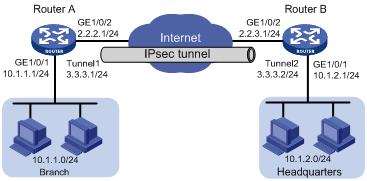

Example: Configuring IPsec tunnel interface-based IPsec for IPv4 packets
As shown in Figure 15, both the branch and the headquarters use fixed IP addresses to access the Internet.
Configure IPsec tunnel interface-based IPsec on Router A and Router B to protect the traffic between the branch (10.1.1.0/24) and the headquarters (10.1.2.0/24). This IPsec implementation ensures that the IPsec configuration of the headquarters remains stable despite of changes of the branch subnet.
Figure 15 Network diagram
Configuring Router A
1.     Configure routing to make sure GE1/0/2 on Router A and GE1/0/1 on Router B can reach each other through the IPv4 network. (Details not shown.)
2.     Configure IP addresses for the interfaces. (Details not shown.)
3.     Configure an IPsec profile:
# Create an IKE keychain named abc.
[RouterA] ike keychain abc
# Specify 123456TESTplat&! in plain text as the preshared key to be used with the remote peer at 2.2.3.1.
[RouterA-ike-keychain-abc] pre-shared-key address 2.2.3.1 255.255.255.0 key simple 123456TESTplat&!
[RouterA-ike-keychain-abc] quit
# Create an IKE profile named abc.
[RouterA] ike profile abc
# Specify IKE keychain abc for the IKE profile.
[RouterA-ike-profile-abc] keychain abc
# Set the local identify to IP address 2.2.2.1.
[RouterA-ike-profile-abc] local-identity address 2.2.2.1
# Configure a peer identity with the identity type of IP address and the value of 2.2.3.1/24.
[RouterA-ike-profile-abc] match remote identity address 2.2.3.1 24
# Set the IKE phase-1 negotiation mode to aggressive.
[RouterA-ike-profile-abc] exchange-mode aggressive
[RouterA-ike-profile-abc] quit
# Create an IPsec transform set named abc.
[RouterA] ipsec transform-set abc
# Specify encryption algorithm AES-CBC-128 for ESP.
[RouterA-ipsec-transform-set-abc] esp encryption-algorithm aes-cbc-128
# Specify authentication algorithm SHA1 for ESP.
[RouterA-ipsec-transform-set-abc] esp authentication-algorithm sha1
[RouterA-ipsec-transform-set-abc] quit
# Create an IKE-based IPsec profile named abc.
[RouterA] ipsec profile abc isakmp
# Specify IPsec transform set abc for the IPsec profile.
[RouterA-ipsec-profile-isakmp-abc] transform-set abc
# Specify IKE profile abc for the IPsec profile.
[RouterA-ipsec-profile-isakmp-abc] ike-profile abc
[RouterA-ipsec-profile-isakmp-abc] quit
4.     Configure an IPsec tunnel interface:
# Create IPsec tunnel interface Tunnel1.
[RouterA] interface tunnel 1 mode ipsec
# Configure an IP address for the tunnel interface.
[RouterA-Tunnel1] ip address 3.3.3.1 255.255.255.0
# Configure the IP address of GE1/0/2 on Router A as the source address of the tunnel interface.
[RouterA-Tunnel1] source 2.2.2.1
# Configure the IP address of GE1/0/2 on Router B as the destination address of the tunnel interface.
[RouterA-Tunnel1] destination 2.2.3.1
# Apply IPsec profile abc to the tunnel interface.
[RouterA-Tunnel1] tunnel protection ipsec profile abc
[RouterA-Tunnel1] quit
5.     Configure a static route from Router A to Router B that goes through the tunnel interface.
[RouterA] ip route-static 10.1.2.0 255.255.255.0 tunnel 1
Configure Router B
1.     Configure IP addresses for the interfaces. (Details not shown.)
2.     Configure an IPsec profile:
[RouterB] ike keychain abc
# Configure 123456TESTplat&! in plain text as the preshared key to be used with the remote peer at 2.2.2.1.
[RouterB-ike-keychain-abc] pre-shared-key address 2.2.2.1 255.255.255.0 key simple 123456TESTplat&!
[RouterB-ike-keychain-abc] quit
[RouterB] ike profile abc
[RouterB-ike-profile-abc] keychain abc
# Set the local identity to IP address 2.2.3.1.
[RouterB-ike-profile-abc] local-identity address 2.2.3.1
# Configure a peer identity with the identity type of IP address and the value of 2.2.2.1/24.
[RouterB-ike-profile-abc] match remote identity address 2.2.2.1 24
[RouterB-ike-profile-abc] exchange-mode aggressive
[RouterB-ike-profile-abc] quit
[RouterB] ipsec transform-set abc
[RouterB-ipsec-transform-set-abc] esp encryption-algorithm aes-cbc-128
[RouterB-ipsec-transform-set-abc] esp authentication-algorithm sha1
[RouterB-ipsec-transform-set-abc] quit
[RouterB] ipsec profile abc isakmp
[RouterB-ipsec-profile-isakmp-abc] transform-set abc
[RouterB-ipsec-profile-isakmp-abc] ike-profile abc
[RouterB-ipsec-profile-isakmp-abc] quit
3.     Configure an IPsec tunnel interface:
[RouterB] interface tunnel 1 mode ipsec
[RouterB-Tunnel1] ip address 3.3.3.2 255.255.255.0
# Configure the IP address of GE1/0/2 on Router B as the source address of the tunnel interface.
[RouterB-Tunnel1] source 2.2.3.1
# Configure the IP address of GE1/0/2 on Router A as the destination address of the tunnel interface.
[RouterB-Tunnel1] destination 2.2.2.1
[RouterB-Tunnel1] tunnel protection ipsec profile abc
[RouterB-Tunnel1] quit
4.     Configure a static route from Router B to Router A that goes through the tunnel interface.
[RouterB] ip route-static 10.1.1.0 255.255.255.0 tunnel 1
After the configuration is completed, Router A will automatically initiate IKE negotiation with Router B. After IKE negotiation succeeds, the tunnel interface will come up and traffic between the branch and the headquarters will be IPsec-protected. This example uses Router A to verify the configuration.
# Display brief IP configuration for interfaces on Router A.
<RouterA> display ip interface brief
*down: administratively down
(s): spoofing  (l): loopback
Interface                Physical Protocol IP Address      Description
GE1/0/1                  up       up       10.1.1.1        --
GE1/0/2                  up       up       2.2.2.1         --
Tun1                     up       up       3.3.3.1         --
# Display tunnel interface information on Router A.
<RouterA> display interface Tunnel 1
Tunnel1
Current state: UP
Line protocol state: UP
Description: Tunnel1 Interface
Bandwidth: 64 kbps
Maximum transmission unit: 1444
Internet address: 3.3.3.1/24 (primary)
Tunnel source 2.2.2.1, destination 2.2.3.1
Tunnel TTL 255
Tunnel protocol/transport IPsec/IP
Output queue - Urgent queuing: Size/Length/Discards 0/100/0
Output queue - Protocol queuing: Size/Length/Discards 0/500/0
Output queue - FIFO queuing: Size/Length/Discards 0/75/0
Last clearing of counters: Never
Last 300 seconds input rate: 0 bytes/sec, 0 bits/sec, 0 packets/sec
Last 300 seconds output rate: 0 bytes/sec, 0 bits/sec, 0 packets/sec
Input: 0 packets, 0 bytes, 0 drops
Output: 0 packets, 0 bytes, 0 drops
<RouterA> display ipsec sa
Interface: Tunnel1
  IPsec profile: abc
  Mode: ISAKMP
    Tunnel id: 0
    Path MTU: 1388
    Tunnel:
    Flow:
        sour addr: 0.0.0.0/0.0.0.0  port: 0  protocol: ip
        dest addr: 0.0.0.0/0.0.0.0  port: 0  protocol: ip
    [Inbound ESP SAs]
      SPI: 2701952073 (0xa10c8449)
      Connection ID: 4294967296
      SA remaining duration (kilobytes/sec): 1843200/3180
      Max received sequence-number: 0
      Status: Active
    [Outbound ESP SAs]
      SPI: 3607077598 (0xd6ffa2de)
      Connection ID: 12884901889
      Max sent sequence-number: 0
      Status: Active
# Verify that a private IP address in the branch subnet can ping a private IP address in the headquarters subnet successfully.
<RouterA> ping -a 10.1.1.1 10.1.2.1
Ping 10.1.2.1 (10.1.2.1) from 10.1.1.1: 56 data bytes, press CTRL_C to break
56 bytes from 10.1.2.1: icmp_seq=0 ttl=255 time=1.000 ms
56 bytes from 10.1.2.1: icmp_seq=1 ttl=255 time=1.000 ms
56 bytes from 10.1.2.1: icmp_seq=2 ttl=255 time=0.000 ms
56 bytes from 10.1.2.1: icmp_seq=3 ttl=255 time=1.000 ms
56 bytes from 10.1.2.1: icmp_seq=4 ttl=255 time=0.000 ms
--- Ping statistics for 10.1.2.1 ---
round-trip min/avg/max/std-dev = 0.000/0.600/1.000/0.490 ms

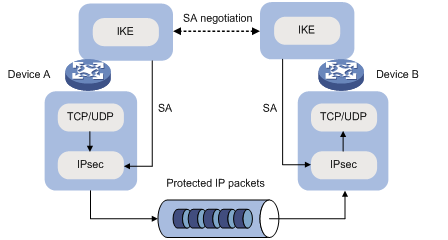

Relationship between IPsec and IKE
As shown in Figure 16, IKE negotiates SAs for IPsec and transfers the SAs to IPsec, and IPsec uses the SAs to protect IP packets.
Figure 16 Relationship between IKE and IPsec

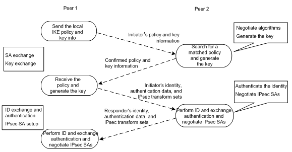

IKE negotiates keys and SAs for IPsec in two phases:
1.     Phase 1—The two peers establish an IKE SA, a secure, authenticated channel for communication.
2.     Phase 2—Using the IKE SA established in phase 1, the two peers negotiate to establish IPsec SAs.
Phase 1 negotiation can use the main mode, GM main mode, or aggressive mode.

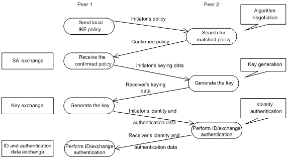

IKE exchange process in main mode
As shown in Figure 17, the main mode of IKE negotiation in phase 1 involves three pairs of messages:
·     SA exchange—Used for negotiating the IKE security policy.
·     Key exchange—Used for exchanging the DH public value and other values, such as the random number. The two peers use the exchanged data to generate key data and use the encryption key and authentication key to ensure the security of IP packets.
·     ID and authentication data exchange—Used for identity authentication.
Figure 17 IKE exchange process in main mode

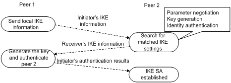

IKE exchange process in aggressive mode
As shown in Figure 18, the process of phase 1 IKE negotiation in aggressive mode is as follows:
1.     The initiator (peer 1) sends a message containing the local IKE information to peer 2. The message includes parameters used for IKE SA establishment, keying data, and peer 1's identity information.
2.     Peer 2 chooses the IKE establishment parameters to use, generate the key, and authenticate peer 1's identity. Then it sends the IKE data to peer 1.
3.     Peer 1 generates the key, authenticates peer 2's identity, and sends the results to peer 1.
After the preceding process, an IKE SA is established between peer 1 and peer 2.
The aggressive mode is faster than the main mode but it does not provide identity information protection. The main mode provides identity information protection but is slower. Choose the appropriate negotiation mode according to your requirements.
Figure 18 IKE exchange process in aggressive mode

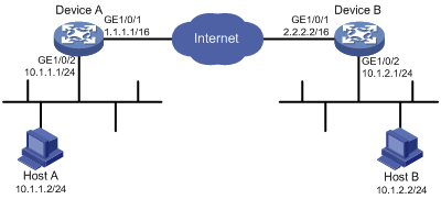

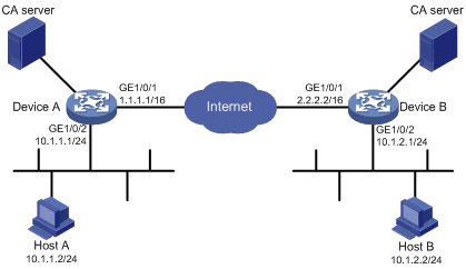

Example: Configuring main-mode IKE with preshared key authentication
As shown in Figure 19, configure an IKE-based IPsec tunnel between Device A and Device B to secure the communication between subnet 10.1.1.0/24 and subnet 10.1.2.0/24.
·     Configure Device A and Device B to use the default IKE proposal for the IKE negotiation to set up the IPsec SAs.
·     Configure the two devices to use the preshared key authentication method for the IKE negotiation phase 1.
Figure 19 Network diagram
1.     Configure Device A:
# Assign an IP address to each interface. (Details not shown.)
# Configure IPv4 advanced ACL 3101 to identify traffic from subnet 10.1.1.0/24 to subnet 10.1.2.0/24.

# Create an IKE keychain named keychain1.
[DeviceA] ike keychain keychain1
# Specify 123456TESTplat&! in plain text as the preshared key to be used with the remote peer at 2.2.2.2.
[DeviceA-ike-keychain-keychain1] pre-shared-key address 2.2.2.2 255.255.0.0 key simple 123456TESTplat&!
[DeviceA-ike-keychain-keychain1] quit
# Create an IKE profile named profile1.
[DeviceA] ike profile profile1
# Specify IKE keychain keychain1.
[DeviceA-ike-profile-profile1] keychain keychain1
# Configure the local ID with the identity type as IP address and the value as 1.1.1.1.
[DeviceA-ike-profile-profile1] local-identity address 1.1.1.1
# Specify IP address 2.2.2.2 as the peer ID.
[DeviceA-ike-profile-profile1] match remote identity address 2.2.2.2 255.255.0.0
[DeviceA-ike-profile-profile1] quit
[DeviceA] ipsec policy map1 10 isakmp
# Specify the remote IP address 2.2.2.2 for the IPsec tunnel.
[DeviceA-ipsec-policy-isakmp-map1-10] remote-address 2.2.2.2
# Specify ACL 3101 to identify the traffic to be protected.
[DeviceA-ipsec-policy-isakmp-map1-10] security acl 3101
# Specify IPsec transform set tran1 for the IPsec policy.
[DeviceA-ipsec-policy-isakmp-map1-10] transform-set tran1
# Specify IKE profile profile1 for the IPsec policy.
[DeviceA-ipsec-policy-isakmp-map1-10] ike-profile profile1
[DeviceA-ipsec-policy-isakmp-map1-10] quit
[DeviceA-GigabitEthernet1/0/1] ipsec apply policy map1
[DeviceA-GigabitEthernet1/0/1] quit
# Configure a static route to the subnet where Host B resides. This example uses 1.1.1.2 as the next hop IP address.
[DeviceA] ip route-static 10.1.2.0 255.255.255.0 1.1.1.2

Example: Configuring aggressive-mode IKE with RSA signature authentication
This configuration example is not available when the device is operating in FIPS mode.
As shown in Figure 20, configure an IKE-based IPsec tunnel between Device A and Device B to secure the communication between subnet 10.1.1.0/24 and subnet 10.1.2.0/24.
Configure Device A and Device B to use aggressive mode for IKE negotiation phase 1 and to use RSA signature authentication. Device A acts as the initiator, and the subnet where Device A resides uses IP addresses dynamically allocated.
Figure 20 Network diagram

# Create a PKI entity named entity1.
[DeviceA] pki entity entity1
# Set the common name to devicea for the PKI entity.
[DeviceA-pki-entity-entity1] common-name devicea
[DeviceA-pki-entity-entity1] quit
# Create a PKI domain named domain1.
[DeviceA] pki domain domain1
# Set the certificate request mode to auto and set the password to 123 for certificate revocation.
[DeviceA-pki-domain-domain1] certificate request mode auto password simple 123
# Set an MD5 fingerprint for verifying the validity of the CA root certificate.
[DeviceA-pki-domain-domain1] root-certificate fingerprint md5 50c7a2d282ea710a449eede6c56b102e
# Specify the trusted CA 8088.
[DeviceA-pki-domain-domain1] ca identifier 8088
# Specify the URL of the registration server for certificate request through the SCEP protocol. This example uses http://192.168.222.1:446/eadbf9af4f2c4641e685f7a6021e7b298373feb7.
[DeviceA-pki-domain-domain1] certificate request url http://192.168.222.1:446/eadbf9af4f2c4641e685f7a6021e7b298373feb7
# Specify the CA to accept certificate requests.
[DeviceA-pki-domain-domain1] certificate request from ca
# Specify the PKI entity for certificate request as entity1.
[DeviceA-pki-domain-domain1] certificate request entity entity1
# Specify RSA key pair rsa1 with the general purpose for certificate request.
[DeviceA-pki-domain-domain1] public-key rsa general name rsa1
[DeviceA-pki-domain-domain1] quit
# Specify PKI domain domain1 for the IKE profile.
[DeviceA-ike-profile-profile1] certificate domain domain1
# Specify that IKE negotiation operates in aggressive mode.
[DeviceA-ike-profile-profile1] exchange-mode aggressive
# Set the local identity to FQDN name www.devicea.com.
[DeviceA-ike-profile-profile1] local-identity fqdn www.devicea.com
# Configure a peer ID with the identity type of FQDN name and the value of www.deviceb.com.
[DeviceA-ike-profile-profile1] match remote identity fqdn www.deviceb.com
# Create an IKE proposal named 10.
[DeviceA] ike proposal 10
# Specify the authentication algorithm as HMAC-MD5.
[DeviceA-ike-proposal-10] authentication-algorithm md5
# Specify the RSA authentication method.
[DeviceA-ike-proposal-10] authentication-method rsa-signature
[DeviceA-ike-proposal-10] quit
# Specify remote IP address 2.2.2.2 for the IPsec tunnel.
2.     Configure Device B:
# Configure IPv4 advanced ACL 3101 to identify traffic from subnet 10.1.2.0/24 to subnet 10.1.1.0/24.
<DeviceB> system-view
[DeviceB] acl advanced 3101
[DeviceB-acl-ipv4-adv-3101] rule permit ip source 10.1.2.0 0.0.0.255 destination 10.1.1.0 0.0.0.255
[DeviceB-acl-ipv4-adv-3101] quit
[DeviceB] ipsec transform-set tran1
# Set the packet encapsulation mode to tunnel.
[DeviceB-ipsec-transform-set-tran1] encapsulation-mode tunnel
# Use the ESP protocol for the IPsec transform set.
[DeviceB-ipsec-transform-set-tran1] protocol esp
# Specify the encryption and authentication algorithms.
[DeviceB-ipsec-transform-set-tran1] esp encryption-algorithm des-cbc
[DeviceB-ipsec-transform-set-tran1] esp authentication-algorithm sha1
[DeviceB-ipsec-transform-set-tran1] quit
# Create a PKI entity named entity2.
[DeviceB] pki entity entity2
# Set the common name to deviceb for the PKI entity.
[DeviceB-pki-entity-entity2] common-name deviceb
[DeviceB-pki-entity-entity2] quit
# Create a PKI domain named domain2.
[DeviceB] pki domain domain2
[DeviceB-pki-domain-domain2] certificate request mode auto password simple 123
[DeviceB-pki-domain-domain2] root-certificate fingerprint md5 50c7a2d282ea710a449eede6c56b102e
[DeviceB-pki-domain-domain2] ca identifier 8088
[DeviceB-pki-domain-domain2] certificate request url http://192.168.222.1:446/eadbf9af4f2c4641e685f7a6021e7b298373feb7
[DeviceB-pki-domain-domain2] certificate request from ca
# Specify the PKI entity for certificate request as entity2.
[DeviceB-pki-domain-domain2] certificate request entity entity2
[DeviceB-pki-domain-domain2] public-key rsa general name rsa1
[DeviceB-pki-domain-domain2] quit
# Create an IKE profile named profile2.
[DeviceB] ike profile profile2
# Specify PKI domain domain2 for the IKE profile.
[DeviceB-ike-profile-profile2] certificate domain domain2
# Configure IKE phase 1 negotiation to use the aggressive mode.
[DeviceB-ike-profile-profile2] exchange-mode aggressive
# Set the local identity to FQDN name www.deviceb.com.
[DeviceB-ike-profile-profile2] local-identity fqdn www.deviceb.com
# Configure a peer ID with the identity type of FQDN name and the value of www.devicea.com.
[DeviceB-ike-profile-profile2] match remote identity fqdn www.devicea.com
[DeviceB-ike-profile-profile2] quit
[DeviceB] ike proposal 10
[DeviceB-ike-proposal-10] authentication-algorithm md5
[DeviceB-ike-proposal-10] authentication-method rsa-signature
[DeviceB-ike-proposal-10] quit
# Create an IPsec policy template entry. Specify template1 as the template name and set the sequence number to 1.
[DeviceB] ipsec policy-template template1 1
# Specify IPsec transform set tran1 for the IPsec policy template.
[DeviceB-ipsec-policy-template-template1-1] transform-set tran1
# Specify IKE profile profile2 for the IPsec policy template.
[DeviceB-ipsec-policy-template-template1-1] ike-profile profile2
[DeviceB-ipsec-policy-template-template1-1] quit
# Create an IKE-based IPsec policy entry by using IPsec policy template template1. Specify use1 as the policy name and set the sequence number to 1.
[DeviceB] ipsec policy use1 1 isakmp template template1
# Apply IPsec policy use1 to GigabitEthernet 1/0/1.
[DeviceB-GigabitEthernet1/0/1] ipsec apply policy use1
[DeviceB-GigabitEthernet1/0/1] quit
# Configure a static route to the subnet where Host A resides. This example uses 2.2.2.1 as the next hop IP address.
[DeviceB] ip route-static 10.1.1.0 255.255.255.0 2.2.2.1
# Initiate a connection from subnet 10.1.1.0/24 to subnet 10.1.2.0/24 to trigger IKE negotiation. After IPsec SAs are successfully negotiated by IKE, traffic between the two subnets is IPsec-protected.

    Connection-ID   Remote                Flag         DOI
    1               2.2.2.2               RD           IPsec
Flags:
RD--READY RL--REPLACED FD-FADING RK-REKEY
# Display information about the CA certificate on Device A.
[DeviceA] display pki certificate domain domain1 ca
Certificate:
    Data:
        Version: 1 (0x0)
        Serial Number:
            b9:14:fb:25:c9:08:2c:9d:f6:94:20:30:37:4e:00:00
        Signature Algorithm: sha1WithRSAEncryption
        Issuer: C=cn, O=rnd, OU=sec, CN=8088
        Validity
            Not Before: Sep  6 01:53:58 2012 GMT
            Not After : Sep  8 01:50:58 2015 GMT
        Subject: C=cn, O=rnd, OU=sec, CN=8088
        Subject Public Key Info:
            Public Key Algorithm: rsaEncryption
                Public-Key: (1024 bit)
                Modulus:
                    00:de:81:f4:42:c6:9f:c2:37:7b:21:84:57:d6:42:
                    00:69:1c:4c:34:a4:5e:bb:30:97:45:2b:5e:52:43:
                    c0:49:1f:e1:d8:0f:5c:48:c2:39:69:d1:84:e4:14:
                    70:3d:98:41:28:1c:20:a1:9a:3f:91:67:78:77:27:
                    d9:08:5f:7a:c4:36:45:8b:f9:7b:e7:7d:6a:98:bb:
                    4e:a1:cb:2c:3d:92:66:bd:fb:80:35:16:c6:35:f0:
                    ff:0b:b9:3c:f3:09:94:b7:d3:6f:50:8d:83:f1:66:
                    2f:91:0b:77:a5:98:22:b4:77:ac:84:1d:03:8e:33:
                    1b:31:03:78:4f:77:a0:db:af
                Exponent: 65537 (0x10001)
        9a:6d:8c:46:d3:18:8a:00:ce:12:ee:2b:b0:aa:39:5d:3f:90:
        08:49:b9:a9:8f:0d:6e:7b:e1:00:fb:41:f5:d4:0c:e4:56:d8:
        7a:a7:61:1d:2b:b6:72:e3:09:0b:13:9d:fa:c8:fc:c4:65:a7:
        f9:45:21:05:75:2c:bf:36:7b:48:b4:4a:b9:fe:87:b9:d8:cf:
        55:16:87:ec:07:1d:55:5a:89:74:73:68:5e:f9:1d:30:55:d9:
        8a:8f:c5:d4:20:7e:41:a9:37:57:ed:8e:83:a7:80:2f:b8:31:
        57:3a:f2:1a:28:32:ea:ea:c5:9a:55:61:6a:bc:e5:6b:59:0d:
        82:16
# Display the local certificate on Device A.
[DeviceA] display pki certificate domain domain1 local
Certificate:
    Data:
        Version: 3 (0x2)
        Serial Number:
            a1:f4:d4:fd:cc:54:c3:07:c4:9e:15:2d:5f:64:57:77
        Validity
            Not Before: Sep 26 02:06:43 2012 GMT
            Not After : Sep 26 02:06:43 2013 GMT
        Subject: CN=devicea
                Modulus:
                    00:b0:a1:cd:24:6e:1a:1d:51:79:f0:2a:3e:9f:e9:
                    84:07:16:78:49:1b:7d:0b:22:f0:0a:ed:75:91:a4:
                    17:fd:c7:ef:d0:66:5c:aa:e3:2a:d9:71:12:e4:c6:
                    25:77:f0:1d:97:bb:92:a8:bd:66:f8:f8:e8:d5:0d:
                    d2:c8:01:dd:ea:e6:e0:80:ad:db:9d:c8:d9:5f:03:
                    2d:22:07:e3:ed:cc:88:1e:3f:0c:5e:b3:d8:0e:2d:
                    ea:d6:c6:47:23:6a:11:ef:3c:0f:6b:61:f0:ca:a1:
                    79:a0:b1:02:1a:ae:8c:c9:44:e0:cf:d1:30:de:4c:
                    f0:e5:62:e7:d0:81:5d:de:d3
        X509v3 extensions:
            X509v3 CRL Distribution Points:
                Full Name:
                  URI:http://xx.rsa.com:447/8088.crl
        73:ac:66:f9:b8:b5:39:e1:6a:17:e4:d0:72:3e:26:9e:12:61:
        9e:c9:7a:86:6f:27:b0:b9:a3:5d:02:d9:5a:cb:79:0a:12:2e:
        cb:e7:24:57:e6:d9:77:12:6b:7a:cf:ee:d6:17:c5:5f:d2:98:
        30:e0:ef:00:39:4a:da:ff:1c:29:bb:2a:5b:60:e9:33:8f:78:
        f9:15:dc:a5:a3:09:66:32:ce:36:cd:f0:fe:2f:67:e5:72:e5:
        21:62:85:c4:07:92:c8:f1:d3:13:9c:2e:42:c1:5f:0e:8f:ff:
        65:fb:de:7c:ed:53:ab:14:7a:cf:69:f2:42:a4:44:7c:6e:90:
        7e:cd
# Display the IPsec SA information on Device A.
[DeviceA] display ipsec sa
  IPsec policy: map1
  Sequence number: 10
  Mode: ISAKMP
    Tunnel id: 0
    Inside VPN:
    Path MTU: 1456
    Tunnel:
    Flow:
        sour addr: 10.1.1.0/255.255.255.0  port: 0  protocol: ip
        dest addr: 10.1.2.0/255.255.255.0  port: 0  protocol: ip
    [Inbound ESP SAs]
      SPI: 3264152513 (0xc28f03c1)
      SA remaining duration (kilobytes/sec): 1843200/3484
      Status: Active
    [Outbound ESP SAs]
      SPI: 738451674 (0x2c03e0da)
      Status: Active
# Display the information about the CA certificate, local certificate, IKE SA, and IPsec SA on Device B.
[DeviceB] display ike sa
[DeviceB] display pki certificate domain domain2 ca
[DeviceB] display pki certificate domain domain2 local
[DeviceB] display ipsec sa

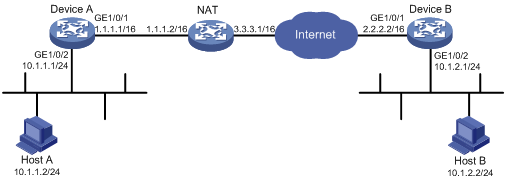

Example: Configuring aggressive-mode IKE with NAT traversal
Device A is behind the NAT device. Hosts behind Device A use public IP address 3.3.3.1 to access the external network.
Configure an IKE-based IPsec tunnel between Device A and Device B to secure the communication between subnet 10.1.1.0/24 and subnet 10.1.2.0/24.
·     Configure Device A and Device B to use the default IKE proposal for the aggressive IKE negotiation to set up the IPsec SAs.
Figure 21 Network diagram
# Configure IPv4 advanced ACL 3000 to identify traffic from subnet 10.1.1.0/24 to subnet 10.1.2.0/24.
<DeviceA> system-view
[DeviceA] acl advanced 3000
[DeviceA-acl-ipv4-adv-3000] rule 0 permit ip source 10.1.1.0 0.0.0.255 destination 10.1.2.0 0.0.0.255
[DeviceA-acl-ipv4-adv-3000] quit
# Create an IPsec transform set named transform1.
[DeviceA] ipsec transform-set transform1
[DeviceA-ipsec-transform-set-transform1] protocol esp
[DeviceA-ipsec-transform-set-transform1] esp encryption-algorithm 3des-cbc
[DeviceA-ipsec-transform-set-transform1] esp authentication-algorithm md5
[DeviceA-ipsec-transform-set-transform1] quit
# Specify 12345zxcvb!@#$%ZXCVB in plain text as the preshared key to be used with the remote peer at 2.2.2.2.
[DeviceA-ike-keychain-keychain1] pre-shared-key address 2.2.2.2 255.255.0.0 key simple 12345zxcvb!@#$%ZXCVB
# Create an IKE-based IPsec policy entry. Specify the policy name as policy1 and set the sequence number to 1.
[DeviceA] ipsec policy policy1 1 isakmp
[DeviceA-ipsec-policy-isakmp-policy1-1] remote-address 2.2.2.2
# Specify IPsec transform set transform1 for the IPsec policy.
[DeviceA-ipsec-policy-isakmp-policy1-1] transform-set transform1
# Specify ACL 3000 to identify the traffic to be protected.
[DeviceA-ipsec-policy-isakmp-policy1-1] security acl 3000
[DeviceA-ipsec-policy-isakmp-policy1-1] ike-profile profile1
[DeviceA-ipsec-policy-isakmp-policy1-1] quit
# Apply IPsec policy policy1 to GigabitEthernet 1/0/1.
[DeviceA-GigabitEthernet1/0/1] ipsec apply policy policy1
# Create IPsec transform set transform1.
[DeviceB] ipsec transform-set transform1
[DeviceB-ipsec-transform-set-transform1] protocol esp
[DeviceB-ipsec-transform-set-transform1] esp encryption-algorithm 3des-cbc
[DeviceB-ipsec-transform-set-transform1] esp authentication-algorithm md5
[DeviceB-ipsec-transform-set-transform1] quit
# Create IKE keychain keychain1.
[DeviceB]ike keychain keychain1
# Specify 12345zxcvb!@#$%ZXCVB in plain text as the preshared key to be used with the remote peer at 1.1.1.1. The source address of packets from 1.1.1.1 is translated into 3.3.3.1 by the NAT device, so specify the IP address of the remote peer as 3.3.3.1.
[DeviceB-ike-keychain-keychain1] pre-shared-key address 3.3.3.1 255.255.0.0 key simple 12345zxcvb!@#$%ZXCVB
[DeviceB-ike-keychain-keychain1] quit
[DeviceB] ike profile profile1
[DeviceB-ike-profile-profile1] keychain keychain1
[DeviceB-ike-profile-profile1] exchange-mode aggressive
[DeviceB-ike-profile-profile1] match remote identity fqdn www.devicea.com
[DeviceB-ike-profile-profile1] quit
# Specify IPsec transform set transform1 for the IPsec policy template.
[DeviceB-ipsec-policy-template-template1-1] transform-set transform1
# Specify 2.2.2.2 as the local address of the IPsec tunnel.
[DeviceB-ipsec-policy-template-template1-1] local-address 2.2.2.2
[DeviceB-ipsec-policy-template-template1-1] ike-profile profile1
# Create an IKE-based IPsec policy entry by using IPsec policy template template1. Specify the policy name as policy1 and set the sequence number to 1.
[DeviceB] ipsec policy policy1 1 isakmp template template1
[DeviceB-GigabitEthernet1/0/1] ipsec apply policy policy1
# Display the IKE SA on Device A.
[DeviceA] display ike sa
    13              2.2.2.2               RD           IPsec
Flags:
[DeviceA] display ike sa verbose
   Connection ID: 13
   Outside VPN:
   Inside VPN:
   Profile: profile1
   Transmitting entity: Initiator
   Initiator cookie: 1bcf453f0a217259
   Responder cookie: 5e32a74dfa66a0a4
   Local IP: 1.1.1.1
   Local ID type: FQDN
   Local ID: www.devicea.com
   Remote IP: 2.2.2.2
   Remote ID type: IPV4_ADDR
   Remote ID: 2.2.2.2
   Authentication-method: PRE-SHARED-KEY
   Authentication-algorithm: SHA1
   Encryption-algorithm: DES-CBC
   Life duration(sec): 86400
   Remaining key duration(sec): 84565
   Exchange-mode: Aggressive
   Diffie-Hellman group: Group 1
   NAT traversal: Detected
   Extend authentication: Disabled
   Assigned IP address:
   Vendor ID index: 0xa1d
   Vendor ID sequence number: 0x0
# Display the IPsec SAs generated on Device A.
  IPsec policy: policy1
  Sequence number: 1
  Mode: ISAKMP
    Tunnel id: 0
    Inside VPN:
    Path MTU: 1435
    Tunnel:
    Flow:
    [Inbound ESP SAs]
      SPI: 830667426 (0x3182faa2)
      Transform set: ESP-ENCRYPT-3DES-CBC ESP-AUTH-MD5
      SA remaining duration (kilobytes/sec): 1843200/2313
      UDP encapsulation used for NAT traversal: Y
      Status: Active
    [Outbound ESP SAs]
      SPI: 3516214669 (0xd1952d8d)
      Status: Active

# Specify 123456TESTplat&! in plain text as the preshared key to be used with the peer at 2.2.2.2.
[DeviceA-ike-keychain-keychain1] pre-shared-key address 2.2.2.2 255.255.255.255 key simple 123456TESTplat&!
# Specify IP address 1.1.1.1 as the local ID.
[DeviceA-ike-profile-profile1] match remote identity address 2.2.2.2 255.255.255.255
# Specify username test and password abc for extended authentication.
[DeviceA-ike-profile-profile1] client-authentication xauth user test password simple abc
# Create an IKE-based IPsec policy entry named policy1 with sequence number 10.
[DeviceA] ipsec policy policy1 10 isakmp
# Specify 2.2.2.2 as the remote IP address for the IPsec tunnel.
[DeviceA-ipsec-policy-isakmp-policy1-10] remote-address 2.2.2.2
# Specify 1.1.1.1 as the local IP address for the IPsec tunnel.
[DeviceA-ipsec-policy-isakmp-policy1-10] local-address 1.1.1.1
[DeviceA-ipsec-policy-isakmp- policy1-10] security acl 3101
[DeviceA-ipsec-policy-isakmp- policy1-10] transform-set tran1
[DeviceA-ipsec-policy-isakmp- policy1-10] ike-profile profile1
[DeviceA-ipsec-policy-isakmp- policy1-10] quit
3.     Configure Device B:
# Configure IP addresses for the interfaces, as shown in Figure 24. (Details not shown.)
# Create a RADIUS scheme named ike-scheme.
[DeviceB] radius scheme ike-scheme
# Specify the IP address and service port of the primary RADIUS authentication server.
[DeviceB-radius-ike-scheme] primary authentication 3.3.3.48 1645
# Set the shared key for secure RADIUS authentication communication.
[DeviceB-radius-ike-scheme] key authentication simple abc
# Configure the device to send the username without the ISP domain name to the RADIUS server. (The configuration varies with the RADIUS server's requirements for username.)
[DeviceB-radius-ike-scheme] user-name-format without-domain
[DeviceB-radius-ike-scheme] quit
# Create an ISP domain named ike and specify the RADIUS scheme used for authenticating the IKE users.
[DeviceB] domain ike
[DeviceB-isp-ike] authentication ike radius-scheme ike-scheme
[DeviceB-isp-ike] quit
# Configure an IPv4 advanced ACL to identify the packets to be protected.
[DeviceB-acl-ipv4-adv-3101] rule permit ip source 2.2.2.2 0.0.0.0 destination 1.1.1.1 0.0.0.0
# Created an IPsec transform set named tran1.
# Specify the transport encapsulation mode.
[DeviceB-ipsec-transform-set-tran1] encapsulation-mode transport
# Specify the ESP encryption algorithm and authentication algorithm.
[DeviceB-ipsec-transform-set-tran1] esp encryption-algorithm aes-cbc-128
[DeviceB] ike keychain keychain1
# Set the preshared key used for IKE negotiation with the peer at 1.1.1.1.
[DeviceB-ike-keychain-keychain1] pre-shared-key address 1.1.1.1 255.255.255.255 key simple 123456TESTplat&!
# Specify the IKE keychain for the IKE profile.
# Specify IP address 2.2.2.2 as the local ID.
[DeviceB-ike-profile-profile1] local-identity address 2.2.2.2
# Specify IP address 1.1.1.1 as the peer ID for IKE profile matching.
[DeviceB-ike-profile-profile1] match remote identity address 1.1.1.1 255.255.255.255
# Enable XAUTH authentication for clients.
[DeviceB-ike-profile-profile1] client-authentication xauth
[DeviceB] ipsec policy-template template1 10
# Specify the remote IP address for the IPsec tunnel.
[DeviceB-ipsec-policy-isakmp-template1-10] remote-address 1.1.1.1
# Specify ACL 3101.
[DeviceB-ipsec-policy-isakmp-template1-10] security acl 3101
# Specify the IPsec transform set.
[DeviceB-ipsec-policy-isakmp-template1-10] transform-set tran1
# Specify the IKE profile.
[DeviceB-ipsec-policy-isakmp-template1-10] ike-profile profile1
[Device-ipsec-policy-isakmp-template1-10] quit
# Use IPsec policy template template1 to create an IKE-based IPsec policy entry.
[DeviceB]ipsec policy policy1 10 isakmp template template1
# Apply the IPsec policy to GigabitEthernet 1/0/1.
# Enable Device A to send packets to the server at 3.3.3.48 to trigger IKE negotiation. Device A will send the username and password to Device B for extended authentication. After Device A passes the extended authentication, it can establish an IPsec tunnel with Device B. (Details not shown.)
# On Device B, verify that an IKE SA to peer 1.1.1.1 is established and that client authentication is enabled.
[DeviceB] display ike sa verbose remote-address 1.1.1.1
   Connection ID: 18
   Outside VPN:
   Inside VPN:
   Profile: profile1
   Transmitting entity: Responder
   Local IP: 2.2.2.2
   Local ID type: IPV4_ADDR
   Local ID: 2.2.2.2
   Remote IP: 1.1.1.1
   Remote ID: 1.1.1.1
   Encryption-algorithm: 3DES-CBC
   Exchange-mode: Main
   Diffie-Hellman group: Group 2
   Extend authentication: Enabled
# Verify that IPsec SAs are established between Device A and Device B.
<DeviceB> display ipsec sa
  IPsec policy: map1
  Sequence number: 1
  Mode: Template
    Tunnel id: 2
    Path MTU: 1427
    Tunnel:
        local  address: 2.2.2.2
        remote address: 1.1.1.1
    Flow:
        dest addr: 20.1.1.2/255.255.255.255  port: 0  protocol: ip
    [Inbound ESP SAs]
      SPI: 2374047012 (0x8d811524)
      Transform set: ESP-ENCRYPT-AES-CBC-256 ESP-AUTH-SHA1
      SA remaining duration (kilobytes/sec): 1843198/3259
      Max received sequence-number: 24
      Status: Active
    [Outbound ESP SAs]
      SPI: 146589619 (0x08bcc7b3)
      SA remaining duration (kilobytes/sec): 1843200/3259
      Status: Active
      SA remaining duration (kilobytes/sec): 1839568/3164
      Max sent sequence-number: 2793
      Status: Active

For example, if the initiator's ACL defines a flow from one network segment to another but the responder's ACL defines a flow from one host to another host, IPsec proposal matching will fail.
# On the initiator:
[Sysname] display acl 3000
Advanced IPv4 ACL 3000, 1 rule,
ACL's step is 5
 rule 0 permit ip source 192.168.222.0 0.0.0.255 destination 192.168.222.0 0.0.0.255
# On the responder:
ACL's step is 5
 rule 0 permit ip source 192.168.222.71 0 destination 192.168.222.5 0

IKEv2 negotiation process
Compared with IKEv1, IKEv2 simplifies the negotiation process and is much more efficient.
IKEv2 defines three types of exchanges: initial exchanges, CREATE_CHILD_SA exchange, and INFORMATIONAL exchange.
As shown in Figure 25, IKEv2 uses two exchanges during the initial exchange process: IKE_SA_INIT and IKE_AUTH, each with two messages.
·     IKE_SA_INIT exchange—Negotiates IKE SA parameters and exchanges keys.
·     IKE_AUTH exchange—Authenticates the identity of the peer and establishes IPsec SAs.
After the four-message initial exchanges, IKEv2 sets up one IKE SA and one pair of IPsec SAs. For IKEv1 to set up one IKE SA and one pair of IPsec SAs, it must go through two phases that use a minimum of six messages.
To set up one more pair of IPsec SAs within the IKE SA, IKEv2 goes on to perform an additional two-message exchange—the CREATE_CHILD_SA exchange. One CREATE_CHILD_SA exchange creates one pair of IPsec SAs. IKEv2 also uses the CREATE_CHILD_SA exchange to rekey IKE SAs and Child SAs.
IKEv2 uses the INFORMATIONAL exchange to convey control messages about errors and notifications.
Figure 25 IKEv2 Initial exchange process
