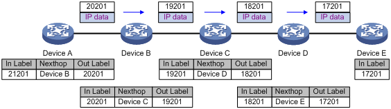

Prefix SID-based packet forwarding
Figure 1 shows how a packet is forwarded along the SRLSP from Device A to Device E based on prefix SIDs. In this example, the outgoing label for the packet is 21201 on Device A.
1.        Ingress node Device A searches for a forwarding entry for label 21201, adds outgoing label 20201 to the packet and sends the packet to the next hop (Device B).
2.        When transit node Device B receives the packet, it searches for a label forwarding entry that matches the label in the packet. Then, Device B uses the outgoing label of the matched entry (19201) to replace the label in the packet and forwards the packet to the next hop (Device C).
3.        Transit nodes Device C and Device D process the packet in the same way Device B does.
4.        When egress node Device E receives the packet, it removes the label and forwards the packet by IP address.
Figure 1 Prefix SID-based packet forwarding

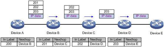

Adjacency SID-based packet forwarding
Figure 2 shows how a packet is forwarded along the SRLSP from Device A to Device E based on adjacency SIDs. In this example, the label stack for the packet is configured as (200, 201, 202, and 203) on Device A.
1.        Ingress node Device A searches for a forwarding entry for the top label (200) to determine the next hop. Then, Device A adds label stack (201, 202, and 203) to the packet, and forwards the packet to the next hop (Device B).
2.        When transit node Device B receives the packet, it searches for a forwarding entry for the top label (201) to determine the next hop. Then, Device B removes the top label from the stack and forwards the packet to the next hop (Device C).
3.        When transit node Device C receives the packet, it searches for a forwarding entry for the top label (202) to determine the next hop. Then, Device C removes the top label from the stack and forwards the packet to the next hop (Device D).
4.        When transit node Device D receives the packet, it searches for a forwarding entry for the label (203) to determine the next hop. Then, Device D removes the label stack from the packet and forwards the packet to the next hop (Device E).
5.        When egress node Device E receives the packet, it forwards the packet by IP address.
Figure 2 Adjacency SID-based packet forwarding

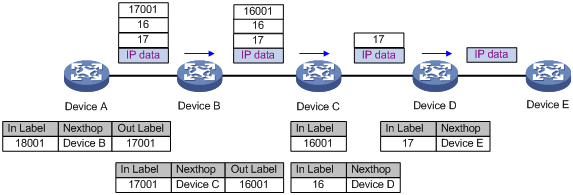

Prefix and adjacency SID-based packet forwarding
Figure 3 shows how a packet is forwarded along the SRLSP from Device A to Device E based on prefix SIDs and adjacency SIDs. In this example, the index value for the prefix SID of Device C is 1. The prefix SIDs for Device A, Device B, and Device C are 18001, 17001, and 16001, respectively. The Adjacency SIDs that Device C and Device D allocate for the adjacent links are 16 and 17, respectively. On Device A, the label stack for the packet is (18001, 16, 17).
1.        Ingress node Device A searches for a forwarding entry for label 18001 to determine the outgoing label (17001) and next hop (Device B). Device A swaps label 18001 with 17001. Then, it adds label stack (17001, 16, 17) to the packet and sends the packet to the next hop (Device B).
2.        When transit node Device B receives the packet, it searches for a label forwarding entry that matches the top label in the label stack (17001). Then, Device B uses the outgoing label of the matched entry (16001) to replace the top label and forwards the packet to the next hop (Device C).
3.        When transit node Device C receives the packet, it removes the top label 16001 and searches for a forwarding entry for the next label (16) to determine the next hop. Then, Device C removes label 16 from the stack and forwards the packet to the next hop (Device D).
4.        When transit node Device D receives the packet, it searches for a forwarding entry for the label (17) to determine the next hop. Then, Device D removes the label stack from the packet and forwards the packet to the next hop (Device E).
Figure 3 Prefix and adjacency SID-based packet forwarding

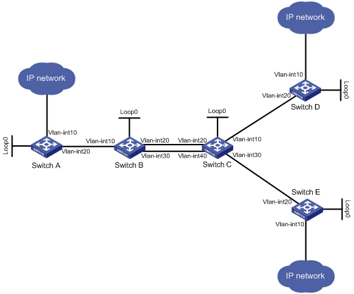

Example: Configuring MPLS SR based on static segments
As shown in Figure 4, Switch A, Switch B, Switch C, Switch D, and Switch E run IS-IS.
Establish an MPLS TE tunnel over a static SRLSP from Switch A to Switch D to transmit data between the two IP networks. The static SRLSP traverses three adjacency segments: Switch A—Switch B, Switch B—Switch C, and Switch C—Switch D.
Establish an MPLS TE tunnel over a static SRLSP from Switch A to Switch E to transmit data between the IP networks. The static SRLSP traverses three segments: Switch A—Switch B (adjacency segment), Switch B—Switch C (prefix segment), and Switch C—Switch E (adjacency segment).
Figure 4 Network diagram

1.        Configure IP addresses and masks for interfaces. (Details not shown.)
2.        Configure IS-IS to advertise interface addresses, including the loopback interface addresses. (Details not shown.)
3.        Execute the display ip routing-table command on each switch to verify that the switches have learned the routes to one another, including the routes to the loopback interfaces. (Details not shown.)
4.        Configure LSR IDs, and enable MPLS and MPLS TE:
# Configure Switch A.
<SwitchA> system-view
[SwitchA] mpls lsr-id 1.1.1.9
[SwitchA] mpls te
[SwitchA-te] quit
[SwitchA] interface vlan-interface 20
[SwitchA-Vlan-interface20] mpls enable
[SwitchA-Vlan-interface20] quit
# Configure Switch B.
<SwitchB> system-view
[SwitchB] mpls lsr-id 2.2.2.9
[SwitchB] mpls te
[SwitchB-te] quit
[SwitchB] interface vlan-interface 10
[SwitchB-Vlan-interface10] mpls enable
[SwitchB-Vlan-interface10] quit
[SwitchB] interface vlan-interface 20
[SwitchB-Vlan-interface20] mpls enable
[SwitchB-Vlan-interface20] quit
[SwitchB] interface vlan-interface 30
[SwitchB-Vlan-interface30] mpls enable
[SwitchB-Vlan-interface30] quit
# Configure Switch C.
<SwitchC> system-view
[SwitchC] mpls lsr-id 3.3.3.9
[SwitchC] mpls te
[SwitchC-te] quit
[SwitchC] interface vlan-interface 10
[SwitchC-Vlan-interface10] mpls enable
[SwitchC-Vlan-interface10] quit
[SwitchC] interface vlan-interface 20
[SwitchC-Vlan-interface20] mpls enable
[SwitchC-Vlan-interface20] quit
[SwitchC] interface vlan-interface 30
[SwitchC-Vlan-interface30] mpls enable
[SwitchC-Vlan-interface30] quit
[SwitchC] interface vlan-interface 40
[SwitchC-Vlan-interface40] mpls enable
[SwitchC-Vlan-interface40] quit
# Configure Switch D.
<SwitchD> system-view
[SwitchD] mpls lsr-id 4.4.4.9
[SwitchD] mpls te
[SwitchD-te] quit
[SwitchD] interface vlan-interface 20
[SwitchD-Vlan-interface20] mpls enable
[SwitchD-Vlan-interface20] quit
# Configure Switch E.
<SwitchE> system-view
[SwitchE] mpls lsr-id 5.5.5.9
[SwitchE] mpls te
[SwitchE-te] quit
[SwitchE] interface vlan-interface 20
[SwitchE-Vlan-interface20] mpls enable
[SwitchE-Vlan-interface20] quit
5.        Configure adjacency segment labels on each node:
# On Switch A, create adjacency segment adjacency-1, and bind incoming label 16 to the next hop address 10.1.1.2.
[SwitchA] static-sr-mpls adjacency adjacency-1 in-label 16 nexthop 10.1.1.2
# On Switch B, create adjacency segment adjacency-2, and bind incoming label 21 to next hop address 20.1.1.2.
[SwitchB] static-sr-mpls adjacency adjacency-2 in-label 21 nexthop 60.1.1.2
# On Switch B, create prefix segments prefix-1 to destination IP address 5.5.5.9. Bind incoming label 16000 to next hop addresses 20.1.1.2 and 60.1.1.2, and specify outgoing label 16001.
[SwitchB] static-sr-mpls prefix prefix-1 destination 5.5.5.9 32 in-label 16000 nexthop 20.1.1.2 out-label 16001
[SwitchB] static-sr-mpls prefix prefix-1 destination 5.5.5.9 32 in-label 16000 nexthop 60.1.1.2 out-label 16001
# On Switch C, create adjacency segment adjacency-1, and bind incoming label 30 to next hop address 30.1.1.2. Create adjacency segment adjacency-2, and bind incoming label 31 to next hop address 50.1.1.2.
[SwitchC] static-sr-mpls adjacency adjacency-1 in-label 30 nexthop 30.1.1.2
[SwitchC] static-sr-mpls adjacency adjacency-2 in-label 31 nexthop 50.1.1.2
# On Switch C, create prefix segment prefix-1 to destination IP address 5.5.5.9, and specify incoming label 16001.
[SwitchC] static-sr-mpls prefix prefix-1 destination 5.5.5.9 32 in-label 16001
6.        On Switch A, establish static SRLSP static-sr-lsp-1 to Switch D and static SRLSP static-sr-lsp-2 to Switch E:
# Configure Switch A as the ingress node of static SRLSP static-sr-lsp-1 and configure a label stack of [16, 21, 30].
[SwitchA] static-sr-mpls lsp static-sr-lsp-1 out-label 16 21 30
# Configure Switch A as the ingress node of static SRLSP static-sr-lsp-2 and configure a label stack of [16, 16000, 31].
[SwitchA] static-sr-mpls lsp static-sr-lsp-2 out-label 16 16000 31
7.        Configure MPLS TE tunnels over static SRLSPs on Switch A:
# Establish static MPLS TE tunnel 1 to Switch D and specify the LSR ID of Switch D as the tunnel destination address. Bind static SRLSP static-sr-lsp-1 to MPLS TE tunnel interface 1.
[SwitchA] interface tunnel 1 mode mpls-te
[SwitchA-Tunnel1 ip address 6.1.1.1 255.255.255.0
[SwitchA-Tunnel1] destination 4.4.4.9
[SwitchA-Tunnel1] mpls te signaling static
[SwitchA-Tunnel1] mpls te static-sr-mpls static-sr-lsp-1
[SwitchA-Tunnel1] quit
# Establish static MPLS TE tunnel 2 to Switch E and specify the LSR ID of Switch E as the tunnel destination address. Bind static SRLSP static-sr-lsp-2 to MPLS TE tunnel interface 2.
[SwitchA] interface tunnel 2 mode mpls-te
[SwitchA-Tunnel2] ip address 7.1.1.1 255.255.255.0
[SwitchA-Tunnel2] destination 5.5.5.9
[SwitchA-Tunnel2] mpls te signaling static
[SwitchA-Tunnel2] mpls te static-sr-mpls static-sr-lsp-2
[SwitchA-Tunnel2] quit
8.        On Switch A, configure two static routes to direct traffic destined for 100.1.2.0/24 and 200.1.2.0/24 to MPLS TE tunnel 1 and tunnel 2, respectively.
[SwitchA] ip route-static 100.1.2.0 24 tunnel 1 preference 1
[SwitchA] ip route-static 200.1.2.0 24 tunnel 2 preference 1
# Display the MPLS TE tunnel information on Switch A.
[SwitchA] display mpls te tunnel-interface
Tunnel Name            : Tunnel 1
Tunnel State           : Up (Main CRLSP up)
Tunnel Attributes      :
  LSP ID               : 1               Tunnel ID            : 0
  Admin State          : Normal
  Ingress LSR ID       : 1.1.1.9         Egress LSR ID        : 4.4.4.9
  Signaling            : Static          Static CRLSP Name    : -
  Static SRLSP Name    : static-sr-lsp-1/-
  Resv Style           : -
  Tunnel mode          : -
  Reverse-LSP name     : -
  Reverse-LSP LSR ID   : -               Reverse-LSP Tunnel ID: -
  Class Type           : -               Tunnel Bandwidth     : -
  Reserved Bandwidth   : -
  Setup Priority       : 0               Holding Priority     : 0
  Affinity Attr/Mask   : -/-
  Explicit Path        : -
  Backup Explicit Path : -
  Metric Type          : TE
  Record Route         : -               Record Label         : -
  FRR Flag             : -               Backup Bandwidth Flag: -
  Backup Bandwidth Flag: -               Backup Bandwidth Type: -
  Backup Bandwidth     : -
  Bypass Tunnel        : -               Auto Created         : -
  Route Pinning        : -
  Retry Limit          : 3               Retry Interval       : 2 sec
  Reoptimization       : -               Reoptimization Freq  : -
  Backup Type          : -               Backup LSP ID        : -
  Auto Bandwidth       : -               Auto Bandwidth Freq  : -
  Min Bandwidth        : -               Max Bandwidth        : -
  Collected Bandwidth  : -
Tunnel Name            : Tunnel 2
Tunnel Attributes      :
  LSP ID               : 1               Tunnel ID            : 1
  Ingress LSR ID       : 1.1.1.9         Egress LSR ID        : 5.5.5.9
  Static SRLSP Name    : static-sr-lsp-2/-
  Resv Style           : -
  Tunnel mode          : -
  Explicit Path        : -
  Metric Type          : TE
  FRR Flag             : -               Bandwidth Protection : -
  Route Pinning        : -
# Display static SRLSP establishment on each switch by using the display mpls lsp or display mpls static-sr-lsp command.
[SwitchA] display mpls lsp
FEC                         Proto       In/Out Label    Interface/Out NHLFE
1.1.1.9/0/46565             StaticCR    -/21            Vlan20
                                        30
1.1.1.9/1/46565             StaticCR    -/16000         Vlan20
                                        31
-                           StaticCR    16/-            Vlan20
10.1.1.2                    Local       -/-             Vlan20
Tunnel0                     Local       -/-             NHLFE1
Tunnel1                     Local       -/-             NHLFE2
[SwitchB] display mpls lsp
5.5.5.9/32                  StaticCR    16000/16001     Vlan20
5.5.5.9/32                  StaticCR    16000/16001     Vlan30
-                           StaticCR    21/-            Vlan20
20.1.1.2                    Local       -/-             Vlan20
60.1.1.2                    Local       -/-             Vlan30
[SwitchC] display mpls lsp
5.5.5.9/32                  StaticCR    16001/-         -
-                           StaticCR    30/-            Vlan10
-                           StaticCR    31/-            Vlan30
30.1.1.2                    Local       -/-             Vlan10
50.1.1.2                    Local       -/-             Vlan30
