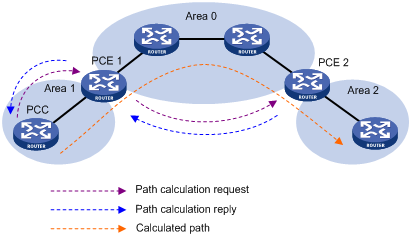

·          BRPC—Backward-Recursive PCE-Based Computation. BRPC path calculation is performed by multiple PCEs. It is applicable to inter-area path calculation.
As shown in Figure 1, PCE 1 is the ABR that can calculate paths in Area 0 and Area 1. PCE 2 is the ABR that can calculate paths in Area 1 and Area 2. The CRLSP that PCC uses to reach a destination in Area 2 is established as follows:
1.        PCC sends a path calculation request to PCE 1 to request the path to the CRLSP destination.
2.        PCE 1 forwards the request to PCE 2.
PCE 1 cannot calculate paths in Area 2, so it forwards the request to PCE 2, the PCE responsible for Area 2 that contains the CRLSP destination.
3.        After receiving the request from PCE 1, PCE 2 calculates potential paths to the CRLSP destination and sends the path information back to PCE 1 in a reply.
4.        PCE 1 uses the local and received path information to select an end-to-end path for the PCC to reach the CRLSP destination, and sends the path to PCC as a reply.
5.        PCC uses the path calculated by PCEs to establish the CRLSP through RSVP-TE.
Figure 1 BRPC path calculation

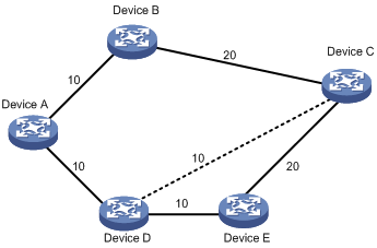

As shown in Figure 2, an MPLS TE tunnel exists from Device D to Device C. IGP shortcut enables only the ingress node Device D to use the MPLS TE tunnel in the IGP route calculation. Device A cannot use this tunnel to reach Device C. With forwarding adjacency enabled, Device A can learn this MPLS TE tunnel and transfer traffic to Device C by forwarding the traffic to Device D.
Figure 2 IGP shortcut and forwarding adjacency diagram

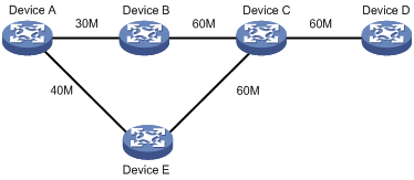

As shown in Figure 3, a CRLSP with 30 M reserved bandwidth has been set up from Device A to Device D through the path Device A—Device B—Device C—Device D.
To increase the reserved bandwidth to 40 M, a new CRLSP must be set up through the path Device A—Device E—Device C—Device D. To achieve this purpose, RSVP-TE needs to reserve 30 M bandwidth for the old CRLSP and 40 M bandwidth for the new CRLSP on the link Device C—Device D. However, there is not enough bandwidth.
After the make-before-break mechanism is used, the new CRLSP can share the bandwidth reserved for the old CRLSP. After the new CRLSP is set up, traffic is switched to the new CRLSP without service interruption, and then the old CRLSP is removed.
Figure 3 Diagram for make-before-break

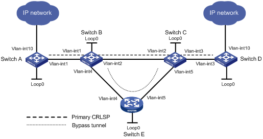

FRR
Fast reroute (FRR) protects CRLSPs from link and node failures. FRR can implement 50-millisecond CRLSP failover.
After FRR is enabled for an MPLS TE tunnel, once a link or node fails on the primary CRLSP, FRR reroutes the traffic to a bypass tunnel. The ingress node attempts to set up a new CRLSP. After the new CRLSP is set up, traffic is forwarded on the new CRLSP.
CRLSP backup provides end-to-end path protection for a CRLSP without time limitation. FRR provides quick but temporary protection for a link or node on a CRLSP.

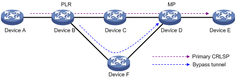

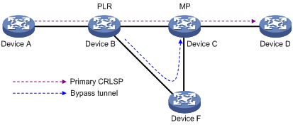

Basic concepts
·          Primary CRLSP—Protected CRLSP.
·          Bypass tunnel—An MPLS TE tunnel used to protect a link or node of the primary CRLSP.
·          Point of local repair—A PLR is the ingress node of the bypass tunnel. It must be located on the primary CRLSP but must not be the egress node of the primary CRLSP.
·          Merge point—An MP is the egress node of the bypass tunnel. It must be located on the primary CRLSP but must not be the ingress node of the primary CRLSP.
Protection modes
FRR provides the following protection modes:
·          Link protection—The PLR and the MP are connected through a direct link and the primary CRLSP traverses this link. When the link fails, traffic is switched to the bypass tunnel. As shown in Figure 4, the primary CRLSP is Device A—Device B—Device C—Device D, and the bypass tunnel is Device B—Device F—Device C. This mode is also called next-hop (NHOP) protection.
Figure 4 FRR link protection
·          Node protection—The PLR and the MP are connected through a device and the primary CRLSP traverses this device. When the device fails, traffic is switched to the bypass tunnel. As shown in Figure 5, the primary CRLSP is Device A—Device B—Device C—Device D—Device E, and the bypass tunnel is Device B—Device F—Device D. Device C is the protected device. This mode is also called next-next-hop (NNHOP) protection.
Figure 5 FRR node protection

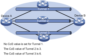

CBTS
About CBTS
Class Based Tunnel Selection (CBTS) enables dynamic routing and forwarding of traffic with different service class values over different MPLS TE tunnels between the same tunnel headend and tailend. Unlike load sharing that selects multiple tunnels to forward the matching traffic, CBTS uses a dedicated tunnel for a certain service class.
How CBTS works
CBTS processes incoming traffic on the device as follows:
1.        Uses a traffic behavior to set a service class value for the traffic. For more information about traffic behaviors, see QoS configuration in ACL and QoS Configuration Guide.
2.        Compares the service class value of the traffic with the service class values of the MPLS TE tunnels and forwards the traffic to a matching tunnel.
MPLS TE tunnel selection rules
CBTS uses the following rules to select an MPLS TE tunnel for the incoming traffic:
·          If the traffic matches an MPLS TE tunnel, CBTS uses this tunnel.
·          If the traffic matches multiple MPLS TE tunnels, CBTS randomly selects a matching tunnel.
·          If the traffic does not match any MPLS TE tunnels, CBTS randomly selects a tunnel from all tunnels with the lowest priority.
The smaller the service class value, the lower the tunnel priority. An MPLS TE tunnel that is not configured with a service class value has the lowest priority.
CBTS application scenario
As shown in Figure 8, CBTS selects MPLS TE tunnels for the incoming traffic as follows:
·          Uses Tunnel 2 to forward traffic with service class value 3.
·          Uses Tunnel 3 to forward traffic with service class value 6.
·          Uses Tunnel 1 to forward traffic with no service class value.
Figure 8 CBTS application scenario

Configuring the metric type for path selection
About metric types
Each MPLS TE link has two metrics: IGP metric and TE metric. By planning the two metrics, you can select different tunnels for different classes of traffic. For example, use the IGP metric to represent a link delay (a smaller IGP metric value indicates a lower link delay), and use the TE metric to represent a link bandwidth value (a smaller TE metric value indicates a bigger link bandwidth value).
You can establish two MPLS TE tunnels: Tunnel 1 for voice traffic and Tunnel 2 for video traffic. Configure Tunnel 1 to use IGP metrics for path selection, and configure Tunnel 2 to use TE metrics for path selection. As a result, the video service (with larger traffic) travels through the path that has larger bandwidth, and the voice traffic travels through the path that has lower delay.
The metric type can be explicitly specified for path selection of a tunnel or globally specified. To specify a global metric type, perform the task on the ingress node of the tunnels. To specify a metric type for a tunnel, perform the task on the tunnel interface. The metric type for a tunnel takes precedence over the global setting.

Configuring an MPLS TE tunnel to use a CRLSP calculated by PCEs
Configuring a PCE
About PCE configuration
An LSR acts as a PCC if no PCE IP address is specified for it. It uses its LSR ID to communicate with PCEs. To configure the LSR as a PCE, perform this task.
1.        Enter system view.
2.        Enter MPLS TE view.
mpls te
3.        Configure a PCE IP address.
pce address ip-address
By default, no PCE address is configured.
Discovering PCEs
About PCE discovery
A PCE can be manually specified on a PCC by using the pce static command or automatically discovered through the PCE information advertised by OSPF TE. A PCC sends PCEP connection requests to discovered PCEs but does not accept requests from the PCEs.
Manually specifying a PCE
mpls te
3.        Specify the IP address of the PCE.
pce static ip-address
Dynamically discovering PCEs
OSPF TE advertises PCE IP addresses for PCCs and other PCEs to dynamically discover the PCEs and establish PCEP sessions to them. For OSPF TE configuration, see "Configuring OSPF TE."
Establishing a CRLSP by using the path calculated by PCEs
About establishing a CRLSP by using the path calculated by PCEs
If you configure the mpls te path command for an LSR, it uses the path calculated by PCEs to establish a CRLSP. The LSR acts as a PCC.
If you specify PCE addresses by using the mpls te path or mpls te backup-path command, the LSR establishes PCEP sessions to the specified PCEs. If you do not specify any PCE addresses, the LSR establishes PCEP sessions to all discovered PCEs.
2.        Enter MPLS TE tunnel interface view.
interface tunnel tunnel-number [ mode mpls-te ]
3.        Establish a CRLSP by using the path calculated by PCEs.
mpls te path preference value dynamic  pce [ ip-address ]&<0-8>
By default, the automatically calculated path is used to establish a CRLSP.

Configuring MPLS TE FRR
Restrictions and guidelines for MPLS TE FRR
MPLS TE FRR provides temporary link or node protection on a CRLSP. When you configure FRR, follow these restrictions and guidelines:
·          Do not configure both FRR and RSVP authentication on the same interface.
·          Only MPLS TE tunnels established through RSVP-TE support FRR.
·          If both the MPLS TE FRR and bidirectional MPLS TE tunnel features are configured, only the bidirectional MPLS TE tunnel feature takes effect.
Enabling FRR
2.        Enter tunnel interface view of the primary CRLSP.
3.        Enable FRR.
mpls te fast-reroute
By default, FRR is disabled.
Configuring a bypass tunnel on the PLR
About bypass tunnels on the PLR
To configure FRR, you must configure bypass tunnels for primary CRLSPs on the PLR by using the following methods:
·          Manually configuring a bypass tunnel on the PLR—Create an MPLS TE tunnel on the PLR, and configure the tunnel as a bypass tunnel for a primary CRLSP. You need to bind the bypass tunnel to the output interface of the primary CRLSP.
You can configure a maximum of three bypass tunnels for a primary CRLSP.
·          Configuring the PLR to set up bypass tunnels automatically—Configure the automatic bypass tunnel setup feature (also referred to as the auto FRR feature) on the PLR. The PLR automatically sets up two bypass tunnels for each of its primary CRLSPs: One in link protection mode and the other in node protection mode. An automatically created bypass tunnel can protect multiple primary CRLSPs.
A primary tunnel can have both manually configured and automatically created bypass tunnels. The PLR will select one bypass tunnel to protect the primary CRLSP. The selected bypass tunnel is bound to the primary CRLSP.
Manually created bypass tunnels take precedence over automatically created bypass tunnels. An automatically created bypass tunnel in node protection mode takes precedence over an automatically created bypass tunnel in link protection mode. Among manually created bypass tunnels, the PLR selects the bypass tunnel for protecting the primary CRLSP by following these rules:
1.        Selects a bypass tunnel according to the bandwidth required by the primary CRLSP.
2.        Prefers the bypass tunnel in node protection mode over the one in link protection mode.
3.        Prefers the bypass tunnel with a smaller ID over the one with a bigger tunnel ID.
The device does not support specifying the CT and bandwidth to be protected by a bypass tunnel. A bypass tunnel protects all CTs without a bandwidth limit.
When you configure a bypass tunnel, follow these principles to protect and assign bandwidth:
·          Use bypass tunnels to protect only critical interfaces or links when bandwidth is insufficient. Bypass tunnels are pre-established and require extra bandwidth.
·          Make sure the bandwidth assigned to the bypass tunnel is no less than the total bandwidth needed by all primary CRLSPs to be protected by the bypass tunnel. Otherwise, some primary CRLSPs might not be protected by the bypass tunnel.
·          A bypass tunnel typically does not forward data when the primary CRLSP operates correctly. For a bypass tunnel to also forward data during tunnel protection, you must assign adequate bandwidth to the bypass tunnel.
A bypass tunnel has the following restrictions:
·          The bypass tunnel cannot be used for services such as VPN.
·          FRR cannot be configured for the bypass tunnel. A bypass tunnel cannot act as a primary CRLSP.
·          The bypass tunnel must not traverse the protected node or interface.
When you configure the PLR to automatically set up a bypass tunnel, follow these restrictions and guidelines:
·          Interfaces automatically generated by the device (such as VA interfaces) support only auto FRR protection.
·          If the PLR is the penultimate node of a primary CRLSP, the PLR does not create a node-protection bypass tunnel for the primary CRLSP.
2.        Create a bypass tunnel.
The bypass tunnel setup method is the same as a normal MPLS TE tunnel. For more information, see "Establishing a static CRLSP", "Establishing a CRLSP dynamically", and "Establishing a CRLSP by using the path calculated by PCEs."
3.        Enter tunnel interface view of the bypass tunnel.
4.        Specify the destination address of the bypass tunnel.
destination ip-address
The bypass tunnel destination address is the LSR ID of the MP.
5.        Configure the bypass tunnel to protect all CTs without a bandwidth limit.
mpls te backup bandwidth un-limited
By default, the bandwidth and the CT to be protected by the bypass tunnel are not specified.
To successfully associate a primary CRLSP with a bypass tunnel, you must execute this command for the bypass tunnel.
6.        Return to system view.
7.        Enter interface view of the output interface of a primary CRLSP.
8.        Specify a bypass tunnel for the protected interface.
mpls te fast-reroute bypass-tunnel tunnel tunnel-number
By default, no bypass tunnel is specified for an interface.

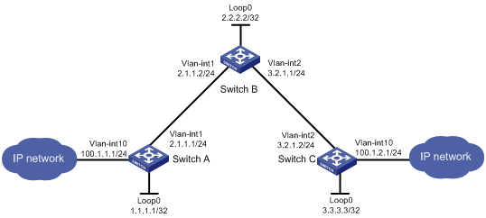

Example: Establishing an MPLS TE tunnel over a static CRLSP
Switch A, Switch B, and Switch C run IS-IS.
Establish an MPLS TE tunnel over a static CRLSP from Switch A to Switch C to transmit data between the two IP networks.
The MPLS TE tunnel requires a bandwidth of 2000 kbps. The maximum bandwidth of the link that the tunnel traverses is 10000 kbps. The maximum reservable bandwidth of the link is 5000 kbps.
Figure 9 Network diagram
1.        Configure IP addresses and masks for interfaces. (Details not shown.)
2.        Configure IS-IS to advertise interface addresses, including the loopback interface address:
# Configure Switch A.
<SwitchA> system-view
[SwitchA] isis 1
[SwitchA-isis-1] network-entity 00.0005.0000.0000.0001.00
[SwitchA-isis-1] quit
[SwitchA] interface vlan-interface 1
[SwitchA-Vlan-interface1] isis enable 1
[SwitchA-Vlan-interface1] quit
[SwitchA] interface loopback 0
[SwitchA-LoopBack0] isis enable 1
[SwitchA-LoopBack0] quit
# Configure Switch B.
<SwitchB> system-view
[SwitchB] isis 1
[SwitchB-isis-1] network-entity 00.0005.0000.0000.0002.00
[SwitchB-isis-1] quit
[SwitchB] interface vlan-interface 1
[SwitchB-Vlan-interface1] isis enable 1
[SwitchB-Vlan-interface1] quit
[SwitchB-Vlan-interface2] isis enable 1
[SwitchB-Vlan-interface2] quit
[SwitchB] interface loopback 0
[SwitchB-LoopBack0] isis enable 1
[SwitchB-LoopBack0] quit
# Configure Switch C.
<SwitchC> system-view
[SwitchC] isis 1
[SwitchC-isis-1] network-entity 00.0005.0000.0000.0003.00
[SwitchC-isis-1] quit
[SwitchC] interface vlan-interface 2
[SwitchC-Vlan-interface2] isis enable 1
[SwitchC-Vlan-interface2] quit
[SwitchC] interface loopback 0
[SwitchC-LoopBack0] isis enable 1
[SwitchC-LoopBack0] quit
# Execute the display ip routing-table command on each switch to verify that the switches have learned the routes to one another, including the routes to the loopback interfaces. (Details not shown.)
3.        Configure an LSR ID, and enable MPLS and MPLS TE:
[SwitchA] mpls lsr-id 1.1.1.1
[SwitchA] mpls te
[SwitchA-te] quit
[SwitchA-Vlan-interface1] mpls enable
[SwitchA-Vlan-interface1] mpls te enable
[SwitchB] mpls lsr-id 2.2.2.2
[SwitchB] mpls te
[SwitchB-te] quit
[SwitchB-Vlan-interface1] mpls enable
[SwitchB-Vlan-interface1] mpls te enable
[SwitchB-Vlan-interface2] mpls enable
[SwitchB-Vlan-interface2] mpls te enable
[SwitchC] mpls lsr-id 3.3.3.3
[SwitchC] mpls te
[SwitchC-te] quit
[SwitchC-Vlan-interface2] mpls enable
[SwitchC-Vlan-interface2] mpls te enable
4.        Configure MPLS TE attributes of links:
# Set the maximum link bandwidth and maximum reservable bandwidth on Switch A.
[SwitchA-Vlan-interface1] mpls te max-link-bandwidth 10000
[SwitchA-Vlan-interface1] mpls te max-reservable-bandwidth 5000
# Set the maximum link bandwidth and maximum reservable bandwidth on Switch B.
[SwitchB-Vlan-interface1] mpls te max-link-bandwidth 10000
[SwitchB-Vlan-interface1] mpls te max-reservable-bandwidth 5000
[SwitchB-Vlan-interface2] mpls te max-link-bandwidth 10000
[SwitchB-Vlan-interface2] mpls te max-reservable-bandwidth 5000
# Set the maximum link bandwidth and maximum reservable bandwidth on Switch C.
[SwitchC-Vlan-interface2] mpls te max-link-bandwidth 10000
[SwitchC-Vlan-interface2] mpls te max-reservable-bandwidth 5000
5.        Configure an MPLS TE tunnel on Switch A:
# Configure MPLS TE tunnel interface Tunnel 1.
[SwitchA] interface tunnel 1 mode mpls-te
[SwitchA-Tunnel1] ip address 6.1.1.1 255.255.255.0
# Specify the tunnel destination address as the LSR ID of Switch C.
[SwitchA-Tunnel1] destination 3.3.3.3
# Configure MPLS TE to use a static CRLSP to establish the tunnel.
[SwitchA-Tunnel1] mpls te signaling static
[SwitchA-Tunnel1] quit
6.        Create a static CRLSP:
# Configure Switch A as the ingress node of the static CRLSP, and specify the next hop address as 2.1.1.2, outgoing label as 20, and bandwidth for the tunnel as 2000 kbps.
[SwitchA] static-cr-lsp ingress static-cr-lsp-1 nexthop 2.1.1.2 out-label 20 bandwidth 2000
# On Switch A, configure tunnel 1 to use static CRLSP static-cr-lsp-1.
[SwitchA] interface Tunnel1
[SwitchA-Tunnel1] mpls te static-cr-lsp static-cr-lsp-1
# Configure Switch B as the transit node of the static CRLSP, and specify the incoming label as 20, next hop address as 3.2.1.2, outgoing label as 30, and bandwidth for the tunnel as 2000 kbps.
[SwitchB] static-cr-lsp transit static-cr-lsp-1 in-label 20 nexthop 3.2.1.2 out-label 30 bandwidth 2000
# Configure Switch C as the egress node of the static CRLSP, and specify the incoming label as 30.
[SwitchC] static-cr-lsp egress static-cr-lsp-1 in-label 30
7.        Configure a static route on Switch A to direct traffic destined for subnet 100.1.2.0/24 to MPLS TE tunnel 1.
[SwitchA] ip route-static 100.1.2.0 24 tunnel 1 preference 1

  Admin State          : Normal
  Ingress LSR ID       : 1.1.1.1         Egress LSR ID        : 3.3.3.3
  Signaling            : Static          Static CRLSP Name    : static-cr-lsp-1
  Static SRLSP Name    : -
  Resv Style           : -
  Tunnel mode          : -
  Reverse-LSP name     : -
  Reverse-LSP LSR ID   : -               Reverse-LSP Tunnel ID: -
  Class Type           : -               Tunnel Bandwidth     : -
  Reserved Bandwidth   : -
  Setup Priority       : 0               Holding Priority     : 0
  Affinity Attr/Mask   : -/-
  Explicit Path        : -
  Backup Explicit Path : -
  Metric Type          : TE
  Record Route         : -               Record Label         : -
  FRR Flag             : -               Bandwidth Protection : -
  Backup Bandwidth Flag: -               Backup Bandwidth Type: -
  Backup Bandwidth     : -
  Bypass Tunnel        : -               Auto Created         : -
  Route Pinning        : -
  Retry Limit          : 3               Retry Interval       : 2 sec
  Reoptimization       : -               Reoptimization Freq  : -
  Backup Type          : -               Backup LSP ID        : -
  Auto Bandwidth       : -               Auto Bandwidth Freq  : -
  Min Bandwidth        : -               Max Bandwidth        : -
  Collected Bandwidth  : -               Service-Class        : -
# Display static CRLSP information on each switch.
[SwitchA] display mpls lsp
FEC                         Proto    In/Out Label    Interface/Out NHLFE
1.1.1.1/0/1                 StaticCR -/20            Vlan1
2.1.1.2                     Local    -/-             Vlan1
Tunnel1                     Local    -/-             NHLFE1025
[SwitchB] display mpls lsp
-                           StaticCR 20/30           Vlan2
3.2.1.2                     Local    -/-             Vlan2
[SwitchC] display mpls lsp
-                           StaticCR 30/-            -
[SwitchA] display mpls static-cr-lsp
Name            LSR Type    In/Out Label   Out Interface        State
static-cr-lsp-1 Ingress     Null/20        Vlan1                Up
[SwitchB] display mpls static-cr-lsp
static-cr-lsp-1 Transit     20/30          Vlan2                Up
[SwitchC] display mpls static-cr-lsp
static-cr-lsp1  Egress      30/Null        -                    Up
# Execute the display ip routing-table command on Switch A. The output shows a static route entry with interface Tunnel 1 as the output interface. (Details not shown.)

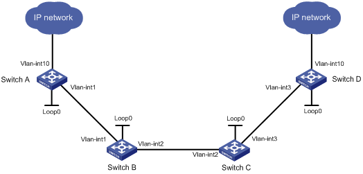

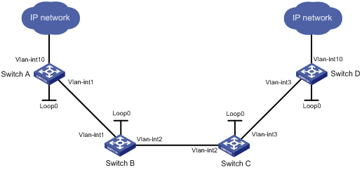

Example: Establishing an MPLS TE tunnel with RSVP-TE
Switch A, Switch B, Switch C, and Switch D run IS-IS and all of them are Level-2 switches.
Use RSVP-TE to establish an MPLS TE tunnel from Switch A to Switch D to transmit data between the two IP networks. The MPLS TE tunnel requires a bandwidth of 2000 kbps.
The maximum bandwidth of the link that the tunnel traverses is 10000 kbps and the maximum reservable bandwidth of the link is 5000 kbps.
Figure 10 Network diagram
Device
Interface
IP address
Device
Interface
IP address
Switch A
Loop0
1.1.1.9/32
Switch D
Loop0
4.4.4.9/32
Vlan-int1
10.1.1.1/24
Vlan-int3
30.1.1.2/24
Vlan-int10
100.1.1.1/24
Vlan-int10
100.1.2.1/24
Switch B
Loop0
2.2.2.9/32
Switch C
Loop0
3.3.3.9/32
Vlan-int1
10.1.1.2/24
Vlan-int3
30.1.1.1/24
Vlan-int2
20.1.1.1/24
Vlan-int2
20.1.1.2/24
[SwitchA] isis 1
[SwitchA-Vlan-interface1] isis circuit-level level-2
[SwitchA-LoopBack0] isis circuit-level level-2
[SwitchB] isis 1
[SwitchB-Vlan-interface1] isis circuit-level level-2
[SwitchB-Vlan-interface2] isis circuit-level level-2
[SwitchB-LoopBack0] isis circuit-level level-2
[SwitchC] isis 1
[SwitchC] interface vlan-interface 3
[SwitchC-Vlan-interface3] isis enable 1
[SwitchC-Vlan-interface3] isis circuit-level level-2
[SwitchC-Vlan-interface3] quit
[SwitchC-Vlan-interface2] isis circuit-level level-2
[SwitchC-LoopBack0] isis circuit-level level-2
# Configure Switch D.
<SwitchD> system-view
[SwitchD] isis 1
[SwitchD-isis-1] network-entity 00.0005.0000.0000.0004.00
[SwitchD-isis-1] quit
[SwitchD] interface vlan-interface 3
[SwitchD-Vlan-interface3] isis enable 1
[SwitchD-Vlan-interface3] isis circuit-level level-2
[SwitchD-Vlan-interface3] quit
[SwitchD] interface loopback 0
[SwitchD-LoopBack0] isis enable 1
[SwitchD-LoopBack0] isis circuit-level level-2
[SwitchD-LoopBack0] quit
3.        Configure an LSR ID, and enable MPLS, MPLS TE, and RSVP-TE:
[SwitchA] mpls lsr-id 1.1.1.9
[SwitchA] mpls te
[SwitchA-te] quit
[SwitchA] rsvp
[SwitchA-rsvp] quit
[SwitchA-Vlan-interface1] rsvp enable
[SwitchB] mpls lsr-id 2.2.2.9
[SwitchB] mpls te
[SwitchB-te] quit
[SwitchB] rsvp
[SwitchB-rsvp] quit
[SwitchB-Vlan-interface1] rsvp enable
[SwitchB-Vlan-interface2] rsvp enable
[SwitchC] mpls lsr-id 3.3.3.9
[SwitchC] mpls te
[SwitchC-te] quit
[SwitchC] rsvp
[SwitchC-rsvp] quit
[SwitchC-Vlan-interface3] mpls enable
[SwitchC-Vlan-interface3] mpls te enable
[SwitchC-Vlan-interface3] rsvp enable
[SwitchC-Vlan-interface2] rsvp enable
[SwitchD] mpls lsr-id 4.4.4.9
[SwitchD] mpls te
[SwitchD-te] quit
[SwitchD] rsvp
[SwitchD-rsvp] quit
[SwitchD-Vlan-interface3] mpls enable
[SwitchD-Vlan-interface3] mpls te enable
[SwitchD-Vlan-interface3] rsvp enable
4.        Configure IS-IS TE:
[SwitchA] isis 1
[SwitchA-isis-1] cost-style wide
[SwitchA-isis-1] mpls te enable level-2
[SwitchB] isis 1
[SwitchB-isis-1] cost-style wide
[SwitchB-isis-1] mpls te enable level-2
[SwitchC] isis 1
[SwitchC-isis-1] cost-style wide
[SwitchC-isis-1] mpls te enable level-2
[SwitchD] isis 1
[SwitchD-isis-1] cost-style wide
[SwitchD-isis-1] mpls te enable level-2
5.        Configure MPLS TE attributes of links:
[SwitchC-Vlan-interface3] mpls te max-link-bandwidth 10000
[SwitchC-Vlan-interface3] mpls te max-reservable-bandwidth 5000
# Set the maximum link bandwidth and maximum reservable bandwidth on Switch D.
[SwitchD-Vlan-interface3] mpls te max-link-bandwidth 10000
[SwitchD-Vlan-interface3] mpls te max-reservable-bandwidth 5000
6.        Configure an MPLS TE tunnel on Switch A:
[SwitchA-Tunnel1] ip address 7.1.1.1 255.255.255.0
# Specify the tunnel destination address as the LSR ID of Switch D.
[SwitchA-Tunnel1] destination 4.4.4.9
# Configure MPLS TE to use RSVP-TE to establish the tunnel.
[SwitchA-Tunnel1] mpls te signaling rsvp-te
# Assign 2000 kbps bandwidth to the tunnel.
[SwitchA-Tunnel1] mpls te bandwidth 2000
7.        Configure a static route on Switch A to direct the traffic destined for subnet 100.1.2.0/24 to MPLS TE tunnel 1.
# Verify that the tunnel interface is up on Switch A.
[SwitchA] display interface tunnel
Tunnel1
Current state: UP
Line protocol state: UP
Description: Tunnel1 Interface
Bandwidth: 64kbps
Maximum transmission unit: 1496
Internet address: 7.1.1.1/24 (primary)
Tunnel source unknown, destination 4.4.4.9
Tunnel TTL 255
Tunnel protocol/transport CR_LSP
Last clearing of counters: Never
Last 300 seconds input rate: 0 bytes/sec, 0 bits/sec, 0 packets/sec
Last 300 seconds output rate: 6 bytes/sec, 48 bits/sec, 0 packets/sec
Input: 0 packets, 0 bytes, 0 drops
Output: 177 packets, 11428 bytes, 0 drops
# Display detailed information about the MPLS TE tunnel on Switch A.
[SwitchA] display mpls te tunnel-interface
Tunnel Name            : Tunnel 1
Tunnel State           : Up (Main CRLSP up. Shared-resource CRLSP down)
Tunnel Attributes      :
  LSP ID               : 23331           Tunnel ID            : 1
  Ingress LSR ID       : 1.1.1.9         Egress LSR ID        : 4.4.4.9
  Signaling            : RSVP-TE         Static CRLSP Name    : -
  Resv Style           : SE
  Tunnel mode          : -
  Class Type           : CT0             Tunnel Bandwidth     : 2000 kbps
  Reserved Bandwidth   : 2000 kbps
  Setup Priority       : 7               Holding Priority     : 7
  Affinity Attr/Mask   : 0/0
  Explicit Path        : -
  Metric Type          : TE
  Record Route         : Disabled        Record Label         : Disabled
  FRR Flag             : Disabled        Bandwidth Protection : Disabled
  Backup Bandwidth Flag: Disabled        Backup Bandwidth Type: -
  Bypass Tunnel        : No               Auto Created         : No
  Route Pinning        : Disabled
  Retry Limit          : 10              Retry Interval       : 2 sec
  Reoptimization       : Disabled        Reoptimization Freq  : -
  Backup Type          : None            Backup LSP ID        : -
  Auto Bandwidth       : Disabled        Auto Bandwidth Freq  : -

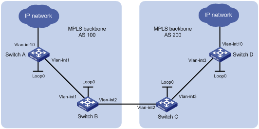

Example: Establishing an inter-AS MPLS TE tunnel with RSVP-TE
Switch A and Switch B are in AS 100. Switch C and Switch D are in AS 200. AS 100 and AS 200 use OSPF as the IGP.
Establish an EBGP connection between ASBRs Switch B and Switch C. Redistribute BGP routes into OSPF and OSPF routes into BGP, so that a route is available between AS 100 and AS 200.
Use RSVP-TE to establish an MPLS TE tunnel from Switch A to Switch D to transmit data between the two IP networks. The tunnel requires a bandwidth of 2000 kbps. The maximum bandwidth of the link that the tunnel traverses is 10000 kbps and the maximum reservable bandwidth of the link is 5000 kbps.
Figure 11 Network diagram
Table 3 Interface and IP address assignment
Device
Interface
IP address
Device
Interface
IP address
Switch A
Loop0
1.1.1.9/32
Switch D
Loop0
4.4.4.9/32
Vlan-int1
10.1.1.1/24
Vlan-int3
30.1.1.2/24
Vlan-int10
100.1.1.1/24
Vlan-int10
100.1.2.1/24
Switch B
Loop0
2.2.2.9/32
Switch C
Loop0
3.3.3.9/32
Vlan-int1
10.1.1.2/24
Vlan-int3
30.1.1.1/24
Vlan-int2
20.1.1.1/24
Vlan-int2
20.1.1.2/24
2.        Configure OSPF to advertise routes within the ASs, and redistribute the direct and BGP routes into OSPF on Switch B and Switch C:
[SwitchA] ospf
[SwitchA-ospf-1] area 0
[SwitchA-ospf-1-area-0.0.0.0] network 10.1.1.0 0.0.0.255
[SwitchA-ospf-1-area-0.0.0.0] network 1.1.1.9 0.0.0.0
[SwitchA-ospf-1-area-0.0.0.0] quit
[SwitchA-ospf-1] quit
[SwitchB] ospf
[SwitchB-ospf-1] import-route direct
[SwitchB-ospf-1] import-route bgp
[SwitchB-ospf-1] area 0
[SwitchB-ospf-1-area-0.0.0.0] network 10.1.1.0 0.0.0.255
[SwitchB-ospf-1-area-0.0.0.0] network 2.2.2.9 0.0.0.0
[SwitchB-ospf-1-area-0.0.0.0] quit
[SwitchB-ospf-1] quit
[SwitchC] ospf
[SwitchC-ospf-1] import-route direct
[SwitchC-ospf-1] import-route bgp
[SwitchC-ospf-1] area 0
[SwitchC-ospf-1-area-0.0.0.0] network 30.1.1.0 0.0.0.255
[SwitchC-ospf-1-area-0.0.0.0] network 3.3.3.9 0.0.0.0
[SwitchC-ospf-1-area-0.0.0.0] quit
[SwitchC-ospf-1] quit
[SwitchD] ospf
[SwitchD-ospf-1] area 0
[SwitchD-ospf-1-area-0.0.0.0] network 30.1.1.0 0.0.0.255
[SwitchD-ospf-1-area-0.0.0.0] network 4.4.4.9 0.0.0.0
[SwitchD-ospf-1-area-0.0.0.0] quit
[SwitchD-ospf-1] quit
# Verify that the switches have learned the routes to one another, including the routes to the loopback interfaces. This example uses Switch A.
[SwitchA] display ip routing-table
Destinations : 6        Routes : 6
Destination/Mask   Proto   Pre Cost        NextHop         Interface
1.1.1.9/32         Direct  0   0           127.0.0.1       InLoop0
2.2.2.9/32         O_INTRA 10  1           10.1.1.2        Vlan1
10.1.1.0/24        Direct  0   0           10.1.1.1        Vlan1
10.1.1.1/32        Direct  0   0           127.0.0.1       InLoop0
127.0.0.0/8        Direct  0   0           127.0.0.1       InLoop0
127.0.0.1/32       Direct  0   0           127.0.0.1       InLoop0
3.        Configure BGP on Switch B and Switch C to ensure that the ASs can communicate with each other:
[SwitchB] bgp 100
[SwitchB-bgp] peer 20.1.1.2 as-number 200
[SwitchB-bgp] address-family ipv4 unicast
[SwitchB-bgp-ipv4] peer 20.1.1.2 enable
[SwitchB-bgp-ipv4] import-route ospf
[SwitchB-bgp-ipv4] import-route direct
[SwitchB-bgp-ipv4] quit
[SwitchB-bgp] quit
[SwitchC] bgp 200
[SwitchC-bgp] peer 20.1.1.1 as-number 100
[SwitchC-bgp] address-family ipv4 unicast
[SwitchC-bgp-ipv4] peer 20.1.1.1 enable
[SwitchC-bgp-ipv4] import-route ospf
[SwitchC-bgp-ipv4] import-route direct
[SwitchC-bgp-ipv4] quit
[SwitchC-bgp] quit
# Verify that the switches have learned AS-external routes.
Destinations : 10       Routes : 10
3.3.3.9/32         O_ASE   150 1           10.1.1.2        Vlan1
4.4.4.9/32         O_ASE   150 1           10.1.1.2        Vlan1
20.1.1.0/24        O_ASE   150 1           10.1.1.2        Vlan1
30.1.1.0/24        O_ASE   150 1           10.1.1.2        Vlan1
4.        Configure an LSR ID, and enable MPLS, MPLS TE, and RSVP-TE:
[SwitchA] mpls te
[SwitchA-te] quit
[SwitchA] rsvp
[SwitchA-rsvp] quit
[SwitchB] mpls te
[SwitchB-te] quit
[SwitchB] rsvp
[SwitchB-rsvp] quit
[SwitchC] mpls te
[SwitchC-te] quit
[SwitchC] rsvp
[SwitchC-rsvp] quit
[SwitchD] mpls te
[SwitchD-te] quit
[SwitchD] rsvp
[SwitchD-rsvp] quit
5.        Configure OSPF TE:
[SwitchA] ospf
[SwitchA-ospf-1] opaque-capability enable
[SwitchA-ospf-1-area-0.0.0.0] mpls te enable
[SwitchB] ospf
[SwitchB-ospf-1] opaque-capability enable
[SwitchB-ospf-1-area-0.0.0.0] mpls te enable
[SwitchC] ospf
[SwitchC-ospf-1] opaque-capability enable
[SwitchC-ospf-1-area-0.0.0.0] mpls te enable
[SwitchD] ospf
[SwitchD-ospf-1] opaque-capability enable
[SwitchD-ospf-1-area-0.0.0.0] mpls te enable
6.        Configure an explicit path on Switch A. Specify Switch B and Switch D as loose nodes, and Switch C as a strict node.
[SwitchA] explicit-path atod
[SwitchA-explicit-path-atod] nexthop 10.1.1.2 include loose
[SwitchA-explicit-path-atod] nexthop 20.1.1.2 include strict
[SwitchA-explicit-path-atod] nexthop 30.1.1.2 include loose
[SwitchA-explicit-path-atod] quit
7.        Configure MPLS TE attributes of links:
8.        Configure an MPLS TE tunnel on Switch A:
# Specify explicit path atod for the tunnel.
[SwitchA-Tunnel1] mpls te path preference 5 explicit-path atod
9.        Configure a static route on Switch A to direct the traffic destined for subnet 100.1.2.0/24 to MPLS TE tunnel 1.
[SwitchA] display interface tunnel 1
Tunnel1
Current state: UP
Bandwidth: 64kbps
Tunnel TTL 255
Last 300 seconds output rate: 0 bytes/sec, 0 bits/sec, 0 packets/sec
Input: 0 packets input, 0 bytes, 0 drops
Output: 3077 packets output, 197028 bytes, 0 drops
Tunnel Attributes      :
  LSP ID               : 23549           Tunnel ID            : 1
  Resv Style           : SE
  Tunnel mode          : -
  Explicit Path        : atod
  Metric Type          : TE
# Verify that Switch A has a static route entry with interface Tunnel1 as the output interface.
Destinations : 14       Routes : 14
7.1.1.0/24         Direct  0   0           7.1.1.1         Tun1
7.1.1.1/32         Direct  0   0           127.0.0.1       InLoop0
100.1.2.0/24       Static  1   0           0.0.0.0         Tun1
Example: Establishing an inter-area MPLS TE tunnel over a CRLSP calculated by PCEs
Switch A, Switch B, Switch C, and Switch D support MPLS TE and run OSPF.

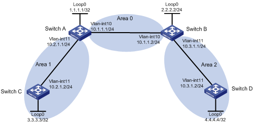

Configure Switch A and Switch B as PCEs, and configure Switch C as a PCC to automatically discover the PCEs.
Establish an MPLS TE tunnel over a CRLSP from Switch C to Switch D that uses the inter-area path calculated by PCEs.
Figure 12 Network diagram
2.        Configure OSPF to advertise interface addresses and configure OSPF TE:
[SwitchA] ospf
[SwitchA-ospf-1-area-0.0.0.0] network 1.1.1.1 0.0.0.0
[SwitchA-ospf-1] area 1
[SwitchA-ospf-1-area-0.0.0.1] network 10.2.1.0 0.0.0.255
[SwitchA-ospf-1-area-0.0.0.1] mpls te enable
[SwitchA-ospf-1-area-0.0.0.1] quit
[SwitchB] ospf
[SwitchB-ospf-1-area-0.0.0.0] network 2.2.2.2 0.0.0.0
[SwitchB-ospf-1] area 2
[SwitchB-ospf-1-area-0.0.0.2] network 10.3.1.0 0.0.0.255
[SwitchB-ospf-1-area-0.0.0.2] mpls te enable
[SwitchB-ospf-1-area-0.0.0.2] quit
[SwitchC] ospf
[SwitchC-ospf-1] area 1
[SwitchC-ospf-1-area-0.0.0.1] network 10.2.1.0 0.0.0.255
[SwitchC-ospf-1-area-0.0.0.1] network 3.3.3.3 0.0.0.0
[SwitchC-ospf-1-area-0.0.0.1] mpls te enable
[SwitchC-ospf-1-area-0.0.0.1] quit
[SwitchD] ospf
[SwitchD-ospf-1] area 2
[SwitchD-ospf-1-area-0.0.0.2] network 10.3.1.0 0.0.0.255
[SwitchD-ospf-1-area-0.0.0.2] network 4.4.4.4 0.0.0.0
[SwitchD-ospf-1-area-0.0.0.2] mpls te enable
[SwitchD-ospf-1-area-0.0.0.2] quit
[SwitchA] mpls te
[SwitchA-te] quit
[SwitchA] rsvp
[SwitchA-rsvp] quit
[SwitchA-Vlan-interface10] mpls enable
[SwitchA-Vlan-interface10] mpls te enable
[SwitchA-Vlan-interface10] rsvp enable
[SwitchA-Vlan-interface10] quit
[SwitchA] interface vlan-interface 11
[SwitchA-Vlan-interface11] mpls enable
[SwitchA-Vlan-interface11] mpls te enable
[SwitchA-Vlan-interface11] rsvp enable
[SwitchA-Vlan-interface11] quit
[SwitchB] mpls te
[SwitchB-te] quit
[SwitchB] rsvp
[SwitchB-rsvp] quit
[SwitchB] interface vlan-interface 10
[SwitchB-Vlan-interface10] mpls enable
[SwitchB-Vlan-interface10] mpls te enable
[SwitchB-Vlan-interface10] rsvp enable
[SwitchB-Vlan-interface10] quit
[SwitchB] interface vlan-interface 11
[SwitchB-Vlan-interface11] mpls enable
[SwitchB-Vlan-interface11] mpls te enable
[SwitchB-Vlan-interface11] rsvp enable
[SwitchB-Vlan-interface11] quit
[SwitchC] mpls te
[SwitchC-te] quit
[SwitchC] rsvp
[SwitchC-rsvp] quit
[SwitchC] interface vlan-interface 11
[SwitchC-Vlan-interface11] mpls enable
[SwitchC-Vlan-interface11] mpls te enable
[SwitchC-Vlan-interface11] rsvp enable
[SwitchC-Vlan-interface11] quit
[SwitchD] mpls lsr-id 4.4.4.4
[SwitchD] mpls te
[SwitchD-te] quit
[SwitchD] rsvp
[SwitchD-rsvp] quit
[SwitchD] interface vlan-interface 11
[SwitchD-Vlan-interface11] mpls enable
[SwitchD-Vlan-interface11] mpls te enable
[SwitchD-Vlan-interface11] rsvp enable
[SwitchD-Vlan-interface11] quit
4.        Configure Switch A and Switch B as PCEs:
[SwitchA] mpls te
[SwitchA-te] pce address 1.1.1.1
[SwitchB] mpls te
[SwitchB-te] pce address 2.2.2.2
5.        Configure Switch C as a PCC to use the path calculated by PCEs:
[SwitchC] interface tunnel 1 mode mpls-te
[SwitchC-Tunnel1] ip address 7.1.1.1 255.255.255.0
[SwitchC-Tunnel1] destination 4.4.4.4
[SwitchC-Tunnel1] mpls te signaling rsvp-te
# Configure the tunnel to use the path calculated by PCEs.
[SwitchC-Tunnel1] mpls te path preference 2 dynamic pce 1.1.1.1 2.2.2.2
[SwitchC-Tunnel1] quit
# Display discovered PCE information on each switch. This example uses Switch A.
[SwitchA] display mpls te pce discovery verbose
PCE address: 2.2.2.2
  Discovery methods: OSPF
  Path scopes:
    Path scope                                                Preference
    Compute intra-area paths                                  7
    Act as PCE for inter-area TE LSP computation              6
    Act as a default PCE for inter-area TE LSP computation    6
  Capabilities:
    Bidirectional path computation
    Support for request prioritization
    Support for multiple requests per message
  Domains:
    OSPF 1 area 0.0.0.0
    OSPF 1 area 0.0.0.2
# Verify that PCEP sessions have been established on each switch. This example uses Switch A.
[SwitchA] display mpls te pce peer verbose
Peer address: 2.2.2.2
  TCP connection          : 1.1.1.1:29507 -> 2.2.2.2:4189
  Peer type               : PCE
  Session type            : Stateless
  Session state           : UP
  Mastership              : Normal
  Role                    : Active
  Session up time         : 0000 days 00 hours 00 minutes
  Session ID              : Local 0, Peer 0
  Keepalive interval      : Local 30 sec, Peer 30 sec
  Recommended DeadTimer   : Local 120 sec, Peer 120 sec
  Tolerance:
    Min keepalive interval: 10 sec
    Max unknown messages  : 5
  Request timeout         : 10 sec
  Delegation timeout      : 30 sec
Peer address: 3.3.3.3
  TCP connection          : 3.3.3.3:29507 -> 1.1.1.1:4189
  Peer type               : PCC
  Session state           : UP
  Mastership              : Normal
  Role                    : Active
  Session ID              : Local 2, Peer 0
  Tolerance:
Example: Configuring bidirectional MPLS TE tunnel
Switch A, Switch B, Switch C, and Switch D all run IS-IS and they are all level-2 switches.
Use RSVP-TE to establish a bidirectional MPLS TE tunnel between Switch A and Switch D.
Figure 13 Network diagram
Table 4 Interface and IP address assignment
Device
Interface
IP address
Device
Interface
IP address
Switch A
Loop0
1.1.1.9/32
Switch D
Loop0
4.4.4.9/32
Vlan-int1
10.1.1.1/24
Vlan-int3
30.1.1.2/24
Vlan-int10
100.1.1.1/24
Vlan-int10
100.1.2.1/24
Switch B
Loop0
2.2.2.9/32
Switch C
Loop0
3.3.3.9/32
Vlan-int1
10.1.1.2/24
Vlan-int3
30.1.1.1/24
Vlan-int2
20.1.1.1/24
Vlan-int2
20.1.1.2/24
2.        Configure IS-IS to advertise interface addresses, including the loopback interface address.
For more information, see "Example: Establishing an MPLS TE tunnel with RSVP-TE."
3.        Configure an LSR ID, and enable MPLS, MPLS TE, and RSVP-TE on each switch. Configure Switch A and Switch D to assign a non-null label to the penultimate hop:
[SwitchA] mpls label advertise non-null
[SwitchA] mpls te
[SwitchA-te] quit
[SwitchA] rsvp
[SwitchA-rsvp] quit
[SwitchB] mpls te
[SwitchB-te] quit
[SwitchB] rsvp
[SwitchB-rsvp] quit
[SwitchC] mpls te
[SwitchC-te] quit
[SwitchC] rsvp
[SwitchC-rsvp] quit
[SwitchD] mpls label advertise non-null
[SwitchD] mpls te
[SwitchD-te] quit
[SwitchD] rsvp
[SwitchD-rsvp] quit
[SwitchA] isis 1
[SwitchB] isis 1
[SwitchC] isis 1
[SwitchD] isis 1
5.        Configure a co-routed bidirectional MPLS TE tunnel:
# Configure Switch A as the active end of the co-routed bidirectional tunnel.
[SwitchA-Tunnel1] mpls te resv-style ff
[SwitchA-Tunnel1] mpls te bidirectional co-routed active
# Configure Switch D as the passive end of the co-routed bidirectional tunnel.
[SwitchD] interface tunnel 4 mode mpls-te
[SwitchD-Tunnel4] ip address 8.1.1.1 255.255.255.0
[SwitchD-Tunnel4] destination 1.1.1.9
[SwitchD-Tunnel4] mpls te signaling rsvp-te
[SwitchD-Tunnel4] mpls te resv-style ff
[SwitchD-Tunnel4] mpls te bidirectional co-routed passive reverse-lsp lsr-id 1.1.1.9 tunnel-id 1
[SwitchD-Tunnel4] quit
6.        Create static routes to direct the traffic to the MPLS TE tunnels.
# Create a static route on Switch A to direct traffic destined for 100.1.2.0/24 to MPLS TE tunnel 1.
# Create a static route on Switch D to direct traffic destined for 100.1.1.0/24 to MPLS TE tunnel 4.
[SwitchD] ip route-static 100.1.1.0 24 tunnel 4 preference 1
Tunnel1
Current state: UP
Bandwidth: 64kbps
Output: 0 packets, 0 bytes, 0 drops
Tunnel State           : Up (Main CRLSP up. Reverse CRLSP up)
Tunnel Attributes      :
  LSP ID               : 30478           Tunnel ID            : 1
  Resv Style           : FF
  Tunnel mode          : Co-routed, active
  Class Type           : CT0             Tunnel Bandwidth     : 0 kbps
  Reserved Bandwidth   : 0 kbps
  Explicit Path        : -
  Metric Type          : TE

Example: Configuring manual bypass tunnel for FRR
On the primary CRLSP Switch A—Switch B—Switch C—Switch D, use FRR to protect the link Switch B—Switch C.
Use RSVP-TE to establish the primary CRLSP and bypass tunnel based on the constraints of the explicit paths to transmit data between the two IP networks. The bypass tunnel uses path Switch B—Switch E—Switch C. Switch B is the PLR and Switch C is the MP.
Configure BFD for RSVP-TE between Switch B and Switch C. When the link between Switch B and Switch C fails, BFD can detect the failure quickly and notify RSVP-TE of the failure, so RSVP-TE can switch traffic to the bypass tunnel.
Figure 15 Network diagram
Table 6 Interface and IP address assignment
Device
Interface
IP address
Device
Interface
IP address
Switch A
Loop0
1.1.1.1/32
Switch B
Loop0
2.2.2.2/32
Vlan-int1
2.1.1.1/24
Vlan-int1
2.1.1.2/24
Vlan-int10
100.1.1.1/24
Vlan-int2
3.1.1.1/24
Switch D
Loop0
4.4.4.4/32
Vlan-int4
3.2.1.1/24
Vlan-int3
4.1.1.2/24
Switch C
Loop0
3.3.3.3/32
Vlan-int10
100.1.1.1/24
Vlan-int3
4.1.1.1/24
Switch E
Loop0
5.5.5.5/32
Vlan-int2
3.1.1.2/24
Vlan-int4
3.2.1.2/24
Vlan-int5
3.3.1.2/24
Vlan-int5
3.3.1.1/24
2.        Configure IS-IS to advertise interface addresses, including the loopback interface address. (Details not shown.)
3.        Configure an LSR ID, and enable MPLS, MPLS TE, and RSVP-TE on each switch. Enable BFD for RSVP-TE on Switch B and Switch C:
[SwitchA] mpls te
[SwitchA-te] quit
[SwitchA] rsvp
[SwitchA-rsvp] quit
[SwitchB] mpls te
[SwitchB-te] quit
[SwitchB] rsvp
[SwitchB-rsvp] quit
[SwitchB-Vlan-interface2] rsvp bfd enable
[SwitchB] interface vlan-interface 4
[SwitchB-Vlan-interface4] mpls enable
[SwitchB-Vlan-interface4] mpls te enable
[SwitchB-Vlan-interface4] rsvp enable
[SwitchB-Vlan-interface4] quit
# Configure Switch C in the same way that Switch B is configured. Configure Switch D and Switch E in the same way that Switch A is configured. (Details not shown.)
4.        Configure an MPLS TE tunnel on Switch A, the ingress node of the primary CRLSP:
# Configure an explicit path for the primary CRLSP.
[SwitchA] explicit-path pri-path
[SwitchA-explicit-path-pri-path] nexthop 2.1.1.2
[SwitchA-explicit-path-pri-path] nexthop 3.1.1.2
[SwitchA-explicit-path-pri-path] nexthop 4.1.1.2
[SwitchA-explicit-path-pri-path] nexthop 4.4.4.4
[SwitchA-explicit-path-pri-path] quit
# Create MPLS TE tunnel interface Tunnel 4 for the primary CRLSP.
[SwitchA] interface tunnel 4 mode mpls-te
[SwitchA-Tunnel4] ip address 10.1.1.1 255.255.255.0
[SwitchA-Tunnel4] destination 4.4.4.4
# Specify the tunnel signaling protocol as RSVP-TE.
[SwitchA-Tunnel4] mpls te signaling rsvp-te
# Specify the explicit path to be used as pri-path.
[SwitchA-Tunnel4] mpls te path preference 1 explicit-path pri-path
# Enable FRR for the MPLS TE tunnel.
[SwitchA-Tunnel4] mpls te fast-reroute
[SwitchA-Tunnel4] quit
# Verify that the tunnel interface Tunnel 4 is up on Switch A.
Tunnel4
Current state: UP
Line protocol current state: UP
Description: Tunnel4 Interface
Bandwidth: 64kbps
Internet address: 10.1.1.1/24 (primary)
Tunnel source unknown, destination 4.4.4.4
Tunnel TTL 255
Last 300 seconds output rate: 1911 bytes/sec, 15288 bits/sec, 0 packets/sec
Output: 1526 packets output, 22356852 bytes, 0 drops
Tunnel Name            : Tunnel 4
Tunnel Attributes      :
  LSP ID               : 48960           Tunnel ID            : 4
  Resv Style           : SE
  Tunnel mode          : -
  Explicit Path        : pri-path
  Metric Type          : TE
  Record Route         : Enabled         Record Label         : Enabled
  FRR Flag             : Enabled         Bandwidth Protection : Disabled
5.        Configure a bypass tunnel on Switch B (the PLR):
# Configure an explicit path for the bypass tunnel.
[SwitchB] explicit-path by-path
[SwitchB-explicit-path-by-path] nexthop 3.2.1.2
[SwitchB-explicit-path-by-path] nexthop 3.3.1.2
[SwitchB-explicit-path-by-path] nexthop 3.3.3.3
[SwitchB-explicit-path-by-path] quit
# Create MPLS TE tunnel interface Tunnel 5 for the bypass tunnel.
[SwitchB] interface tunnel 5 mode mpls-te
[SwitchB-Tunnel5] ip address 11.1.1.1 255.255.255.0
# Specify the tunnel destination address as LSR ID of Switch C.
[SwitchB-Tunnel5] destination 3.3.3.3
[SwitchB-Tunnel5] mpls te signaling rsvp-te
# Specify the explicit path to be used as by-path.
[SwitchB-Tunnel5] mpls te path preference 1 explicit-path by-path
# Set the bandwidth that the bypass tunnel can protect.
[SwitchB-Tunnel5] mpls te backup bandwidth un-limited
[SwitchB-Tunnel5] quit
# Bind the bypass tunnel to the protected interface.
[SwitchB-Vlan-interface2] mpls te fast-reroute bypass-tunnel tunnel 5
# Execute the display interface tunnel command on Switch B to verify that the tunnel interface Tunnel 5 is up. (Details not shown.)
6.        Configure a static route on Switch A to direct the traffic destined for subnet 100.1.2.0/24 to MPLS TE tunnel 4.
[SwitchA] ip route-static 100.1.2.0 24 tunnel 4 preference 1
# Display LSP entries on each switch to verify that Switch B and Switch C each have two CRLSPs and the bypass tunnel backs up the primary CRLSP.
1.1.1.1/4/61400             RSVP     -/1245          Vlan1
1.1.1.1/4/614000            RSVP     1245/3          Vlan2
Backup                               1245/3          Tun5
2.2.2.2/5/30914             RSVP     -/1150          Vlan2
3.2.1.2                     Local    -/-             Vlan4
3.1.1.2                     Local    -/-             Vlan2
[SwitchE] display mpls lsp
2.2.2.2/5/30914             RSVP     1150/3          Vlan5
3.3.1.2                     Local    -/-             Vlan5
# Shut down the protected interface VLAN-interface 2 on the PLR (Switch B).
[SwitchB-Vlan-interface2] shutdown
# Execute the display interface tunnel 4 command on Switch A to display information about the primary CRLSP. The output shows that the tunnel interface is still up. (Details not shown.)
# Display detailed information about the tunnel interface on Switch A.
Tunnel State           : Up (Main CRLSP up. Shared-resource CRLSP being set up)
Tunnel Attributes      :
  LSP ID               : 18753           Tunnel ID            : 4
  Resv Style           : SE
  Tunnel mode          : -
  Metric Type          : TE
If you execute the display mpls te tunnel-interface command immediately after an FRR, you can see two CRLSPs in up state. This is because FRR uses the make-before-break mechanism to set up a new LSP, and the old LSP is deleted after the new one has been established for a while.
# Verify that the bypass tunnel is in use on Switch B.
1.1.1.1/4/61400             RSVP     1136/3          Tun5
2.2.2.2/5/30914             RSVP     -/1149          Vlan4
# On the PLR, configure the interval for selecting an optimal bypass tunnel as 5 seconds.
[SwitchB] mpls te
[SwitchB-te] fast-reroute timer 5
[SwitchB-te] quit
# On the PLR, bring up the protected interface VLAN-interface 2.
[SwitchB-Vlan-interface2] undo shutdown
# Execute the display interface tunnel 4 command on Switch A to display information about the primary CRLSP. The output shows that the tunnel interface is in up state. (Details not shown.)
# Wait for about 5 seconds, execute the display mpls lsp verbose command on Switch B. The output shows that Tunnel 5 is bound to interface VLAN-interface 2 but not in use. (Details not shown.)
# Execute the display ip routing-table command on Switch A. The output shows a static route entry with interface Tunnel 4 as the output interface. (Details not shown.)

5.        Configure auto FRR on Switch B (the PLR):
# Enable the automatic bypass tunnel setup feature globally.
[SwitchB] mpls te
[SwitchB-te] auto-tunnel backup
# Specify interface numbers 50 to 100 for the automatically created bypass tunnels.
[SwitchB-te-auto-bk] tunnel-number min 50 max 100
[SwitchB-te-auto-bk] quit
# Verify that two tunnels have been created automatically on Switch B.
[SwitchB] display interface tunnel brief
Brief information on interfaces in route mode:
Link: ADM - administratively down; Stby - standby
Protocol: (s) - spoofing
Interface            Link Protocol Primary IP      Description
Tun50                UP   DOWN     --
Tun51                UP   DOWN     --
# Display information about Tunnel 50 and Tunnel 51 on Switch B. The output shows that Tunnel 50 and Tunnel 51 are automatically created bypass tunnels. Tunnel 50 is a node-protection bypass tunnel (egress LSR ID is 4.4.4.4, the LSR ID of Switch D). Tunnel 51 is a link-protection bypass tunnel (egress LSR ID is 3.3.3.3, the LSR ID of Switch C).

# Verify that the current bypass tunnel that protects the primary CRLSP is tunnel 50.
2.2.2.2/51/16802            RSVP     -/3             Vlan4
2.2.2.2/1/16802             RSVP     -/1151          Vlan2
Backup                               -/3             Tun50
2.2.2.2/50/16802            RSVP     -/3             Vlan6

Fast Reroute protection: Ready
  FRR inner label: 3           Bypass tunnel: Tunnel50
Example: Configuring IETF DS-TE
Use RSVP-TE to establish an MPLS TE tunnel from Switch A to Switch D to transmit data between the two IP networks. Traffic of the tunnel belongs to CT 2, and the tunnel needs a bandwidth of 4000 kbps.
The maximum bandwidth of the link that the tunnel traverses is 10000 kbps and the maximum reservable bandwidth of the link is 10000 kbps. BC 1, BC 2, and BC 3 are 8000 kbps, 5000 kbps, and 2000 kbps.
Figure 17 Network diagram
Table 8 Interface and IP address assignment
Device
Interface
IP address
Device
Interface
IP address
Switch A
Loop0
1.1.1.9/32
Switch D
Loop0
4.4.4.9/32
Vlan-int1
10.1.1.1/24
Vlan-int3
30.1.1.2/24
Vlan-int10
100.1.1.1/24
Vlan-int10
100.1.2.1/24
Switch B
Loop0
2.2.2.9/32
Switch C
Loop0
3.3.3.9/32
Vlan-int1
10.1.1.2/24
Vlan-int3
30.1.1.1/24
Vlan-int2
20.1.1.1/24
Vlan-int2
20.1.1.2/24
[SwitchA] isis 1
[SwitchB] isis 1
[SwitchC] isis 1
[SwitchD] isis 1
2.2.2.9/32         IS_L1   15  10          10.1.1.2        Vlan1
3.3.3.9/32         IS_L1   15  20          10.1.1.2        Vlan1
4.4.4.9/32         IS_L1   15  30          10.1.1.2        Vlan1
20.1.1.0/24        IS_L1   15  20          10.1.1.2        Vlan1
30.1.1.0/24        IS_L1   15  30          10.1.1.2        Vlan1
3.        Configure an LSR ID, enable MPLS, MPLS TE, and RSVP-TE, and configure the DS-TE mode as IETF:
[SwitchA] mpls te
[SwitchA-te] ds-te mode ietf
[SwitchA-te] quit
[SwitchA] rsvp
[SwitchA-rsvp] quit
[SwitchB] mpls te
[SwitchB-te] ds-te mode ietf
[SwitchB-te] quit
[SwitchB] rsvp
[SwitchB-rsvp] quit
[SwitchC] mpls te
[SwitchC-te] ds-te mode ietf
[SwitchC-te] quit
[SwitchC] rsvp
[SwitchC-rsvp] quit
[SwitchD] mpls te
[SwitchD-te] ds-te mode ietf
[SwitchD-te] quit
[SwitchD] rsvp
[SwitchD-rsvp] quit
[SwitchA] isis 1
[SwitchB] isis 1
[SwitchC] isis 1
[SwitchD] isis 1
# Set the maximum bandwidth, maximum reservable bandwidth, and bandwidth constraints on Switch A.
[SwitchA-Vlan-interface1] mpls te max-reservable-bandwidth rdm 10000 bc1 8000 bc2 5000 bc3 2000
# Set the maximum bandwidth, maximum reservable bandwidth, and bandwidth constraints on Switch B.
[SwitchB-Vlan-interface1] mpls te max-reservable-bandwidth rdm 10000 bc1 8000 bc2 5000 bc3 2000
[SwitchB-Vlan-interface2] mpls te max-reservable-bandwidth rdm 10000 bc1 8000 bc2 5000 bc3 2000
# Set the maximum bandwidth, maximum reservable bandwidth, and bandwidth constraints on Switch C.
[SwitchC-Vlan-interface3] mpls te max-reservable-bandwidth rdm 10000 bc1 8000 bc2 5000 bc3 2000
[SwitchC-Vlan-interface2] mpls te max-reservable-bandwidth rdm 10000 bc1 8000 bc2 5000 bc3 2000
# Set the maximum bandwidth, maximum reservable bandwidth, and bandwidth constraints on Switch D.
[SwitchD-Vlan-interface3] mpls te max-reservable-bandwidth rdm 10000 bc1 8000 bc2 5000 bc3 2000
# Create MPLS TE tunnel interface Tunnel 1.
# Assign 4000 kbps bandwidth to CT 2 for the tunnel.
[SwitchA-Tunnel1] mpls te bandwidth ct2 4000
# Set the tunnel setup priority and holding priority both to 0.
[SwitchA-Tunnel1] mpls te priority 0
Tunnel4
Current state: UP
Bandwidth: 64kbps
Tunnel TTL 255
Tunnel Attributes      :
  LSP ID               : 36882           Tunnel ID            : 1
  Resv Style           : SE
  Tunnel mode          : -
  Class Type           : CT2             Tunnel Bandwidth     : 4000 kbps
  Reserved Bandwidth   : 4000 kbps
  Explicit Path        : -
  Metric Type          : TE
# Display bandwidth information on interface VLAN-interface 1 on Switch A.
[SwitchA] display mpls te link-management bandwidth-allocation interface vlan-interface 1
Interface:  Vlan-interface1
  Max Link Bandwidth                          : 10000 kbps
  Max Reservable Bandwidth of Prestandard RDM : 0 kbps
  Max Reservable Bandwidth of IETF RDM        : 10000 kbps
  Max Reservable Bandwidth of IETF MAM        : 0 kbps
  Allocated Bandwidth-Item Count  : 1
  Allocated Bandwidth             : 0 kbps
  Physical Link Status            : Up
  BC  Prestandard RDM(kbps)  IETF RDM(kbps)       IETF MAM(kbps)
  0   0                      10000                0
  1   0                      8000                 0
  2   -                      5000                 0
  3   -                      2000                 0
  TE Class    Class Type    Priority   BW Reserved(kbps)  BW Available(kbps)
  0           0             0          0                  0
  1           0             1          0                  0
  2           0             2          0                  0
  3           0             3          0                  0
  4           0             4          0                  0
  5           0             5          0                  0
  6           0             6          0                  0
  7           0             7          0                  0

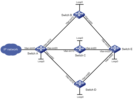

Example: Configuring CBTS
As shown in Figure 18, all switches run IS-IS.
Use RSVP-TE to establish the following MPLS TE tunnels between Switch A and Switch E:
·          Switch A—Switch B—Switch E.
·          Switch A—Switch C—Switch E.
·          Switch A—Switch D—Switch E.
Assign the MPLS TE tunnels different service class values for different classes of services.
Figure 18 Network diagram
Table 9 Interface and IP address assignment
Device
Interface
IP address
Device
Interface
IP address
Switch A
Loop0
1.1.1.1/32
Switch D
Loop0
4.4.4.4/32
Vlan-int10
10.1.1.1/24
Vlan-int10
30.1.1.2/24
Vlan-int20
20.1.1.1/24
Vlan-int20
40.1.1.1/24
Vlan-int30
30.1.1.1/24
Switch E
Loop0
5.5.5.5/32
Vlan-int40
100.1.1.1/24
Vlan-int10
100.1.1.2/24
Switch B
Loop0
2.2.2.2/32
Vlan-int20
200.1.1.2/24
Vlan-int10
10.1.1.2/24
Vlan-int30
40.1.1.1.2/24
Vlan-int20
100.1.1.1/24
Switch C
Loop0
3.3.3.3/32
Vlan-int10
20.1.1.2/24
Vlan-int20
200.1.1.1/24
1.        Configure IP addresses and masks for interfaces, including the loopback interfaces, as shown in Figure 18. (Details not shown.)
2.        Configure IS-IS to advertise interface addresses including loopback interface addresses, and configure IS-IS TE. (Details not shown.)
3.        Configure an LSR ID, and enable MPLS, MPLS TE, and RSVP-TE on each switch. (Details not shown.)
4.        Use RSVP-TE to establish three MPLS TE tunnels: Tunnel 1, Tunnel 2, and Tunnel 3. Tunnel 1 uses path Switch A—Switch B—Switch E. Tunnel 2 uses path Switch A—Switch C—Switch E. Tunnel 3 uses path Switch A—Switch D—Switch E. (Details not shown.)
5.        Configure a QoS policy on Switch A.
# Create a traffic class.
[SwitchA] traffic classifier class
[SwitchA-classifier-class] if-match any
[SwitchA-classifier-class] quit
# Create a traffic behavior.
[SwitchA] traffic behavior behave
[SwitchA-behavior-behave] remark service-class 6
[SwitchA-behavior-behave] quit
# Create a QoS policy.
[SwitchA] qos policy policy1
[SwitchA-qospolicy-policy1] classifier class behavior behave
[SwitchA-qospolicy-policy1] quit
# Apply the QoS policy to VLAN-interface 40.
[SwitchA] interface vlan-interface 40
[SwitchA-Vlan-interface40] qos apply policy policy1 inbound
[SwitchA-Vlan-interface40] quit
6.        Set the service class values for the MPLS TE tunnels.
# Set the service class value to 3 for Tunnel 2.
[SwitchA] interface Tunnel 2 mode mpls-te
[SwitchA-Tunnel2] mpls te service-class 3
[SwitchA-Tunnel2] quit
# Set the service class value to 6 for Tunnel 3.
[SwitchA] interface Tunnel 3 mode mpls-te
[SwitchA-Tunnel3] mpls te service-class 6
[SwitchA-Tunnel3] quit
# Display information about Tunnel 1 on Switch A.
[SwitchA] display mpls te tunnel-interface Tunnel 1
Tunnel State           : Up (Main CRLSP up)
Tunnel Attributes      :
  LSP ID               : 17419           Tunnel ID            : 1
  Ingress LSR ID       : 10.1.1.1        Egress LSR ID        : 40.1.1.1
  Resv Style           : -
  Tunnel mode          : -
  Explicit Path        : -
  Metric Type          : TE
  Route Pinning        : -
The Service-Class field has no value, indicating that no service class value is specified for Tunnel 1.
# Display information about Tunnel 2 and Tunnel 3 on Switch A.
[SwitchA] display mpls te tunnel-interface Tunnel 2
Tunnel Name            : Tunnel 2

[SwitchA]display mpls te tunnel-interface Tunnel 3
Tunnel Name            : Tunnel 3
Tunnel Attributes      :
  LSP ID               : 17418           Tunnel ID            : 3
  Resv Style           : -
  Tunnel mode          : -
  Explicit Path        : -
  Metric Type          : TE
  Route Pinning        : -
  Collected Bandwidth  : -               Service-Class        : 6
The Service-Class fields show that the service class values of Tunnel 2 and Tunnel 3 are 3 and 6, respectively. According to the QoS policy, traffic arrives at VLAN-interface 40 of Switch A is assigned service class value 3. So CBTS uses Tunnel 2 to forward the traffic.
