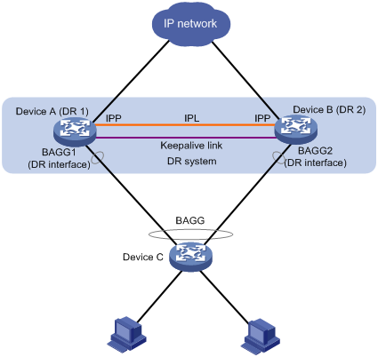

As shown in Figure 1, DRNI virtualizes two devices into a distributed-relay (DR) system, which connects to the remote aggregation system through a multichassis aggregate link. To the remote aggregation system, the DR system is one device.
Figure 1 DRNI network model
The DR member devices are DR peers to each other. For features that require centralized traffic processing (for example, spanning tree), a DR member device is assigned the primary or secondary role based on its DR role priority. The secondary DR device passes the traffic of those features to the primary DR device for processing. If the DR member devices in a DR system have the same DR role priority, the device with the lower bridge MAC address is assigned the primary role.

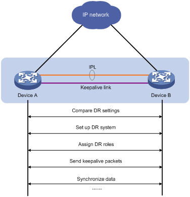

As shown in Figure 2, two devices perform the following operations to form a DR system:
1.     Send DRCPDUs over the IPL to each other and compare the DRCPDUs to determine the DR system stackability and device roles:
a.     Compare the DR system settings. The devices can form a DR system if they have the same DR system MAC address and system priority and different DR system numbers.
b.     Determine the device roles based on the DR role priority and the bridge MAC address.
c.     Perform configuration consistency check. For more information, see "Configuration consistency check."
2.     Send keepalive packets over the keepalive link to verify that the peer system is operating correctly.
3.     Synchronize configuration data by sending DRCPDUs over the IPL. The configuration data includes MAC address entries and ARP entries.
Figure 2 DR system setup process

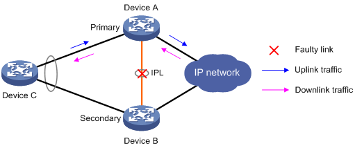

When the DR interface of one DR member device fails, the DR system forwards traffic through the other DR member device.
As shown in Figure 3, Device A and Device B form a DR system, to which Device C is attached through a multichassis aggregation. If traffic to Device C arrives at Device B after the DR interface connected Device B to Device C has failed, the DR system forwards the traffic as follows:
1.     Device B sends the traffic to Device A over the IPL.
2.     Device A forwards the downlink traffic received from the IPL to Device C.
After the faulty DR interface comes up, Device B forwards traffic to Device C through the DR interface.
Figure 3 DR interface failure handling mechanism

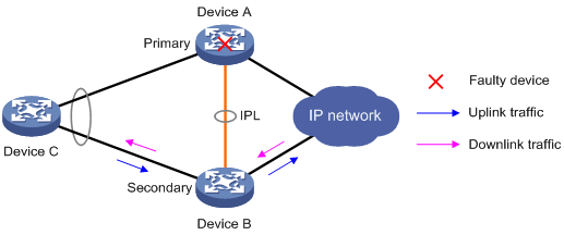

As shown in Figure 5, when the primary DR device fails, the secondary DR device takes over the primary role to forward all traffic for the DR system. When the faulty device recovers, it becomes the secondary DR device.
When the secondary DR device fails, the primary DR device forwards all traffic for the DR system.
Figure 5 Device failure handling mechanism

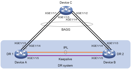

DRNI configuration examples
Basic DRNI function configuration example
Network requirements
As shown in Figure 6, configure DRNI on Device A and Device B to establish a multichassis aggregate link with Device C.
Figure 6 Network diagram
Configuration procedure

[DeviceB-Ten-GigabitEthernet1/1/4] port link-aggregation group 4
[DeviceB-Ten-GigabitEthernet1/1/4] quit
# Assign Bridge-Aggregation 4 to DR group 4.
[DeviceB] interface bridge-aggregation 4
[DeviceB-Bridge-Aggregation4] port drni group 4
[DeviceB-Bridge-Aggregation4] quit
3.     Configure Device C:
# Create Layer 2 dynamic aggregate interface Bridge-Aggregation 4.
<DeviceC> system-view
[DeviceC] interface bridge-aggregation 4
[DeviceC-Bridge-Aggregation4] link-aggregation mode dynamic
[DeviceC-Bridge-Aggregation4] quit
# Assign Ten-GigabitEthernet 1/1/1 through Ten-GigabitEthernet 1/1/4 to aggregation group 4.
[DeviceC] interface range ten-gigabitethernet 1/1/1 to ten-gigabitethernet 1/1/4
[DeviceC-if-range] port link-aggregation group 4
[DeviceC-if-range] quit

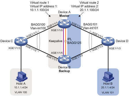

DRNI Layer 3 forwarding configuration example
As shown in Figure 7:
·     Configure Device A and Device B as a DR system to establish one multichassis aggregate link with Device C and one with Device D.
·     Set up a keepalive link between Ten-GigabitEthernet 1/1/5 of Device A and Ten-GigabitEthernet 1/1/5 of Device B, and exclude the interfaces from the shutdown action by DRNI MAD.
·     Configure two VRRP groups on Device A and Device B to provide gateway services for VLAN 100 and VLAN 200. Configure Device A as the master of the VRRP groups.
Figure 7 Network diagram

[DeviceB] interface vlan-interface 101
[DeviceB-Vlan-interface101] vrrp vrid 2 virtual-ip 20.1.1.100
[DeviceB-Vlan-interface101] quit
# Create Layer 2 dynamic aggregate interface Bridge-Aggregation 100.
[DeviceC] interface bridge-aggregation 100
[DeviceC-Bridge-Aggregation100] link-aggregation mode dynamic
[DeviceC-Bridge-Aggregation100] quit
# Assign Ten-GigabitEthernet 1/1/1 and Ten-GigabitEthernet 1/1/2 to aggregation group 100.
[DeviceC] interface range ten-gigabitethernet 1/1/1 to ten-gigabitethernet 1/1/2
[DeviceC-if-range] port link-aggregation group 100
# Create VLAN 100.
[DeviceC] vlan 100
[DeviceC-vlan100] quit
# Set the link type of Bridge-Aggregation 100 to trunk, and assign it to VLAN 100.
[DeviceC-Bridge-Aggregation100] port link-type trunk
[DeviceC-Bridge-Aggregation100] port trunk permit vlan 100
# Set the link type of Ten-GigabitEthernet 1/1/3 to trunk, and assign it to VLAN 100.
[DeviceC] interface ten-gigabitethernet 1/1/3
[DeviceC-Ten-GigabitEthernet1/1/3] port link-type trunk
[DeviceC-Ten-GigabitEthernet1/1/3] port trunk permit vlan 100
[DeviceC-Ten-GigabitEthernet1/1/3] quit
# Create VLAN-interface 100, and assign it an IP address.
[DeviceC] interface vlan-interface 100
[DeviceC-vlan-interface100] ip address 10.1.1.3 24
[DeviceC-vlan-interface100] quit
# Configure OSPF.
[DeviceC] ospf
[DeviceC-ospf-1] import-route direct
[DeviceC-ospf-1] area 0
[DeviceC-ospf-1-area-0.0.0.0] network 10.1.1.0 0.0.0.255
[DeviceC-ospf-1-area-0.0.0.0] quit
[DeviceC-ospf-1] quit
4.     Configure Device D:
# Create Layer 2 dynamic aggregate interface Bridge-Aggregation 101.
<DeviceD> system-view
[DeviceD] interface bridge-aggregation 101
[DeviceD-Bridge-Aggregation101] link-aggregation mode dynamic
[DeviceD-Bridge-Aggregation101] quit
# Assign Ten-GigabitEthernet 1/1/1 and Ten-GigabitEthernet 1/1/2 to aggregation group 101.
[DeviceD] interface range ten-gigabitethernet 1/1/1 to ten-gigabitethernet 1/1/2
[DeviceD-if-range] port link-aggregation group 101
[DeviceD-if-range] quit
# Create VLAN 101.
[DeviceD] vlan 101
[DeviceD-vlan101] quit
# Set the link type of Bridge-Aggregation 101 to trunk, and assign it to VLAN 101.
[DeviceD-Bridge-Aggregation101] port link-type trunk
[DeviceD-Bridge-Aggregation101] port trunk permit vlan 101
# Set the link type of Ten-GigabitEthernet 1/1/3 to trunk, and assign it to VLAN 101.
[DeviceD] interface ten-gigabitethernet 1/1/3
[DeviceD-Ten-GigabitEthernet1/1/3] port link-type trunk
[DeviceD-Ten-GigabitEthernet1/1/3] port trunk permit vlan 101
[DeviceD-Ten-GigabitEthernet1/1/3] quit
# Create VLAN-interface 101, and assign it an IP address.
[DeviceD] interface vlan-interface 101
[DeviceD-vlan-interface101] ip address 20.1.1.3 24
[DeviceD-vlan-interface101] quit
# Configure OSPF.
[DeviceD] ospf
[DeviceD-ospf-1] import-route direct
[DeviceD-ospf-1] area 0
[DeviceD-ospf-1-area-0.0.0.0] network 20.1.1.0 0.0.0.255
[DeviceD-ospf-1-area-0.0.0.0] quit
[DeviceD-ospf-1] quit
# Verify that Device C has established OSPF neighbor relationships with Device A and Device B.
[DeviceC] display ospf peer
         OSPF Process 1 with Router ID 10.1.1.3
               Neighbor Brief Information
 Area: 0.0.0.0
 Router ID       Address         Pri Dead-Time  State             Interface
 20.1.1.1        10.1.1.1        1   37         Full/DR           Vlan100
 20.1.1.2        10.1.1.2        1   32         Full/BDR          Vlan100
# Verify that Device D has established OSPF neighbor relationships with Device A and Device B.
[DeviceD] display ospf peer
         OSPF Process 1 with Router ID 20.1.1.3
 Area: 0.0.0.0
 20.1.1.1        20.1.1.1        1   38         Full/DR           Vlan101
 20.1.1.2        20.1.1.2        1   37         Full/BDR          Vlan101
# Verify that Host A and Host B can ping each other. (Details not shown.)
