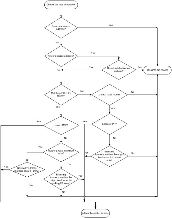

Figure 2 shows how uRPF works.
Figure 2 uRPF work flow
1.     uRPF checks source address validity:
¡     uRPF discards packets with a broadcast source address.
¡     uRPF discards packets with an all-zero source address but a non-broadcast destination address. (A packet with source address 0.0.0.0 and destination address 255.255.255.255 might be a DHCP or BOOTP packet and cannot be discarded.)
¡     uRPF proceeds to step 2 for other packets.
2.     uRPF checks whether the source address matches a FIB entry:
¡     If yes, uRPF proceeds to step 3.
¡     If no, uRPF proceeds to step 6.
3.     uRPF checks whether the check mode is loose:
¡     If yes, uRPF proceeds to step 8.
¡     If no, uRPF checks whether the matching route is a direct route:
-     If yes, uRPF proceeds to step 5.
-     If no, uRPF proceeds to step 4.
4.     uRPF checks whether the receiving interface matches the output interface of the matching FIB entry:
¡     If no, uRPF proceeds to step 9.
5.     uRPF checks whether the source IP address matches an ARP entry:
6.     uRPF checks whether the FIB table has a default route:
¡     If yes, uRPF proceeds to step 7.
7.     uRPF checks whether the check mode is loose:
¡     If no, uRPF checks whether the output interface of the default route matches the receiving interface of the packet:
-     If yes, uRPF proceeds to step 8.
-     If no, uRPF proceeds to step 9.
8.     The packet passes the check and is forwarded.
9.     The packet is discarded.

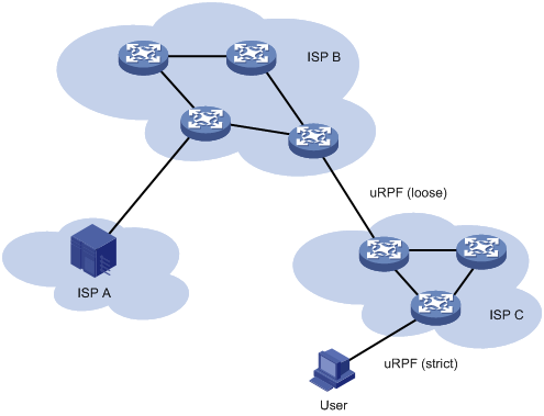

Figure 3 Network diagram
As shown in Figure 3, strict uRPF check is configured between an ISP network and a customer network. Loose uRPF check is configured between ISPs.
