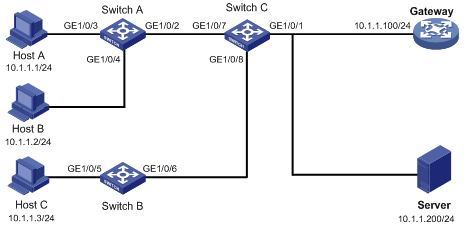

Manual-mode MFF configuration example in a tree network
Network requirements
As shown in Figure 2, all the devices are in VLAN 100. Hosts A, B, and C are assigned IP addresses manually.
Configure MFF to isolate the hosts at Layer 2 and allow them to communicate with each other through Gateway at Layer 3.
Figure 2 Network diagram
Configuration procedure
1.     Configure the IP addresses of the hosts and Gateway as shown in Figure 2.
2.     Configure Switch A:
# Configure manual-mode MFF on VLAN 100.
[SwitchA] vlan 100
[SwitchA-vlan100] mac-forced-forwarding default-gateway 10.1.1.100
# Specify the IP address of the server.
[SwitchA-vlan100] mac-forced-forwarding server 10.1.1.200
# Enable ARP snooping on VLAN 100.
[SwitchA-vlan100] arp snooping enable
[SwitchA-vlan100] quit
# Configure GigabitEthernet 1/0/2 as a network port.
[SwitchA] interface gigabitethernet 1/0/2
[SwitchA-GigabitEthernet1/0/2] mac-forced-forwarding network-port
3.     Configure Switch B:
[SwitchB] vlan 100
[SwitchB-vlan100] mac-forced-forwarding default-gateway 10.1.1.100
[SwitchB-vlan100] mac-forced-forwarding server 10.1.1.200
[SwitchB-vlan100] arp snooping enable
[SwitchB-vlan100] quit
# Configure GigabitEthernet 1/0/6 as a network port.
[SwitchB] interface gigabitethernet 1/0/6
[SwitchB-GigabitEthernet1/0/6] mac-forced-forwarding network-port
