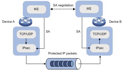

IP Security (IPsec) is defined by the IETF to provide interoperable, high-quality, cryptographically-based security for IP communications. It is a Layer 3 VPN technology that transmits data in a secure channel established between two endpoints (such as two security gateways). Such a secure channel is usually called an IPsec tunnel.
IPsec is a security framework that has the following protocols and algorithms:
·     Authentication Header (AH).
·     Encapsulating Security Payload (ESP).
·     Internet Key Exchange (IKE).
·     Algorithms for authentication and encryption.
AH and ESP are security protocols that provide security services. IKE performs automatic key exchange. For more information about IKE, see "Configuring IKE."

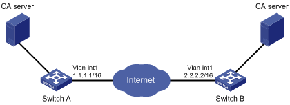

Configuring an IKE-based IPsec tunnel for IPv4 packets
Network requirements
As shown in Figure 5, establish an IPsec tunnel between Switch A and Switch B to protect data flows between the switches. Configure the IPsec tunnel as follows:
·     Specify the encapsulation mode as tunnel, the security protocol as ESP, the encryption algorithm as AES-CBC-192, and the authentication algorithm as HMAC-SHA1.
·     Set up SAs through IKE negotiation.
Figure 5 Network diagram
Configuration procedure
1.     Configure Switch A:

As shown in Figure 7, IKE negotiates SAs for IPsec and transfers the SAs to IPsec, and IPsec uses the SAs to protect IP packets.
Figure 7 Relationship between IKE and IPsec

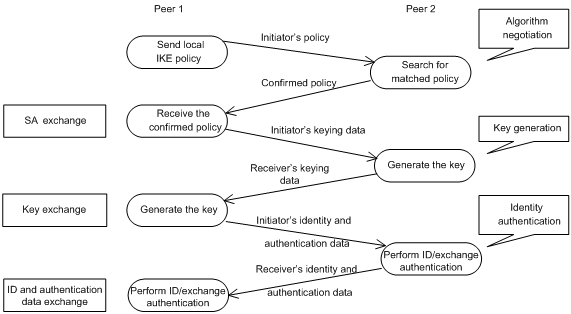

Figure 8 IKE exchange process in main mode
As shown in Figure 8, the main mode of IKE negotiation in phase 1 involves three pairs of messages:
·     SA exchange—Used for negotiating the IKE security policy.
·     Key exchange—Used for exchanging the DH public value and other values, such as the random number. The two peers use the exchanged data to generate key data and use the encryption key and authentication key to ensure the security of IP packets.
·     ID and authentication data exchange—Used for identity authentication.
The main difference between the main mode and the aggressive mode is that the aggressive mode does not provide identity information protection and exchanges only three messages, rather than three pairs. The main mode provides identity information protection but is slower.

Main mode IKE with pre-shared key authentication configuration example
As shown in Figure 9, configure an IPsec tunnel that uses IKE negotiation between Switch A and Switch B to secure the communication.
Configure Switch A and Switch B to use the default IKE proposal for the IKE negotiation to set up the IPsec SA. Configure the two switches to use the pre-shared key authentication method.
Figure 9 Network diagram
Make sure Switch A and Switch B can reach each other.

IKEv2 with RSA signature authentication configuration example
As shown in Figure 12, configure an IKE-based IPsec tunnel between Switch A and Switch B to secure the communication between the switches.
Configure Switch A and Switch B to use IKEv2 negotiation and RSA signature authentication.
Figure 12 Network diagram

# Use the ESP protocol for the IPsec transform set.
[SwitchA-ipsec-transform-set-tran1] protocol esp
# Specify the encryption and authentication algorithms.
[SwitchA-ipsec-transform-set-tran1] esp encryption-algorithm des-cbc
[SwitchA-ipsec-transform-set-tran1] esp authentication-algorithm sha1
[SwitchA-ipsec-transform-set-tran1] quit
# Create a PKI entity named entity1.
[SwitchA] pki entity entity1
# Set the common name to switcha for the PKI entity.
[SwitchA-pki-entity-entity1] common-name switcha
[SwitchA-pki-entity-entity1] quit
# Create a PKI domain named domain1.
[SwitchA] pki domain domain1
# Set the certificate request mode to auto and set the password to 123 for certificate revocation.
[SwitchA-pki-domain-domain1] certificate request mode auto password simple 123
# Set an MD5 fingerprint for verifying the validity of the CA root certificate.
[SwitchA-pki-domain-domain1] root-certificate fingerprint md5 50c7a2d282ea710a449eede6c56b102e
# Specify the trusted CA 8088.
[SwitchA-pki-domain-domain1] ca identifier 8088
# Specify the URL of the registration server for certificate request through the SCEP protocol. This example uses http://192.168.222.1:446/eadbf9af4f2c4641e685f7a6021e7b298373feb7.
[SwitchA-pki-domain-domain1] certificate request url http://192.168.222.1:446/eadbf9af4f2c4641e685f7a6021e7b298373feb7
# Specify the CA to accept certificate requests.
[SwitchA-pki-domain-domain1] certificate request from ca
# Specify the PKI entity for certificate request as entity1.
[SwitchA-pki-domain-domain1] certificate request entity entity1
# Specify RSA key pair rsa1 with the general purpose for certificate request.
[SwitchA-pki-domain-domain1] public-key rsa general name rsa1
[SwitchA-pki-domain-domain1] quit
# Create an IKEv2 profile named profile1.
[SwitchA] ikev2 profile profile1
# Specify the local authentication method as RSA signatures.
[SwitchA-ikev2-profile-profile1] authentication-method local rsa-signature
# Specify the remote authentication method as RSA signatures.
[SwitchA-ikev2-profile-profile1] authentication-method remote rsa-signature
# Specify PKI domain domain1 for the IKEv2 profile.
[SwitchA-ikev2-profile-profile1] certificate domain domain1
# Set the local ID to FQDN name www.switcha.com.
[SwitchA-ikev2-profile-profile1] identity local fqdn www.switcha.com
# Specify the peer ID that the IKEv2 profile matches. The peer ID is FQDN name b.example.com.
[SwitchA-ikev2-profile-profile1] match remote identity fqdn b.example.com
[SwitchA-ikev2-profile-profile1] quit
# Create an IKEv2 proposal named 10.
[SwitchA] ikev2 proposal 10
# Specify the integrity protection algorithm as HMAC-MD5.
[SwitchA-ikev2-proposal-10] integrity md5
# Specify the encryption algorithm as 3DES-CBC.
[SwitchA-ikev2-proposal-10] encryption 3des-cbc
# Specify the DH group as Group 1.
[SwitchA-ikev2-proposal-10] dh group1
# Specify the PRF algorithm as HMAC-MD5.
[SwitchA-ikev2-proposal-10] prf md5
[SwitchA-ikev2-proposal-10] quit
# Create an IKEv2 policy named 1.
[SwitchA] ikev2 policy 1
# Specify IKEv2 proposal 10 for the IKEv2 policy.
[SwitchA-ikev2-policy-1] proposal 10
[SwitchA-ikev2-policy-1] quit
# Create an IKE-based IPsec policy entry. Specify the policy name as map1 and set the sequence number to 10.
[SwitchA] ipsec policy map1 10 isakmp
# Specify remote IP address 2.2.2.2 for the IPsec tunnel.
[SwitchA-ipsec-policy-isakmp-map1-10] remote-address 2.2.2.2
# Specify IPsec transform set tran1 for the IPsec policy.
[SwitchA-ipsec-policy-isakmp-map1-10] transform-set tran1
# Specify ACL 3101 to identify the traffic to be protected.
[SwitchA-ipsec-policy-isakmp-map1-10] security acl 3101
# Specify IKEv2 profile profile1 for the IPsec policy.
[SwitchA-ipsec-policy-isakmp-map1-10] ikev2-profile profile1
[SwitchA-ipsec-policy-isakmp-map1-10] quit
# Apply IPsec policy map1 to VLAN-interface 1.
[SwitchA] interface vlan-interface 1
[SwitchA-Vlan-interface1] ipsec apply policy map1
[SwitchA-Vlan-interface1] quit
2.     Configure Switch B:
# Assign an IP address to VLAN-interface 1.
<SwitchB> system-view
[SwitchB] interface Vlan-interface1
[SwitchB-Vlan-interface1] ip address 2.2.2.2 255.255.255.0
[SwitchB-Vlan-interface1] quit
# Configure IPv4 advanced ACL 3101 to identify traffic between Switch A and Switch B.
[SwitchB] acl advanced 3101
[SwitchB-acl-ipv4-adv-3101] rule 0 permit ip source 2.2.2.2 0 destination 1.1.1.0 0
[SwitchB-acl-ipv4-adv-3101] quit
# Create an IPsec transform set named tran1.
[SwitchB] ipsec transform-set tran1
# Set the packet encapsulation mode to tunnel.
[SwitchB-ipsec-transform-set-tran1] encapsulation-mode tunnel
[SwitchB-ipsec-transform-set-tran1] protocol esp
[SwitchB-ipsec-transform-set-tran1] esp encryption-algorithm des-cbc
[SwitchB-ipsec-transform-set-tran1] esp authentication-algorithm sha1
[SwitchB-ipsec-transform-set-tran1] quit
# Create a PKI entity named entity2.
[SwitchB] pki entity entity2
# Set the common name to routerb for the PKI entity.
[SwitchB-pki-entity-entity2] common-name routerb
[SwitchB-pki-entity-entity2] quit
# Create a PKI domain named domain2.
[SwitchB] pki domain domain2
[SwitchB-pki-domain-domain2] certificate request mode auto password simple 123
[SwitchB-pki-domain-domain2] root-certificate fingerprint md5 50c7a2d282ea710a449eede6c56b102e
[SwitchB-pki-domain-domain2] ca identifier 8088
[SwitchB-pki-domain-domain2] certificate request url http://192.168.222.1:446/eadbf9af4f2c4641e685f7a6021e7b298373feb7
[SwitchB-pki-domain-domain2] certificate request from ca
# Specify the PKI entity for certificate request as entity2.
[SwitchB-pki-domain-domain2] certificate request entity entity2
[SwitchB-pki-domain-domain2] public-key rsa general name rsa1
[SwitchB-pki-domain-domain2] quit
# Create an IKEv2 profile named profile2.
[SwitchB] ikev2 profile profile2
[SwitchB-ikev2-profile-profile2] authentication-method local rsa-signature
[SwitchB-ikev2-profile-profile2] authentication-method remote rsa-signature
# Set the local identity to FQDN name b.example.com.
[SwitchB-ikev2-profile-profile2] identity local fqdn b.example.com
# Specify the peer ID that the IKEv2 profile matches. The peer ID is FQDN name www.switcha.com.
[SwitchB-ikev2-profile-profile2] match remote identity fqdn www.switcha.com
[SwitchB-ikev2-profile-profile2] quit
[SwitchB] ikev2 proposal 10
[SwitchB-ikev2-proposal-10] integrity md5
[SwitchB-ikev2-proposal-10] encryption 3des-cbc
[SwitchB-ikev2-proposal-10] dh group1
[SwitchB-ikev2-proposal-10] prf md5
[SwitchB-ikev2-proposal-10] quit
[SwitchB] ikev2 policy 1
[SwitchB-ikev2-policy-1] proposal 10
[SwitchB-ikev2-policy-1] quit
# Create an IPsec policy template entry. Specify the template name as template1 and set the sequence number to 1.
[SwitchB] ipsec policy-template template1 1
# Specify the remote IP address 1.1.1.1 for the IPsec tunnel.
[SwitchB-ipsec-policy-template-template1-1] remote-address 1.1.1.1
[SwitchB-ipsec-policy-template-template1-1] security acl 3101
# Specify IPsec transform set tran1 for the IPsec policy template.
[SwitchB-ipsec-policy-template-template1-1] transform-set tran1
# Specify IKEv2 profile profile2 for the IPsec policy template.
[SwitchB-ipsec-policy-template-template1-1] ikev2-profile profile2
[SwitchB-ipsec-policy-template-template1-1] quit
# Create an IKE-based IPsec policy entry by using IPsec policy template template1. Specify the policy name as use1 and set the sequence number to 1.
[SwitchB] ipsec policy use1 1 isakmp template template1
# Apply IPsec policy use1 to VLAN-interface 1.
[SwitchB] interface vlan-interface 1
[SwitchB-Vlan-interface1] ipsec apply policy use1
# Initiate a connection between Switch A and Switch B to trigger IKEv2 negotiation. After IPsec SAs are successfully negotiated by IKEv2, traffic between the two switches is IPsec protected.
