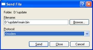

5.      Choose an option from 1 to 3. For example, to upgrade the main Comware software images, enter 2.
6.      On the configuration terminal, configure the communication settings and transfer the upgrade file. For more information, see "Using XMODEM to upgrade software through the console port."
In this example, the system sets the file as a main software image file when the file transfer is complete. The following is the sample output:
Waiting ...CCC
Download successfully!
47979456 bytes downloaded!
Updating File flash:/test-boot-r7328.bin..............................................
..Done.

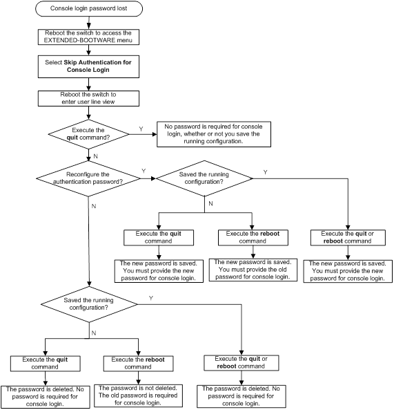

Skipping console login authentication
IMPORTANT:
·       To perform this task, make sure password recovery capability is enabled. If the capability is disabled, you cannot perform this task.
·       Perform this task only if the switch has one MPU. If the switch has two MPUs, you cannot skip console login authentication.
If you cannot remember the console login password, enter 8 in the EXTENDED-BOOTWARE menu, and then enter 1 or 0 in the EXTENDED-BOOTWARE menu. The switch will reboot and load the next-startup configuration file with the console login password ignored.
Enter your choice(0-9): 8
Clear Image Password Success!
After the switch starts up, you can configure a new console login password and save the running configuration so the new password takes effect (see Figure 1). If you do not configure a new console login password, the old password continues to take effect for the subsequent reboot.
Figure 1 Skipping console login authentication
Waiting ...CCC
Updating File flash:/test.bin..............................................
..Done.
IMPORTANT
IMPORTANT:
After the switch starts up, you can configure a new console login password and save the running configuration so the new password takes effect (see Figure 2). If you do not configure a new console login password, the old password continues to take effect for the subsequent reboot.
Figure 2 Skipping console login authentication

6.      Select Transfer > Send File in the HyperTerminal window. In the dialog box that appears, click Browse to select the source file, and select Xmodem from the Protocol list. In this example, the file D:\update\main.bin is selected.
Figure 3 File transmission dialog box
