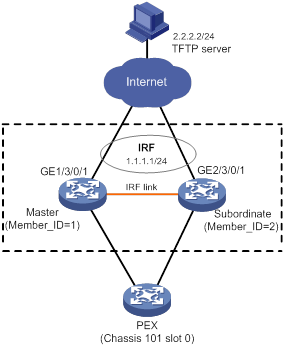

As shown in Figure 1, the IRF fabric has two members. Each member has one active MPU (slot 6) and one standby MPU (slot 7).
Upgrade the feature1 feature from R0201 to R0202. The two versions are compatible.
Figure 1 Network diagram
Upgrade procedure

Feature upgrade to an incompatible version
Upgrade requirements
As shown in Figure 2, the IRF fabric has two members. Each member has one MPU in slot 6 (active MPU) and one MPU in slot 7 (standby MPU).
Upgrade the feature1 feature from R0201 to R0202. The two versions are incompatible.
Figure 2 Network diagram
Upgrade procedure

Feature upgrade to an incompatible version (upgrading one subordinate member first)
As shown in Figure 4, the IRF fabric has four members. Each member has one active MPU (slot 6), one standby MPU (slot 7), and one LPU (slot 3).
Upgrade a feature from soft-version1 to soft-version2 on the IRF fabric. The two versions are incompatible.
Figure 4 Network diagram
Upgrade procedure

# Identify the ISSU method and possible impact of the upgrade.
<Sysname> display version comp-matrix file feature flash:/soft-version2.bin
Verifying the file flash:/soft-version2.bin on chassis 1 slot 6...Don
e.
Feature image: flash:/soft-version2.bin
  Version:
  7.1.045-Release 7168
  Version compatibility list:
  Version dependency system list:
Upgrade Way: Incompatible upgrade.
The output shows that the two versions are incompatible. The cards will be rebooted for the upgrade.

Examples of using issu commands for ISSU on an IRF 3 system
Feature upgrade to a compatible version
As shown in Figure 6, the IRF 3 system contains a two-chassis parent fabric and an S6300 PEX.
·           The PEX is connected to both the master and the subordinate member.
·           The master has two MPUs (active in slot 6 and standby in slot 7) and two LPUs (in slot 8 and slot 12).
·           The subordinate member has one MPU (in slot 6) and one LPU (in slot 8).
Upgrade the feature1 feature as follows:
·           From a0041 to the compatible version a0042 on the parent IRF fabric.
·           From d2402 to the compatible version d2403 on the PEX.
Figure 6 Network diagram
Upgrade procedure
As shown in Figure 7, the IRF 3 system contains a two-chassis parent fabric and an S6300 PEX.
·           The master has two MPUs (active in slot 6 and standby in slot 7) and two LPUs (in slot 8 and in slot 12).
·           From a0041 to the incompatible version a0043 on the parent IRF fabric.
·           From d2402 to the incompatible version d2404 on the PEX.
Figure 7 Network diagram
Upgrade procedure

Examples of using install commands for ISSU on an IRF 3 system
Feature upgrade example
As shown in Figure 10, the IRF 3 system contains a two-chassis parent fabric and an S6300 PEX.
Figure 10 Network diagram
Upgrade procedure
# Download the image file that contains the d2403 feature for PEX upgrade from the TFTP server.
<Sysname> tftp 2.2.2.2 get S6300-feature1-d2403.bin
  % Total    % Received % Xferd  Average Speed   Time    Time     Time  Current
                                 Dload  Upload   Total   Spent    Left  Speed
100   256  100  256     0     0    764      0 --:--:-- --:--:-- --:--:--   810
# Download the image file that contains the a0042 feature for parent IRF fabric upgrade from the TFTP server.
<Sysname> tftp 2.2.2.2 get feature1-a0042.bin
# Display active software images.
<Sysname> display install active
Active packages on chassis 1 slot 6:
  flash:/boot-a0041.bin
  flash:/system-a0041.bin
  flash:/feature1-a0041.bin
Active packages on chassis 1 slot 7:
Active packages on chassis 1 slot 8:
Active packages on chassis 1 slot 12:
Active packages on chassis 2 slot 6:
Active packages on chassis 2 slot 8:
Active packages on chassis 101 slot 0:
  flash:/S6300-boot.bin
  flash:/S6300-system.bin
  flash:/S6300-feature1-d2402.bin
# Identify the recommended ISSU method for the upgrade and view the possible impact of the upgrade.
<Sysname> install activate feature flash:/feature1-a0042.bin chassis 1 slot 6 test
Verifying the file flash:/feature1-a0042.bin on chassis 1 slot 6...Done.
Upgrade summary according to following table:
  Running Version             New Version
  Alpha 0041                  Alpha 0042
  Chassis   Slot              Upgrade Way
  1         6                 Service Upgrade
  1         8                 Service Upgrade
  1         12                Service Upgrade
Influenced service according to following table on chassis 1 slot 6:
         feature1      CFA
Influenced service according to following table on chassis 1 slot 8:
         feature1
Influenced service according to following table on chassis 1 slot 12:
         feature1
<Sysname> install activate feature flash:/feature1-a0042.bin chassis 1 slot 7 test
Verifying the file flash:/feature1-a0042.bin on chassis 1 slot 7...Done.
  1         7                Service Upgrade
Influenced service according to following table on chassis 1 slot 7:
         feature1      CFA
<Sysname> install activate feature flash:/feature1-a0042.bin chassis 2 slot 6 test
Verifying the file flash:/feature1-a0042.bin on chassis 2 slot 6...Done.
  2         6                Service Upgrade
  2         8                 Service Upgrade
  2         12                Service Upgrade
Influenced service according to following table on chassis 2 slot 6:
         feature1      CFA
Influenced service according to following table on chassis 2 slot 8:
         feature1
<Sysname> install activate feature flash:/S6300-feature1-d2403.bin chassis 101 slot 0 test
  Demo 2402                   Demo 2403
  101       0                 Service Upgrade
Influenced service according to following table on chassis 101 slot 0:
         feature1
The output shows that an incremental upgrade is recommended. The feature and its related modules might reboot on the MPUs, the LPUs, and the PEX during the upgrade.
# Activate the new feature image to upgrade the feature on the MPU in slot 7 of chassis 1.
flash:/feature1-a0042.bin already exists on chassis 1 slot 7.
Overwrite it?[Y/N]:Y
Successfully copied flash:/feature1-a0042.bin to chassis1#slot7#flash:/feature1-a0042.bin.
  1         7                 Service Upgrade
Upgrading software images to compatible versions. Continue? [Y/N]:Y
This operation might take several minutes, please wait......................Done.
# Activate the new feature image to upgrade the feature on the MPU in slot 6 of chassis 1 and the LPUs in chassis 1.
flash:/feature1-a0042.bin already exists on chassis 1 slot 6.
Successfully copied flash:/feature1-a0042.bin to chassis1#slot6#flash:/feature1-a0042.bin.
  1         6                 Service Upgrade
  1         8                 Service Upgrade
# Activate the new feature image to upgrade the feature on the cards in chassis 2.
flash:/feature1-a0042.bin already exists on chassis 2 slot 6.
Successfully copied flash:/feature1-a0042.bin to chassis2#slot6# flash:/feature1-a0042.bin.
  2         6                 Service Upgrade
  2         8                 Service Upgrade
# Activate the new feature image to upgrade the feature on the PEX.
flash:/S6300-feature1-d2403.bin already exists on chassis 101 slot 0.
Successfully copied S6300-feature1-d2403.bin to chassis101#slot0#flash:/S6300-feature1-d2403.bin.
Verifying the file flash:/S6300-feature1-d2403.bin on chassis 1 slot 6...Done.
  Demo 2402                   Demo 2403
