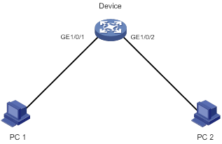

Schedule configuration example
Network requirements
As shown in Figure 1, two interfaces of the device are connected to users.
To save energy, configure the device to perform the following operations:
·           Enable the interfaces at 8:00 a.m. every Monday through Friday.
·           Disable the interfaces at 18:00 every Monday through Friday.
Figure 1 Network diagram

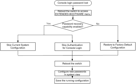

Disabling password recovery capability
Password recovery capability controls console user access to the device configuration and SDRAM from BootWare menus. This feature also decides the method for handling console login password loss (see Figure 2).
If password recovery capability is enabled, a console user can access the device configuration without authentication to configure new passwords.
If password recovery capability is disabled, console users must restore the factory-default configuration before they can configure new passwords. Restoring the factory-default configuration deletes the next-startup configuration files.
To enhance system security, disable password recovery capability.
Figure 2 Handling console login password loss
Table 1 summarizes options whose availability depends on the password recovery capability setting.
Table 1 BootWare options and password recovery capability compatibility matrix
BootWare menu option
Password recovery enabled
Password recovery disabled
Tasks that can be performed
Download Image Program To SDRAM And Run
Yes
No
Load and run Comware software images in SDRAM.
Download Files(*.*)
Yes
No
Download a file to the current storage medium.
Skip Authentication for Console Login
Yes
No
Enable console login without authentication.
This is a one-time operation and takes effect only for the first system boot or reboot after you choose this option.
Skip Current System Configuration
Yes
No
Skip the configuration file at the next startup.
This is a one-time operation. It takes effect only for the first system boot or reboot after you choose this option.
This option does not delete the configuration file.
Restore to Factory Default Configuration
No
Yes
Delete the next-startup configuration file and load the factory-default configuration.
To disable password recovery capability:
Step
Remarks
1.      Enter system view.
N/A
2.      Disable password recovery capability.
undo password-recovery enable
By default, password recovery capability is enabled.
When password recovery capability is disabled, you cannot downgrade the software configuration of the device to a version that does not support the capability through the BootWare menus. You can do so at the CLI, but the configured BootWare menu password becomes effective again.

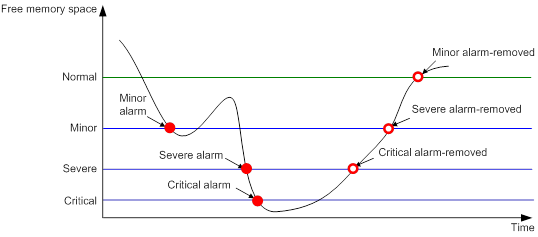

Setting memory alarm thresholds
To monitor memory usage, the device performs the following operations:
·           Samples memory usage at an interval of 1 minute, and compares the sample with the memory usage threshold. If the sample is greater, the device sends a trap.
·           Monitors the amount of free memory space in real time. If a free-memory threshold is exceeded, the system generates an alarm notification or an alarm-removed notification and sends it to affected service modules or processes.
As shown in Table 2 and Figure 3, the system supports the following free-memory thresholds:
·           Normal state threshold.
·           Minor alarm threshold.
·           Severe alarm threshold.
·           Critical alarm threshold.
Table 2 Memory alarm notifications and memory alarm-removed notifications
Notification
Triggering condition
Remarks
Minor alarm notification
The amount of free memory space decreases to or below the minor alarm threshold for the first time.
After generating and sending a minor alarm notification, the system does not generate and send any additional minor alarm notifications until the first minor alarm is removed.
Severe alarm notification
The amount of free memory space decreases to or below the severe alarm threshold for the first time.
After generating and sending a severe alarm notification, the system does not generate and send any additional severe alarm notifications until the first severe alarm is removed.
Critical alarm notification
The amount of free memory space decreases to or below the critical alarm threshold for the first time.
After generating and sending a critical alarm notification, the system does not generate and send any additional critical alarm notifications until the first critical alarm is removed.
Critical alarm-removed notification
The amount of free memory space increases to or above the severe alarm threshold.
N/A
Severe alarm-removed notification
The amount of free memory space increases to or above the minor alarm threshold.
N/A
Minor alarm-removed notification
The amount of free memory space increases to or above the normal state threshold.
N/A
Figure 3 Memory alarm notification and alarm-removed notification
