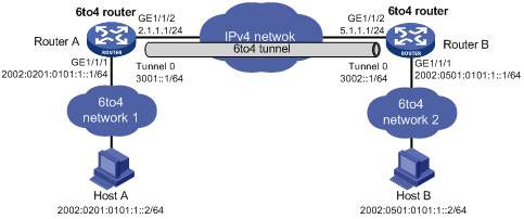

· 6to4 tunneling
¡ Ordinary 6to4 tunneling—A point-to-multipoint automatic tunnel. It is used to connect multiple isolated IPv6 networks over an IPv4 network.
6to4 tunneling uses an IPv4 address to identify a 6to4 network. This method overcomes the limitations of automatic IPv4-compatible IPv6 tunneling.

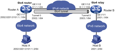

¡ 6to4 relay—Connects a 6to4 network and an IPv6 network that uses an IP prefix other than 2002::/16. A 6to4 relay router is a gateway that forwards packets from a 6to4 network to an IPv6 network.
As shown in Figure 2, 6to4 network Site 1 communicates with IPv6 network Site 3 over a 6to4 tunnel. Configure a static route on the border router (Device A) in the 6to4 network. The next hop address must be the 6to4 address of the 6to4 relay router (Device C). Device A forwards all packets destined for the IPv6 network over the 6to4 tunnel, and Device C then forwards them to the IPv6 network.
Figure 2 Principle of 6to4 tunneling and 6to4 relay

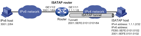

· ISATAP tunneling—A point-to-multipoint automatic tunnel. It provides a solution to connect an IPv6 host and an IPv6 network over an IPv4 network. ISATAP tunnels are mainly used for communication between IPv6 routers or between an IPv6 host and an IPv6 router over an IPv4 network.
Figure 3 Principle of ISATAP tunneling

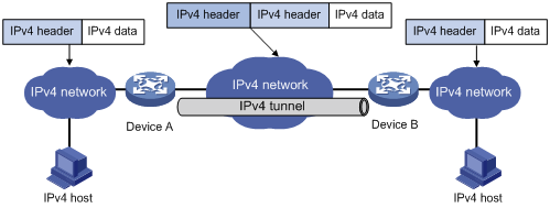

IPv4 over IPv4 tunneling
IPv4 over IPv4 tunneling (RFC 1853) enables isolated IPv4 networks to communicate. For example, an IPv4 over IPv4 tunnel can connect isolated private IPv4 networks over a public IPv4 network.
Figure 4 IPv4 over IPv4 tunnel
Figure 4 shows the encapsulation and de-encapsulation processes.
· Encapsulation:
a. Device A receives an IP packet from an IPv4 host and submits it to the IP protocol stack.
b. The IPv4 protocol stack determines how to forward the packet according to the destination address in the IP header. If the packet is destined for the IPv4 host connected to Device B, Device A delivers the packet to the tunnel interface.
c. The tunnel interface adds a new IPv4 header to the IPv4 packet and submits it to the IP protocol stack.
In the new header, the source IP address specifies the tunnel source, and the destination IP address specifies the tunnel destination.
d. The IP protocol stack uses the destination IP address of the new IP header to look up the routing table, and then sends the packet out.
· De-encapsulation:
a. After receiving the packet, Device B delivers it to the IP protocol stack.
b. If the protocol number is 4 (indicating an IPv4 packet is encapsulated within the packet), the IP protocol stack delivers the packet to the tunnel module for de-encapsulation.
c. The tunnel module de-encapsulates the IP packet and sends it back to the IP protocol stack.
d. The protocol stack forwards the de-encapsulated packet.

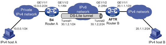

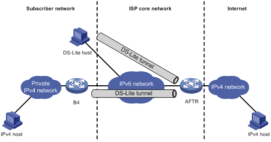

· DS-Lite tunnel
Dual Stack Lite (DS-Lite) is a combination of the tunneling and NAT technologies. NAT translates the private IPv4 addresses of the IPv4 hosts before the hosts reach the IPv4 public network.
DS-Lite tunnel supports only an IPv4 host in a private network initiating communication with an IPv4 host on the Internet. It does not support an IPv4 host on the Internet initiating communication with an IPv4 host in a private network.
Figure 6 DS-Lite tunnel
As shown in Figure 6, the DS-Lite feature contains the following components:
¡ Basic Bridging BroadBand (B4) element
The B4 element is typically a CPE router that connects end hosts. IPv4 packets entering the B4 router are encapsulated into IPv6 packets and sent to the AFTR. IPv6 packets from the AFTR are de-encapsulated into IPv4 packets and sent to the subscriber's network.
Hosts that can act as the B4 router are referred to as DS-Lite hosts.
¡ Address Family Transition Router (AFTR)
An AFTR resides in the ISP network and terminates the tunnel from the B4 router. NAT is also implemented on the interface that is connected to the public IPv4 network.
An AFTR de-encapsulates the tunneled packet, translates the network address, and routes the packet to the destination IPv4 network. For IPv4 packets coming from the public IPv4 network, the AFTR performs address translation and sends them to the B4 router by using the DS-Lite tunnel.

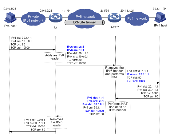

Figure 7 Packet forwarding process in DS-Lite
As shown in Figure 7, the packet forwarding process in DS-Lite is as follows:
a. Upon receiving a packet from the private IPv4 network, the B4 router adds an IPv6 header to the packet and sends the IPv6 packet to the AFTR through the tunnel.
b. The AFTR performs the following operations:
- Removes the IPv6 header from the tunneled packet.
- Assigns a tunnel ID to the B4 router.
- Records the mapping between the IPv6 address of the B4 router (the source IPv6 address of the packet), and the tunnel ID.
c. After de-encapsulation, the AFTR translates the source private IPv4 address of the packet into a public IPv4 address and sends the packet to the destination IPv4 host. The AFTR also maps the NAT entries to the tunnel ID so that IPv4 networks connected to different B4 routers can use the same address space.
d. Upon receiving the response packet from the public network, the AFTR translates the destination public IPv4 address into the private IPv4 address. The AFTR performs the following operations:
- Looks up the IPv6 address-tunnel ID mapping to obtain the IPv6 address of the B4 router.
- Uses the address as the destination address of the encapsulated IPv6 packet.
- Forwards the packet to the B4 router.
Figure 7 shows an example of PAT translation for dynamic NAT. Typically, dynamic NAT is used. When you use static NAT for DS-Lite tunneling, make sure the IP addresses of private IPv4 networks connected to different B4 routers do not overlap. For more information about NAT, see "Configuring NAT."

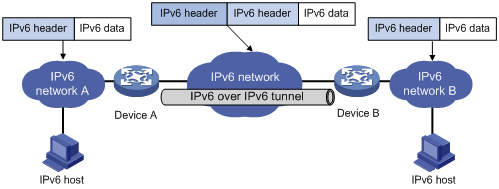

IPv6 over IPv6 tunneling
IPv6 over IPv6 tunneling (RFC 2473) enables isolated IPv6 networks to communicate with each other over another IPv6 network. For example, two isolated IPv6 networks that do not want to show their addresses to the Internet can use an IPv6 over IPv6 tunnel to communicate with each other.
Figure 8 Principle of IPv6 over IPv6 tunneling
Figure 8 shows the encapsulation and de-encapsulation processes.
· Encapsulation:
a. After receiving an IPv6 packet, Device A submits it to the IPv6 protocol stack.
b. The IPv6 protocol stack uses the destination IPv6 address of the packet to find the egress interface. If the egress interface is the tunnel interface, the stack delivers it to the tunnel interface.
c. After receiving the packet, the tunnel interface adds an IPv6 header to it and submits it to the IPv6 protocol stack.
d. The IPv6 protocol stack forwards the packet according to its destination IPv6 address.
· De-encapsulation:
a. Upon receiving the IPv6 packet, Device B delivers it to the IPv6 protocol stack.
b. The IPv6 protocol stack checks the protocol type of the data portion encapsulated in the IPv6 packet. If the encapsulation protocol is IPv6, the stack delivers the packet to the tunnel module.
c. The tunnel module de-encapsulates the packet and sends it back to the IPv6 protocol stack.
d. The IPv6 protocol stack forwards the IPv6 packet.

6to4 tunnel configuration example
Network requirements
As shown in Figure 11, configure a 6to4 tunnel between 6to4 routers Router A and Router B so the two hosts can reach each other over the IPv4 network.
Requirements analysis
To enable communication between 6to4 networks, configure 6to4 addresses for 6to4 routers and hosts in the 6to4 networks.
· The IPv4 address of GigabitEthernet 1/1/2 on Router A is 2.1.1.1/24, and the corresponding 6to4 prefix is 2002:0201:0101::/48. Host A must use this prefix.
· The IPv4 address of GigabitEthernet 1/1/2 on Router B is 5.1.1.1/24, and the corresponding 6to4 prefix is 2002:0501:0101::/48. Host B must use this prefix.
Configuration procedure
Make sure Router A and Router B can reach each other through IPv4.
· Configure Router A:
# Specify an IPv4 address for GigabitEthernet 1/1/2.
<RouterA> system-view
[RouterA] interface gigabitethernet 1/1/2
[RouterA-GigabitEthernet1/1/2] ip address 2.1.1.1 24
[RouterA-GigabitEthernet1/1/2] quit
# Specify a 6to4 address for GigabitEthernet 1/1/1.
[RouterA] interface gigabitethernet 1/1/1
[RouterA-GigabitEthernet1/1/1] ipv6 address 2002:0201:0101:1::1/64
[RouterA-GigabitEthernet1/1/1] quit
# Create the 6to4 tunnel interface Tunnel 0.
[RouterB] interface tunnel 0 mode ipv6-ipv4 6to4
# Specify an IPv6 address for the tunnel interface.
[RouterA-Tunnel0] ipv6 address 3001::1/64
# Specify the source interface as GigabitEthernet 1/1/2 for the tunnel interface.
[RouterA-Tunnel0] source gigabitethernet 1/1/2
[RouterA-Tunnel0] quit
# Configure a static route destined for 2002::/16 through the tunnel interface.
[RouterA] ipv6 route-static 2002:: 16 tunnel 0
· Configure Router B:
<RouterB> system-view
[RouterB] interface gigabitethernet 1/1/2
[RouterB-GigabitEthernet1/1/2] ip address 5.1.1.1 24
[RouterB-GigabitEthernet1/1/2] quit
[RouterB] interface gigabitethernet 1/1/1
[RouterB-GigabitEthernet1/1/1] ipv6 address 2002:0501:0101:1::1/64
[RouterB-GigabitEthernet1/1/1] quit
[RouterB-Tunnel0] ipv6 address 3002::1/64
[RouterB-Tunnel0] source gigabitethernet 1/1/2
[RouterB-Tunnel0] quit
[RouterB] ipv6 route-static 2002:: 16 tunnel 0
# Verify that Linux-running hosts Host A and Host B can ping each other.
D:\>ping6 -s 2002:201:101:1::2 2002:501:101:1::2
Pinging 2002:501:101:1::2
from 2002:201:101:1::2 with 32 bytes of data:
Reply from 2002:501:101:1::2: bytes=32 time=13ms
Reply from 2002:501:101:1::2: bytes=32 time=1ms
Reply from 2002:501:101:1::2: bytes=32 time<1ms
Ping statistics for 2002:501:101:1::2:
Minimum = 0ms, Maximum = 13ms, Average = 3ms
6to4 relay configuration example
As shown in Figure 12, Router A is a 6to4 router, and 6to4 addresses are used on the connected IPv6 network. Router B acts as a 6to4 relay router and is connected to an IPv6 network (2001::/16). Configure a 6to4 tunnel between Router A and Router B to make Host A and Host B reachable to each other.
The configuration on a 6to4 relay router is similar to that on a 6to4 router. However, to enable communication between the 6to4 network and the IPv6 network, you must configure a route to the IPv6 network on the 6to4 router. The IPv4 address of GigabitEthernet 1/1/2 on the relay router is 6.1.1.1/24 and its corresponding 6to4 prefix is 2002:0601:0101::/48. The next hop of the static route must be an address using this prefix.
[RouterA-GigabitEthernet1/1/2] ip address 2.1.1.1 255.255.255.0
[RouterA] interface tunnel 0 mode ipv6-ipv4 6to4
[RouterA-Tunnel0] ipv6 address 2002::1/64
# Specify GigabitEthernet 1/1/2 as the source interface of the tunnel interface.
# Configure a static route to the 6to4 relay router.
[RouterA] ipv6 route-static 2002:0601:0101:: 64 tunnel 0
# Configure a default route to reach the IPv6 network, which specifies the next hop as the 6to4 address of the relay router.
[RouterA] ipv6 route-static :: 0 2002:0601:0101::1
[RouterB-GigabitEthernet1/1/2] ip address 6.1.1.1 255.255.255.0
# Specify an IPv6 address for GigabitEthernet 1/1/1.
[RouterB-GigabitEthernet1/1/1] ipv6 address 2001::1/16
[RouterB-Tunnel0] ipv6 address 2003::1/64
D:\>ping6 -s 2002:201:101:1::2 2001::2
Pinging 2001::2
Reply from 2001::2: bytes=32 time=13ms
Reply from 2001::2: bytes=32 time=1ms
Reply from 2001::2: bytes=32 time<1ms
Ping statistics for 2001::2:

Configuration example
As shown in Figure 13, configure an ISATAP tunnel between the router and the ISATAP host so the ISATAP host in the IPv4 network can access the IPv6 network.
· Configure the router:
# Specify an IPv6 address for GigabitEthernet 1/1/2.
<Router> system-view
[Router] interface gigabitethernet 1/1/2
[Router-GigabitEthernet1/1/2] ipv6 address 3001::1/64
[Router-GigabitEthernet1/1/2] quit
# Specify an IPv4 address for GigabitEthernet 1/1/1.
[Router] interface gigabitethernet 1/1/1
[Router-GigabitEthernet1/1/1] ip address 1.1.1.1 255.0.0.0
[Router-GigabitEthernet1/1/1] quit
# Create the ISATAP tunnel interface Tunnel 0.
[Router] interface tunnel 0 mode ipv6-ipv4 isatap
# Specify an EUI-64 IPv6 address for the tunnel interface.
[Router-Tunnel0] ipv6 address 2001:: 64 eui-64
# Specify GigabitEthernet 1/1/1 as the source interface of the tunnel interface.
[Router-Tunnel0] source gigabitethernet 1/1/1
# Disable RA suppression so that the ISATAP host can acquire information such as the address prefix from the RA message advertised by the ISATAP router.
[Router-Tunnel0] undo ipv6 nd ra halt
[Router-Tunnel0] quit
· Configure the ISATAP host:
Configurations on the ISATAP host vary by operating system. The following configuration is performed on Windows XP.
# Install IPv6.
C:\>ipv6 install
# On a host running Windows XP, the ISATAP interface is typically interface 2. Display information about the ISATAP interface.
C:\>ipv6 if 2
Interface 2: Automatic Tunneling Pseudo-Interface
Guid {48FCE3FC-EC30-E50E-F1A7-71172AEEE3AE}
does not use Neighbor Discovery
does not use Router Discovery
routing preference 1
EUI-64 embedded IPv4 address: 0.0.0.0
router link-layer address: 0.0.0.0
preferred link-local fe80::5efe:1.1.1.2, life infinite
link MTU 1280 (true link MTU 65515)
current hop limit 128
reachable time 42500ms (base 30000ms)
retransmission interval 1000ms
DAD transmits 0
default site prefix length 48
# Specify an IPv4 address for the ISATAP router.
C:\>netsh interface ipv6 isatap set router 1.1.1.1
# Display information about the ISATAP interface.
C:\>ipv6 if 2
uses Router Discovery
EUI-64 embedded IPv4 address: 1.1.1.2
router link-layer address: 1.1.1.1
preferred global 2001::5efe:1.1.1.2, life 29d23h59m46s/6d23h59m46s (public)
link MTU 1500 (true link MTU 65515)
current hop limit 255
DAD transmits 0
The host has obtained the prefix 2001::/64 and has automatically generated the global unicast address 2001::5efe:1.1.1.2. The message "uses Router Discovery" indicates that the router discovery feature is enabled on the host.
# Display information about IPv6 routes on the host.
C:\>ipv6 rt
2001::/64 -> 2 pref 1if+8=9 life 29d23h59m43s (autoconf)
::/0 -> 2/fe80::5efe:1.1.1.1 pref 1if+256=257 life 29m43s (autoconf)
· On the IPv6 host, configure a route to the ISATAP router.
C:\>netsh interface ipv6 set route 2001::/64 5 3001::1
# Verify that the ISATAP host can ping the IPv6 host.
C:\>ping 3001::2
Pinging 3001::2 with 32 bytes of data:
Reply from 3001::2: time=1ms
Ping statistics for 3001::2:
Configuring an IPv4 over IPv4 tunnel
Follow these guidelines when you configure an IPv4 over IPv4 tunnel:
· The tunnel destination address specified on the local device must be identical with the tunnel source address specified on the tunnel peer device.
· Do not specify the same source and destination addresses for local tunnel interfaces in the same tunnel mode.
· The IPv4 address of the local tunnel interface cannot be on the same subnet as the destination address configured on the tunnel interface.
· To ensure correct packet forwarding, identify whether the destination IPv4 network and the IPv4 address of the local tunnel interface are on the same subnet. If they are not, configure a route reaching the destination IPv4 network through the tunnel interface. You can configure the route by using one of the following methods:
¡ Configure a static route, and specify the local tunnel interface as the egress interface or specify the IPv4 address of the peer tunnel interface as the next hop.
¡ Enable a dynamic routing protocol on both tunnel interfaces to achieve the same purpose.
For more information about route configuration, see Layer 3—IP Routing Configuration Guide.
· The destination address of the route passing the tunnel interface cannot be on the same subnet as the destination address configured on the tunnel interface.
To configure an IPv4 over IPv4 tunnel:
Step |
Command |
Remarks |
1. Enter system view. |
system-view |
N/A |
2. Enter IPv4 over IPv4 tunnel interface view. |
interface tunnel number [ mode ipv4-ipv4 ] |
N/A |
3. Configure an IPv4 address for the tunnel interface. |
ip address ip-address { mask | mask-length } [ sub ] |
By default, no IPv4 address is configured for the tunnel interface. |
4. Configure a source address or source interface for the tunnel interface. |
source { ipv4-address | interface-type interface-number } |
By default, no source address or source interface is configured for the tunnel interface. If you specify a source address, it is used as the source IP address of tunneled packets. If you specify a source interface, the primary IP address of this interface is used as the source IP address of tunneled packets. |
5. Configure a destination address for the tunnel interface. |
destination ipv4-address |
By default, no destination address is configured for the tunnel interface. The tunnel destination address must be the IP address of the receiving interface on the tunnel peer. It is used as the destination IP address of tunneled packets. |
6. (Optional.) Set the DF bit for tunneled packets. |
tunnel dfbit enable |
By default, the DF bit is not set for tunneled packets. |

Configuring a DS-Lite tunnel
A B4 tunnel interface can establish a tunnel with only one AFTR tunnel interface, but an AFTR tunnel interface can establish tunnels with multiple B4 tunnel interfaces.
Follow these guidelines when you configure the B4 router of a DS-Lite tunnel:
· Do not specify the same source addresses for local tunnel interfaces in the same tunnel mode.
· The destination address specified for the tunnel interface on the B4 router must be the source address specified for the tunnel interface on the AFTR.
¡ Configure a static route, and specify the local tunnel interface as the egress interface or specify the IPv6 address of the peer tunnel interface as the next hop.
Follow these guidelines when you configure the AFTR of a DS-Lite tunnel:
· Enable NAT on the interface that is connected to the public IPv4 interface.
· The tunnel destination cannot be configured on the AFTR. The AFTR uses the address of the B4 router as the IPv6 address of the tunnel destination.
· It is not necessary to configure a route to the destination IPv4 address for forwarding packets through the tunnel interface.
To configure the B4 router of a DS-Lite tunnel:
Step |
Command |
Remarks |
system-view |
N/A |
2. Enter IPv4 over IPv6 tunnel interface view. |
interface tunnel number [ mode ipv4-ipv6 ] |
N/A |
3. Specify an IPv4 address for the tunnel interface. |
By default, no IPv4 address is specified for the tunnel interface. |
4. Specify the source address or source interface for the tunnel. |
source { ipv6-address | interface-type interface-number } |
By default, no source address or interface is specified for the tunnel. If you specify a source address, it is used as the source IPv6 address of tunneled packets. If you specify a source interface, the lowest IPv6 address of this interface is used as the source IPv6 address of tunneled packets. |
5. Specify the destination address for the tunnel. |
destination { ipv6-address | dhcp-alloc interface-type interface-number } |
As shown in Figure 14, to enable hosts in the private IPv4 network to access the public IPv4 network over the IPv6 network, perform the following tasks:
· Configure a DS-Lite tunnel between Router A and Router B.
· Configure NAT on GigabitEthernet 1/1/1 on the AFTR.
Make sure Router A and Router B can reach each other through IPv6.
[RouterA-GigabitEthernet1/1/1] ip address 10.0.0.2 255.255.255.0
# Specify an IPv6 address for GigabitEthernet 1/1/2, which is the physical interface of the tunnel.
[RouterA-GigabitEthernet1/1/2] ipv6 address 1::1 64
# Create IPv4 over IPv6 tunnel interface Tunnel 1.
[RouterA] interface tunnel 1 mode ipv4-ipv6
# Specify an IPv4 address for the tunnel interface.
[RouterA-Tunnel1] ip address 30.1.2.1 255.255.255.0
# Specify the IP address of GigabitEthernet 1/1/2 as the source address for the tunnel interface.
[RouterA-Tunnel1] source 1::1
# Specify IP address of GigabitEthernet 1/1/2 on Router B as the destination address for the tunnel interface.
[RouterA-Tunnel1] destination 2::2
[RouterA-Tunnel1] quit
# Configure a static route to the public IPv4 network through the tunnel interface.
[RouterA] ip route-static 20.1.1.0 255.255.255.0 tunnel 1
[RouterB-GigabitEthernet1/1/1] ip address 20.1.1.1 24
[RouterB-GigabitEthernet1/1/2] ipv6 address 2::2 64
# Create the DS-Lite tunnel interface Tunnel 2.
[RouterB] interface tunnel 2 mode ds-lite-aftr
# Configure an IPv4 address for the tunnel interface.
[RouterB-Tunnel2] ip address 30.1.2.2 255.255.255.0
[RouterB-Tunnel2] source gigabitethernet 1/1/2
[RouterB-Tunnel2] quit
# Enable DS-Lite tunneling on GigabitEthernet 1/1/1.
[RouterB-GigabitEthernet1/1/1] ds-lite enable
# Enable NAT on GigabitEthernet 1/1/1 and use the IP address of GigabitEthernet 1/1/1 as the translated address.
[RouterB-GigabitEthernet1/1/1] nat outbound
· On host A, specify the IP address for the host as 10.0.0.1 and configure a static route to 20.1.1.0/24 with next hop 10.0.0.2. (Details not shown.)
· On host B, specify the IP address for the host as 20.1.1.2. (Details not shown.)
# Use the display interface tunnel command to display the status of the tunnel interfaces on Router A and Router B. Verify that the tunnel interfaces are up. (Details not shown.)
# Verify that host A can ping host B.
C:\> ping 20.1.1.2
Pinging 20.1.1.2 with 32 bytes of data:
Reply from 20.1.1.2: bytes=32 time=51ms TTL=255
Reply from 20.1.1.2: bytes=32 time=44ms TTL=255
Reply from 20.1.1.2: bytes=32 time=1ms TTL=255
Ping statistics for 20.1.1.2:
Minimum = 1ms, Maximum = 51ms, Average = 24ms
Configuring an IPv6 over IPv6 tunnel
Follow these guidelines when you configure an IPv6 over IPv6 tunnel:
· The IPv6 address of the tunnel interface cannot be on the same subnet as the destination address configured for the tunnel interface.
· To ensure correct packet forwarding, identify whether the destination IPv6 network and the IPv6 address of the local tunnel interface are on the same subnet. If they are not, configure a route reaching the destination IPv6 network through the tunnel interface. You can configure the route by using one of the following methods:
· The destination address of the route passing the tunnel interface cannot be on the same subnet as the destination address configured for the tunnel interface.
To configure an IPv6 over IPv6 tunnel:
Step |
Command |
Remarks |
system-view |
N/A |
2. Enter IPv6 over IPv6 tunnel interface view. |
interface tunnel number [ mode ipv6-ipv6 ] |
N/A |
3. Configure an IPv6 address for the tunnel interface. |
See "Configuring basic IPv6 settings." |
By default, no IPv6 address is configured for the tunnel interface. |
4. Configure the source address or source interface for the tunnel interface. |
By default, no source address or interface is configured for the tunnel. If you specify a source address, it is used as the source IPv6 address of tunneled packets. If you specify a source interface, the lowest IPv6 address of this interface is used as the source IPv6 address of tunneled packets. |
5. Configure the destination address for the tunnel interface. |
destination ipv6-address |
By default, no destination address is configured for the tunnel. The tunnel destination address must be the IPv6 address of the receiving interface on the tunnel peer. It is used as the destination IPv6 address of tunneled packets. |
6. Return to system view. |
quit |
N/A |
7. (Optional.) Enable dropping IPv6 packets that use IPv4-compatible IPv6 addresses. |
tunnel discard ipv4-compatible-packet |
By default, IPv6 packets that use IPv4-compatible IPv6 packets are not dropped. |
